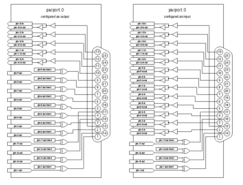

Parport-Blockdiagramm
Figure 1. Parport-Blockdiagramm

Pin in out/epp x
1
out
out
in
2
in
out
out
3
in
out
out
4
in
out
out
5
in
out
out
6
in
out
out
7
in
out
out
8
in
out
out
9
in
out
out
10
in
in
in
11
in
in
in
12
in
in
in
13
in
in
in
14
out
out
in
15
in
in
in
16
out
out
in
17
out
out
in
