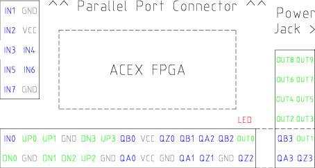

2.1. Pinout
  • UPx - The up (up/down mode) or pwm (pwm+direction mode) signal from PWM generator X. May be used as a digital output if the corresponding PWM channel is unused, or the output on the channel is always negative. The corresponding digital output invert may be set to TRUE to make UPx active low rather than active high.
  • DNx - The down (up/down mode) or direction (pwm+direction mode) signal from PWM generator X. May be used as a digital output if the corresponding PWM channel is unused, or the output on the channel is never negative. The corresponding digital output invert may be set to TRUE to make DNx active low rather than active high.
  • QAx, QBx - The A and B signals for Quadrature counter X. May be used as a digital input if the corresponding quadrature channel is unused.
  • QZx - The Z (index) signal for quadrature counter X. May be used as a digital input if the index feature of the corresponding quadrature channel is unused.
  • INx - Dedicated digital input #x
  • OUTx - Dedicated digital output #x
  • GND - Ground
  • VCC - +3.3V regulated DC
Pluto-Servo Pinout
Figure 1. Pluto-Servo Pinout
Table 1. Pluto-Servo Alternate Pin Functions
Primary function Alternate Function Behavior if both functions used
UP0
PWM0
When pwm-0-pwmdir is TRUE, this pin is the PWM output
OUT10
XOR’d with UP0 or PWM0
UP1
PWM1
When pwm-1-pwmdir is TRUE, this pin is the PWM output
OUT12
XOR’d with UP1 or PWM1
UP2
PWM2
When pwm-2-pwmdir is TRUE, this pin is the PWM output
OUT14
XOR’d with UP2 or PWM2
UP3
PWM3
When pwm-3-pwmdir is TRUE, this pin is the PWM output
OUT16
XOR’d with UP3 or PWM3
DN0
DIR0
When pwm-0-pwmdir is TRUE, this pin is the DIR output
OUT11
XOR’d with DN0 or DIR0
DN1
DIR1
When pwm-1-pwmdir is TRUE, this pin is the DIR output
OUT13
XOR’d with DN1 or DIR1
DN2
DIR2
When pwm-2-pwmdir is TRUE, this pin is the DIR output
OUT15
XOR’d with DN2 or DIR2
DN3
DIR3
When pwm-3-pwmdir is TRUE, this pin is the DIR output
OUT17
XOR’d with DN3 or DIR3
QZ0
IN8
Read same value
QZ1
IN9
Read same value
QZ2
IN10
Read same value
QZ3
IN11
Read same value
QA0
IN12
Read same value
QA1
IN13
Read same value
QA2
IN14
Read same value
QA3
IN15
Read same value
QB0
IN16
Read same value
QB1
IN17
Read same value
QB2
IN18
Read same value
QB3
IN19
Read same value

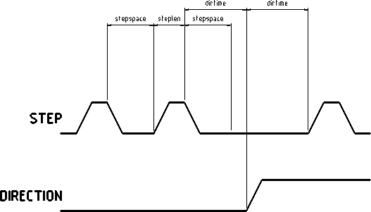

3.3. Step Waveform Timings
The firmware and driver enforce step length, space, and direction change times. Timings are rounded up to the next multiple of 1.6μs, with a maximum of 49.6μs. The timings are the same as for the software stepgen component, except that dirhold and dirsetup have been merged into a single parameter dirtime which should be the maximum of the two, and that the same step timings are always applied to all channels.
Pluto-Step Timings
Figure 3. Pluto-Step Timings
