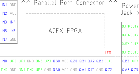

2.1. Pinout
  • UPx - The up (up/down mode) or pwm (pwm+direction mode) signal from PWM generator X. May be used as a digital output if the corresponding PWM channel is unused, or the output on the channel is always negative. The corresponding digital output invert may be set to TRUE to make UPx active low rather than active high.
  • DNx - The down (up/down mode) or direction (pwm+direction mode) signal from PWM generator X. May be used as a digital output if the corresponding PWM channel is unused, or the output on the channel is never negative. The corresponding digital output invert may be set to TRUE to make DNx active low rather than active high.
  • QAx, QBx - The A and B signals for Quadrature counter X. May be used as a digital input if the corresponding quadrature channel is unused.
  • QZx - The Z (index) signal for quadrature counter X. May be used as a digital input if the index feature of the corresponding quadrature channel is unused.
  • INx - Dedicated digital input #x
  • OUTx - Dedicated digital output #x
  • GND - Ground
  • VCC - +3.3V regulated DC
Pluto-Servo Pinout
Figure 1. Pluto-Servo Pinout

2.2. Input latching and output updating
  • PWM duty cycles for each channel are updated at different times.
  • Digital outputs OUT0 through OUT9 are all updated at the same time. Digital outputs OUT10 through OUT17 are updated at the same time as the pwm function they are shared with.
  • Digital inputs IN0 through IN19 are all latched at the same time.
  • Quadrature positions for each channel are latched at different times.

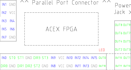

3.1. Pinout
  • STEPx - The step (clock) output of stepgen channel x
  • DIRx - The direction output of stepgen channel x
  • GND - Ground
While the extended main connector has a superset of signals usually found on a Step & Direction DB25 connector—​4 step generators, 9 inputs, and 6 general-purpose outputs—​the layout on this header is different than the layout of a standard 26-pin ribbon cable to DB25 connector.
Pluto-Step Pinout
Figure 2. Pluto-Step Pinout
