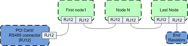

  • RS485 I/O expander modules: RS485 bus was designed for interfacing with compact DIN-rail mounted expander modules. An 8-channel digital input, an 8-channel relay output and an analogue I/O (4x +/-10 Volts output and 8x +/-5 Volts input) modules are available now. Up to 16 modules can be connected to the bus altogether.

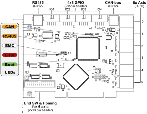

The following connectors can be found on the GM6-PCI card:
GM6-PCI card connectors and LEDs
Figure 1. GM6-PCI card connectors and LEDs
1. I/O connectors
Pin numbering of GPIO connectors
Figure 2. Pin numbering of GPIO connectors

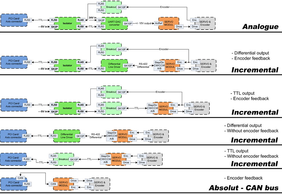

Small sized DIN rail mounted interface modules gives easy way of connecting different types of servo modules to the axis connectors. Seven different system configurations are presented in the System integration manual for evaluating typical applications. Also the detailed description of the Axis modules can be found in the System integration manual.
For evaluating the appropriate servo-drive structure the modules have to be connected as the following block diagram shows:
Servo axis interfaces
Figure 4. Servo axis interfaces

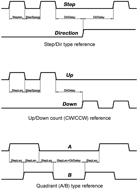

For evaluating the appropriate values see the timing diagrams below:
Reference signal timing diagrams
Figure 5. Reference signal timing diagrams

6. Status LEDs
6.1. CAN
Color: Orange
  • Blink, during data communication.
  • On, when any of the buffers are full - communication error.
  • Off, when no data communication.
6.2. RS485
Color: Orange
  • Blink, during initialization of modules on the bus
  • On, when the data communication is up between all initialized modules.
  • Off, when any of the initialized modules dropped off because of an error.
6.3. EMC
Color: White
  • Blink, when LinuxCNC is running.
  • Otherwise off.
6.4. Boot
Color: Green
  • On, when system booted successfully.
  • Otherwise off.
6.5. Error
Color: Red
  • Off, when there is no fault in the system.
  • Blink, when PCI communication error.
  • On, when watchdog timer overflowed.

Connecting the nodes
The modules on the bus have to be connected in serial topology, with termination resistors on the end. The start of the topology is the PCI card, and the end is the last module.
Connecting the RS485 nodes to the GM6-PCI card
Figure 7. Connecting the RS485 nodes to the GM6-PCI card
