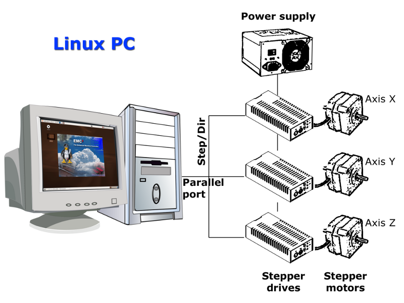

The below illustration is a simple block diagram showing what a typical 3-axis CNC mill with stepper motors might look like:
Simple LinuxCNC Controlled Machine
Figure 1. Simple LinuxCNC Controlled Machine
A computer running LinuxCNC sends a sequence of pulses via the parallel port to the stepper drives, each of which has one stepper motor connected to it. Each drive receives two independent signals; one signal to command the drive to move its associated stepper motor in a clockwise or anti-clockwise direction, and a second signal that defines the speed at which that stepper motor rotates.

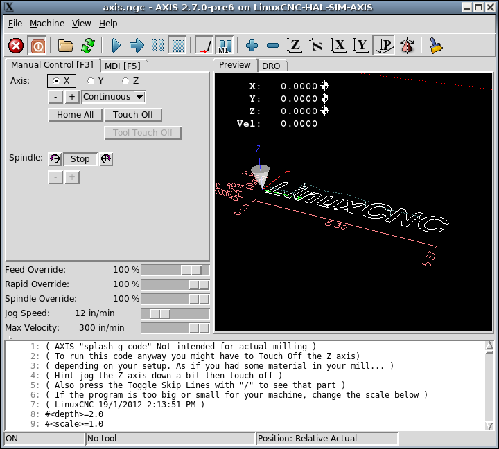

AXIS
AXIS, the standard keyboard GUI interface. This is also the default GUI launched when a Configuration Wizard is used to create a desktop icon launcher:
Figure 2. AXIS, the standard keyboard GUI interface

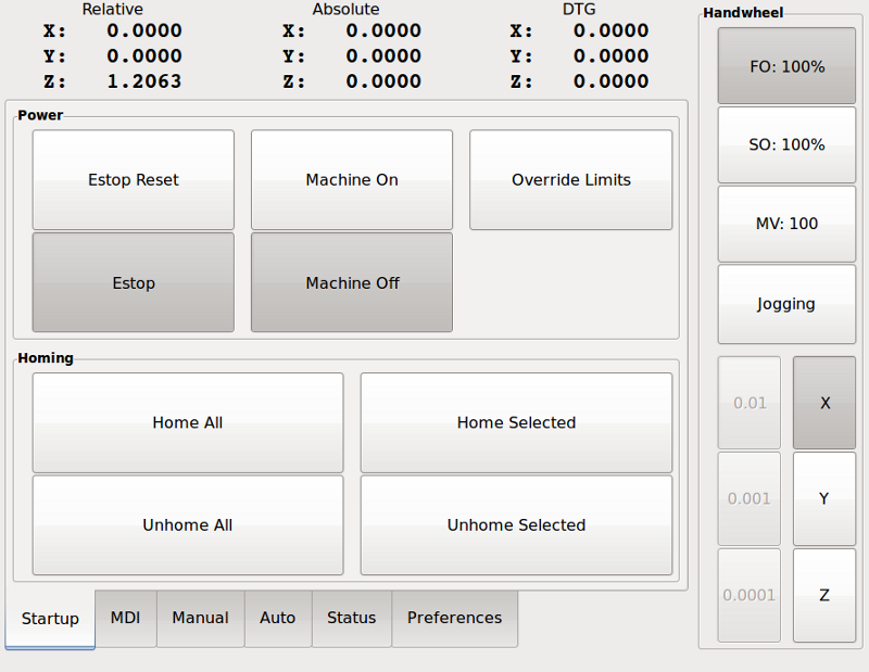

Touchy
Touchy, a touch screens GUI:
Touchy, a touch screen GUI
Figure 3. Touchy, a touch screen GUI

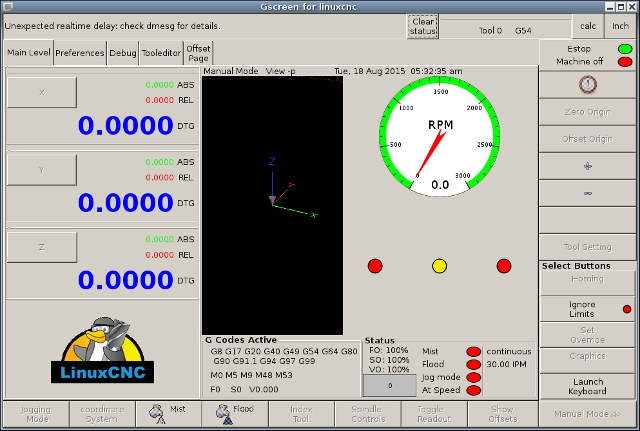

Gscreen, a user-configurable touch screen GUI:
Gscreen, a configurable base touch screen GUI
Figure 4. Gscreen, a configurable base touch screen GUI

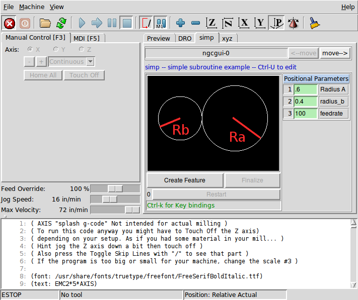

NGCGUI, a subroutine GUI that provides wizard-style programming of G code. NGCGUI may be run as a standalone program or embedded into another GUI as a series of tabs. The following screenshot shows NGCGUI embedded into AXIS:
NGCGUI, a graphical interface integrated into AXIS
Figure 6. NGCGUI, a graphical interface integrated into AXIS

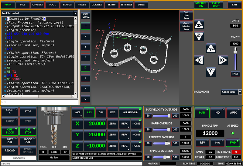

QtDragon, a touch screen GUI based on QtVCP using the PyQt5 library. It comes in two versions QtDragon and QtDragon_hd. They are very similar in features but QtDragon_hd is made for larger monitors.
Figure 8. QtDragon, a touch screen GUI based on QtVCP
