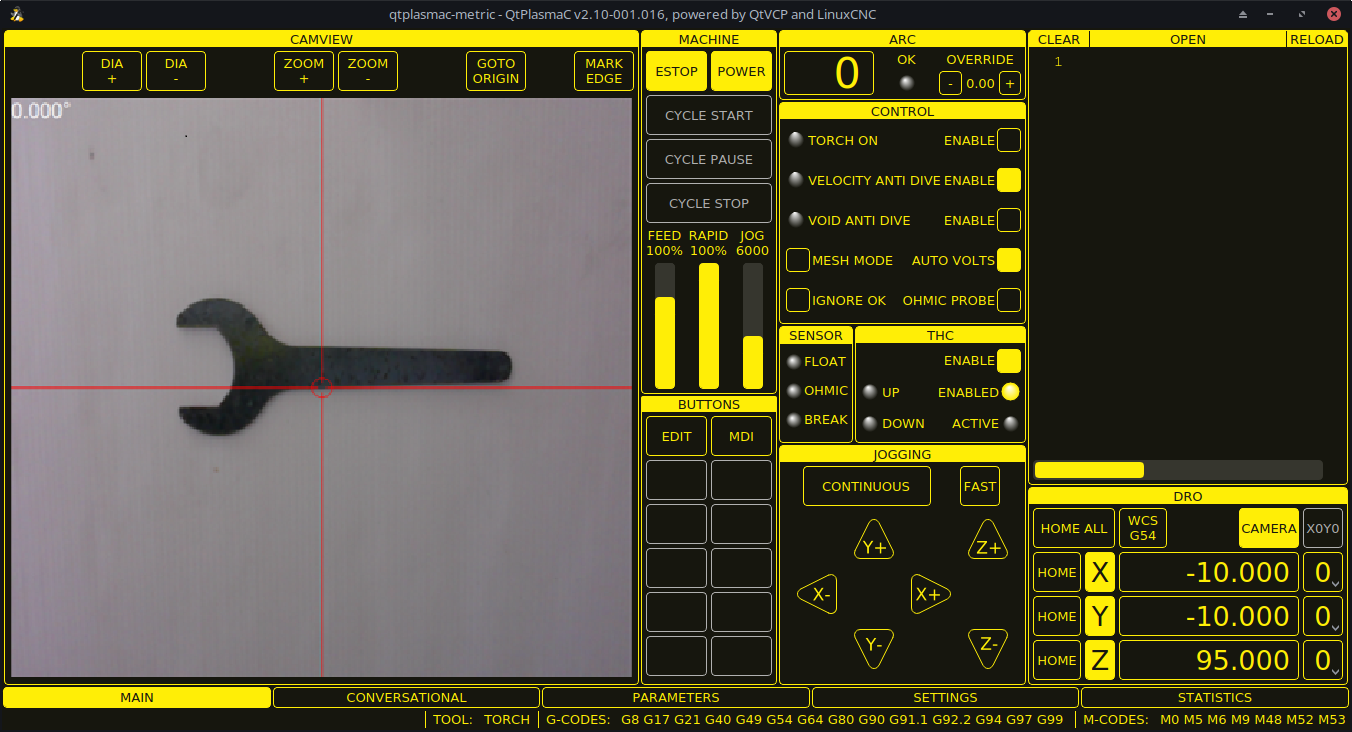

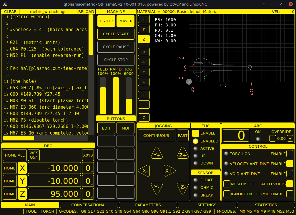

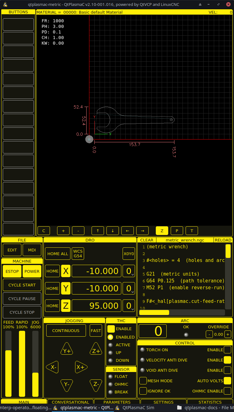

Screenshot examples of QtPlasmaC are below:
images/qtplasmac_16x9.png
Figura 1. 16:9
images/qtplasmac_9x16.png
Figura 2. 9:16
images/qtplasmac_4x3.png
Figura 3. 4:3

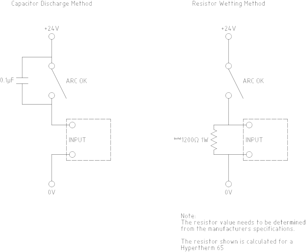

Arc OK
1, 2
Digital input; optional.
HAL pin name plasmac.arc-ok-in
Connected from the Arc OK output of the plasma power source to an input on the breakout board. This signal is used to determine if the cutting arc has been established and it is ok for the machine to move (sometimes called arc transfer).

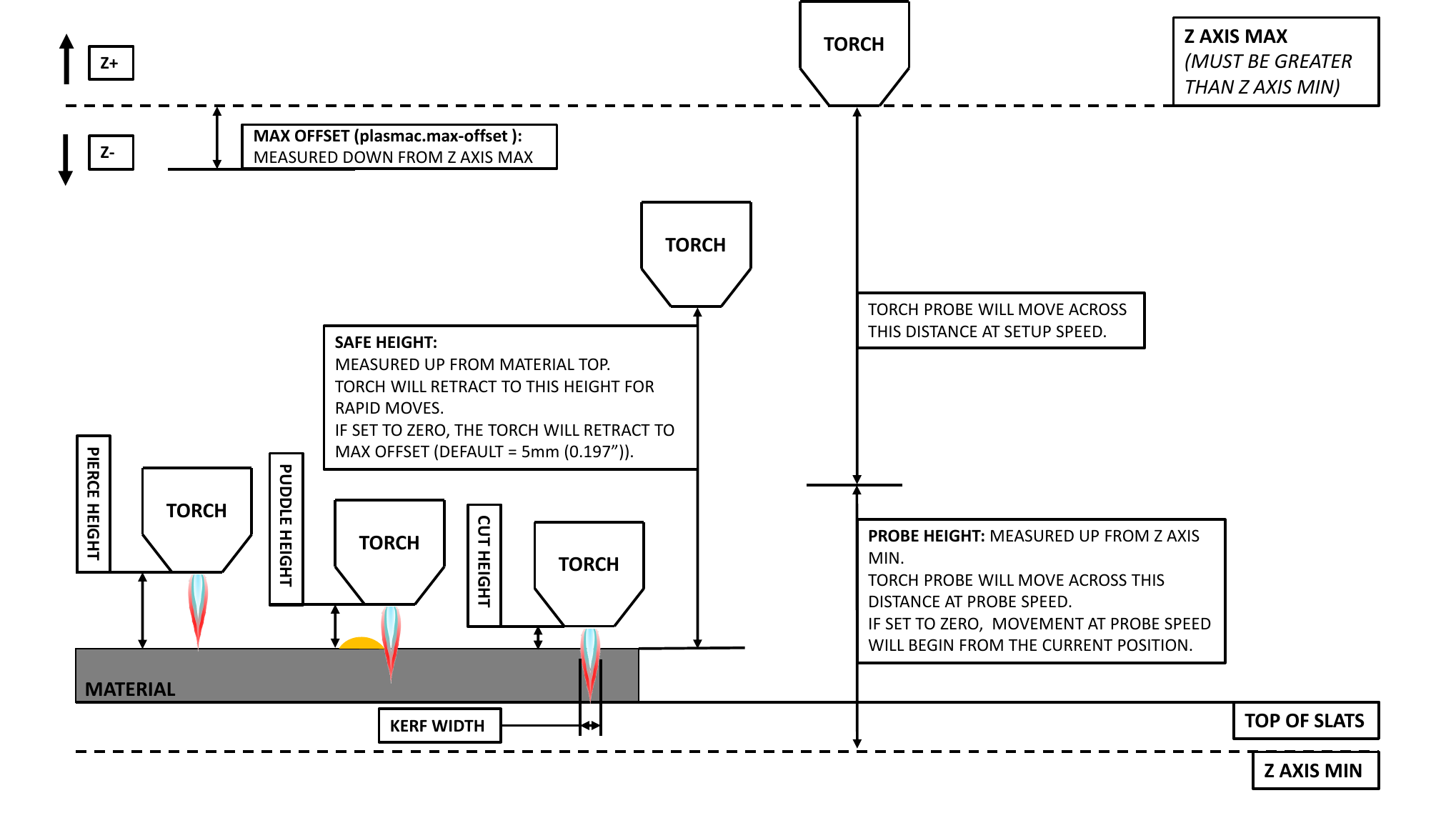

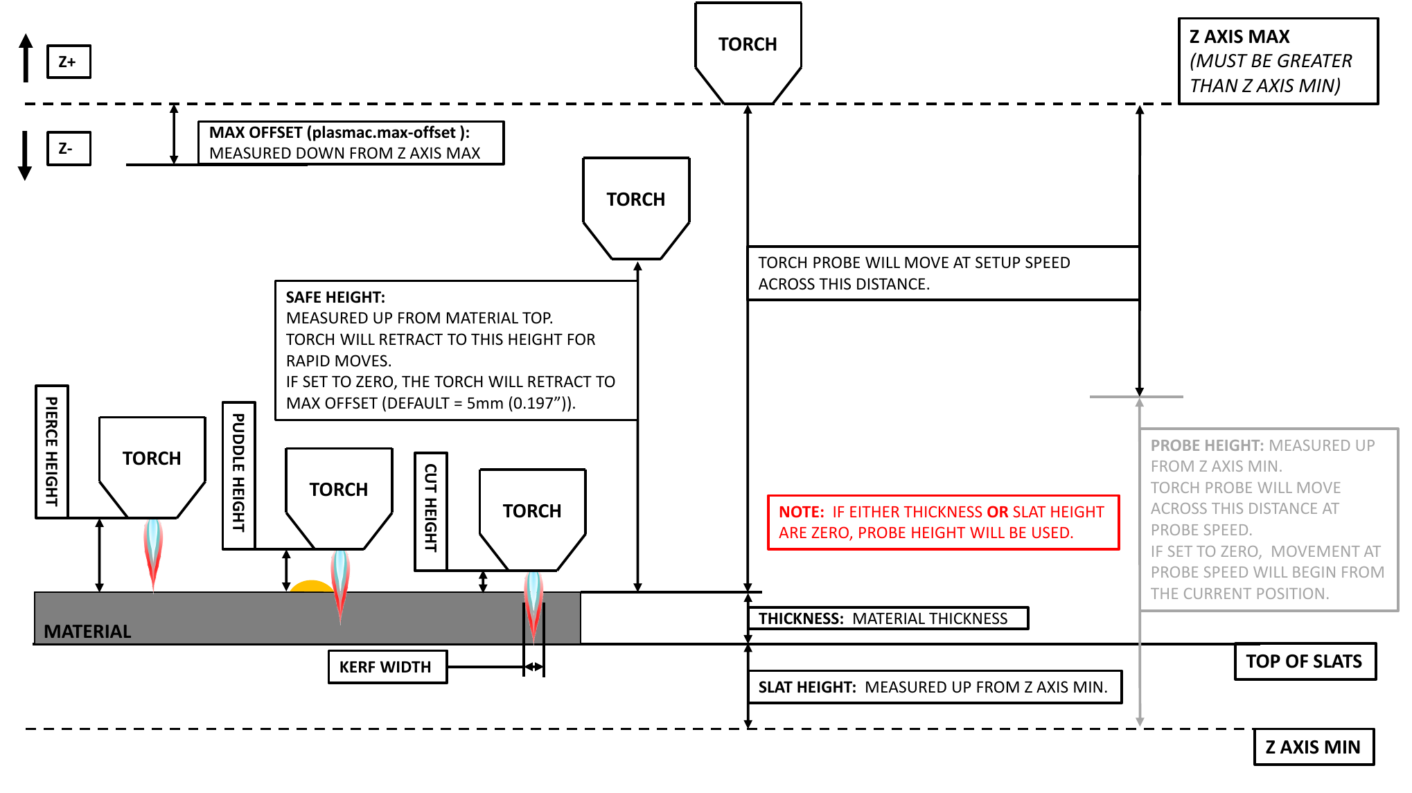

Refer to the Heights Diagrams for a visual representation of the terms below.
  • [AXIS_Z] MIN_LIMIT should be just below top of the slats with allowances for float_switch_travel and over travel tolerance. For example, if the user’s float switch takes 4 mm (0.157") to activate then set the Z minimum to 5 mm (0.2") plus an allowance for overrun (either calculated using the equation below or allow 5 mm (0.2") below the lowest slat).
  • [AXIS_Z] MAX_LIMIT should be the highest the user wants the Z axis to travel (it must not be lower than Z HOME_OFFSET).
  • [AXIS_Z] HOME should be set to be approximately 5 mm-10 mm (0.2"-0.4") below the maximum limit.
  • Floating Head - it is recommended that a floating head be used and that it has enough movement to allow for overrun during probing. Overrun can be calculated using the following formula:
o = 0.5 * a * (v / a)^2
where: o = overrun, a = acceleration in units/s2 and v = velocity in units/s.
Metric example: given a Z axis MAX_ACCELERATION of 600 mm/s2 and MAX_VELOCITY of 60 mm/s, the overrun would be 3 mm.
Imperial example: given a Z axis MAX_ACCELERATION of 24 in/s2 and MAX_VELOCITY of 2.4 in/s, the overrun would be 0.12 in.
On machines that will utilize an ohmic probe as the primary method of probing, it is highly recommended to install a switch on the floating head as a backup means of stopping Z motion in the event of ohmic probe failure due to dirty surfaces.

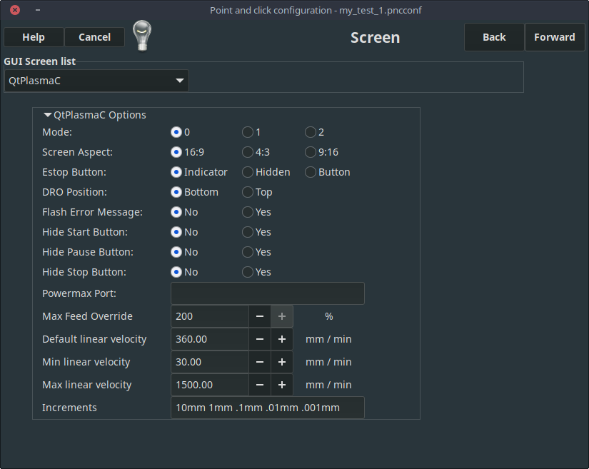

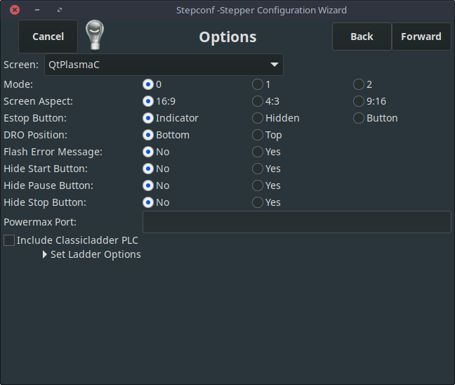

QtPlasmaC adds two pages to the LinuxCNC configuration wizards for QtPlasmaC specific parameters, the two pages are QtPlasmaC options and User Buttons. Complete each of the wizards QtPlasmaC page to suit the machine that is being configured and the user button requirements.
Note that PnCConf options allow user selection of Feed Override, Linear Velocity, and Jog Increments, whereas in StepConf these are automatically calculated and set.
images/qtplasmac_pncconf_screen.png
Figura 4. PnCConf QtPlasmaC Options
images/qtplasmac_stepconf_options.png
Figura 5. StepConf QtPlasmaC Options

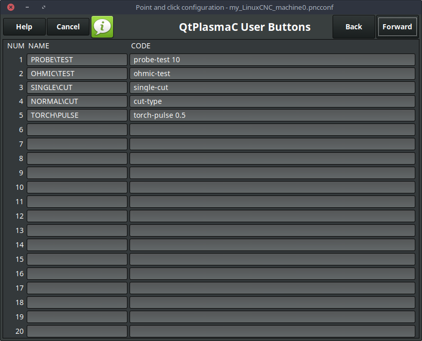

images/qtplasmac_pncconf_buttons.png
Figura 6. QtPlasmaC User Buttons

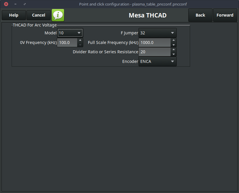

images/qtplasmac_pncconf_thcad.png
Figura 7. QtPlasmaC THCAD
The THCAD screen will only appear if a Plasma Encoder is selected in the card screen. The the dedicated section on Mesa THCAD for more information.

5.6. Initial Setup
The following heights diagrams will help the user visualize the different heights involved in plasma cutting and how they are measured. There are two different scenarios based on if the user chooses to use Probe Height only, or if the user chooses to user Slat Height AND Material Thickness.
images/qtplasmac_heights_diagram_probe_height.png
Figura 8. Probe Height Only
images/qtplasmac_heights_diagram_slat_and_material_height.png
Figura 9. Slat Height and Material Thickness

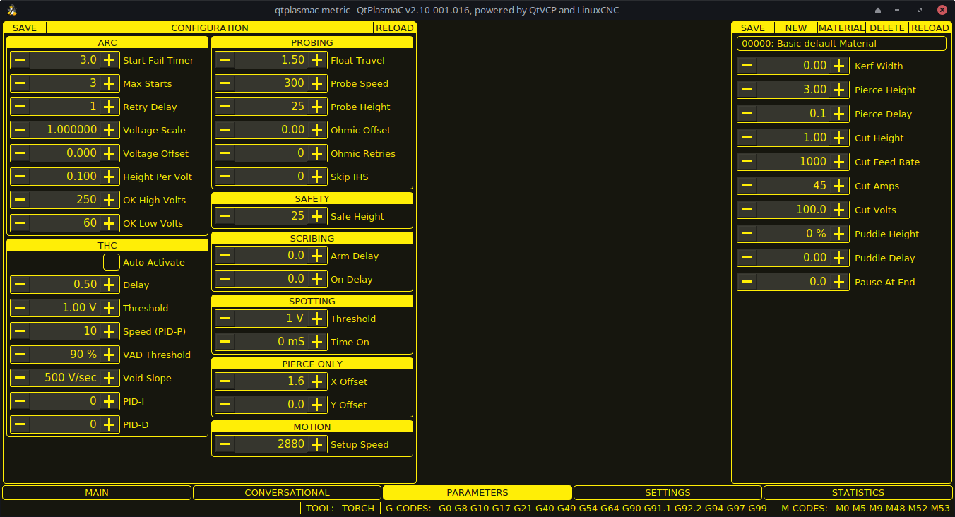

Click on the Parameters Tab to view the CONFIGURATION section which shows the user settable parameters. It is necessary to ensure every one of these settings is tailored to the machine.
To set the Z axis DRO relative to the Z axis MINIMUM_LIMIT, the user should perform the following steps. It is important to understand that in QtPlasmaC, touching off the Z axis DRO has no effect on the Z axis position while running a G-code program. These steps simply allow the user to more easily set the probe height as after performing the steps, the displayed Z axis DRO value will be relative to Z axis MINIMUM_LIMIT.
Nota
The user should be familiar with the recommended Z Axis Settings.
  1. Home the Z axis.
  2. Ensure there is nothing below the torch then jog the Z axis down until it stops at the Z axis MINIMUM_LIMIT then click the 0 next to the Z axis DRO to Touch Off with the Z axis selected to set the Z axis at zero offset. This step only serves to allow the user to more easily visualize and adjust Probe Height this value is measured from the Z axis MINIMUM_LIMIT up.
  3. Lleva el eje Z a casa nuevamente.
Probe Test
If the machine is equipped with a float switch, then the user will need to set the offset in the CONFIGURATION section of the PARAMETERS tab. This will be done by running a "Probe Test" cycle.
  1. Check that the Probe Speed and the Probe Height in the CONFIGURATION section of the PARAMETERS tab are correct. QtPlasmaC can probe at the full Z axis velocity so long as the machine has enough movement in the float switch to absorb any overrun. If the machine is suitable, the user could set the Probe Height to a value near the Z axis minimum and do all probing at full speed.
  2. If the machine is not already homed and in the home position, home the machine.
  3. Place some material on the slats under the torch.
  4. Press the PROBE TEST button.
  5. The Z axis will probe down, find the material then move up to the specified Pierce Height as set by the currently selected material. The torch will wait in this position for the time set in the <machine_name>.prefs file. The default probe test hold time is 10 seconds, this value may be edited in the <machine_name>.prefs file. After this the torch will return to the starting height.
  6. Measure the distance between the material and the tip of the torch while the torch is waiting at Pierce Height.
  7. If the measurement is greater than the Pierce Height of the currently selected material, then reduce the "Float Travel" in the CONFIGURATION section of the PARAMETERS tab by the difference between the measured value and the specified value. If the measurement is less than Pierce Height of the currently selected material, then increase the "Float Travel" in the CONFIGURATION section of the PARAMETERS tab by the difference between the specified value and the measured value.

7.3. Contact Load
Mechanical relays and switches usually require a minimum current passing through the contacts for reliable operation. This current varies with the material that the contacts in the device are made from.
Depending on the specified minimum contact current and the current drawn by the input device there may be a need to provide a method to increase the current through the contacts.
Most relays using gold contacts will not require any additional current for reliable operation.
There are two different methods available to provide this minimum current if it is required:
  1. A 0.1 μF film capacitor placed across the contacts.
  2. A 1200 Ω 1 W resistor across the load (see calculations below).
Schematics are shown at contact load schematics.
More information on contact switching load can be seen on page VI of the finder General Technical Information document.
Calculations:
If using a Mesa card, the input resistance of a 7I96 is 4700 Ω (symbol R)(always consult the product manual associated with the revision being used as these values sometimes vary between revisions), giving a contact current of 5.1 mA (symbol I) assuming a supply voltage (symbol U) of 24 V (I = U/R)
[In the US, the letter V is commonly used as a symbol (Voltage) and as a unit (Volt).]
As an example, the typical relay used in a Hypertherm Powermax 65 plasma cutter (TE T77S1D10-24) requires a minimum contact load of 100 mA @ 5 VDC which will dissipate 0.5 W (P = I * V). If using a 24 VDC power supply this would then equate to a minimum current of 20.8 mA. Because there is less current drawn by the Mesa input than is required by the relay there needs to be an increase in the current.
The resistance can be calculated using R = Us / (Im - Ii) where:
  • R = calculated resistance
  • Us = supply voltage
  • Im = minimum current required
  • Ii = input current
Using a 7I96 with an input current of 5.1 mA gives a calculated value of 1529 Ω ( = 24 V / (.0208 - .0051) A). This could then be rounded down to a commonly available 1500 Ω resistor, giving a small safety margin.
The power dissipation can by calculated using P = Us2 / Rs where:
  • P = power
  • Rs = selected resistance
This gives a value of 0.38 W. This could then be rounded up to 1 W, giving a good safety margin. The final selection would be a 1500 Ω 1 W resistor.

DISPLAY = qtvcp qtplasmac      (use 16:9 resolution)
        = qtvcp qtplasmac_9x16 (use 9:16 resolution)
        = qtvcp qtplasmac_4x3  (use 4:3 resolution)
There are multiple QtVCP options that are described here: QtVCP INI Settings
For example, the following would start a 16:9 resolution QtPlasmaC screen in full screen mode:
DISPLAY = qtvcp -f qtplasmac

8.2. MAIN Tab
Screenshot example of the QtPlasmaC MAIN Tab in 16:9 aspect ratio:
Some functions/features are only used for particular modes and are not displayed if they are not required by the chosen QtPlasmaC mode.
Tabla 1. Features of the PREVIEW WINDOW
Name Descripción
Material
The top header is clickable in this area to reveal a drop-down menu. It is used to manually select the current material cut parameters. If there are no materials in the material file, then only the default material will be displayed.
VEL:
Displays the current feed rate of the table, including both rapid and cutting moves. While cutting, if a Velocity Reduction is active, this label updates to reflect the percentage of the original feed rate being used. For example, "VEL@20%:" means the table is cutting at 20% of the programmed feed rate - an 80% reduction.
FR:
If "View Material" is selected on the SETTINGS Tab, this displays the currently selected material’s Feed Rate.
PH:
If "View Material" is selected on the SETTINGS Tab, this displays the currently selected material’s Pierce Height.
PD:
If "View Material" is selected on the SETTINGS Tab, this displays the currently selected material’s Pierce Delay.
CH:
If "View Material" is selected on the SETTINGS Tab, this displays the currently selected material’s Cut Height.
CA:
If "View Material" is selected on the SETTINGS Tab, and RS485 communications are enabled, this displays the currently selected material’s Cut Amperage.
T
This button changes the preview to a top down full table view.
P
This button changes the preview to an isometric view.
Z
This button changes the preview to a top down view.
This button pans the preview right.
This button pans the preview left.
This button pans the preview up.
This button pans the preview down.
This button zooms the preview.
C
This button clears the live plot.
Tabla 2. MACHINE representation
Name Descripción
ESTOP
Setting Estop type = 0 in the [GUI_OPTIONS] section of the <machine_name>.prefs file, will change this button to an indicator of the hardware E-stop’s status only. This is the default behavior.
Setting the option Estop type = 1 in the [GUI_OPTIONS] section of the <machine_name>.prefs file, will hide this button.
Setting the option Estop type = 2 in the [GUI_OPTIONS] section of the <machine_name>.prefs file, will enable this button to act as a GUI E-stop.
POWER
This button turns the GUI on and allows QtPlasmaC/LinuxCNC to control the hardware.
Pressing and holding the POWER button for longer than two seconds will bring up a dialog to exit the QtPlasmaC application.
CYCLE START
This button starts the cycle for any loaded G-code file.
CYCLE PAUSE
This button pauses the cycle for any loaded G-code file.
If a cycle is paused, this button will display CYCLE RESUME and flash.
Pressing CYCLE RESUME will resume the cycle.
CYCLE STOP
This button stops any actively running or paused cycle.
This includes:
- G-code Programs
- Torch pulse if the pulse was started during CYCLE PAUSE (this will cancel the paused G-code program execution as well)
- Probe Test
- Framing
- Manual Cut
FEED
This slider overrides the feed rate for all feed moves.
Any value other than 100% will cause the label to flash.
Clicking the label will return the slider to 100%.
RAPID
This slider overrides the rapid rate for all rapid moves.
JOG
This slider sets the jog rate.
Clicking the label will return the slider to the default linear velocity as set in the <machine_name>.ini file.
BUTTONS
The Button Panel contains buttons useful for the operation of the machine.
The EDIT and MDI buttons are permanent, all other buttons are user programmable in the <machine_name>.prefs file.
See custom user buttons for detailed information on custom user buttons.
Name Descripción
EDIT
This button opens a G-code editor for the currently loaded program.
MDI
This button places QtPlasmaC into Manual Data Input (MDI) mode which will display the MDI HISTORY and an entry box over top of the G-code window.
Once pressed, this button will display "MDI CLOSE".
Pressing MDI CLOSE will close the MDI.
Please see the MDI section for additional MDI information.
OHMIC TEST
This button will enable the Ohmic Probe Enable output signal and if the Ohmic Probe input is sensed, the LED indicator in the SENSOR Panel will light.
The main purpose of this is to allow a quick test for a shorted torch tip.
PROBE TEST
This button will initiate a Probe Test.
SINGLE CUT
This button will show the dialog box to start an automatic Single Cut.
NORMAL CUT
This button will toggle between Cut Types (NORMAL CUT and PIERCE ONLY).
TORCH PULSE
This button will initiate a Torch Pulse.
Tabla 3. ARC
Name Modes Descripción
Arc Voltage
0, 1
Displays the actual arc voltage.
OK
0, 1, 2
Indicates the status of the Arc OK signal.
0, 1
Each press of this button will raise the target voltage by the THC Threshold voltage (The distance changed will be Height Per Volt * THC Threshold voltage).
0, 1
Each press of this button will lower the target voltage by the THC Threshold voltage (The distance changed will be Height Per Volt * THC Threshold voltage).
OVERRIDE
0, 1
Clicking this label will return any voltage override to 0.00.
Tabla 4. CONTROL
TORCH ON
0, 1, 2
Indicates the status of the Torch On output signal.
TORCH ON ENABLE
0, 1, 2
This box toggles between Enabling and Disabling the torch.
This box defaults to unfilled (disabled) when QtPlasmaC is first run.
This box must be filled to change it to "Torch Enabled" before material cutting can commence.
If this box is not filled, then running a loaded program will cause the machine to run the cycle without firing the torch. This is sometimes referred to as a "dry run". If the user has a laser installed, then it is also possible to dry run with the laser. See the LASER section for detailed instructions.
VELOCITY ANTI DIVE
0, 1, 2
Indicates that the THC is locked at the current height due to the cut velocity falling below the Velocity Anti Dive (VAD) Threshold percentage set on the PARAMETERS Tab.
VELOCITY ANTI DIVE ENABLE
0, 1, 2
This box toggles between Enabling and Disabling VELOCITY ANTI DIVE.
VOID ANTI DIVE
0, 1
Indicates that the THC is locked due to a void being sensed.
VOID ANTI DIVE ENABLE
0, 1
This box toggles between Enabling and Disabling VOID ANTI DIVE.
MESH MODE
0, 1, 2
This box will enable or disable Mesh Mode for the cutting of expanded metal. This check box may be enabled or disabled at any time during normal cutting.
Mesh mode:
- Will require an Arc OK signal to start machine motion.
- Will disable the THC.
- Will not stop machine motion if the Arc OK signal is lost.
- Will automatically select CPA mode if PowerMax communications are being used.
For more information see Mesh Mode (expanded metal).
AUTO VOLTS
0, 1
This box will enable or disable Auto Volts.
IGNORE OK
0, 1, 2
This box will determine if QtPlasmaC ignores the Arc OK signal. This check box may be enabled or disabled at any time during normal cutting. Additionally, this mode may be enabled or disabled via proper M codes in a running program.
Ignore Arc OK mode:
- Will not require an Arc OK signal be received before starting machine motion after the "Torch On" signal is given.
For more information see Ignore Arc Ok.
OHMIC PROBE
0, 1, 2
This box enables or disables the ohmic probe input.
If the Ohmic Probe input is disabled, the Ohmic Probe LED will still show the status of the probe input, but the Ohmic Probe results will be ignored.
RS485
0, 1, 2
This box will enable or disable the communications to a PowerMax. This button is only visible if a PM_PORT option is configured in the [POWERMAX] section of the <machine_name>.prefs file.
Status
0, 1, 2
When PowerMax communications are enabled, this will display one of the following:
CONNECTING, CONNECTED, COMMS ERROR, or a Fault Code.
For more information, see the PowerMax Communications section.
Tabla 5. SENSOR
Name Descripción
FLOAT
Indicates that the float switch is activated.
OHMIC
Indicates that the probe has sensed the material.
BREAK
Indicates that the torch breakaway sensor is activated.
Tabla 6. THC
Name Descripción
ENABLE
This box determines whether the THC will be enabled or disabled during a cut.
ENABLED
This LED indicates whether the THC is enabled or disabled.
ACTIVE
This LED indicates that the THC is actively controlling the Z axis.
UP
This LED indicates that the THC is commanding the Z axis to raise.
DOWN
This LED indicates that the THC is commanding the Z axis to lower.
Nota
JOGGING
During Paused Motion, this section will become CUT RECOVERY
Name Descripción
CONTINUOUS
This drop-down button will change the jog increment. Options are determined by the values in the [DISPLAY] section of the <machine_name>.ini file and begin with the label "INCREMENTS =".
FAST
This button will toggle between FAST which is the default linear velocity in the <machine_name>.ini file or SLOW which is 10% of the default value.
Y+
Este botón mueve el eje Y en dirección positiva.
Y-
Este botón mueve el eje Y en dirección negativa.
X+
Este botón mueve el eje X en dirección positiva.
X-
Este botón mueve el eje X en dirección negativa.
Z+
Este botón mueve el eje Z en dirección positiva.
Z-
Este botón mueve el eje Z en dirección negativa.
Nota
CUT RECOVERY
During Paused Motion, this section will be shown on top of the JOGGING panel. The following section will cover each button encountered in this panel. Please see CUT RECOVERY for a detailed description of the cut recovery functionality.
Name Descripción
PAUSED MOTION FEED SLIDER
In the event of a paused program, this interface allows X/Y motion to follow the programmed path in the reverse or forward direction.
This slider’s range is from 1%-100% of the Cut Feed Rate for the currently selected material.
FEED
This displays the paused motion feed rate.
REV
In the event of a paused program, this button will move the machine in reverse along the programmed path until it reaches the last M3 command that was either executed or that QtPlasmaC was attempting to execute before the program became paused.
FWD
In the event of a paused program, this button will move the machine forward along the programmed path indefinitely until the program’s end, skipping over M3 commands.
CANCEL MOVE
This button will cancel any Cut Recovery movement that was made and return the torch to the position the Cut Recovery movement was initiated.
Note that if FWD or REV were used to move the torch, CANCEL will not return to the position of the torch when the pause occurred.
MOVE x.xxx
This displays the amount of travel that will be incurred with each press of an arrow key, in the direction the arrow key was pressed.
This value displayed below MOVE represents the Kerf Width of the currently selected material.
DIRECTIONAL ARROWS
These buttons will move the torch in the direction indicated by a distance of one Kerf Width (of the currently selected material) per press.
Tabla 7. G-CODE WINDOW
Name Descripción
CLEAR
This button will clear the currently opened program.
If a file is open, the default material will be selected.
If no file is open, the preview will be reset to a top down full table view.
The torch (T0) will be selected if it was not the active tool.
Previous error messages, and the error status will be cleared.
Cut type will be set to NORMAL CUT.
OPEN
This button will open a FILE OPEN panel over the PREVIEW WINDOW.
RELOAD
Este botón recargará el archivo de código G cargado actualmente.
Tabla 8. DRO
Name Descripción
HOME ALL
This button will home all of the axes in the order set by HOME_SEQUENCE in the <machine_name>.ini file.
WCS G54
Esta lista desplegable cambiará el offset de trabajo actual.
CAMERA
This button will display a CAMVIEW panel on top of the PREVIEW WINDOW and will allow the user to set an origin with or without rotation. See the CAMERA section for detailed instructions. This button will not be visible until a CAMERA offset is set in the <machine_name>.prefs file.
LASER
This button will allow the user to use a laser to set an origin with or without rotation. See the LASER section for detailed instructions. This button will not be visible until a LASER offset is set in the <machine_name>.prefs file.
X0 Y0
Este botón establecerá la posición actual a X0 Y0.
HOME [AXIS]
This button will home the corresponding axis.
0 [AXIS]
This drop-down button will display the following options:
Zero - zeros the axis.
Set - launches a dialog box to manually input the axis' coordinate.
Divide By 2 - divides the currently displayed coordinate in the DRO by two.
Set To Last - sets the axis to the previously set coordinate.

8.5. PARAMETERS Tab
Screenshot example of the QtPlasmaC PARAMETERS Tab in 16:9 aspect ratio:
images/qtplasmac_parameters.png
This tab is used to display configuration parameters that are modified infrequently.
It is possible to hide this tab so machine settings cannot be modified by unauthorized personnel. This may be achieved either by wiring the pin to a physical key-switch or similar or it may also be set in a HAL file using the following command:
setp qtplasmac.param_disable 1
Tabla 9. CONFIGURATION - ARC
Start Fail Timer
0, 1, 2
This sets the amount of time (in seconds) QtPlasmaC will wait between commanding a "Torch On" and receiving an Arc OK signal before timing out and displaying an error message.
Max Starts
0, 1, 2
This sets the number of times QtPlasmaC will attempt to start the arc.
Retry Delay
0, 1, 2
This sets the time (in seconds) between an arc failure and another arc start attempt.
Voltage Scale
0, 1
This sets the arc voltage input scale and is used to display the correct arc voltage.
For initial setup, see Calibration Values.
Voltage Offset
0, 1
This sets the arc voltage offset and is used to display zero volts when there is zero arc voltage input.
Height Per Volt
0, 1, 2
This sets the distance the torch would need to move to change the arc voltage by one volt.
Used for manual height manipulation only.
OK High Volts
0
This sets the voltage threshold below which Arc OK signal is valid.
OK Low Volts
0
This sets the voltage threshold above which the Arc OK signal is valid.
Nota
When setting the OK Low Volts and OK High Volts in Mode 0, the cut voltage of a stable arc must be greater than the OK Low Volts value but lower than the OK High Volts value for QtPlasmaC to receive a valid Arc OK signal. To further clarify, to have a valid Arc OK, the arc voltage must fall between the two limits.
Tabla 10. CONFIGURATION - PROBING
Name Descripción
Float Travel
This sets the amount of travel the float switch moves before completing the float switch circuit. This distance can be measured by using the Probe Test button, and the method described in Initial Setup.
Probe Speed
This sets the speed at which the torch will probe to find the material after it moves to the Probe Height.
Probe Height
This sets the height above the Z axis minimum limit that Probe Speed begins. If set to zero, then the torch will move at Probe Speed from the current position. This may be adventageous when using Slat Height and Material Thickness as the machine will default to Probe Height if either Slat Height or Material Thickness are zero. Refer to the Heights Diagrams for a visual representation.
Slat Height
This sets the height of the slats, measured up from Z axis minimum limit. This must be used in conjunction with Material Thickness. If either Slat Height or Material Thickness are zero then the machine will default to Probe Height. Refer to the Heights Diagrams for a visual representation.
Ohmic Offset
This sets the distance above the material the torch will should go after a successful ohmic probe. It is mainly used to compensate for high probing speeds.
Ohmic Retries
This sets the number of times QtPlasmaC will retry a failed ohmic probe before falling back to the float switch for material detection.
Skip IHS
This sets the distance threshold used to determine if an Initial Height Sense (probe) can be skipped for the current cut, see IHS Skip.
Offset Speed
This sets the speed at which the probe will move to the offset position in the X axis and Y axis.
Nota
If the amount of time between the torch contacting the material and when the torch moves up and comes to rest at the Pierce Height seems excessive, see the probing section for a possible solution.
Tabla 11. CONFIGURATION - SAFETY
Name Descripción
Safe Height
This sets the height above the material that the torch will retract to before executing rapid moves.
If set to zero, then Max Offset (plasmac.max-offset) will be used for the safe height. This defaults to 5mm (0.197"). Refer to the Heights Diagrams for a visual representation.
Tabla 12. CONFIGURATION - SCRIBING
Name Descripción
Arm Delay
This sets the delay (in seconds) from the time the scribe command is received to the activation of the scribe. This allows the scribe to reach surface of the material before activating the scribe.
On Delay
This sets the delay (in seconds) to allow the scribe mechanism to start before beginning motion.
Tabla 13. CONFIGURATION - SPOTTING
Name Descripción
Threshold
This sets the arc voltage at which the delay timer will begin.
0 V starts the delay when the torch on signal is activated.
Time On
This sets the length of time (in milliseconds) the torch is on after threshold voltage is reached.
Tabla 14. CONFIGURATION - PIERCE ONLY
Name Descripción
X Offset
Moves the pierce point this distance along the X axis when piercing in Pierce Only mode.
Y Offset
Moves the pierce point this distance along the Y axis when piercing in Pierce Only mode.
Tabla 15. CONFIGURATION - MOTION
Name Descripción
Setup Speed
The Z axis velocity for setup moves (movements to Probe Height, Pierce Height, Cut Height, etc.).
Nota
Setup Speed has no effect on THC speed which is capable of the velocity displayed in the Max. Speed field.
Tabla 16. CONFIGURATION - THC
Delay
0, 1, 2
This sets the delay (in seconds) measured from the time the Arc OK signal is received until Torch Height Controller (THC) activates. This is only available when Auto THC is not enabled.
Sample Counts
0, 1
This sets the number of consecutive arc voltage readings within THC Sample Threshold required to activate the Torch Height Controller (THC). This is only available when Auto THC is enabled.
Sample Threshold
0, 1
This sets the maximum voltage deviation allowed for THC Sample Counts. This is only available when Auto THC is enabled.
Threshold
0, 1
This sets the voltage variation allowed from the target voltage before for THC makes movements to correct the torch height.
Speed (PID-P)
0, 1, 2
This sets the Proportional gain for the THC PID loop. This roughly equates to how quickly the THC attempts to correct changes in height.
VAD Threshold
0, 1, 2
(Velocity Anti Dive) This sets the percentage of the current cut feed rate the machine can slow to before locking the THC to prevent torch dive.
Void Slope
0, 1
(Void Anti Dive) This sets the size of the change in cut voltage per seconds necessary to lock the THC to prevent torch dive (higher values need greater voltage change to lock THC).
PID-I
0, 1
This sets the Integral gain for the THC PID loop. Integral gain is associated with the sum of errors in the system over time and is not always needed.
PID-D
0, 1
This sets the Derivative gain for the THC PID loop. Derivative gain works to dampen the system and reduce over correction oscillations and is not always needed.
Two methods of THC activation are available and are selected with the Auto Activation check-button. Both methods begin their calculations when the current velocity of the torch matches the cut feed rate specified for the selected material:
  1. Delay Activation (the default) is selected when Auto Activation is unchecked. This method uses a time delay set with the Delay parameter.
  2. Auto Activation is selected when Auto Activation is checked. This method determines that the arc voltage is stable by using the Sample Counts and Sample Threshold parameters.
Nota
PID loop tuning is a complicated process and is outside the scope of this User Guide. There are many sources of information available to assist with understanding and tuning PID loops. If the THC is not making corrections fast enough, it is recommended to increase the P gain in small increments until the system operates favorably. Large P gain adjustments can result in over correction and oscillations.
SAVE & RELOAD Buttons
The SAVE button will save the currently displayed parameters to the <machine_name>.prefs file.
The RELOAD button will reload all the parameters from the <machine_name>.prefs file.
Tabla 17. MATERIAL - The parameters which are active for the current cut.
Name Descripción
Material
The top drop-down menu is used to manually select the current material cut parameters. If there are no materials in the material file, then only the default material will be displayed.
Thickness
This sets the thickness for the currently selected material. This must be used in conjunction with Slat Height. If either Slat Height or Material Thickness are zero then the machine will default to Probe Height. Refer to the Heights Diagrams for a visual representation.
Kerf Width
This sets the kerf width for the currently selected material. Refer to the Heights Diagrams for a visual representation.
Pierce Height
This sets the pierce height for the currently selected material. Refer to the Heights Diagrams for a visual representation.
Pierce Delay
This sets the pierce delay (in seconds) for the currently selected material.
Cut Height
This sets the cut height for the currently selected material. Refer to the Heights Diagrams for a visual representation.
Cut Feed Rate
This sets the cut feed rate for the currently selected material.
Cut Amps
This sets the cut amperage for the currently selected material.
This is a visual indicator to the operator only, unless PowerMax communications are being used.
Cut Volts
This sets the cut voltage for the currently selected material.
Puddle Height
Expressed as a percentage of Pierce Height, this sets the Puddle Jump height for the currently selected material.

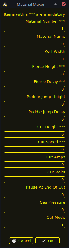

The NEW button will allow a new material to be added to the material file. The user will be prompted for a material number and a material name, all other parameters will be read from the currently selected material. Once entered, QtPlasmaC will reload the material file and display the new material. The Cut Parameters for the new material will then need to be adjusted and saved.

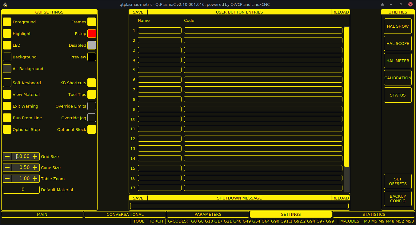

8.6. SETTINGS Tab
Screenshot example of the QtPlasmaC SETTINGS Tab in 16:9 aspect ratio:
images/qtplasmac_settings.png
This tab is used to display GUI configuration parameters, button text, and shutdown text that are modified infrequently as well as some utility buttons.
setp qtplasmac.settings_disable 1
GUI SETTINGS
This section shows parameters that effect the GUI appearance and GUI behaviors.
To return any of the color changes to their default values, see the Returning To The Default Styling section.
Tabla 18. GUI SETTINGS Parameters that effect the GUI appearance and GUI behaviors.
Name Descripción
Foreground
This button allows the user to change the color of the GUI Foreground.
Highlight
This button allows the user to change the color of the GUI Highlight.
LED
This button allows the user to change the color of the GUI LED.
Background
This button allows the user to change the color of the GUI Background.
Alt Background
This button allows the user to change the color of the GUI Alternate Background.
Frames
This button allows the user to change the color of the GUI Frames.
Estop
This button allows the user to change the color of the GUI Estop.
Disabled
This button allows the user to change the color of the GUI’s Disabled features.
Preview
This button allows the user to change the color of the GUI Preview Window Background.
Soft Keyboard
This radio button allows the user to enable or disable the soft touchscreen keyboard.
If the "onboard" virtual keyboard is installed then the custom layouts will be enabled.
KB Shortcuts
This radio button allows the user to enable or disable Keyboard Shortcuts within the GUI (such as keyboard jogging).
In addition to the standard jog keys, a list of the additional shortcuts is available in the keyboard shortcuts section.
View Material
This radio button allows the user to enable or disable the addition of a visual reference showing key material cut settings to the Preview Windows of the MAIN and CONVERSATIONAL tabs.
Examples are: Feed Rate, Pierce Height, Pierce Delay, and Cut Height. Cut Amps will be shown if PowerMax communications are enabled.
Exit Warning
This radio button allows the user to enable or disable whether a warning will always be displayed during shutdown.
It is possible to add a custom message to the warning by editing the EXIT WARNING MESSAGE option in the [GUI_OPTIONS] section of the <machine_name>.prefs file.
The custom message can be made multi-line by adding a "\" between lines.
Parada opcional
This radio button allows the user to enable or disable whether or not a running program will pause at an M1 command.

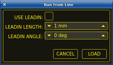

Run From Line
This radio button allows the user to enable or disable Run From Line. If enabled, the user can click on a line of G-code and have the program start from that line.
Override Limits
This radio button allows the user to temporarily Override the input from a Limit Switch in the event the limit switch becomes tripped during operation. This button can only be clicked when a limit switch is tripped.
Override Jog
This radio button will also allow jogging while jogging is inhibited due to a float switch, breakaway switch, or ohmic probe activation. This button can only be clicked when a jog is inhibited.
Bloqueo opcional
This radio button allows the user to enable or disable whether or not lines starting with "/" will be skipped if present in a running program.
Grid Size
This allows a user to change the size of the grid in the Preview Window on the MAIN Tab. Grid size of 0.0 will disable the grid.
Cone Size
This allows a user to change the size of the cone (which represents the current tool) in the Preview Window on the MAIN Tab.
Table Zoom
This allows a user to change the default zoom level for the top down full table view in the Preview Window on the MAIN Tab.
USER BUTTON ENTRIES USERBUTTON
This section shows the text that appears on the Custom User Buttons as well as the code associated with the user button. User buttons may be changed, and the new settings used without restarting LinuxCNC.
The text and/or code may be edited at any time and will be loaded ready for use if the SAVE button is clicked.
Deleting the Name and Code text will cause that user button to be hidden if the SAVE button is clicked.
To return all the Name and Code text to their last saved values press the RELOAD button.
Name Código
The text that is displayed on the button
The code that is run when the button is pressed.
Nota
There are 20 user buttons available but not all may be displayed depending on the window size.
This section shows the text that appears on the shutdown dialog if the Exit Warning is enabled.
The text may be edited at any time and will be loaded ready for use if the SAVE button is clicked.
To return the EXIT WARNING MESSAGE text to the last saved value press the RELOAD button.
UTILITIES
Some standard LinuxCNC utilities are provided as an aid in the diagnosis of issues that may arise:
In addition the following two QtPlasmaC specific utilities are provided:

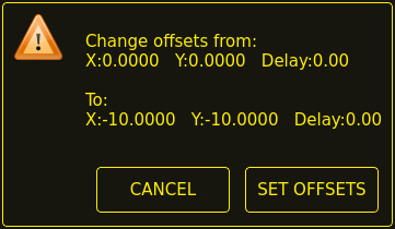

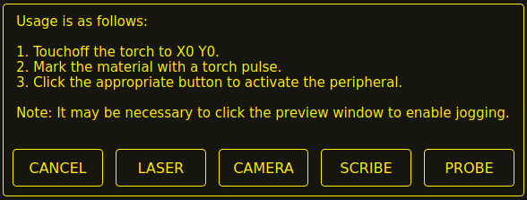

The SET OFFSETS button is used if the table has a laser or camera for sheet alignment, a scribe, or uses offset probing. The required offsets for these peripherals need to be applied by following the procedure described in Peripheral Offsets.
The BACKUP CONFIG button will create a complete machine configuration backup for archiving or to aid in fault diagnosis. A compressed backup of the machine configuration will be saved in the user’s Linux home directory. The file name will be <machine_name><version><date>_<time>.tar.gz, where <machine_name> is the machine name entered in the configuration wizard, <version> is the current QtPlasmaC version the user is on, <date> is the current date (YY-MM-DD), and <time> is the current time (HH-MM-SS).
Prior to the backup being made, the machine log will be saved to a file in the configuration directory named machine_log_<date>_<time>.txt where <date> and <time> are formatted as described above. This file along with up to five previous machine logs will also be included in the backup.
These files are not required by QtPlasmaC and are safe to delete at any time.

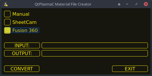

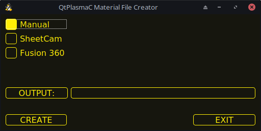

9.10. Material Converter
This application is used to convert existing tool tables into QtPlasmaC material files. It can also create a material file from manual user input to entry fields.
At this stage the only conversions available are for tool tables exported from either SheetCam or Fusion 360.
SheetCam tool tables are complete, and the conversion is fully automatic. The SheetCam tool file must be in the SheetCam .tools format.
Fusion 360 tool tables do not have all of the required fields so the user will be prompted for missing parameters. The Fusion 360 tool file must be in the JSON format of Fusion 360.
If the user has a format from a different CAM software they would like converted, create a New Topic in the PlasmaC forum section of the LinuxCNC forum to request this addition.
El Convertidor de Material puede ejecutarse desde una terminal usando uno de los dos métodos siguientes.
For a package installation (Buildbot) enter the following command in a terminal window:
qtplasmac-materials
For a run in place installation enter the following two commands in a terminal window:
source ~/linuxcnc-dev/scripts/rip-environment
qtplasmac-materials
This will bring up the Material Converter Main dialog box with Manual selected as the default.

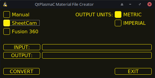

Seleccione uno de:
  • Manual - to manually create a new material file.
images/qtplasmac_material_main_manual.png
  • SheetCam - to convert a SheetCam tool file.
images/qtplasmac_material_main_sheetcam.png
For SheetCam only, select whether the user requires a metric or imperial output file.
  • Fusion 360 - to convert a Fusion 360 tool file.
images/qtplasmac_material_main_fusion360.png
Para convertir:
  1. Select the Input File to be converted, press INPUT to bring up a file selector or directly enter the file in the entry box.
  2. Select the Output File to write to, press OUTPUT to bring up a file selector or directly enter the file in the entry box. This would normally be ~/linuxcnc/configs/<machine_name>_material.cfg. If necessary, the user could select a different file and hand edit the <machine_name>_material.cfg file.
  3. Click CREATE/CONVERT and the new material file will be created.
For both a Manual creation or a Fusion 360 conversion, a dialog box will show with all available parameters displayed for input. Any entry marked with *** is mandatory and all other entries are optional depending on the user’s configuration needs.
images/qtplasmac_material_manual_dialog.png
Nota
If the user selects ~/linuxcnc/configs/<machine_name>_material.cfg and the file already exists, it will be overwritten.
9.11. LASER
QtPlasmaC has the ability to use a laser to set the origin with or without rotation compensation. Rotation compensation can be used to align the work offset to a sheet of material with edge(s) that are not parallel to the machine’s X/Y axes. The LASER button will be enabled after the machine is homed. This button will not be visible until a LASER offset is set in the <machine_name>.prefs file.
To use this feature, the user must set the laser’s offset from the torch center by following the procedure described in Peripheral Offsets.
To modify the offsets manually, the user could edit either or both the following options in the [LASER_OFFSET] section of the <machine_name>.prefs file:
X axis = n.n
Y axis = n.n
where n.n is distance from the center line of the torch to the laser’s cross hairs.
Additionally, the laser can be tied to any available output to turn the laser on and off via a HAL pin with the following name:
qtplasmac.laser_on
To set the origin with zero rotation:
  1. Click the LASER button.
  2. LASER button label will change to MARK EDGE and the HAL pin named qtplasmac.laser_on will be turned on.
  3. Jog until the laser cross hairs are on top of the desired origin point.
  4. Press MARK EDGE. The MARK EDGE button label will change to SET ORIGIN.
  5. Press SET ORIGIN. The SET ORIGIN button label will change to MARK EDGE and the HAL pin named qtplasmac.laser_on will be turned off.
  6. The torch will now move to the X0 Y0 position.
  7. The offset is now successful set.
To set the origin with rotation:
  3. Jog until the laser cross hairs are at the edge of the material a suitable distance away from the desired origin point.
  5. Jog until the laser cross hairs are at the origin point of the material.
  6. Press SET ORIGIN. The SET ORIGIN button label will change to MARK EDGE and the HAL pin named qtplasmac.laser_on will be turned off.
  7. The torch will now move to the X0 Y0 position.
  8. The offset is now successfully set.
To turn the laser off and cancel an alignment:
  1. Press the LASER button and hold for longer than 750 ms.
  2. LASER button label will change to LASER and the HAL pin named qtplasmac.laser_on will be turned off.
  3. Release the LASER button.
If an alignment laser has been set up then it is possible to use the laser during CUT RECOVERY for accurate positioning of the new start coordinates.
To dry run the G-code file with the laser: . Ensure there are no bounds errors and CYCLE START is enabled. . Press the LASER button and hold for longer than 750 ms, the laser will turn on and the dry run will start. . Release the LASER button.
9.12. CAMERA
images/qtplasmac_camview.png
QtPlasmaC has the ability to use a USB camera to set the origin with or without rotation compensation. Rotation compensation can be used to align the work offset to a sheet of material with edge(s) that are not parallel to the machine’s X/Y axes. The CAMERA button will be enabled after the machine is homed. This button will not be visible until a CAMERA offset is set in the <machine_name>.prefs file.
To use this feature, the user must set the camera’s offset from the torch center by following the procedure described in Peripheral Offsets.
To modify the offsets manually, the user could edit either or both the following axes options in the [CAMERA_OFFSET] section of the <machine_name>.prefs file:
X axis = n.n
Y axis = n.n
Camera port = 0
where n.n is distance from the center line of the torch to the camera’s cross hairs.
  1. Jog until the cross hairs are on top of the desired origin point.
  2. Press MARK EDGE. The MARK EDGE button label will change to SET ORIGIN and the GOTO ORIGIN button will be disabled.
  3. Press SET ORIGIN. The SET ORIGIN button label will change to MARK EDGE and the GOTO ORIGIN button will be enabled.
  4. The torch will now move to the X0 Y0 position.
  5. The offset is now successful set.
  1. Jog until the cross hairs are at the edge of the material a suitable distance away from the desired origin point.
  3. Jog until the cross hairs are at the origin point of the material.
  4. Press SET ORIGIN. The SET ORIGIN button label will change to MARK EDGE and the GOTO ORIGIN button will be enabled.
  5. The torch will now move to the X0 Y0 position.
  6. The offset is now successfully set.
In the CAMVIEW panel, the mouse can affect the cross hairs, and the zoom level as follows:
  • Mouse Wheel Scroll - Change cross hair diameter.
  • Mouse Wheel Button Double Click - Restores cross hair diameter to default.
  • Mouse Left Button Clicked + Wheel Scroll - Changes camera zoom level.
  • Mouse Left Button Clicked + Wheel Button Double Click - Restores default camera zoom level.

9.21. Probing
Probing may be done with either ohmic sensing or a float switch. It is also possible to combine the two methods, in which case the float switch will provide a fallback to ohmic probing. An alternative to ohmic probing is Offset Probing
If the machine’s torch does not support ohmic probing, the user could have a separate probe next to the torch. In this case the user would extend the probe below the torch. The probe must NOT extend more than the minimum Cut Height below the torch and the Z axis offset distance needs to be entered as the Ohmic Offset in the PROBING frame of the CONFIGURATION section of the PARAMETERS Tab.
Probing setup is done in the PROBING frame of the CONFIGURATION section of the PARAMETERS Tab.
QtPlasmaC can probe at the full Z axis velocity so long as the machine has enough movement in the float switch to absorb any overrun. If the machine’s float switch travel is suitable, the user could set the Probe Height to near the Z axis MINIMUM_LIMIT and do all probing at full speed.
Some float switches can exhibit a large switching hysteresis which shows up in the probing sequence as an excessive time to complete the final probe up.
  • This time may be decreased by changing the speed of the final probe up.
  • This speed defaults to 0.001 mm (0.000039") per servo cycle.
  • It is possible to increase this speed by up to a factor of 10 by adding the following line to the custom.hal file:
setp plasmac.probe-final-speed n
where n is a value from 1-10. It is recommended to keep this value as low as possible.
Using this feature will change the final height slightly and will require thorough probe testing to confirm the final height.
This speed value affects ALL probing so if the user uses ohmic probing and the user changes this speed value then the user will need to probe test to set the require offset to compensate for this speed change as well as the float travel.

Offset Probing is the use of a probe that is offset from the torch. This method is an alternative to Ohmic Probing and uses the plasmac.ohmic-enable output pin to operate a solenoid for extending and retracting the probe. The plasmac.ohmic-probe input pin is used to detect the material and the Ohmic Offset in the PROBING frame of the CONFIGURATION section of the PARAMETERS Tab is used to set the correct measured height.
The probe could be a mechanically deployed probe, a permanently mounted proximity sensor or even simply a stiff piece of wire extending about 0.5 mm (0.2") below the torch tip. If the probe is mechanically deployed, then it needs to extend/retract rather quickly to avoid excessive probing times and would commonly be pneumatically operated.
To use this feature, the user must set the probe’s offset from the torch center by following the procedure described in Peripheral Offsets.
To modify the offsets manually, the user could edit either or both the following options in the [OFFSET_PROBING] section of the <machine_name>.prefs file:
X axis = n.n
Y axis = n.n
Delay = t.t
where n.n is the offset of the probe from the torch center in machine units for the X and Y axes and t.t is the time in seconds to allow for any mechanical deployment of the probe if required.
Each of these parameters is optional and also may appear in any order. If a parameter is not detected, then the default is 0.0. There can be no space after the X or Z, lower case is permissible.
When this variable appears in the <machine_name>.prefs file with either X or Y not equal to zero, then QtPlasmaC will do all Ohmic Probing as Offset Probing. If Offset Probing is valid then the feed rate at which the X and Y axes move to the offset position may be adjusted by the use of the Offset Speed parameter in the PROBING frame of the PARAMETERS Tab.
When a probe sequence has begun, the plasmac.ohmic-enable pin will be set True causing the probe to extend. When the material is detected the plasmac.ohmic-enable pin will be reset to false causing the probe to retract.
The probe will begin moving to the offset position simultaneously with the Z axis moving down to the Probe Height, probing will not commence unless the deployment timer has completed. It is required that the Probe Height in the PROBING frame of the CONFIGURATION section of the PARAMETERS Tab is above the top of the material to ensure that the probe is fully offset to the correct X/Y position before the final vertical probe down movement.

9.32. Run From Line
If the user has the Run From Line option enabled in the GUI SETTINGS section of the SETTINGS Tab then they will have the ability to start from any line in a G-code program via the following methods:
  1. Clicking any line in the Preview Window
  2. Clicking any line in the G-code Window
It is important to note that G-code programs can be run from any selected line using this method, however a lead-in may not be possible depending on the line selected. In this case, an error message will be displayed to let the user know the lead-in calculation was not possible.
Once the user has selected the starting place, the CYCLE START button will blink "SELECTED nn" where nn is the corresponding line number selected. Clicking this button will bring up the following Run From Line dialog box:
It is not possible to use Run From Line from within a subroutine. If the user selects a line within a subroutine and clicks "SELECTED nn" then an error message will be displayed that includes the O-code name of the subroutine.
It is not possible to use Run From Line if previous G-code has set cutter compensation active. If the user selects a line while cutter compensation is active and clicks "SELECTED nn" then an error message will be displayed.
It is possible to select a new line while Run From Line is active.
images/qtplasmac_rfl_options.png
9.32.1. HERE TO END
HERE TO END will run from the beginning of the selected line to the end of the G-code file. The user will be presented with the option of adding a lead-in if the selected line falls within an "active" cutting operation (between an M3 and M5).
images/qtplasmac_rfl_here_to_end.png
Name Descripción
USE LEADIN
This radio button will allow the user to start the selected line with a lead-in.
LEADIN LENGTH
If USE LEADIN is selected, this will set the length of the lead in the machine units.
LEADIN ANGLE
If USE LEADIN is selected, this will set the angle of approach for the lead-in.
The angle is measured such that positive increases in value move the lead-in counterclockwise:
0 Degrees = 3 o’clock position
90 Degrees = 12 o’clock position
180 Degrees = 9 o’clock position
270 Degrees = 6 o’clock position
CANCEL
This button will cancel the Run From Line dialog box and any selections.
LOAD
This button will load a temporary "rfl.ngc" program with any selected lead-in parameters applied.
If the lead-in cannot be calculated for the selected line, the following error message will be displayed:
"Unable to calculate a lead-in for this cut
Program will run from selected line with no lead-in applied"
After pressing LOAD, the blinking "SELECTED nn" button will change to RUN FROM LINE CYCLE START button. Click this button to start the program from the beginning of the selected line.

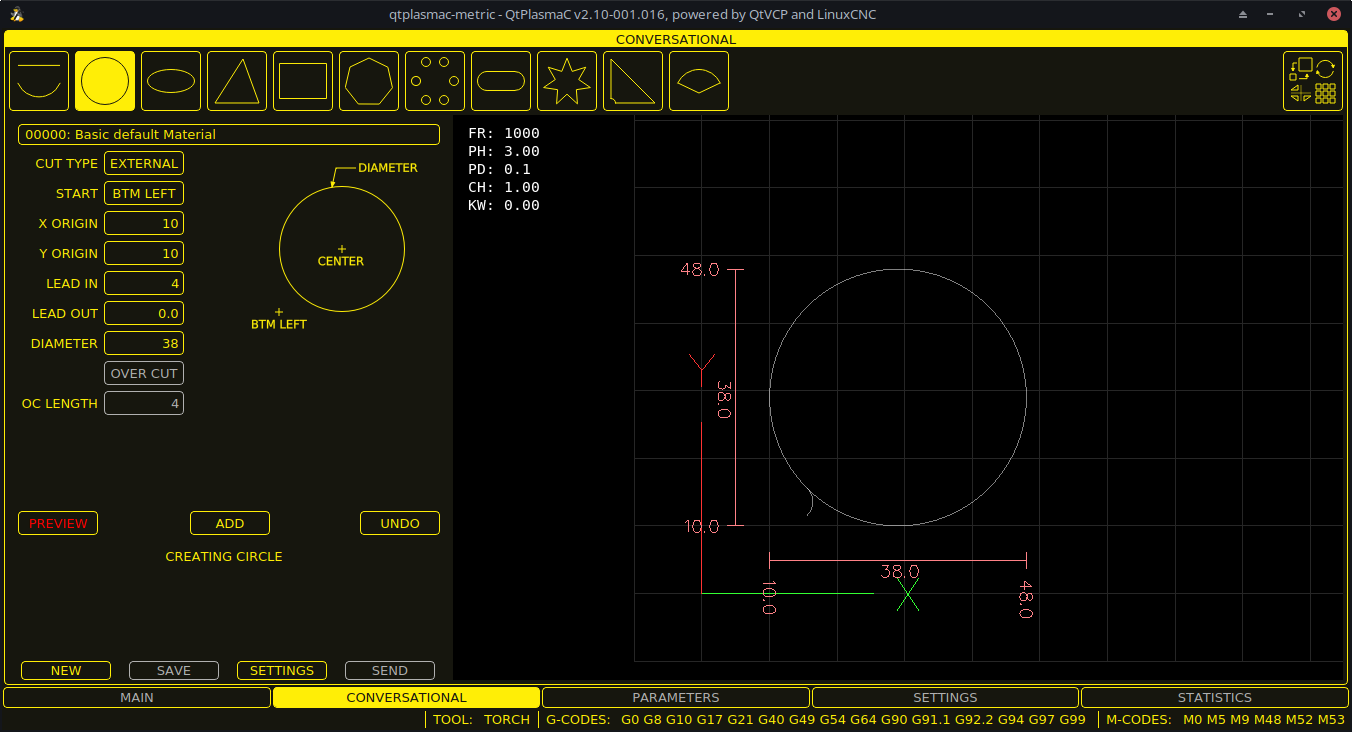

  3. Enter the appropriate values and press PREVIEW to display the shape.
  4. If the shape is not correct, edit the values and press PREVIEW and the new shape will be displayed. Repeat until satisfied with the shape.
  5. Press ADD to add the shape to the G-code file.
  6. Press SEND to send the G-code file to LinuxCNC (QtPlasmaC) for cutting.
For CIRCLE, the OVER CUT button will become valid when a CUT TYPE of INTERNAL is selected and the value entered in the DIAMETER field is less than the Small Hole Diameter parameter in the Conversational SETTINGS section.
For BOLT CIRCLE the OVER CUT button will become valid if the value entered in the HOLE DIA field is less than the SMALL HOLES DIAMETER parameter in the Conversational SETTINGS section.
For the following shapes, KERF OFFSET will become active once a LEAD IN is specified:
  1. TRIANGLE
  2. RECTANGLE
  3. POLYGON
  4. SLOT
  5. STAR
  6. GUSSET
10.4. Conversational Group Of Shapes
Multiple shapes can be added together to create a complex group.
The cut order of the group is determined by the order in which the individual shapes are added to the group.
Once a shape is added to the group it cannot be edited or removed.
Groups cannot have shapes removed, only added to.
To create a group of shapes:
  1. Create the first shape as in Single Shape.
  2. Press ADD and the shape will be added to the group.
  3. If the user wishes to add another version of the same shape, then edit the required parameters and press ADD when satisfied with the shape.
  4. If the user wishes to add a different shape, select that shape and create it as in Single Shape.
  5. Repeat until all the required shapes to complete the group have been added.

The QtPlasmaC GUI offers user buttons that can be customized by adding commands in the USER BUTTON ENTRIES section of the SETTINGS Tab in the <machine_name>.prefs file.
The number of user buttons varies by display type and resolution as follows:
  • 16:9 and 4:3 - Minimum 8, Maximum 20
  • 9:16 - Minimum 15, Maximum 20
The user will need to run QtPlasmaC at the desired screen size to determine how many user buttons are available for use.
All <machine_name>.prefs file settings for the buttons are found in the [BUTTONS] section.

Use the following sequence to set the offsets for a laser, camera, scribe, or offset probe:
  1. Place a piece of scrap material under the torch.
  2. The machine must be homed and idle before proceeding.
  3. Open the SETTINGS tab.
  4. Click the SET OFFSETS button which opens the Set Peripheral Offsets dialog.
    images/qtplasmac_peripheral_offsets_set.png
  5. Click the X0Y0 button to set the torch position to zero.
  6. Make a mark on the material by one of:
    1. Jog the torch down to pierce height then pulse the torch on to make a dimple in the material.
    2. Place marking dye on the torch shield then jog the torch down to mark the material.
  7. Click the appropriate button to activate the peripheral.

  11. Click the GET OFFSETS button to get the offsets and a confirmation dialog will open.
    images/qtplasmac_peripheral_offsets_confirm.png
  12. Click SET OFFSETS and the offsets will now be saved.

15.6. Tuning Mode 0 Arc OK
Mode 0 Arc OK relies on the arc voltage to set the Arc OK signal. This is accomplished by sampling the arc voltage every servo thread cycle. There needs to be a specified number of consecutive samples, all within a specified threshold for the Arc OK signal to be set. These voltages are also required to be within a specified range.
There are two settings in the PARAMETERS Tab for setting the range, these are:
  • OK High Volts which is the upper value of the voltage range. The default is 250 V.
  • OK Low Volts which is the lower value of the voltage range. The default is 60 V.
Both of these values may be changed by direct entry or by the use of the increment/decrement buttons.
There are also two HAL pins that have been provided to allow the user to tune the set point. These HAL pins are:
  • plasmac.arc-ok-counts which is the number of consecutive readings within the threshold that are required to set the Arc OK signal. The default is 10.
  • plasmac.arc-ok-threshold which is the maximum voltage deviation that is allowed for a valid voltage to set the Arc OK signal. The default is 10.
The following example would set the number of valid consecutive readings required to 6:
setp plasmac.arc-ok-counts 6
These settings if used should be in the custom.hal file of the configuration.

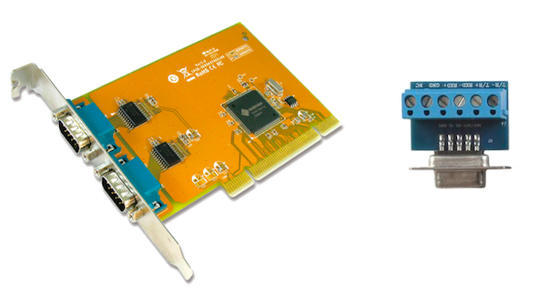

15.15. Hypertherm PowerMax Communications
Communications can be established with a Hypertherm PowerMax plasma cutter that has a RS485 port. This feature enables the setting of Cut Mode, Cutting Amperage and Gas Pressure automatically from the Cut Parameters of the material file. In addition, the user will be able to view the PowerMax’s Arc On Time in hh:mm:ss format on the STATISTICS Tab.
If Gas Pressure is set to zero, then the PowerMax will automatically calculate the required pressure from the Cut Mode, Cut Current, torch type, and torch length.
Changing the cutting mode will set the gas pressure to zero causing the machine to use its automatic gas pressure mode.
The maximum and minimum values of these parameters are read from the plasma cutter and the related spin-buttons in the Cut Parameters are then limited by these values. Gas pressure cannot be changed from zero until communications have been established.
This feature is enabled by setting the correct port name for the PM_PORT option in the [POWERMAX] section of the <machine_name>.prefs file. If the PM_PORT option is not set in the <machine_name>.prefs file then the widgets associated with this feature will not be visible.
Example showing enabling the Hypertherm PowerMax Communications on USB0:
[POWERMAX]
Port = /dev/ttyusb0
If the user is unsure of the name of the port, there is a Python script in the configuration directory that will show all available ports and can also be used to test communications with the plasma unit prior to enabling this feature in the QtPlasmaC GUI.
To use the test script, follow these instructions:
pmx485-test
pmx485-test
The gas pressure units display (psi or bar) is determined by the data received during initial setup of the communication link and is then shown next to the Gas Pressure setting in the MATERIAL section of the PARAMETERS Tab.
The PowerMax machine will go into remote mode after communications have been established and may only be controlled remotely (via the QtPlasmaC GUI) at this point. The connection can be validated by observing the PowerMax display.
To switch the PowerMax back to local mode the user can either:
  1. Disable PowerMax Comms from the MAIN Tab
  2. Close LinuxCNC which will put the PowerMax into local mode during shutdown.
  3. Turn the PowerMax off for 30 seconds and then power it back on.
Sugerencia
If PowerMax communications is active then selecting Mesh Mode will automatically select CPA mode on the PowerMax unit.
Nota
To use the PowerMax communications feature it is necessary to have the Python pyserial module installed.
If pyserial is not installed an error message will be displayed.
To install pyserial, enter the following command into a terminal window:
sudo apt install python3-serial
A typical connection diagram is shown in the appendix of this document as well as confirmed working interfaces.

Create or edit materials.
Options:
0 - Create temporary default
1 - Add if not existing
2 - Overwrite if existing else add new
mandatory parameters:
(o=<option>, nu=<nn>, na=<ll>, ph=<nn>, pd=<nn>, ch=<nn>, fr=<nn>)
optional parameters:
(kw=<nn>, th=<nn>, ca=<nn>, cv=<nn>, pe=<nn>, gp=<nn>, cm=<nn>, jh=<nn>, jd=<nn>)

Create temporary default material
(o=0, nu=2, na=5mm Mild Steel 40A, ph=3.1, pd=0.1, ch=0.75, fr=3000)
Edit material, if not existing create a new one
(o=2, nu=2, na=5mm Mild Steel 40A, ph=3.1, pd=0.1, ch=0.75, fr=3000, kw=1.0)
17.5. Mesa THCAD
The Mesa THCAD is a common way of obtaining the arc voltage from a plasma cutter and is also useful for ohmic sensing of the material during probing. The THCAD may be used for parallel port configurations as well as configurations using Mesa Electronics hardware. The THCAD is available in three different models, THCAD-5, THCAD-10, and THCAD-300.
There is a mode jumper on each THCAD card which should be set to UNIPOLAR
There is a frequency divider jumper on each THCAD card which should be set according to the hardware type:
Input Device Recommended Setting
Parallel Port with very low latency
F/32
Parallel Port recommended starting point
F/64
Parallel Port with higher latency, or when cutting thick material
F/128
Mesa Card
F/32
This value is required to be entered into PnCConf during installation.
Nota
If using a parallel port it may be necessary for the user to adjust the jumper setting and the subsequent scaling values on the Parameters Tab to achieve optimal results. Symptoms may include random torch raises or dives during otherwise stable cutting. Halscope plots may be useful in diagnosing these issues.
Located on the rear of the THCAD is a calibration sticker showing:
    THCAD-nnn
 0V  121.1 kHz
 5V  925.3 kHz
or similar values, these values are required to be entered into PnCConf during installation.
PnCConf has entries for all required THCAD parameters and will calculate and configure any required settings. The calculations used are as follows:
Voltage Scale
vs = r / ((f - z) / d / v)
Voltage Offset
vo = z / d
r = divider ratio (see below).
f = full scale value from calibration sticker.
z = 0 V value from calibration sticker.
d = value from jumper above.
v = full scale voltage of THCAD
Divider Ratio
THCAD-5 or THCAD-10
If connecting to a plasma CNC port, then the divider ratio is selected from the plasma machine. A common ratio used is 20:1.
If connecting to the plasma machines full arc voltage, then a common setup for a THCAD-10 is to use a 1 MΩ resistor from arc negative to THCAD negative and a 1 MΩ resistor from arc positive to THCAD positive. The divider ratio is obtained by:
r = (total_resistance + 100000) / 100000
THCAD-300
r = 1
Importante
IF THE USER IS USING A HF START PLASMA POWER SUPPLY, THEN EACH OF THESE RESISTANCES SHOULD BE MADE UP OF SEVERAL HIGH VOLTAGE RESISTORS.
Atención
IF THE USER IS USING A HF START PLASMA POWER SUPPLY, THEN OHMIC SENSING IS NOT RECOMMENDED.
Nota
These values can be calculated by using this online calculator.
Nota
There is a lowpass filter available which may be useful if using a THCAD and there is a lot of noise on the returned arc voltage.

The following is necessary to convert a motherboard Serial connection or Serial card (RS232) to RS485:
DTECH RS-232 to RS-485 converter:
images/qtplasmac_rs485_converter.png
Serial card example (Sunnix SER5037A PCI Card shown with Breakout Board):
images/qtplasmac_rs485_sunnix.png

17.8. Contact Load Schematics
images/qtplasmac_relay_contact.png
A full description is at Contact Load.
