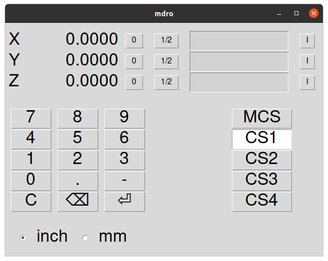

1. Introducción
MDRO is a simple graphical front-end for LinuxCNC providing a display of data from Digital Read Out (DRO) scales. It provides functionality similar to a normal machinist’s DRO display, allowing the user to use the DRO scales on the machine when operating in a manual-only (hand-cranked) mode. It is most useful for manual machines such as DRO equipped Bridgeport style mills that have been converted to CNC but still have the manual controls.
MDRO is mouse and touch screen friendly.
MDRO Window
Figura 1. MDRO Window

3. MDRO Window
The MDRO window contains the following elements:
  • A row for each axis. Each row includes:
    • el nombre del eje,
    • the current value,
    • a "z" button that zeros the value,
    • a "1/2" button that halves the value,
    • a entry field that can be used to set a user-defined value. This field can be set from the keyboard or from the on-screen keypad.
    • A "I" button that starts an index operation (see below),
  • a keypad used to set values in the entry field via a mouse or touchscreen,
  • botones de selección del sistema de coordenadas:
    • The "mcs" button selects the machine coordinate system. These are the raw values from the encoders connected to the mdro.axis.n pins.
    • The "cs1" - "cs4" buttons allow the user to select among one of four user-defined coordinate systems. If the program is started with the MDRO_VAR_FILE = option, the labels will be changed to "g54" - "g57" and the values from the specified .var file will be preloaded. Note that any changes to the values are not persistent: the .var file is never changed.
  • Botones de selección de Pulgada/Milímetro.
