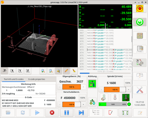

1. Introducción
GMOCCAPY is a GUI for LinuxCNC, designed to be used with a touch screen, but can also be used on normal screens with a mouse or hardware buttons and MPG wheels, as it presents HAL Pins for the most common needs. Please find more information in the following.
Ofrece la posibilidad de mostrar hasta 4 ejes, admite un modo de torno para herramienta normal y posterior, que puede adaptarse a casi cualquier necesidad, ya que GMOCCAPY soporta pestañas y paneles laterales incrustados. Como un buen ejemplo de esto, puede verse gmoccapy_plasma.
GMOCCAPY 3 does support up to 9 axes and 9 joints. As GMOCCAPY 3 has been changed in code to support the joint / axis changes in LinuxCNC it does not work on 2.7 or 2.6 branch!
It has support for integrated virtual keyboard (onboard or matchbox-keyboard), so there is no need for a hardware keyboard or mouse, but it can also be used with that hardware. GMOCCAPY offers a separate settings page to configure most settings of the GUI without editing files.
GMOCCAPY can be localized very easy, because the corresponding files are separated from the linuxcnc.po files, so there is no need to translate unneeded stuff. If you want to contribute a translation, please use the web based translation editor Weblate. For more information see the section Translations

Obtendrá una pantalla similar a la siguiente (el diseño puede variar dependiendo de su configuración.):

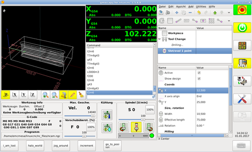

You can add macros to GMOCCAPY, similar to Touchy’s way. A macro is nothing else than a NGC file. You are able to execute complete CNC programs in MDI mode by just pushing one button. To do so, you first have to specify the search path for macros:
[RS274NGC]
SUBROUTINE_PATH = macros
Establece la ruta para buscar macros y otras subrutinas. Si quiere usar varias rutas de subrutinas, simplemente sepárelas con ":".
Then you just have to add a section like this:
Configuration of Five Macros to be Shown in the MDI Button List
[MACROS]
MACRO = i_am_lost
MACRO = hello_world
MACRO = jog_around
MACRO = increment xinc yinc
MACRO = go_to_position X-pos Y-pos Z-pos
Then you have to provide the corresponding NGC files which have to follow these rules:
  • El nombre del archivo debe ser exactamente el mismo que el nombre mencionado en la linea MACRO, con la extensión ".ngc" (sensible a mayúsculas).
  • El archivo debe contener una subrutina como: O<i_am_lost> sub; el nombre de la subrutina debe coincidir exactamente (distingue entre mayúsculas y minúsculas) con el nombre de la macro.
  • El archivo debe terminar con un endsub O<i_am_lost> endsub seguido de un comando M2.
  • The files need to be placed in a folder specified in your INI file by SUBROUTINE_PATH in the RS274NGC section
The code between sub and endsub will be executed by pushing the corresponding macro button.
Nota
A maximum of 16 macros will be shown in the GUI. Due to space reasons you may need to click on an arrow to switch the page and display hidden macro buttons. The macro buttons will be displayed in the order of the INI entries. It is no error placing more than 16 macros in your INI file, they will just not be shown.
Nota
You will find the sample macros in a folder named macros placed in the GMOCCAPY sim folder. If you have given several subroutine paths, they will be searched in the order of the given paths. The first file found will be used.

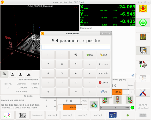

GMOCCAPY will also accept macros asking for parameters like:
[MACROS]
The parameters must be separated by spaces. This example calls a file go_to_position.ngc with the following content:
; Test file "go to position"
; will jog the machine to a given position
O<go_to_position> sub
G17
G21
G54
G61
G40
G49
G80
G90
;#1 = <X-Pos>
;#2 = <Y-Pos>
;#3 = <Z-Pos>
(DEBUG, Will now move machine to X = #1 , Y = #2 , Z = #3)
G0 X #1 Y #2 Z #3
O<go_to_position> endsub
M2
After pushing the execute macro button, you will be asked to enter the values for X-pos Y-pos Z-pos and the macro will only run if all values have been given.
Nota
Si desea usar una macro sin ningún movimiento, vea también las notas en problemas conocidos.

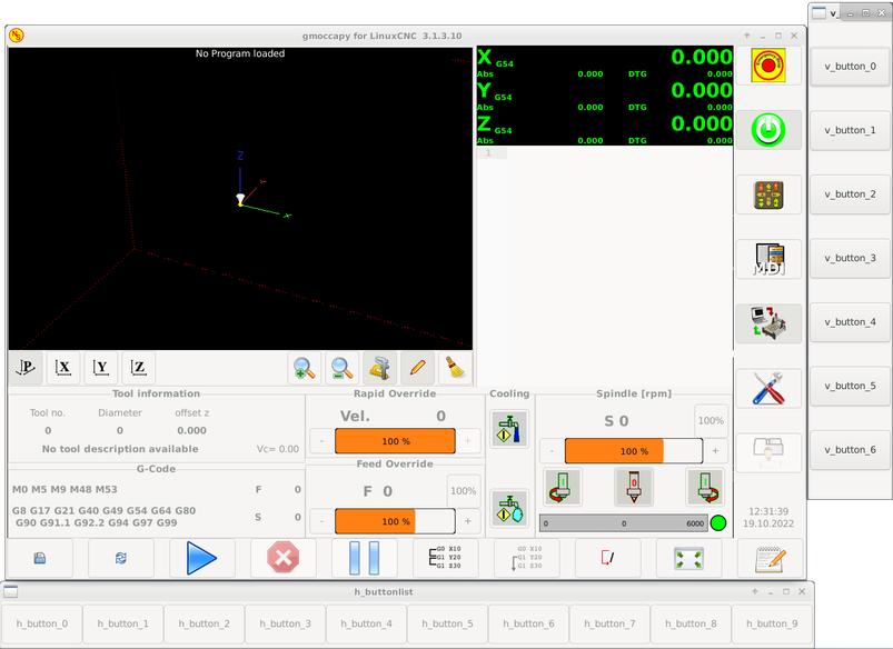

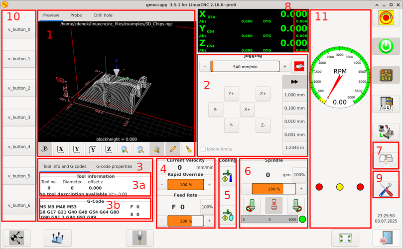

4.4. Pestañas y paneles incrustados

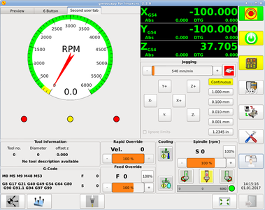

You can add embedded programs to GMOCCAPY like you can do in AXIS, Touchy and Gscreen. All is done by GMOCCAPY automatically if you include a few lines in your INI file in the DISPLAY section.
Si nunca ha usado un panel Glade, se recomienda leer la excelente documentación en Glade VCP.
Embedded Tab Example
EMBED_TAB_NAME = DRO
EMBED_TAB_LOCATION = ntb_user_tabs
EMBED_TAB_COMMAND = gladevcp -x {XID} dro.glade
EMBED_TAB_NAME = Second user tab
EMBED_TAB_COMMAND = gladevcp -x {XID} vcp_box.glade
Todo lo que debe tener en cuenta es incluir para cada pestaña o panel lateral las tres líneas mencionadas:

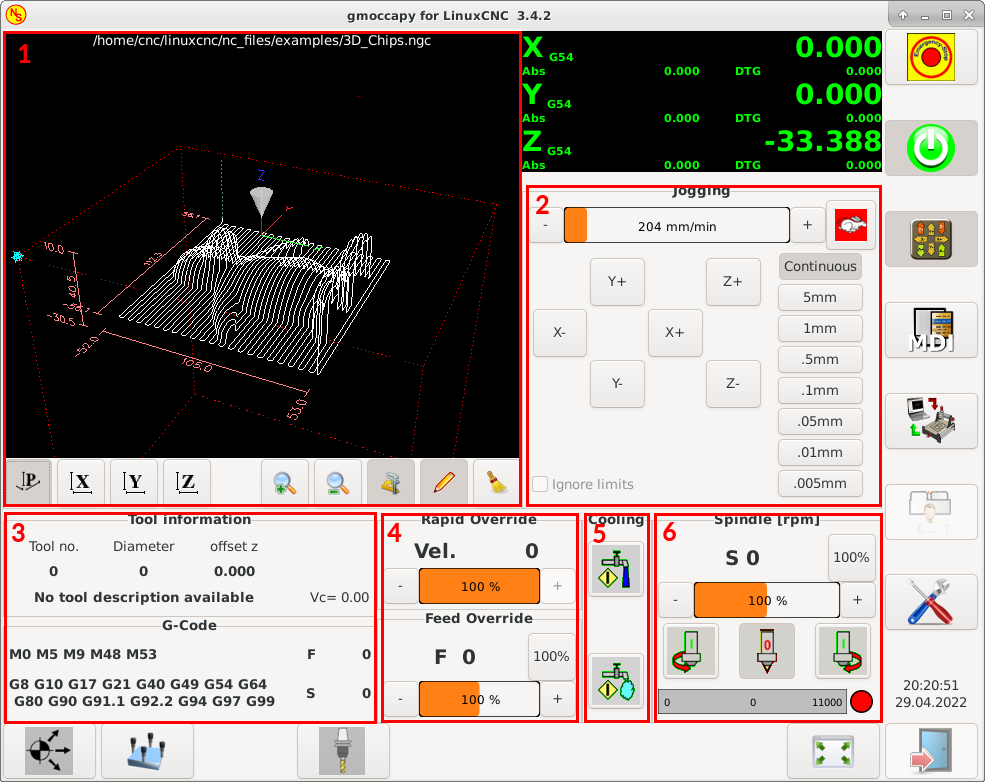

  • EMBED_TAB_NAME = Representa el nombre de la pestaña o el panel lateral. Depende de usted qué nombre usar, pero ¡debe estar presente!
  • EMBED_TAB_LOCATION = Es el lugar donde se colocará su programa en la GUI, ver figura Ubicaciones de pestañas incrustadas. Son valores válidos:
    • ntb_user_tabs (como pestaña principal, cubriendo la pantalla completa (7))
    • ntb_preview (como pestaña en el lado de vista previa (1))
    • hbox_jog (ocultará los botones de trote e introducirá su archivo glade aquí (2))
    • box_left (a la izquierda, altura completa de la pantalla (10))
    • box_right (a la derecha, entre la pantalla normal y la lista de botones (11))
    • box_tool_and_code_info (ocultará los marcos de Información de la herramienta y Código G e introducirá su archivo glade ahí (3))
    • box_tool_info (ocultará el cuadro de Información de la herramienta e introducirá su archivo glade ahí (3a))
    • box_code_info (ocultará el cuadro de Información de código G e introducirá tu archivo glade ahí (3b))
    • box_vel_info (ocultará los marcos de velocidad e introducirá tu archivo glade (4))
    • box_coolant_and_spindle (ocultará los marcos del refrigerante y del husillo e introducirá ahí su archivo glade (5)+(6))
    • box_cooling (ocultará el marco de refrigerante e introducirá su archivo glade (5))
    • box_spindle (ocultará el marco del husillo e introducirá su archivo glade (6))
    • box_custom_1 (presentará tu archivo glade a la izquierda de vel_frame)
    • box_custom_2 (presentará tu archivo glade a la izquierda de cooling_frame)
    • box_custom_3 (presentará tu archivo glade a la izquierda de spindle_frame)
    • box_custom_4 (presentará su archivo glade a la derecha de spindle_frame)
    • box_dro_side (presentará su archivo glade a la derecha de DRO (8))
    • ntb_setup (como pestaña en la página de configuración (9))
Nota
See also the included sample INI files to see the differences.
  • EMBED_TAB_COMMAND = El comando a ejecutar, p. ej.
    includes a custom glade file called dro.glade in the mentioned location. The file must be placed in the config folder of your machine.
    gladevcp h_buttonlist.glade
    will just open a new user window called h_buttonlist.glade note the difference. This one is stand alone, and can be moved around independent from GMOCCAPY window.
    gladevcp -c gladevcp -u hitcounter.py -H manual-example.hal manual-example.ui
    will add a the panel manual-example.ui, include a custom Python handler, hitcounter.py and make all connections after realizing the panel according to manual-example.hal.
    hide
    will hide the chosen box.
images/gmoccapy_embedded_tabs_small.png
Figura 1. Embedded tab locations
Nota
Si realiza alguna conexión HAL a su panel de glade personalizado, debe hacerlo en el archivo HAL especificado en la línea EMBED_TAB_COMMAND; de lo contrario, puede obtener un error de que el pin HAL no existe — esto se debe a las condiciones de carrera al cargar los archivos HAL. Las conexiones a pines GMOCCAPY HAL deben realizarse en el archivo HAL postgui especificado en su archivo INI, porque esos pines no existen antes de realizar la GUI.
Here are some examples:
ntb_preview
images/gmoccapy_ntb_preview_small.png
box_right - and GMOCCAPY in MDI mode
images/gmoccapy_with_right_panel_in_MDI_mode_small.png

5.1. Right and Bottom Button Lists
The screen has two main button lists, one on the right side an one on the bottom. The right handed buttons will not change during operation, but the bottom button list will change very often. The buttons are count from up to down and from left to right beginning with 0.
Nota
Los nombres de pin han cambiado en GMOCCAPY 2 para ordenarlos mejor.
The pins for the right (vertical) buttons are:
  • gmoccapy.v-button.button-0 (bit IN)
  • gmoccapy.v-button.button-1 (bit IN)
  • gmoccapy.v-button.button-2 (bit IN)
  • gmoccapy.v-button.button-3 (bit IN)
  • gmoccapy.v-button.button-4 (bit IN)
  • gmoccapy.v-button.button-5 (bit IN)
  • gmoccapy.v-button.button-6 (bit IN)
For the bottom (horizontal) buttons they are:
  • gmoccapy.h-button.button-0 (bit IN)
  • gmoccapy.h-button.button-1 (bit IN)
  • gmoccapy.h-button.button-2 (bit IN)
  • gmoccapy.h-button.button-3 (bit IN)
  • gmoccapy.h-button.button-4 (bit IN)
  • gmoccapy.h-button.button-5 (bit IN)
  • gmoccapy.h-button.button-6 (bit IN)
  • gmoccapy.h-button.button-7 (bit IN)
  • gmoccapy.h-button.button-8 (bit IN)
  • gmoccapy.h-button.button-9 (bit IN)
As the buttons in the bottom list will change according to the mode and other influences, the hardware buttons will activate the displayed functions. So you don’t have to take care about switching functions around in HAL, because that is done completely by GMOCCAPY!
For a three axes XYZ machine the HAL pins will react as shown in the following three tables:
Tabla 1. Functional assignment of horizontal buttons (1)
Pin Modo manual MDI Mode Auto Mode
open homing button
macro 1 (if defined)
open file

¡Así que tenemos 67 reacciones con sólo 10 pines de HAL!
These pins are made available to be able to use the screen without a touch panel, or protect it from excessive use by placing hardware buttons around the panel. They are available in a sample configuration like shown in the image below.
Sample configuration "gmoccapy_sim_hardware_button" showing the side buttons
images/gmoccapy_sim_hardware_button_mid.png

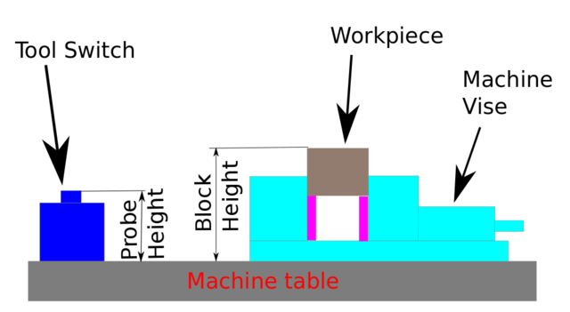

Tool Measurement in GMOCCAPY is done a little bit different to many other GUIs. You should follow these steps:
  1. Toque de su pieza en X e Y.
  2. Mida la altura de su bloque desde la base donde está ubicado su interruptor de herramienta hasta la cara superior del bloque (incluyendo la mordaza etc.).
  3. Presione el botón de altura del bloque e ingrese el valor medido.
  4. Ir al modo automático e iniciar su programa.
Here is a small sketch:
images/sketch_auto_tool_measurement.png
Figura 4. Tool measurement data
With the first given tool change the tool will be measured and the offset will be set automatically to fit the block height. The advantage of the GMOCCAPY way is, that you do not need a reference tool.

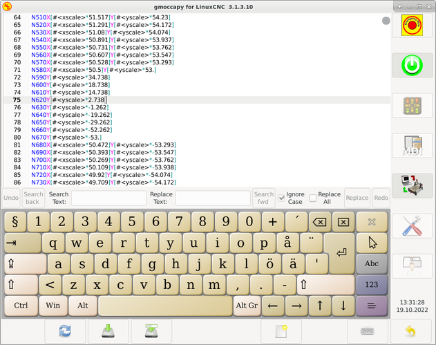

Virtual Keyboard
The checkboxes allow the user to select if he wants the on board keyboard to be shown immediately when entering the MDI Mode, the offset page, the tooledit widget or when open a program in the EDIT mode. The keyboard button on the bottom button list will not be affected by these settings, so you are able to show or hide the keyboard by pressing the button.
La configuración predeterminada es:
  • Show keyboard on offset = False
  • Show keyboard on tooledit = False
  • Show keyboard on MDI = True
  • Show keyboard on EDIT = True
  • Show keyboard on load file = False
Nota
If this section is not sensitive, you have not installed a virtual keyboard, supported ones are onboard and matchbox-keyboard.
Nota
If the keyboard layout is not correct, i.e. clicking Y gives Z, than the layout has not been set properly, related to your locale settings. For onboard it can be solved with a small batch file with the following content:
#!/bin/bash
setxkbmap -model pc105 -layout de -variant basic
Las letras "de" son para Alemán, tendrá que configurar de acuerdo con su configuración regional (para español de España, es). Simplemente ejecute este archivo antes de iniciar LinuxCNC. También puede agregar un iniciador a su carpeta local.
./config/autostart
So that the layout is set automatically on starting.
For matchbox-keyboard you will have to make your own layout, for a German layout ask in the forum.
GMOCCAPY with Onboard keyboard in edit mode
Onboard keyboard

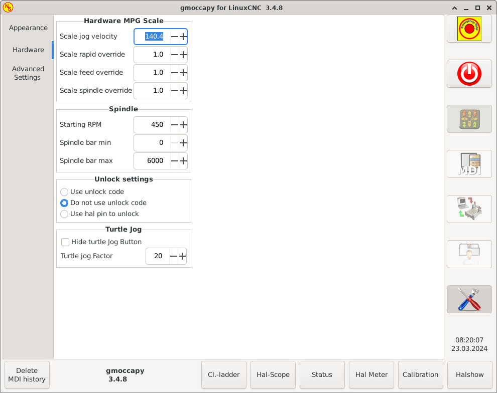

  • Usar código de desbloqueo - El usuario debe dar un código para entrar.
  • No usar código de desbloqueo - No habrá verificación de seguridad.
  • Usar un pin para desbloquear - El pin de hardware debe estar alto para desbloquear la configuración, ver pin de desbloqueo hardware.
El valor predeterminado es usar el código de desbloqueo (predeterminado = * 123 *).
Turtle Jog
This settings will have influence on the jog velocities.
  • Hide turtle jog button - Will hide the button right of the jog velocity slider. If you hide this button, please take care that the "rabbit mode" is activated, otherwise you will not be able to jog faster than the turtle jog velocity, which is calculated using the turtle jog factor.
  • Factor de trote de tortuga - Establece la escala para el modo trote de tortuga (botón presionado mostrando la tortuga). Si le pone un factor de 20, la velocidad máxima de trote de tortuga será 1/20 de la velocidad máxima de la máquina.
Nota
This button can be controlled using the Turtle-Jog HAL Pin.

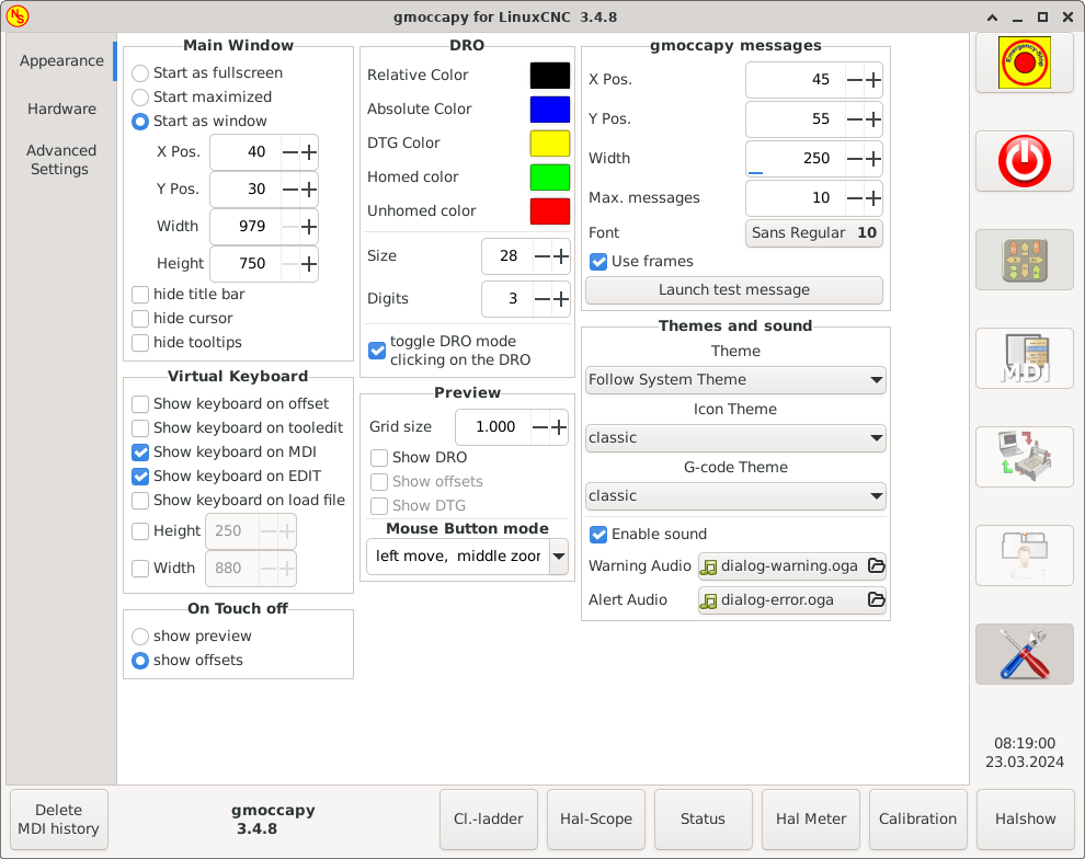

7.3. Advanced Settings
Advanced settings
Tool Measurement
Please check Auto Tool Measurement
Nota
If this part is not sensitive, you do not have a valid INI file configuration to use tool measurement.
  • Use auto tool measurement - If checked, after each tool change, a tool measurement will be done, the result will be stored in the tool table and a G43 will be executed after the change.
    Probe Information
    Las información siguiente se toma de su archivo INI y se debe proporcionar en coordenadas absolutas:
    • X Pos. - La posición X del interruptor de herramienta.
    • Y Pos. - La posición Y del interruptor de herramienta.
    • Z Pos. - La posición Z del interruptor de la herramienta, iremos como movimiento rápido a esta coordenada.
    • Max. Probe - The distance to search for contact, an error will be launched, if no contact is given in this range. The distance has to be given in relative coordinates, beginning the move from Z Pos., so you have to give a negative value to go down!
    • Probe Height - The height of your probe switch, you can measure it. Just touch off the base where the probe switch is located and set that to zero. Then make a tool change and watch the tool_offset_z value, that is the height you must enter here.
    Probe velocities
    • Search Vel. - The velocity to search for the tool switch. After contact the tool will go up again and then goes towards the probe again with probe vel, so you will get better results.
    • Vel. Sonda - Es la velocidad para el segundo movimiento hacia el interruptor. Debe ser más lento para obtener mejores resultados. En modo sim, esto es comentado en macros/change.ngc, de lo contrario el usuario tendría que hacer clic dos veces en el botón de la sonda.
Reload Tool::
  • Reload Tool on Start - Loads the last tool on start after homing.
If checked, the tool in spindle will be saved on each change in the preference file, making it possible to reload the last mounted tool on start up. The tool will be loaded after all axes are homed, because before it is not allowed to execute MDI commands. If you use NO_FORCE_HOMING you can not use this feature, because the needed all_homed_signal will never be emitted.
File to load on start up
Select the file you want to be loaded on start up. If a file is loaded, it can be set by pressing the current button. To avoid that any program is loaded at start up, just press the None button.
La pantalla de selección de archivos utilizará los filtros que haya configurado en el archivo INI. Si no hay filtros, solo verá los archivos NGC. La ruta se establecerá de acuerdo con la configuración de INI en [DISPLAY] PROGRAM_PREFIX.
Jump to dir
You can set here the directory to jump to if you press the corresponding button in the file selection dialog.
Run from Line
You can allow or disallow the run from line. This will set the corresponding button insensitive (grayed out), so the user will not be able to use this option. The default is disable run from line.
Aviso

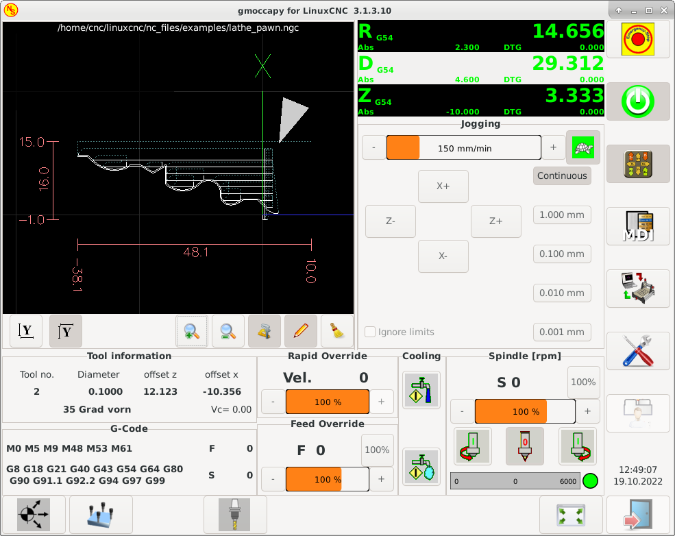

9. Lathe Specific Section
If in the INI file LATHE = 1 is given, the GUI will change its appearance to the special needs for a lathe. Mainly the Y axis will be hidden and the jog buttons will be arranged in a different order.
images/gmoccapy_lathe.png
Figura 6. Normal Lathe
images/gmoccapy_back_tool_lathe.png
Figura 7. Back Tool Lathe
As you see the R DRO has a black background and the D DRO is gray. This will change according to the active G-code G7 or G8. The active mode is visible by the black background, meaning in the shown images G8 is active.
The next difference to the standard screen is the location of the jog buttons. X and Z have changed places and Y is gone. You will note that the X+ and X- buttons changes there places according to normal or back tool lathe.
Also the keyboard behavior will change:
Normal Lathe:
  • Arrow_Left or NumPad_Left - Jog Z minus
  • Arrow_Right or NumPad_Right - Jog Z plus
  • Arrow_up or NumPad_Up - Jog X minus
  • Arrow_Down or NumPad_Down - Jog X plus
Back Tool Lathe:
  • Arrow_up or NumPad_Up - Jog X plus
  • Arrow_Down or NumPad_Down - Jog X minus
The tool information frame will show not only the Z offset, but also the X offset and the tool table is showing all lathe relevant information.
