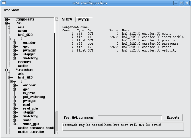

10. HAL Pins
The HAL pins for each configuration can be seen by opening up Show HAL Configuration from the Machine menu. All the HAL pins and parameters can be found there. The following figure is of the 5I20 configuration used above.
5i20 HAL Pins
Figure 1. 5i20 HAL Pins

15.1. Pins
  • count - (sint, out) Number of encoder counts since the previous reset.
  • index-enable - (bool, i/o) When this pin is set to True, the count (and therefore also position) are reset to zero on the next Index (Phase-Z) pulse. At the same time, index-enable is reset to zero to indicate that the pulse has occurred.
  • position - (real, out) Encoder position in position units (count / scale).
  • rawcounts - (sint, out) Total number of encoder counts since the start, not adjusted for index or reset.
  • reset - (bool, in) When this pin is TRUE, the count and position pins are set to 0. The value of the velocity pin is not affected by this. The driver does not reset this pin to FALSE after resetting the count to 0, that is the user’s job.
  • velocity - (real, out) Estimated encoder velocity in position units per second.
