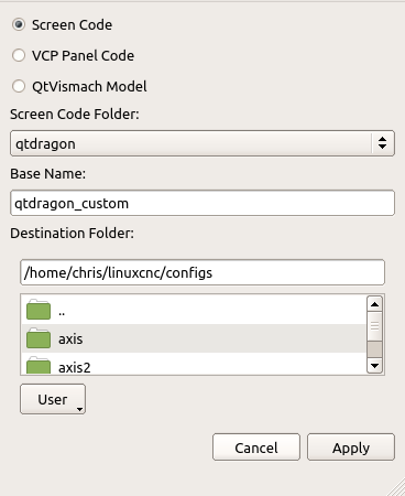

1.1. copy
Used for copying QtVCP’s builtin Screens/VCP Panels/QtVismach code to a folder so one can customize it.
In a terminal run:
qtvcp copy
copy Dialog - Screen, VCP Panel or QtVismach Code Copy Panel1.2. center

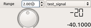

1.4. test_dial
This panel has a dial that adjusts SINT and REAL HAL output pins.
The dial’s range can be adjusted from a drop down menu.
The output can be scaled with the
spinbox. -
A
comboboxcan be used to automatically select and connect to a signal.
loadusr qtvcp test_dial

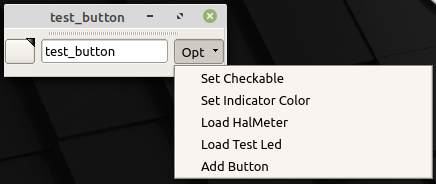

test_dial Panel - Test Dial VCP1.5. test_button
This panel has a button that will set a HAL pin.
The button can be selected as a momentary or a toggle button.
A HAL pin will be created that follows the button state.
The button’s indicator color can be adjusted from a drop down menu.
A HAL pin or signal can be selected to follow the button state.
You can add more buttons from the drop down menu.
You can load a Halmeter from the drop down menu.
You can load a test LED from the drop down menu.
The button can be detached from the main windows.
Here is how to load test_button from a HAL script:
loadusr qtvcp test_button
loadusr qtvcp -o 4 test_button
The -o switch sets how many buttons the panel starts with.
If loading directly from a terminal omit the loadusr.

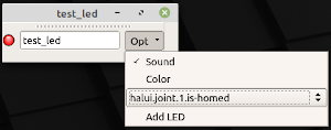

test_button - Test Button VCP1.6. test_led
This panel has an LED that can selected to watch HAL bit pins/signals.
The LED’s color can be adjusted from a drop down menu.
The text box and state can be output as speech if sound is selected.
A
comboboxcan be used to automatically select and connect to a pin/signal. -
You can add more LEDs from the drop down menu.
The LED can be detached from the main windows.
Here is how to load test_led from a HAL script:
loadusr qtvcp test_led
loadusr qtvcp -o 4 test_led
The -o switch sets how many LEDs the panel starts with.

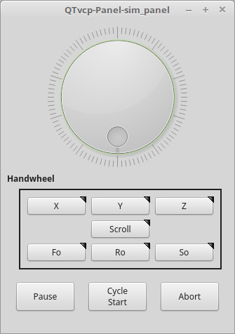

1.9. sim_panel
Small control panel to simulate MPG jogging controls etc for simulated configurations.
The MPG, selection buttons and control buttons export HAL pins to connect to linuxcnc.
The selection and control group boxes can be hidden if not needed by using the -o hide= option.
groupBoxControl and groupBoxSelection are the widget names that can be hidden.
If you want to hide both, use a comma between them with no spaces.
The -a option will make the panel always-on-top of all windows.
loadusr qtvcp sim_panel
Here we load the panel with no MPG selection buttons and the always-on-top option.
loadusr qtvcp -a -o hide=groupBoxSelection sim_panel

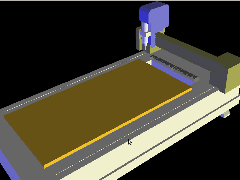

vismach_mill_xyz - 3-Axis Mill 3D View Panel2.2. QtVCP vismach_router_atc
3D OpenGL view of a 3-Axis router style, gantry bed milling machine.
This particular panel shows how to define and connect the model parts in the handler file, rather then importing the pre-built model from QtVCP’s vismach library.
loadusr qtvcp vismach_router_atc

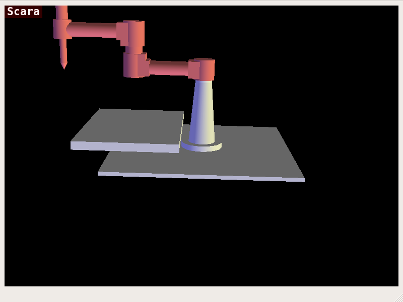

vismach_router_atc - 3-Axis Gantry Bed Mill 3D View Panel2.3. QtVCP vismach_scara
3D OpenGL view of a SCARA based milling machine.
loadusr qtvcp vismach_scara

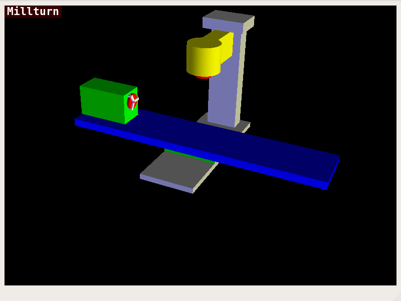

vismach_scara - SCARA Mill 3D View Panel2.4. QtVCP vismach_millturn
3D OpenGL view of a 3-Axis milling machine with an A axis/spindle.
loadusr qtvcp vismach_millturn

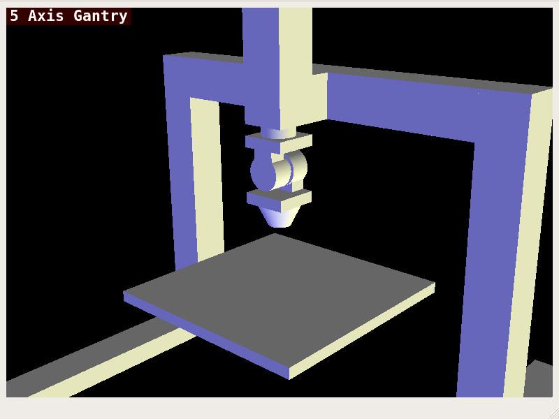

vismach_millturn - 4 Axis MillTurn 3D View Panel2.5. QtVCP vismach_mill_5axis_gantry
3D OpenGL view of a 5-Axis gantry type milling machine.
loadusr qtvcp vismach_mill_5axis_gantry

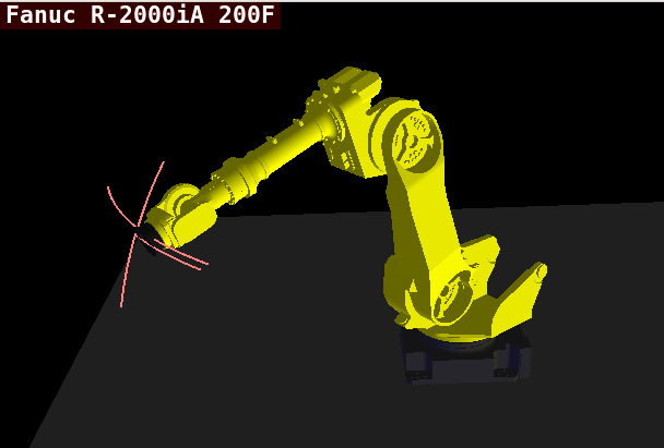

vismach_mill_5axis_gantry - 5-AxIs Gantry Mill 3D View Panel2.6. QtVCP vismach_fanuc_200f
3D openGL view of a 6 joint robotic arm.
loadusr qtvcp vismach_fanuc_200f
