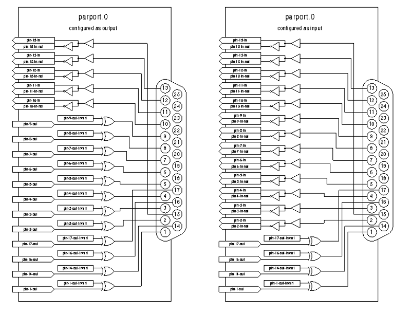

The hal_parport component is a driver for the traditional PC parallel port. The port has a total of 17 physical pins. The original parallel port divided those pins into three groups: data, control, and status. The data group consists of 8 output pins, the control group consists of 4 pins, and the status group consists of 5 input pins.
In the early 1990s, the bidirectional parallel port was introduced, which allows the data group to be used for output or input. The HAL driver supports the bidirectional port, and allows the user to set the data group as either input or output. If configured as out, a port provides a total of 12 outputs and 5 inputs. If configured as in, it provides 4 outputs and 13 inputs.

parport.<p>.pin-`__<n>__-out` (bool) Drives a physical output pin. -
parport.<p>.pin-`__<n>__-in` (bool) Tracks a physical input pin. -
parport.<p>.pin-`__<n>__-in-not` (bool) Tracks a physical input pin, but inverted.
For each pin, <p> is the port number, and <n> is the physical pin number in the 25 pin D-shell connector.
For each physical output pin, the driver creates a single HAL pin, for example: parport.0.pin-14-out.
For each physical input pin, the driver creates two HAL pins, for example: parport.0.pin-12-in and parport.0.pin-12-in-not.
The -in HAL pin is TRUE if the physical pin is high, and FALSE if the physical pin is low. The -in-not HAL pin is inverted and is FALSE if the physical pin is high.
