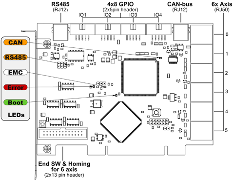

The following connectors can be found on the GM6-PCI card:
GM6-PCI card connectors and LEDs
Figure 1. GM6-PCI card connectors and LEDs
1. I/O connectors
Pin numbering of GPIO connectors
Figure 2. Pin numbering of GPIO connectors

Each pin can be configured as digital input or output. GM6-PCI motion control card has 4 general purpose I/O (GPIO) connectors, with eight configurable I/O on each. Every GPIO pin and parameter name begins as follows:
gm.<card_no>.gpio.<gpio_con_no>
where <gpio_con_no> is from 0 to 3.

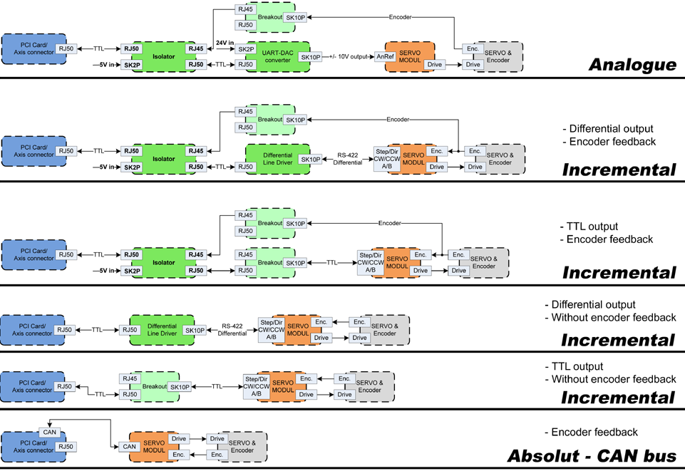

2.1. Axis interface modules
Small sized DIN rail mounted interface modules gives easy way of connecting different types of servo modules to the axis connectors. Seven different system configurations are presented in the System integration manual for evaluating typical applications. Also the detailed description of the Axis modules can be found in the System integration manual.
For evaluating the appropriate servo-drive structure the modules have to be connected as the following block diagram shows:
Servo axis interfaces
Figure 4. Servo axis interfaces

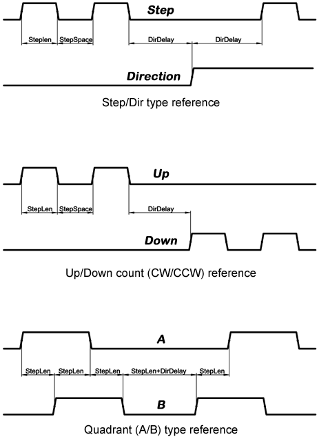

For evaluating the appropriate values see the timing diagrams below:
Reference signal timing diagrams
Figure 5. Reference signal timing diagrams
