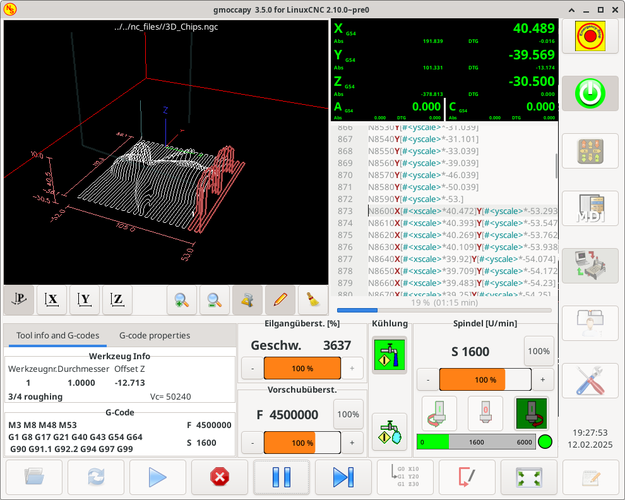

3. How to get GMOCCAPY
GMOCCAPY 3 is included in the standard distribution of LinuxCNC since release 2.7. So the easiest way to get GMOCCAPY on your controlling PC is just to download the ISO and install it from the CD/DVD/USB-stick. This allows you to receive updates with the regular Debian packages.
In the release notes aka changelist you can track the latest bugfixes and features.
You will get a similar screen to the following (the design may vary depending on your config):
gmoccapy 3 axis mid

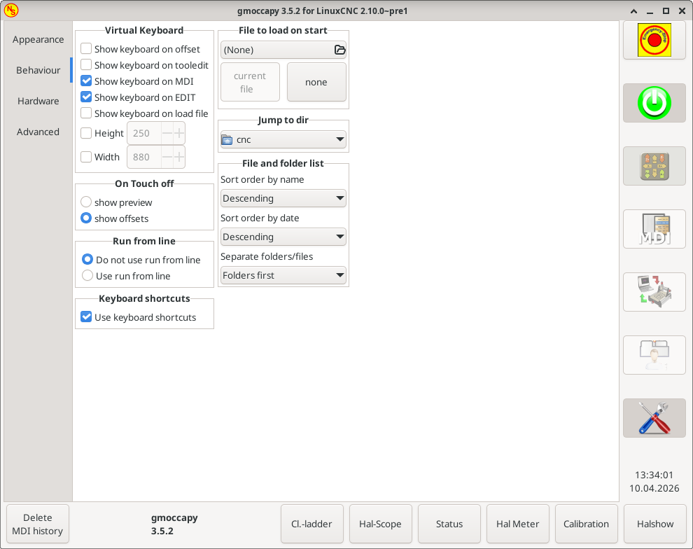

Table 2. Functional assignment of horizontal buttons (2)
Pin Settings Mode Homing Mode Touch off Mode
gmoccapy.h-button.button-0
delete MDI history
touch X
gmoccapy.h-button.button-1
home all
touch Y
gmoccapy.h-button.button-2
touch Z
gmoccapy.h-button.button-3
home x
gmoccapy.h-button.button-4
open classic ladder
home y
gmoccapy.h-button.button-5
open HAL scope
home z
gmoccapy.h-button.button-6
open HAL status
gmoccapy.h-button.button-7
open HAL meter
gmoccapy.h-button.button-8
open HAL calibration
unhome all
gmoccapy.h-button.button-9
open HAL show
back
back

7.2. Behaviour
Configuration page
Figure 6. GMOCCAPY settings page Behaviour
Virtual Keyboard
The checkboxes allow the user to select if he wants the on board keyboard to be shown immediately when entering the MDI Mode, the offset page, the tooledit widget or when open a program in the EDIT mode. The keyboard button on the bottom button list will not be affected by these settings, so you are able to show or hide the keyboard by pressing the button.
The default setting is:
  • Show keyboard on offset = False
  • Show keyboard on tooledit = False
  • Show keyboard on MDI = True
  • Show keyboard on EDIT = True
  • Show keyboard on load file = False
Note
If this section is not sensitive, you have not installed a virtual keyboard, supported ones are onboard and matchbox-keyboard.
Note
If the keyboard layout is not correct, i.e. clicking Y gives Z, than the layout has not been set properly, related to your locale settings. For onboard it can be solved with a small batch file with the following content:
#!/bin/bash
setxkbmap -model pc105 -layout de -variant basic
The letters "de" are for German, you will have to set them according to your locale settings. Just execute this file before starting LinuxCNC, it can be done also adding a starter to your local folder.
./config/autostart
So that the layout is set automatically on starting.

On Touch Off
This gives the option whether to show the preview tab or the offset page tab when you enter the touch off mode by clicking the corresponding bottom button.
  • show preview
  • show offsets
Run from Line
You can allow or disallow the run from line. This will set the corresponding button insensitive (grayed out), so the user will not be able to use this option. The default is disable run from line.
Warning
It is not recommend to use run from line, as LinuxCNC will not take care of any previous lines in the code before the starting line. So errors or crashes are fairly likely.
Keyboard shortcuts
Some users want to jog their machine using the keyboard buttons and there are others that will never allow this. So everybody can select whether to use them or not.
Keyboard shortcuts are disabled by default. They can be activated by the checkbox
  • Use keyboard shortcuts
Warning
It is not recommended to use keyboard jogging, as it represents a serious risk for operator and machine.
Please take care if you use a lathe, then the shortcuts will be different, see the Lathe Specific Section.
General
  • F1 - Trigger Estop (will work even if keyboard shortcuts are disabled)
  • F2 - Toggle machine on/off
  • F3 - Manual mode
  • F5 - MDI mode
  • ESC - Abort
In Manual Mode
  • Arrow_Left or NumPad_Left - Jog X minus
  • Arrow_Right or NumPad_Right - Jog X plus
  • Arrow_up or NumPad_Up - Jog Y plus
  • Arrow_Down or NumPad_Down - Jog Y minus
  • Page_Up or NumPad_Page_Up - Jog Z plus
  • Page_Down or NumPad_Page_Down - Jog Z minus
In Auto Mode
  • R or r - Run program
  • P or p - Pause program
  • S or s - Resume program
  • Control + R or Control + r - Reload the loaded file
Message handling (see Message behavior and appearance)
  • WINDOWS - Delete last message
  • Control + Space - Delete all messages
File to load on start up
Select the file you want to be loaded on start up. If a file is loaded, it can be set by pressing the current button. To avoid that any program is loaded at start up, just press the None button.
The file selection screen will use the filters you have set in the INI file, if there aren’t any filters given, you will only see NGC files. The path will be set according to the INI settings in [DISPLAY] PROGRAM_PREFIX.
NGC files can be explicitly excluded from the file selection screen by passing no_ngc instead of an extension:
PROGRAM_EXTENSION = no_ngc Exclude ngc files from selection screen
Jump to dir
You can set here the directory to jump to if you press the corresponding button in the file selection dialog.
File and folder list
For the file chooser page it is possible to change the sorting options with these parameters.
