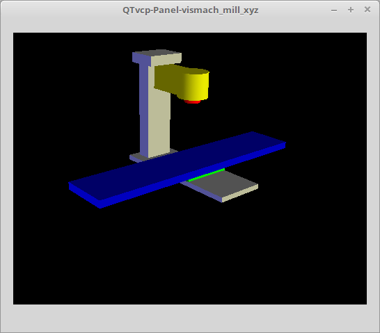

Vismach displays the model in a 3D viewport and the model parts are animated as the values of associated HAL pins change.
QtVismach 3D Viewport
Figure 1. QtVismach 3D Viewport
The Vismach 3D viewport view can be manipulated as follows:
  • zoom by scroll wheel
  • pan by middle button drag
  • rotate by right-button drag
  • tilt by left button drag

Taking the mill shown in the 3D Viewport picture above for example:
  • If you move X, it can move on its own,
  • but if you move Y, it will also move X assembly, as it is attached to Y assembly.
So for this machine, the tree looks like this:
model
  |---frame
  |     |---base
  |     |---column
  |     |---top
  |---yassembly
  |      |---xassembly
  |      |      |---xbase
  |      |      |---work
  |      |---ybase
  |---zassembly
          |---zframe
          |     |---zbody
          |     |---spindle
          |---toolassembly
                    |---cat30
                    |---tool
                         |---tooltip
                         |---(tool cylinder function)
