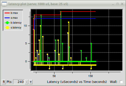

2.2. Latency Plot
latency-plot makes a strip chart recording for a base and a servo thread. It may be useful to see spikes in latency when other applications are started or used. Usage:
latency-plot --help
Usage:
latency-plot --help | -?
latency-plot --hal [Options]
Options:
--base ns (base thread interval in nanoseconds, default: 25000)
--servo ns (servo thread interval in nanoseconds, default: 1000000)
--time ms (report interval in milliseconds, default: 1000)
--relative (relative clock time (default))
--actual (actual clock time)

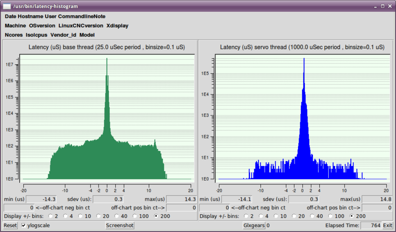

latency-plot Window2.3. Latency Histogram
The application latency-histogram displays a histogram of latency (jitter) for a base and servo thread.
Usage: latency-histogram --help | -? latency-histogram [Options] Options: --base ns (base thread interval in nanoseconds, default: 25000, min: 5000) --servo ns (servo thread interval in nanoseconds, default: 1000000, min: 25000) --bbinsize ns (base bin size in nanoseconds, default: 100 --sbinsize ns (servo bin size in nanoseconds, default: 100 --bbins n (base bins, default: 200 --sbins n (servo bins, default: 200 --logscale 0|1 (y axis log scale, default: 1) --text note (additional note, default: "" ) --show (show count of undisplayed bins) --nobase (servo thread only) --verbose (progress and debug) --nox (no gui, display elapsed,min,max,sdev for each thread)
Note
When determining the latency, LinuxCNC and HAL should not be running, stop with halrun -U. Large number of bins and/or small binsizes will slow updates. For single thread, specify --nobase (and options for servo thread). Measured latencies outside the +/- bin range are reported with special end bars. Use --show to show count for the off-chart [pos|neg] bin.
