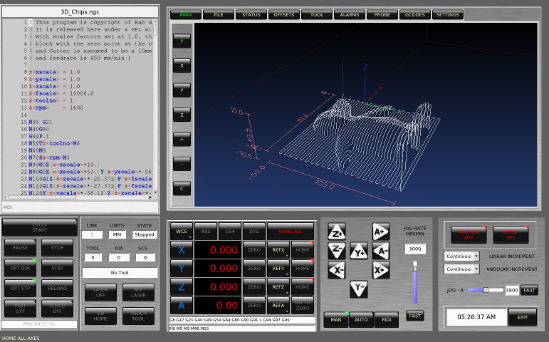

1.1. QtDragon
QtDragon Router
Figure 1. QtDragon - 3 to 5 axis sample (1440x860) in silver theme
QtDragon is resizable from a resolution of 1280x768 to 1680x1200. It will work in window mode on any monitor with higher resolution but not on monitors with lower resolution.

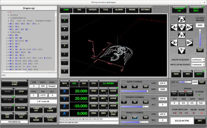

1.3. QtDragon_hd
QtDragon_hd
Figure 2. QtDragon_hd - 3 to 5 axis sample for larger monitors (1920x1056) in dark theme
QtDragon_hd is a similar design as QtDragon but modified to utilize the extra space of modern larger monitors. There are some small differences in layout and utility.
QtDragon_hd has a resolution of 1920x1056 and is not resizeable. It will work in window mode on any monitor with higher resolution but not on monitors with lower resolution.

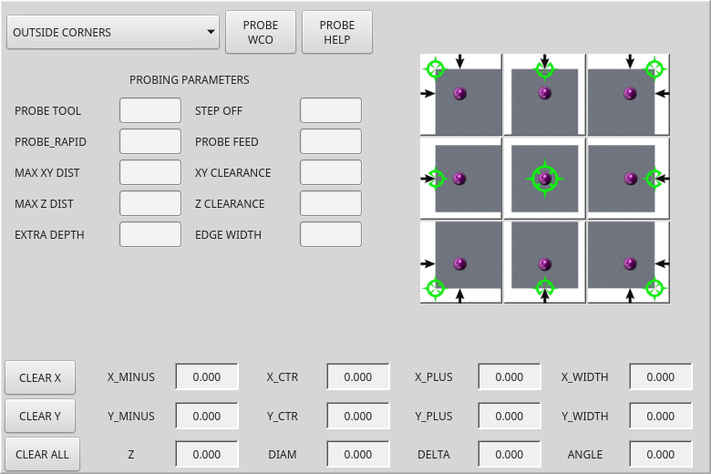

2.14. Probe/Touchplate/Laser Settings
QtDragon has INI entries for two optional probing tab screens available. Comment/uncomment which ever you prefer.
  • Versa probe is a QtVCP ported version of a popular GladeVCP probing panel.
  • Basic Probe is a QtVCP ported version based on the third party basic probe screen.
Both perform similar probing routines, though Versa probe optionally handles auto tool measurement.
[PROBE]
#USE_PROBE = versaprobe
USE_PROBE = basicprobe

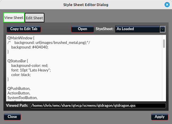

F12 - Style Editor

12.2. Basic probe
QtDragon Probe
Figure 5. QtDragon - Basic Probe Option
Basic probe is used to semi-automatically probe work pieces to find edges, centers and angles. The combo box allows selecting the basic type of probing buttons shown:
  • Outside Corners
  • Inside Corners
  • Edge Angles
  • Boss and Pockets
  • Ridge and Valleys
  • Calibration
You must carefully set the Probing Parameters:
Probe Tool
Will only allow probing if this tool number is in the spindle
Probe Diameter
The size of the probe tip
Probe Rapid
The speed of rapid moves in machine units
Probe Search
The speed of the first rough search in machine units
Probe Feed
The speed of the second fine search in machine units
Step Off
Back off and re-probe distance
Max XY Distance
The maximum distance the probe will search for in X and Y before failing with error
Max Z Distance
The maximum distance the probe will search for in Z before failing with error
XY Clearance
Clearance distance from probe to wall edge before rapid traversing down in Z and rough probing
Z Clearance
Clearance distance from probed to top of material
Extra Depth
Distance from top of material to desired probe depth
There are also hint parameters depending on selected probing type:
Edge Width
Desired distance from the probe start position, along wall edge before starting to probe
Diameter Hint
Used by Round Boss or Round Pocket probing (start move: 1/2 diameter plus XY clearance)
X Hint
Used by Rectangular Boss/Pocket probing (start move: 1/2 X length plus XY clearance)
Y Hint
Used by Rectangular Boss/Pocket probing (start move: 1/2 Y length plus XY clearance)
After setting the parameters and hints:
  • Manually move the probe to the approximate position represented by the green target on the button.
  • Confirm the parameters are reasonable.
  • Press the desired probing button.
The probing routine will start immediately.
Note
Pressing the stop button or the keyboard escape key, will abort the probing.

17.1. Main tab
This tab displays the graphical representation of the current program. The side buttons will control the display.
  • User View: Select/restore a user set view of the current program.
  • P,X,Y,Z: Set standard views.
  • D: Toggle display of dimensions.
  • +, -: Zoom controls.
  • C: Clear graphics of tool movement lines.
In qtdragon_hd there are also macro buttons available on the right side. Up to tens buttons can be defined in the INI.

17.6. Probe Tab
Probing routines options are displayed on this tab. Depending on INI options, this could be VersaProbe or BasicProbe style. They are functionally similar. QtDragon_hd will also show a smaller graphics display window.

19. Styles
Nearly all aspects of the GUI appearance are configurable via the QtDragon.qss stylesheet file. The file can be edited manually or through the stylesheet dialog widget in the GUI. To call up the dialog, press F12 on the main window. New styles can be applied temporarily and then saved to a new qss file, or overwrite the current qss file.
QtDragon styles
Figure 10. QtDragon - Two Style Examples

21.1. Stylesheets
Stylesheets can be leveraged to do a fair amount of customization, but you usually need to know a bit about the widget names. Pressing F12 will display a stylesheet editor dialog to load/test/save modification.
The View Sheet tab will allow you to select and apply what stylesheet QtDragon will use when it’s first loaded.
Press the button Copy to Edit Tab to copy the current stylesheet to the edit tab.
The Edit Sheet tab allows editing, applying and saving of changes od the displayed stylesheet.
QtDragon stylesheet editor
Sometimes these lines will be present and you can change them, otherwise you will need to add them.
For instance, to change the DRO font (look for this entry and change the font name):
