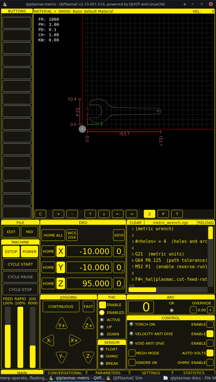

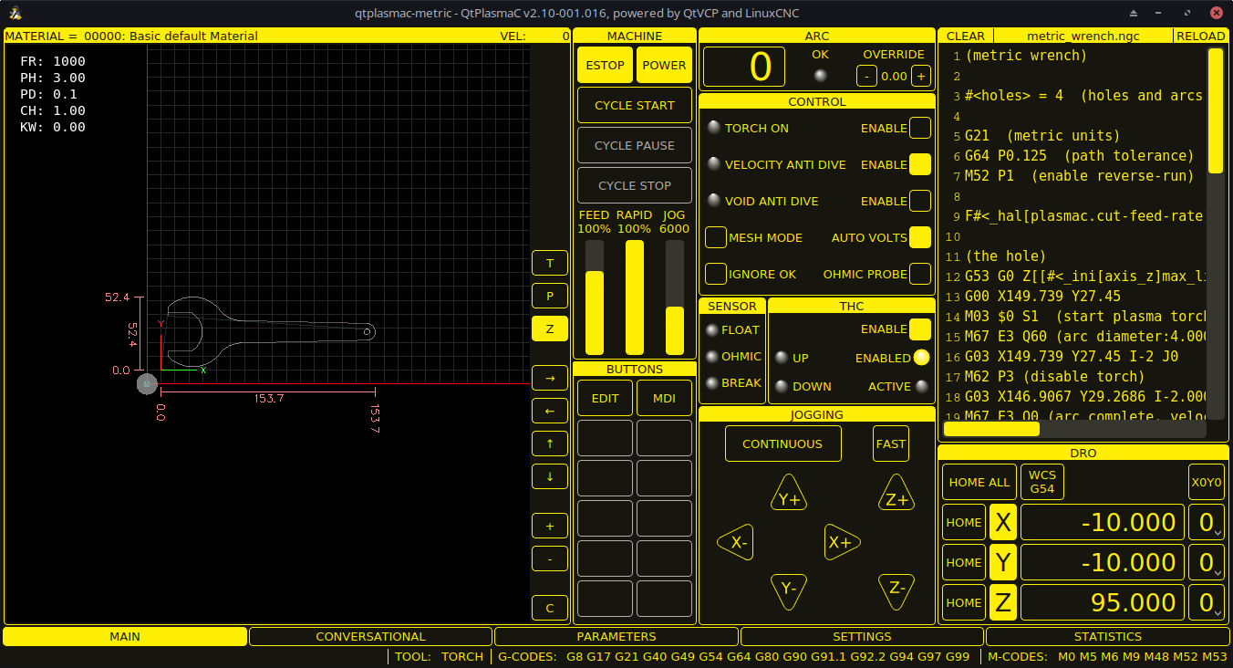

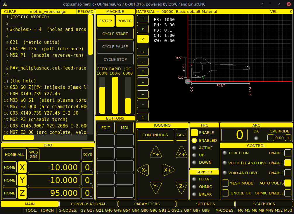

Screenshot examples of QtPlasmaC are below:
qtplasmac 16x9
Figure 1. 16:9
qtplasmac 9x16
Figure 2. 9:16
qtplasmac 4x3
Figure 3. 4:3

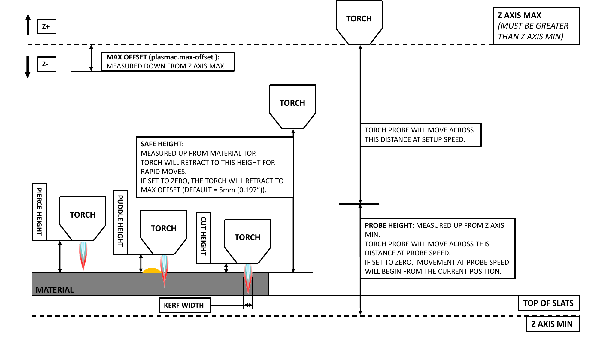

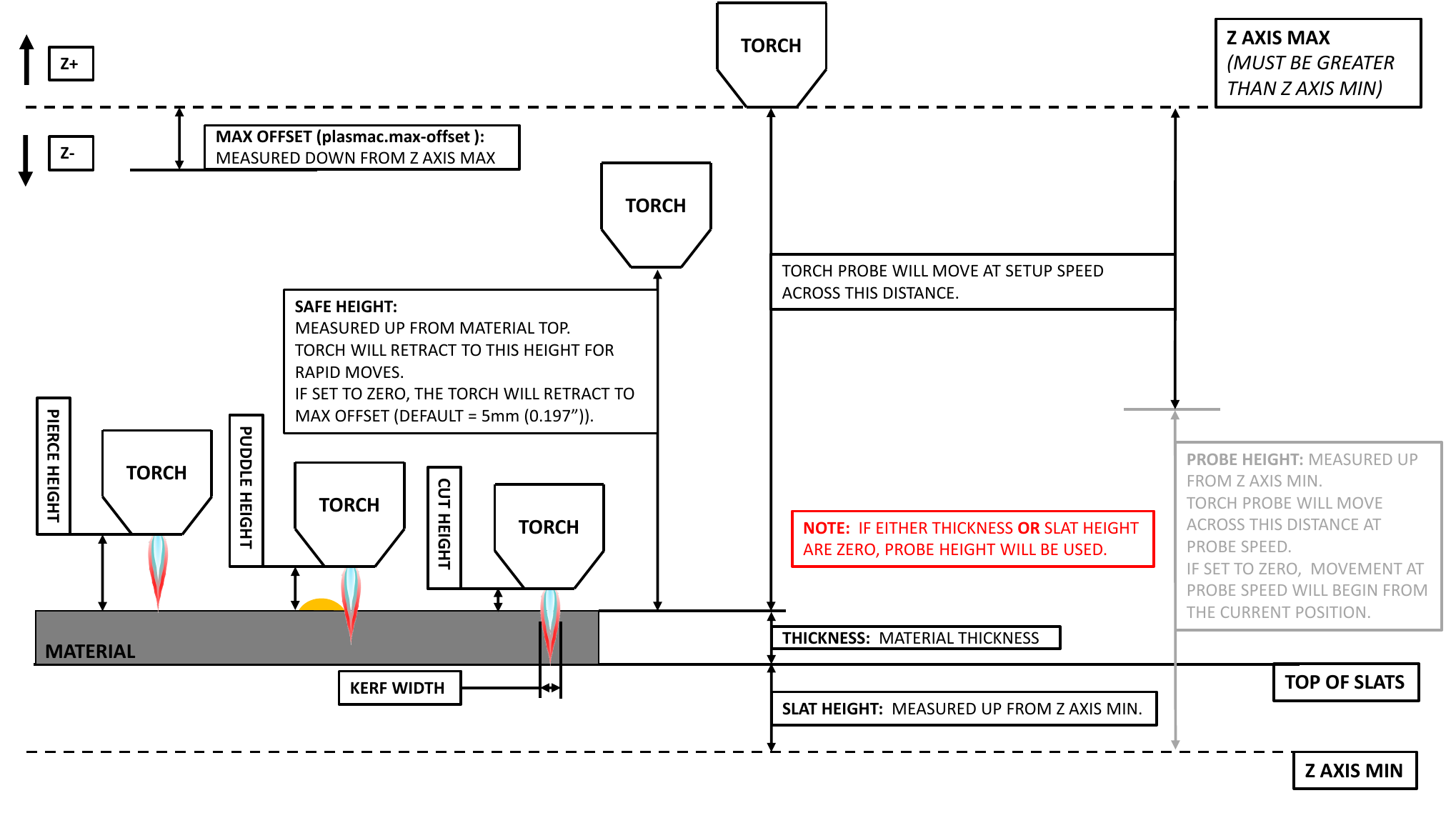

The following heights diagrams will help the user visualize the different heights involved in plasma cutting and how they are measured. There are two different scenarios based on if the user chooses to use Probe Height only, or if the user chooses to use Slat Height AND Material Thickness.
qtplasmac heights diagram probe height
Figure 8. Probe Height Only
qtplasmac heights diagram slat and material height
Figure 9. Slat Height and Material Thickness

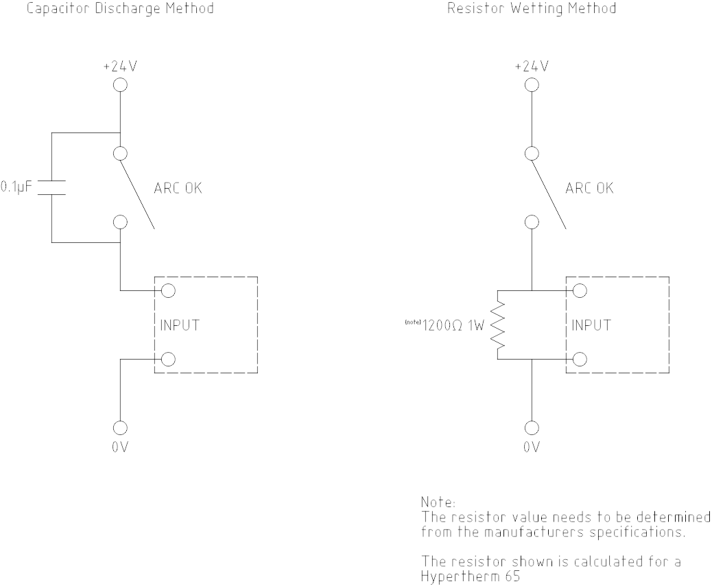

7.3. Contact Load
Mechanical relays and switches usually require a minimum current passing through the contacts for reliable operation. This current varies with the material that the contacts in the device are made from.
Depending on the specified minimum contact current and the current drawn by the input device there may be a need to provide a method to increase the current through the contacts.
Most relays using gold contacts will not require any additional current for reliable operation.
There are two different methods available to provide this minimum current if it is required:
  1. A 0.1 μF film capacitor placed across the contacts.
  2. A 1200 Ω 1 W resistor across the load (see calculations below).
Schematics are shown at contact load schematics.
More information on contact switching load can be seen on page VI of the finder General Technical Information document.
Calculations:
If using a Mesa card, the input resistance of a 7I96 is 4700 Ω (symbol R)(always consult the product manual associated with the revision being used as these values sometimes vary between revisions), giving a contact current of 5.1 mA (symbol I) assuming a supply voltage (symbol U) of 24 V (I = U/R)[1].
As an example, the typical relay used in a Hypertherm Powermax 65 plasma cutter (TE T77S1D10-24) requires a minimum contact load of 100 mA @ 5 VDC which will dissipate 0.5 W (P = I * V). If using a 24 VDC power supply this would then equate to a minimum current of 20.8 mA. Because there is less current drawn by the Mesa input than is required by the relay there needs to be an increase in the current.
The resistance can be calculated using R = Us / (Im - Ii) where:
  • R = calculated resistance
  • Us = supply voltage
  • Im = minimum current required
  • Ii = input current
Using a 7I96 with an input current of 5.1 mA gives a calculated value of 1529 Ω ( = 24 V / (.0208 - .0051) A). This could then be rounded down to a commonly available 1500 Ω resistor, giving a small safety margin.
The power dissipation can by calculated using P = Us2 / Rs where:
  • P = power
  • Rs = selected resistance
This gives a value of 0.38 W. This could then be rounded up to 1 W, giving a good safety margin. The final selection would be a 1500 Ω 1 W resistor.

8.2. MAIN Tab
Screenshot example of the QtPlasmaC MAIN Tab in 16:9 aspect ratio:
qtplasmac 16x9
Some functions/features are only used for particular modes and are not displayed if they are not required by the chosen QtPlasmaC mode.
Table 1. Features of the PREVIEW WINDOW
Name Description
Material
The top header is clickable in this area to reveal a drop-down menu. It is used to manually select the current material cut parameters. If there are no materials in the material file, then only the default material will be displayed.
VEL:
Displays the current feed rate of the table, including both rapid and cutting moves. While cutting, if a Velocity Reduction is active, this label updates to reflect the percentage of the original feed rate being used. For example, "VEL@20%:" means the table is cutting at 20% of the programmed feed rate - an 80% reduction.
FR:
If "View Material" is selected on the SETTINGS Tab, this displays the currently selected material’s Feed Rate.
PH:
If "View Material" is selected on the SETTINGS Tab, this displays the currently selected material’s Pierce Height.
PD:
If "View Material" is selected on the SETTINGS Tab, this displays the currently selected material’s Pierce Delay.
CH:
If "View Material" is selected on the SETTINGS Tab, this displays the currently selected material’s Cut Height.
CA:
If "View Material" is selected on the SETTINGS Tab, and RS485 communications are enabled, this displays the currently selected material’s Cut Amperage.
T
This button changes the preview to a top down full table view.
P
This button changes the preview to an isometric view.
Z
This button changes the preview to a top down view.
This button pans the preview right.
This button pans the preview left.
This button pans the preview up.
This button pans the preview down.
This button zooms the preview.
C
This button clears the live plot.
Table 2. MACHINE representation
Name Description
ESTOP
Setting Estop type = 0 in the [GUI_OPTIONS] section of the <machine_name>.prefs file, will change this button to an indicator of the hardware E-stop’s status only. This is the default behavior.
Setting the option Estop type = 1 in the [GUI_OPTIONS] section of the <machine_name>.prefs file, will hide this button.
Setting the option Estop type = 2 in the [GUI_OPTIONS] section of the <machine_name>.prefs file, will enable this button to act as a GUI E-stop.
POWER
This button turns the GUI on and allows QtPlasmaC/LinuxCNC to control the hardware.
Pressing and holding the POWER button for longer than two seconds will bring up a dialog to exit the QtPlasmaC application.
CYCLE START
This button starts the cycle for any loaded G-code file.
CYCLE PAUSE
This button pauses the cycle for any loaded G-code file.
If a cycle is paused, this button will display CYCLE RESUME and flash.
Pressing CYCLE RESUME will resume the cycle.
CYCLE STOP
This button stops any actively running or paused cycle.
This includes:
- G-code Programs
- Torch pulse if the pulse was started during CYCLE PAUSE (this will cancel the paused G-code program execution as well)
- Probe Test
- Framing
- Manual Cut
FEED
This slider overrides the feed rate for all feed moves.
Any value other than 100% will cause the label to flash.
Clicking the label will return the slider to 100%.
RAPID
This slider overrides the rapid rate for all rapid moves.
JOG
This slider sets the jog rate.
Clicking the label will return the slider to the default linear velocity as set in the <machine_name>.ini file.
BUTTONS
The Button Panel contains buttons useful for the operation of the machine.
The EDIT and MDI buttons are permanent, all other buttons are user programmable in the <machine_name>.prefs file.
See custom user buttons for detailed information on custom user buttons.
Name Description
EDIT
This button opens a G-code editor for the currently loaded program.
MDI
This button places QtPlasmaC into Manual Data Input (MDI) mode which will display the MDI HISTORY and an entry box over top of the G-code window.
Once pressed, this button will display "MDI CLOSE".
Pressing MDI CLOSE will close the MDI.
Please see the MDI section for additional MDI information.
OHMIC TEST
This button will enable the Ohmic Probe Enable output signal and if the Ohmic Probe input is sensed, the LED indicator in the SENSOR Panel will light.
The main purpose of this is to allow a quick test for a shorted torch tip.
PROBE TEST
This button will initiate a Probe Test.
SINGLE CUT
This button will show the dialog box to start an automatic Single Cut.
NORMAL CUT
This button will toggle between Cut Types (NORMAL CUT and PIERCE ONLY).
TORCH PULSE
This button will initiate a Torch Pulse.
Table 3. ARC
Name Modes Description
Arc Voltage
0, 1
Displays the actual arc voltage.
OK
0, 1, 2
Indicates the status of the Arc OK signal.
0, 1
Each press of this button will raise the target voltage by the THC Threshold voltage (The distance changed will be Height Per Volt * THC Threshold voltage).
0, 1
Each press of this button will lower the target voltage by the THC Threshold voltage (The distance changed will be Height Per Volt * THC Threshold voltage).
OVERRIDE
0, 1
Clicking this label will return any voltage override to 0.00.
Table 4. CONTROL
TORCH ON
0, 1, 2
Indicates the status of the Torch On output signal.
TORCH ON ENABLE
0, 1, 2
This box toggles between Enabling and Disabling the torch.
This box defaults to unfilled (disabled) when QtPlasmaC is first run.
This box must be filled to change it to "Torch Enabled" before material cutting can commence.

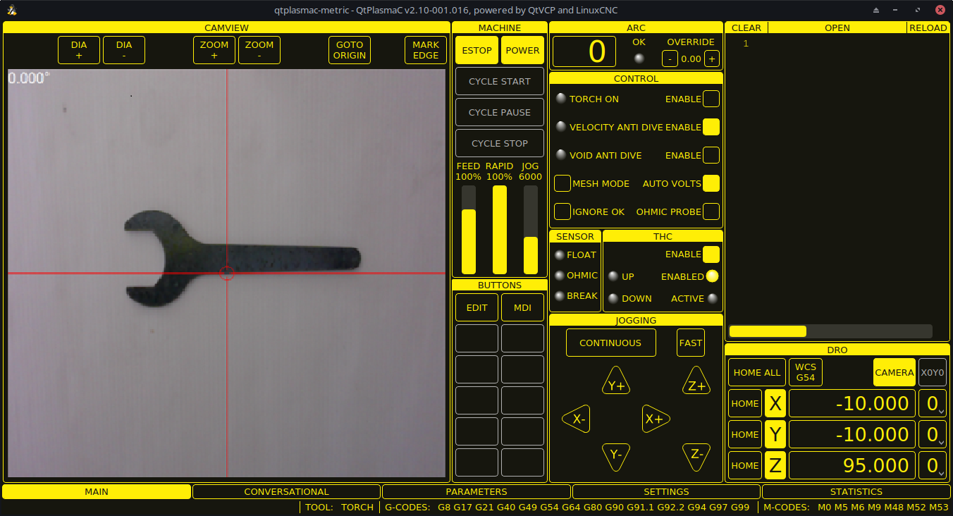

If this box is not filled, then running a loaded program will cause the machine to run the cycle without firing the torch. This is sometimes referred to as a "dry run". If the user has a laser installed, then it is also possible to dry run with the laser. See the LASER section for detailed instructions.
VELOCITY ANTI DIVE
0, 1, 2
Indicates that the THC is locked at the current height due to the cut velocity falling below the Velocity Anti Dive (VAD) Threshold percentage set on the PARAMETERS Tab.
VELOCITY ANTI DIVE ENABLE
0, 1, 2
This box toggles between Enabling and Disabling VELOCITY ANTI DIVE.
VOID ANTI DIVE
0, 1
Indicates that the THC is locked due to a void being sensed.
VOID ANTI DIVE ENABLE
0, 1
This box toggles between Enabling and Disabling VOID ANTI DIVE.
MESH MODE
0, 1, 2
This box will enable or disable Mesh Mode for the cutting of expanded metal. This check box may be enabled or disabled at any time during normal cutting.
Mesh mode:
- Will require an Arc OK signal to start machine motion.
- Will disable the THC.
- Will not stop machine motion if the Arc OK signal is lost.
- Will automatically select CPA mode if PowerMax communications are being used.
For more information see Mesh Mode (expanded metal).
AUTO VOLTS
0, 1
This box will enable or disable Auto Volts.
IGNORE OK
0, 1, 2
This box will determine if QtPlasmaC ignores the Arc OK signal. This check box may be enabled or disabled at any time during normal cutting. Additionally, this mode may be enabled or disabled via proper M codes in a running program.
Ignore Arc OK mode:
- Will not require an Arc OK signal be received before starting machine motion after the "Torch On" signal is given.
For more information see Ignore Arc Ok.
OHMIC PROBE
0, 1, 2
This box enables or disables the ohmic probe input.
If the Ohmic Probe input is disabled, the Ohmic Probe LED will still show the status of the probe input, but the Ohmic Probe results will be ignored.
RS485
0, 1, 2
This box will enable or disable the communications to a PowerMax. This button is only visible if a PM_PORT option is configured in the [POWERMAX] section of the <machine_name>.prefs file.
Status
0, 1, 2
When PowerMax communications are enabled, this will display one of the following:
CONNECTING, CONNECTED, COMMS ERROR, or a Fault Code.
For more information, see the PowerMax Communications section.
Table 5. SENSOR
Name Description
FLOAT
Indicates that the float switch is activated.
OHMIC
Indicates that the probe has sensed the material.
BREAK
Indicates that the torch breakaway sensor is activated.
Table 6. THC
Name Description
ENABLE
This box determines whether the THC will be enabled or disabled during a cut.
ENABLED
This LED indicates whether the THC is enabled or disabled.
ACTIVE
This LED indicates that the THC is actively controlling the Z axis.
UP
This LED indicates that the THC is commanding the Z axis to raise.
DOWN
This LED indicates that the THC is commanding the Z axis to lower.
Note
JOGGING
During Paused Motion, this section will become CUT RECOVERY
Name Description
CONTINUOUS
This drop-down button will change the jog increment. Options are determined by the values in the [DISPLAY] section of the <machine_name>.ini file and begin with the label "INCREMENTS =".
FAST
This button will toggle between FAST which is the default linear velocity in the <machine_name>.ini file or SLOW which is 10% of the default value.
Y+
This button moves the Y axis in the positive direction.
Y-
This button moves the Y axis in the negative direction.
X+
This button moves the X axis in the positive direction.
X-
This button moves the X axis in the negative direction.
Z+
This button moves the Z axis in the positive direction.
Z-
This button moves the Z axis in the negative direction.
Note
CUT RECOVERY
During Paused Motion, this section will be shown on top of the JOGGING panel. The following section will cover each button encountered in this panel. Please see CUT RECOVERY for a detailed description of the cut recovery functionality.
Name Description
PAUSED MOTION FEED SLIDER
In the event of a paused program, this interface allows X/Y motion to follow the programmed path in the reverse or forward direction.
This slider’s range is from 1%-100% of the Cut Feed Rate for the currently selected material.
FEED
This displays the paused motion feed rate.
REV
In the event of a paused program, this button will move the machine in reverse along the programmed path until it reaches the last M3 command that was either executed or that QtPlasmaC was attempting to execute before the program became paused.
FWD
In the event of a paused program, this button will move the machine forward along the programmed path indefinitely until the program’s end, skipping over M3 commands.
CANCEL MOVE
This button will cancel any Cut Recovery movement that was made and return the torch to the position the Cut Recovery movement was initiated.
Note that if FWD or REV were used to move the torch, CANCEL will not return to the position of the torch when the pause occurred.
MOVE x.xxx
This displays the amount of travel that will be incurred with each press of an arrow key, in the direction the arrow key was pressed.
This value displayed below MOVE represents the Kerf Width of the currently selected material.
DIRECTIONAL ARROWS
These buttons will move the torch in the direction indicated by a distance of one Kerf Width (of the currently selected material) per press.
Table 7. G-CODE WINDOW
Name Description
CLEAR
This button will clear the currently opened program.
If a file is open, the default material will be selected.
If no file is open, the preview will be reset to a top down full table view.
The torch (T0) will be selected if it was not the active tool.
Previous error messages, and the error status will be cleared.
Cut type will be set to NORMAL CUT.
OPEN
This button will open a FILE OPEN panel over the PREVIEW WINDOW.
RELOAD
This button will reload the currently loaded G-code File.
Table 8. DRO
Name Description
HOME ALL
This button will home all of the axes in the order set by HOME_SEQUENCE in the <machine_name>.ini file.
WCS G54
This drop-down button will change the current work offset.
CAMERA
This button will display a CAMVIEW panel on top of the PREVIEW WINDOW and will allow the user to set an origin with or without rotation. See the CAMERA section for detailed instructions. This button will not be visible until a CAMERA offset is set in the <machine_name>.prefs file.
LASER
This button will allow the user to use a laser to set an origin with or without rotation. See the LASER section for detailed instructions. This button will not be visible until a LASER offset is set in the <machine_name>.prefs file.
X0 Y0
This button will set the current position to X0 Y0.
HOME [AXIS]
This button will home the corresponding axis.
0 [AXIS]
This drop-down button will display the following options:
Zero - zeros the axis.
Set - launches a dialog box to manually input the axis' coordinate.
Divide By 2 - divides the currently displayed coordinate in the DRO by two.
Set To Last - sets the axis to the previously set coordinate.
8.3. Preview Views
The QtPlasmaC preview screen has the ability to be switched between different views and displays, as well as zooming in and out, and panning horizontally and vertically.
When QtPlasmaC is first started, the Z (top down) view will be selected as the default view for a loaded G-code file, but the full table view will be displayed.
When a G-code file is loaded, the display will change to the selected view.
Whenever there is no G-code file loaded, the full table will automatically be displayed irrespective of which view is currently selected (the highlighted button representing the currently selected view will not change).
If a full table is displayed due to no G-code file being loaded and the user wishes to change the view orientation, then pressing either Z or P will change the display to the newly selected view. If the user then wishes to display the full table while maintaining the currently selected view as the default view for a loaded G-code file, then pressing CLEAR will achieve this and allow the selected view orientation to prevail the next time a G-code file is loaded.

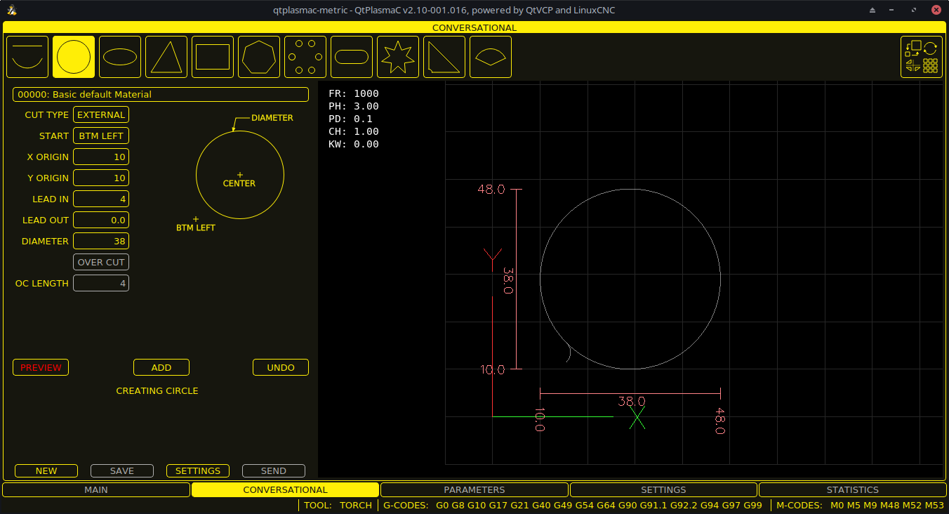

8.4. CONVERSATIONAL Tab
Screenshot example of the QtPlasmaC CONVERSATIONAL Tab in 16:9 aspect ratio:
qtplasmac conversational
The CONVERSATIONAL Tab enables the user to quickly program various simple shapes for quick cutting without the need for CAM software.
See Conversational Shape Library for detailed information on the Conversational feature.
It is possible to hide this tab so the conversational feature cannot be used by an operator. This may be achieved either by wiring the pin to a physical key-switch or similar or it may also be set in a HAL file using the following command:
setp qtplasmac.conv_disable 1

Float Travel
This sets the amount of travel the float switch moves before completing the float switch circuit. This distance can be measured by using the Probe Test button, and the method described in Initial Setup.
Probe Speed
This sets the speed at which the torch will probe to find the material after it moves to the Probe Height.
Probe Height
This sets the height above the Z axis minimum limit that Probe Speed begins. If set to zero, then the torch will move at Probe Speed from the current position. This may be adventageous when using Slat Height and Material Thickness as the machine will default to Probe Height if either Slat Height or Material Thickness are zero. Refer to the Heights Diagrams for a visual representation.
Slat Height
This sets the height of the slats, measured up from Z axis minimum limit. This must be used in conjunction with Material Thickness. If either Slat Height or Material Thickness are zero then the machine will default to Probe Height. Refer to the Heights Diagrams for a visual representation.
Ohmic Offset
This sets the distance above the material the torch will should go after a successful ohmic probe. It is mainly used to compensate for high probing speeds.
Ohmic Retries
This sets the number of times QtPlasmaC will retry a failed ohmic probe before falling back to the float switch for material detection.
Skip IHS
This sets the distance threshold used to determine if an Initial Height Sense (probe) can be skipped for the current cut, see IHS Skip.
Offset Speed
This sets the speed at which the probe will move to the offset position in the X axis and Y axis.
Note
If the amount of time between the torch contacting the material and when the torch moves up and comes to rest at the Pierce Height seems excessive, see the probing section for a possible solution.
Table 11. CONFIGURATION - SAFETY
Name Description
Safe Height
This sets the height above the material that the torch will retract to before executing rapid moves.
If set to zero, then Max Offset (plasmac.max-offset) will be used for the safe height. This defaults to 5mm (0.197"). Refer to the Heights Diagrams for a visual representation.

Thickness
This sets the thickness for the currently selected material. This must be used in conjunction with Slat Height. If either Slat Height or Material Thickness are zero then the machine will default to Probe Height. Refer to the Heights Diagrams for a visual representation.
Kerf Width
This sets the kerf width for the currently selected material. Refer to the Heights Diagrams for a visual representation.
Pierce Height
This sets the pierce height for the currently selected material. Refer to the Heights Diagrams for a visual representation.
Pierce Delay
This sets the pierce delay (in seconds) for the currently selected material.
Cut Height
This sets the cut height for the currently selected material. Refer to the Heights Diagrams for a visual representation.
Cut Feed Rate
This sets the cut feed rate for the currently selected material.
Cut Amps
This sets the cut amperage for the currently selected material.
This is a visual indicator to the operator only, unless PowerMax communications are being used.
Cut Volts
This sets the cut voltage for the currently selected material.
Puddle Height
Expressed as a percentage of Pierce Height, this sets the Puddle Jump height for the currently selected material.
Typically used for thicker materials, Puddle Jump allows the torch to have an intermediate step between Pierce Height and Cut Height.

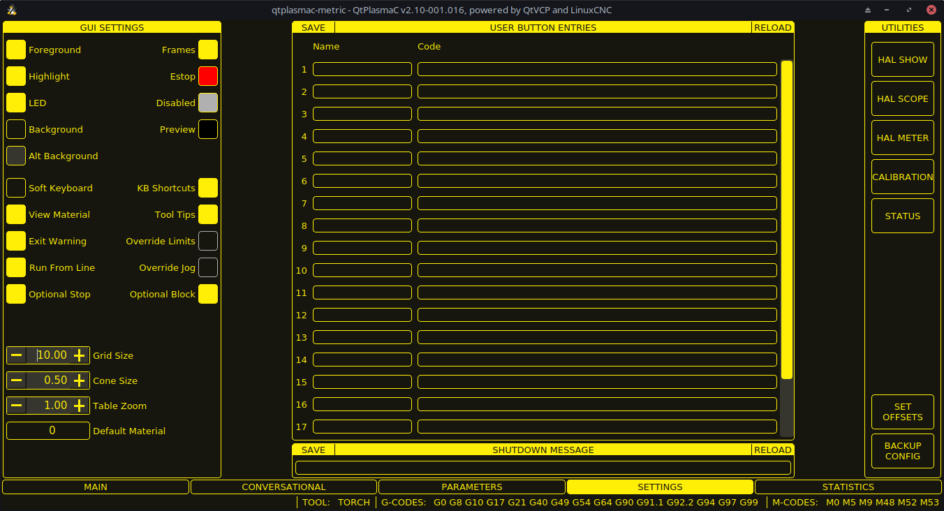

8.6. SETTINGS Tab
Screenshot example of the QtPlasmaC SETTINGS Tab in 16:9 aspect ratio:
qtplasmac settings
This tab is used to display GUI configuration parameters, button text, and shutdown text that are modified infrequently as well as some utility buttons.
It is possible to hide this tab so machine settings cannot be modified by unauthorized personnel. This may be achieved either by wiring the pin to a physical key-switch or similar or it may also be set in a HAL file using the following command:
setp qtplasmac.settings_disable 1
GUI SETTINGS
This section shows parameters that effect the GUI appearance and GUI behaviors.
To return any of the color changes to their default values, see the Returning To The Default Styling section.
Table 18. GUI SETTINGS Parameters that effect the GUI appearance and GUI behaviors.
Name Description
Foreground
This button allows the user to change the color of the GUI Foreground.
Highlight
This button allows the user to change the color of the GUI Highlight.
LED
This button allows the user to change the color of the GUI LED.
Background
This button allows the user to change the color of the GUI Background.
Alt Background
This button allows the user to change the color of the GUI Alternate Background.
Frames
This button allows the user to change the color of the GUI Frames.
Estop
This button allows the user to change the color of the GUI Estop.
Disabled
This button allows the user to change the color of the GUI’s Disabled features.
Preview
This button allows the user to change the color of the GUI Preview Window Background.
Soft Keyboard
This radio button allows the user to enable or disable the soft touchscreen keyboard.
If the "onboard" virtual keyboard is installed then the custom layouts will be enabled.
KB Shortcuts
This radio button allows the user to enable or disable Keyboard Shortcuts within the GUI (such as keyboard jogging).
In addition to the standard jog keys, a list of the additional shortcuts is available in the keyboard shortcuts section.
View Material
This radio button allows the user to enable or disable the addition of a visual reference showing key material cut settings to the Preview Windows of the MAIN and CONVERSATIONAL tabs.
Examples are: Feed Rate, Pierce Height, Pierce Delay, and Cut Height. Cut Amps will be shown if PowerMax communications are enabled.
Exit Warning
This radio button allows the user to enable or disable whether a warning will always be displayed during shutdown.
It is possible to add a custom message to the warning by editing the EXIT WARNING MESSAGE option in the [GUI_OPTIONS] section of the <machine_name>.prefs file.
The custom message can be made multi-line by adding a "\" between lines.
Optional Stop
This radio button allows the user to enable or disable whether or not a running program will pause at an M1 command.
Run From Line
This radio button allows the user to enable or disable Run From Line. If enabled, the user can click on a line of G-code and have the program start from that line.
Override Limits
This radio button allows the user to temporarily Override the input from a Limit Switch in the event the limit switch becomes tripped during operation. This button can only be clicked when a limit switch is tripped.
Override Jog
This radio button will also allow jogging while jogging is inhibited due to a float switch, breakaway switch, or ohmic probe activation. This button can only be clicked when a jog is inhibited.
Optional Block
This radio button allows the user to enable or disable whether or not lines starting with "/" will be skipped if present in a running program.
Grid Size
This allows a user to change the size of the grid in the Preview Window on the MAIN Tab. Grid size of 0.0 will disable the grid.
Cone Size
This allows a user to change the size of the cone (which represents the current tool) in the Preview Window on the MAIN Tab.
Table Zoom
This allows a user to change the default zoom level for the top down full table view in the Preview Window on the MAIN Tab.
USER BUTTON ENTRIES USERBUTTON
This section shows the text that appears on the Custom User Buttons as well as the code associated with the user button. User buttons may be changed, and the new settings used without restarting LinuxCNC.
The text and/or code may be edited at any time and will be loaded ready for use if the SAVE button is clicked.
Deleting the Name and Code text will cause that user button to be hidden if the SAVE button is clicked.
To return all the Name and Code text to their last saved values press the RELOAD button.
Name Code
The text that is displayed on the button
The code that is run when the button is pressed.
Note
There are 20 user buttons available but not all may be displayed depending on the window size.
This section shows the text that appears on the shutdown dialog if the Exit Warning is enabled.
The text may be edited at any time and will be loaded ready for use if the SAVE button is clicked.
To return the EXIT WARNING MESSAGE text to the last saved value press the RELOAD button.
UTILITIES
Some standard LinuxCNC utilities are provided as an aid in the diagnosis of issues that may arise:
In addition the following two QtPlasmaC specific utilities are provided:
The SET OFFSETS button is used if the table has a laser or camera for sheet alignment, a scribe, or uses offset probing. The required offsets for these peripherals need to be applied by following the procedure described in Peripheral Offsets.
The BACKUP CONFIG button will create a complete machine configuration backup for archiving or to aid in fault diagnosis. A compressed backup of the machine configuration will be saved in the user’s Linux home directory. The file name will be <machine_name><version><date>_<time>.tar.gz, where <machine_name> is the machine name entered in the configuration wizard, <version> is the current QtPlasmaC version the user is on, <date> is the current date (YY-MM-DD), and <time> is the current time (HH-MM-SS).
Prior to the backup being made, the machine log will be saved to a file in the configuration directory named machine_log_<date>_<time>.txt where <date> and <time> are formatted as described above. This file along with up to five previous machine logs will also be included in the backup.
These files are not required by QtPlasmaC and are safe to delete at any time.

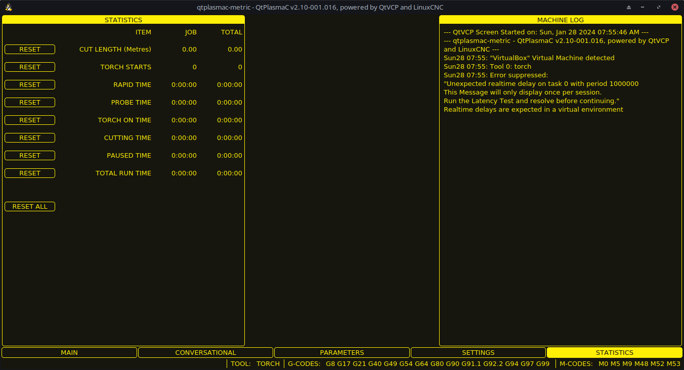

8.7. STATISTICS Tab
The STATISTICS Tab provides statistics to allow for the tracking of consumable wear and job run times. These statistics are shown for the current job as well as the running total. Previous job statistics are reset once the next program is run. The total values may be reset either individually by clicking the corresponding "RESET" button, or they may all be reset together by clicking "RESET ALL".
The RS485 PMX STATISTICS panel will only be displayed if the user has Hypertherm PowerMax communications and a valid RS485 connection to the PowerMax is established. This panel will show the ARC ON TIME for the PowerMax in hh:mm:ss format.
The MACHINE LOG is also displayed on the STATISTICS Tab, this log will display any errors and/or important information that occurs during the current LinuxCNC session. If the user makes a backup of the configuration from the SETTINGS Tab then the machine log is also included in the backup.
qtplasmac stats

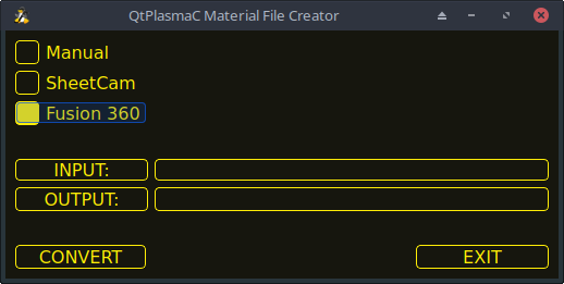

This will bring up the Material Converter Main dialog box with Manual selected as the default.
Select one of:
  • Manual - to manually create a new material file.
qtplasmac material main manual
  • SheetCam - to convert a SheetCam tool file.
qtplasmac material main sheetcam
For SheetCam only, select whether the user requires a metric or imperial output file.
  • Fusion 360 - to convert a Fusion 360 tool file.
qtplasmac material main fusion360
To convert:
  1. Select the Input File to be converted, press INPUT to bring up a file selector or directly enter the file in the entry box.
  2. Select the Output File to write to, press OUTPUT to bring up a file selector or directly enter the file in the entry box. This would normally be ~/linuxcnc/configs/<machine_name>_material.cfg. If necessary, the user could select a different file and hand edit the <machine_name>_material.cfg file.
  3. Click CREATE/CONVERT and the new material file will be created.

9.12. CAMERA
qtplasmac camview
QtPlasmaC has the ability to use a USB camera to set the origin with or without rotation compensation. Rotation compensation can be used to align the work offset to a sheet of material with edge(s) that are not parallel to the machine’s X/Y axes. The CAMERA button will be enabled after the machine is homed. This button will not be visible until a CAMERA offset is set in the <machine_name>.prefs file.
To use this feature, the user must set the camera’s offset from the torch center by following the procedure described in Peripheral Offsets.
To modify the offsets manually, the user could edit either or both the following axes options in the [CAMERA_OFFSET] section of the <machine_name>.prefs file:
X axis = n.n
Y axis = n.n
Camera port = 0
where n.n is distance from the center line of the torch to the camera’s cross hairs.
To set the origin with zero rotation:
  1. Jog until the cross hairs are on top of the desired origin point.
  2. Press MARK EDGE. The MARK EDGE button label will change to SET ORIGIN and the GOTO ORIGIN button will be disabled.
  3. Press SET ORIGIN. The SET ORIGIN button label will change to MARK EDGE and the GOTO ORIGIN button will be enabled.
  4. The torch will now move to the X0 Y0 position.
  5. The offset is now successful set.
To set the origin with rotation:
  1. Jog until the cross hairs are at the edge of the material a suitable distance away from the desired origin point.
  3. Jog until the cross hairs are at the origin point of the material.
  4. Press SET ORIGIN. The SET ORIGIN button label will change to MARK EDGE and the GOTO ORIGIN button will be enabled.
  5. The torch will now move to the X0 Y0 position.
  6. The offset is now successfully set.
In the CAMVIEW panel, the mouse can affect the cross hairs, and the zoom level as follows:
  • Mouse Wheel Scroll - Change cross hair diameter.
  • Mouse Wheel Button Double Click - Restores cross hair diameter to default.
  • Mouse Left Button Clicked + Wheel Scroll - Changes camera zoom level.
  • Mouse Left Button Clicked + Wheel Button Double Click - Restores default camera zoom level.

9.21. Probing
Probing may be done with either ohmic sensing or a float switch. It is also possible to combine the two methods, in which case the float switch will provide a fallback to ohmic probing. An alternative to ohmic probing is Offset Probing
If the machine’s torch does not support ohmic probing, the user could have a separate probe next to the torch. In this case the user would extend the probe below the torch. The probe must NOT extend more than the minimum Cut Height below the torch and the Z axis offset distance needs to be entered as the Ohmic Offset in the PROBING frame of the CONFIGURATION section of the PARAMETERS Tab.
Probing setup is done in the PROBING frame of the CONFIGURATION section of the PARAMETERS Tab.
QtPlasmaC can probe at the full Z axis velocity so long as the machine has enough movement in the float switch to absorb any overrun. If the machine’s float switch travel is suitable, the user could set the Probe Height to near the Z axis MINIMUM_LIMIT and do all probing at full speed.
Some float switches can exhibit a large switching hysteresis which shows up in the probing sequence as an excessive time to complete the final probe up.
  • This time may be decreased by changing the speed of the final probe up.
  • This speed defaults to 0.001 mm (0.000039") per servo cycle.
  • It is possible to increase this speed by up to a factor of 10 by adding the following line to the custom.hal file:
setp plasmac.probe-final-speed n
where n is a value from 1-10. It is recommended to keep this value as low as possible.
Using this feature will change the final height slightly and will require thorough probe testing to confirm the final height.
This speed value affects ALL probing so if the user uses ohmic probing and the user changes this speed value then the user will need to probe test to set the require offset to compensate for this speed change as well as the float travel.
The reliability of this feature will only be as good as the repeatability of the float switch.
Note
Probe Height refers to the height above the Z axis MINIMUM_LIMIT.

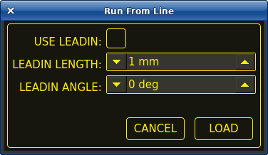

9.32.1. HERE TO END
HERE TO END will run from the beginning of the selected line to the end of the G-code file. The user will be presented with the option of adding a lead-in if the selected line falls within an "active" cutting operation (between an M3 and M5).
qtplasmac rfl here to end
Name Description
USE LEADIN
This radio button will allow the user to start the selected line with a lead-in.
LEADIN LENGTH
If USE LEADIN is selected, this will set the length of the lead in the machine units.
LEADIN ANGLE
If USE LEADIN is selected, this will set the angle of approach for the lead-in.
The angle is measured such that positive increases in value move the lead-in counterclockwise:
0 Degrees = 3 o’clock position
90 Degrees = 12 o’clock position
180 Degrees = 9 o’clock position
270 Degrees = 6 o’clock position
CANCEL
This button will cancel the Run From Line dialog box and any selections.
LOAD
This button will load a temporary "rfl.ngc" program with any selected lead-in parameters applied.
If the lead-in cannot be calculated for the selected line, the following error message will be displayed:
"Unable to calculate a lead-in for this cut
Program will run from selected line with no lead-in applied"
After pressing LOAD, the blinking "SELECTED nn" button will change to RUN FROM LINE CYCLE START button. Click this button to start the program from the beginning of the selected line.

10.3. Conversational Single Shape
The following shapes are available for creation:
qtplasmac conv shapes
To create a shape:
  1. Select the corresponding icon for the shape to create. The available parameters will be displayed.
  2. Choose the material from the MATERIAL drop-down. If no material is chosen, the default material (00000) will be used.
  3. Enter the appropriate values and press PREVIEW to display the shape.
  4. If the shape is not correct, edit the values and press PREVIEW and the new shape will be displayed. Repeat until satisfied with the shape.
  5. Press ADD to add the shape to the G-code file.
  6. Press SEND to send the G-code file to LinuxCNC (QtPlasmaC) for cutting.
For CIRCLE, the OVER CUT button will become valid when a CUT TYPE of INTERNAL is selected and the value entered in the DIAMETER field is less than the Small Hole Diameter parameter in the Conversational SETTINGS section.

11.1. Error Logging
All errors are logged into the machine log which is able to be viewed in the STATISTICS Tab. The log file is saved into the configuration directory when QtPlasmaC is shutdown. The five last logfiles are kept, after which the oldest logfile is deleted each time a new log file is created. These saved log files may be viewed with any text editor.

15. QtPlasmaC Advanced Topics
15.1. Custom User Buttons
The QtPlasmaC GUI offers user buttons that can be customized by adding commands in the USER BUTTON ENTRIES section of the SETTINGS Tab in the <machine_name>.prefs file.
The number of user buttons varies by display type and resolution as follows:
  • 16:9 and 4:3 - Minimum 8, Maximum 20
  • 9:16 - Minimum 15, Maximum 20
The user will need to run QtPlasmaC at the desired screen size to determine how many user buttons are available for use.
All <machine_name>.prefs file settings for the buttons are found in the [BUTTONS] section.

15.10. Max Offset
Max Offset is the distance (in millimeters) away from the Z MAX_LIMIT that QtPlasmaC will allow the Z axis to travel while under machine control.
The pin for adjusting this value is named plasmac.max-offset and the default value (in millimeters) is set to 5. To change this value, add the pin and the required value to the custom.hal file. It is not recommended to use values less than 5 mm as offset overrun may cause unforeseen issues.
The following example would set the distance from Z MAX_LIMIT to 10 mm:
setp plasmac.max-offset 10

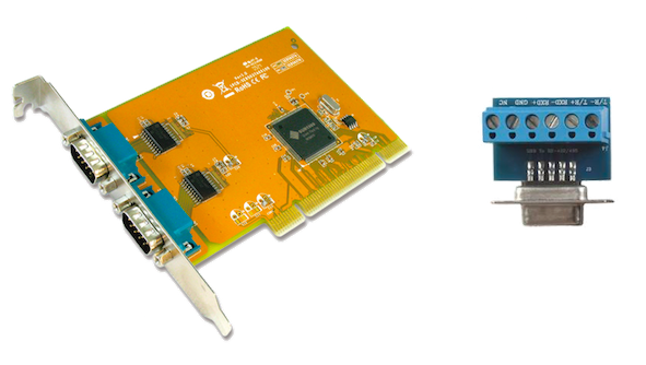

The following is necessary to convert a motherboard Serial connection or Serial card (RS232) to RS485:
DTECH RS-232 to RS-485 converter:
qtplasmac rs485 converter
Serial card example (Sunnix SER5037A PCI Card shown with Breakout Board):
qtplasmac rs485 sunnix

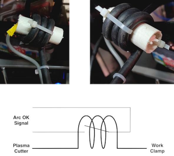

17.7. Arc OK With A Reed Relay
An effective and very reliable method of obtaining an Arc OK signal from a plasma power supply without a CNC port is to mount a reed relay inside a non-conductive tube and wrap and secure three turns of the work lead around the tube.
This assembly will now act as a relay that will switch on when current is flowing through the work lead which only occurs when a cutting arc has been established.
This will require that QtPlasmaC be operated in Mode 1 rather than Mode 0. See the QtPlasmaC Modes sections for more information.
qtplasmac reed arc ok
17.8. Contact Load Schematics
qtplasmac relay contact
A full description is at Contact Load.
