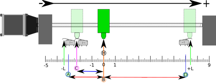

3. Separate Home Switch Example Layout
This example shows minimum and maximum limit switches with a separate home switch.
Example Homing Switch layout
Figure 1. Demonstrative Separate Switch Layout
  • A is the negative soft limit
  • B is the G53 machine coordinate Origin
  • C is the home switch trip point
  • D is the positive soft limit
  • H is the final home position (HOME) = 0 units
  • The -L and +L are the limit switches trip points
  • A<→B is the negative soft limits (MIN_LIMITS) = -3 units
  • B<→C is the home_offset (HOME_OFFSET) = -2.3 units
  • B<→D is the positive soft limits (MAX_LIMITS) = 7 units
  • A<→D is the total travel = 10 units
  • The distance between the limit switches and soft limits (-L<→A and D←+L) is magnified in this example
  • Note that there is distance between the limit switches and actual physical hard contact for coasting after the amplifier is disabled.

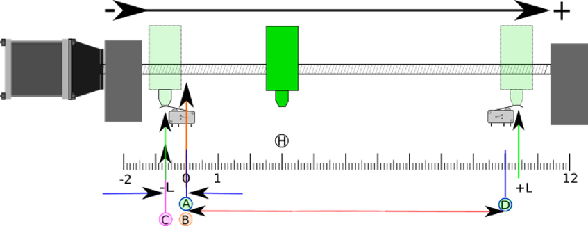

4. Shared Limit/Home Switch Example Layout
This example shows a maximum limit switch and a combined minimum limit/home switch.
Example shared Home Limit Switch layout
Figure 2. Demonstrative Shared Switch Layout
  • A is the negative soft limit.
  • B is the G53 machine coordinate Origin.
  • C is the home switch trip point shared with (-L) minimum limit trip.
  • D is the positive soft limit.
  • H is the final home position (HOME) = 3 units.
  • The -L and +L are the limit switch trip points.
  • A<→B is the negative soft limits (MIN_LIMITS) = 0 units.
  • B<→C is the home_offset (HOME_OFFSET) = -0.7 units.
  • B<→D is the positive soft limits (MAX_LIMITS) 10 units.
  • A<→D is the total travel = 10 units.
  • The distance between the limits switches and soft limits (-L<→A and D<→+L) is magnified in this example.

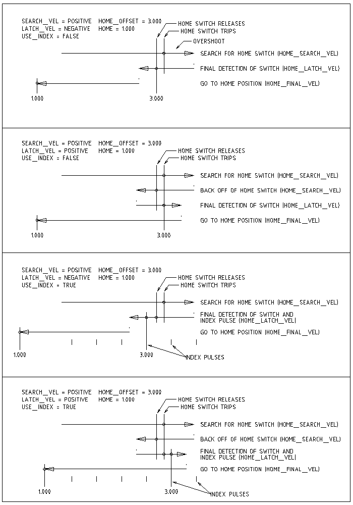

5. Homing Sequence
There are four possible homing sequences defined by the sign of HOME_SEARCH_VEL and HOME_LATCH_VEL, along with the associated configuration parameters as shown in the following table. Two basic conditions exist, HOME_SEARCH_VEL and HOME_LATCH_VEL are the same sign or they are opposite signs. For a more detailed description of what each configuration parameter does, see the following section.
