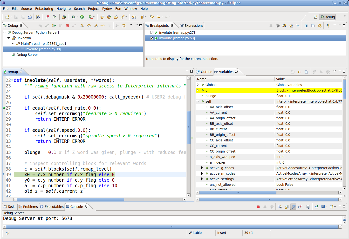

The following example is based on the nc_files/involute.py script - but canned as a G-code with some parameter extraction and checking. It also demonstrates calling the interpreter recursively (see self.execute()).
Assuming a definition like so (NB: this does not use argspec):
REMAP=G88.1 modalgroup=1 py=involute
The involute function in python/remap.py listed below does all word extraction from the current block directly. Note that interpreter errors can be translated to Python exceptions. Remember this is readahead time - execution time errors cannot be trapped this way.
import sys
import traceback
from math import sin,cos
from interpreter import *
from emccanon import MESSAGE
from util import lineno, call_pydevd
# raises InterpreterException if execute() or read() fails
throw_exceptions = 1
def involute(self, **words):
""" remap function with raw access to Interpreter internals """
if self.debugmask & 0x20000000: call_pydevd() # USER2 debug flag
if equal(self.feed_rate,0.0):
return "feedrate > 0 required"
if equal(self.speed[0], 0.0):
return "spindle speed > 0 required"
plunge = 0.1 # if Z word was given, plunge - with reduced feed
# inspect controlling block for relevant words
c = self.blocks[self.remap_level]
x0 = c.x_number if c.x_flag else 0
y0 = c.y_number if c.y_flag else 0
a = c.p_number if c.p_flag else 10
old_z = self.current_z
if self.debugmask & 0x10000000:
print("x0=%f y0=%f a=%f old_z=%f" % (x0,y0,a,old_z))
try:
#self.execute("G3456") # would raise InterpreterException
self.execute("G21",lineno())
self.execute("G64 P0.001",lineno())
self.execute("G0 X%f Y%f" % (x0,y0),lineno())
if c.z_flag:
feed = self.feed_rate
self.execute("F%f G1 Z%f" % (feed * plunge, c.z_number),lineno())
self.execute("F%f" % (feed),lineno())
for i in range(100):
t = i/10.
x = x0 + a * (cos(t) + t * sin(t))
y = y0 + a * (sin(t) - t * cos(t))
self.execute("G1 X%f Y%f" % (x,y),lineno())
if c.z_flag: # retract to starting height
self.execute("G0 Z%f" % (old_z),lineno())
except InterpreterException,e:
msg = "%d: '%s' - %s" % (e.line_number,e.line_text, e.error_message)
return msg
return INTERP_OK

12.5. Debugging Embedded Python code
Debugging of embedded Python code is harder than debugging normal Python scripts, and only a limited supply of debuggers exists. A working open-source based solution is to use the Eclipse IDE, and the PydDev Eclipse plug in and its remote debugging feature.
To use this approach:
Install Eclipse via the the Ubuntu Software Center (choose first selection).
Install the PyDev plug in from the Pydev Update Site.
Setup the LinuxCNC source tree as an Eclipse project.
Start the Pydev Debug Server in Eclipse.
Make sure the embedded Python code can find the
pydevd.pymodule which comes with that plug in - it is buried somewhere deep under the Eclipse install directory. Set the thepydevdvariable inutil.pyto reflect this directory location. -
Add
import pydevdto your Python module - see exampleutil.pyandremap.py. -
Call
pydevd.settrace()in your module at some point to connect to the Eclipse Python debug server - here you can set breakpoints in your code, inspect variables, step etc. as usual.
Caution
pydevd.settrace() will block execution if Eclipse and the Pydev debug server have not been started.
To cover the last two steps: the o<pydevd> procedure helps to get into the debugger from MDI mode. See also the call_pydevd function in util.py and its usage in remap.involute to set a breakpoint.
Here’s a screen-shot of Eclipse/PyDevd debugging the involute procedure from above:
See the Python code in configs/sim/axis/remap/getting-started/python for details.
