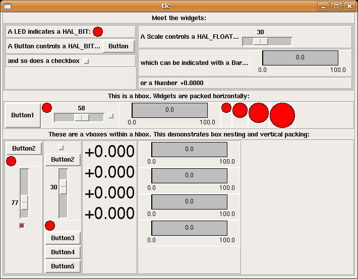

The following graphic displays many of the PyVCP widgets.
pyvcp group
Figure 1. PyVCP Widgets Showcase

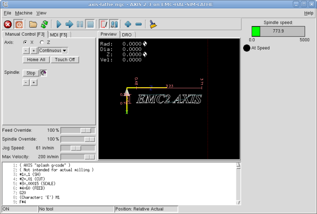

pyvcp axis lathe
This is what the newly created PyVCP panel should look like in AXIS. The sim/lathe configuration is already configured this way.
