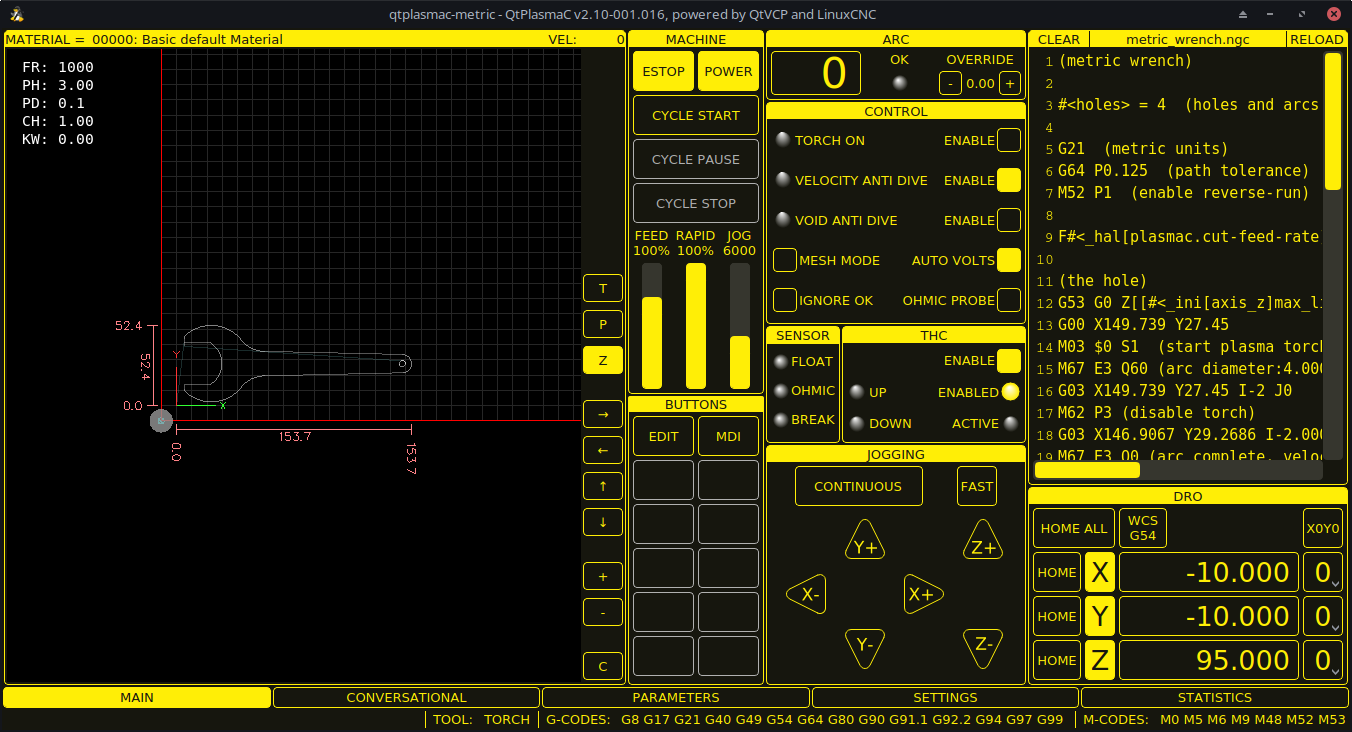

QtPlasmaC
QtPlasmaC, a touch screen plasma cutting GUI based on QtVCP using the PyQt5 library. It comes in three aspect ratios, 16:9, 4:3, and 9:16.
Figure 9. QtPlasmaC, a touch screen plasma cutting GUI based on QtVCP
