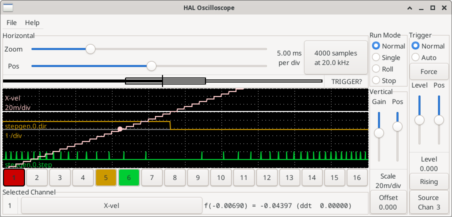

7. Halscope
The previous example generates some very interesting signals. But much of what happens is far too fast to see with halmeter. To take a closer look at what is going on inside the HAL, we want an oscilloscope. Fortunately HAL has one, called halscope.
Halscope tiene dos partes - una parte en tiempo real que lee señales HAL, y una parte en tiempo no-real que proporciona la GUI y la pantalla. Sin embargo, usted no necesita preocuparse por esto, porque la porción en tiempo no-real cargará automáticame la parte en tiempo real cuando se necesite.
With LinuxCNC running in a terminal you can start halscope with the following command.
halcmd loadusr halscope

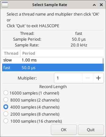

If LinuxCNC is not running or the autosave.halscope file does not match the pins available in the current running LinuxCNC the scope GUI window will open, immediately followed by a Realtime function not linked dialog that looks like the following figure. To change the sample rate left click on the samples box.
This dialog is where you set the sampling rate for the oscilloscope. For now we want to sample once per millisecond, so click on the 1.00 ms thread slow and leave the multiplier at 1. We will also leave the record length at 4000 samples, so that we can use up to four channels at one time. When you select a thread and then click OK, the dialog disappears, and the scope window looks something like the following figure.
7.1. Hooking up the scope probes
At this point, Halscope is ready to use. We have already selected a sample rate and record length, so the next step is to decide what to look at. This is equivalent to hooking virtual scope probes to the HAL. Halscope has 16 channels, but the number you can use at any one time depends on the record length - more channels means shorter records, since the memory available for the record is fixed at approximately 16,000 samples.
The channel buttons run across the bottom of the halscope screen. Click button 1, and you will see the Select Channel Source dialog as shown in the following figure. This dialog is very similar to the one used by Halmeter. We would like to look at the signals we defined earlier, so we click on the Signals tab, and the dialog displays all of the signals in the HAL (only two for this example).
To choose a signal, just click on it. In this case, we want channel 1 to display the signal X-vel. Click on the Signals tab then click on X-vel and the dialog closes and the channel is now selected.
The channel 1 button is pressed in, and channel number 1 and the name X-vel appear below the row of buttons. That display always indicates the selected channel - you can have many channels on the screen, but the selected one is highlighted, and the various controls like vertical position and scale always work on the selected one.
To add a signal to channel 2, click the 2 button. When the dialog pops up, click the Signals tab, then click on Y-vel. We also want to look at the square and triangle wave outputs. There are no signals connected to those pins, so we use the Pins tab instead. For channel 3, select siggen.0.triangle and for channel 4, select siggen.0.square.
7.2. Capturing our first waveforms
Now that we have several probes hooked to the HAL, it’s time to capture some waveforms. To start the scope, click the Normal button in the Run Mode section of the screen (upper right). Since we have a 4000 sample record length, and are acquiring 1000 samples per second, it will take halscope about 2 seconds to fill half of its buffer. During that time a progress bar just above the main screen will show the buffer filling. Once the buffer is half full, the scope waits for a trigger. Since we haven’t configured one yet, it will wait forever. To manually trigger it, click the Force button in the Trigger section at the top right. You should see the remainder of the buffer fill, then the screen will display the captured waveforms. The result will look something like the following figure.
The Selected Channel box at the bottom tells you that the purple trace is the currently selected one, channel 4, which is displaying the value of the pin siggen.0.square. Try clicking channel buttons 1 through 3 to highlight the other three traces.
7.3. Vertical Adjustments
Las ondas son bastante difíciles de distinguir ya que las cuatro están una sobre otra. Para solucionar esto, usamos los controles Vertical en el cuadro derecho de la pantalla. Estos controles actúan en el canal actualmente seleccionado. Al ajustar la ganancia, observe que cubre un amplio rango. A diferencia de un osciloscopio real, este puede mostrar señales que van desde muy pequeñas (pico-unidades) a muy grandes (tera-unidades). El control de posición mueve el trazo mostrado arriba y abajo sobre la altura de la pantalla solamente. Para ajustes más grandes se debe usar el botón de desplazamiento.
The large Selected Channel button at the bottom indicates that channel 1 is currently selected channel and that it matches the X-vel signal. Try clicking on the other channels to put their traces in evidence and to be able to move them with the Pos cursor.
7.4. Triggering
Using the Force button is a rather unsatisfying way to trigger the scope. To set up real triggering, click on the Source button at the bottom right. It will pop up the Trigger Source dialog, which is simply a list of all the probes that are currently connected. Select a probe to use for triggering by clicking on it. For this example we will use channel 3, the triangle wave as shown in the following figure.
After setting the trigger source, you can adjust the trigger level and trigger position using the sliders in the Trigger box along the right edge. The level can be adjusted from the top to the bottom of the screen, and is displayed below the sliders. The position is the location of the trigger point within the overall record. With the slider all the way down, the trigger point is at the end of the record, and halscope displays what happened before the trigger point. When the slider is all the way up, the trigger point is at the beginning of the record, displaying what happened after it was triggered. The trigger point is visible as a vertical line in the progress box above the screen. The trigger polarity can be changed by clicking the button just below the trigger level display. It will then become descendant. Note that changing the trigger position stops the scope once the position has been adjusted, you relaunch the scope by clicking on the Normal button of Run mode the group.
Now that we have adjusted the vertical controls and triggering, the scope display looks something like the following figure.
7.5. Horizontal Adjustments
Para observar detenidamente parte de una forma de onda, puede usar el deslizador de zoom en la parte superior de la pantalla, para expandir las formas de onda horizontalmente, y el control deslizante de posición para determinar qué parte de la forma de onda ampliada sera visible. Sin embargo, a veces simplemente expandir las formas de onda no es suficiente y necesita aumentar la tasa de muestreo. Por ejemplo, nos gustaría para ver los pulsos de pasos reales que se generan en nuestro ejemplo. Dado que los pulsos de paso pueden tener solo 50 µs. de largo, muestrear a 1 kHz no es lo suficientemente rápido para capturarlos. Para cambiar la frecuencia de muestreo, haga clic en el botón que indica el número de muestras y la frecuencia de muestreo, que mostrará el dialogo Seleccionar frecuencia de muestreo. Para este ejemplo, haremos clic en el hilo fast de 50 µs, que nos da una velocidad de muestra de aproximadamente 20 kHz. Ahora en lugar de mostrar aproximadamente 4 segundos de datos, un registro es 4000 muestras a 20 kHz, o aproximadamente 0.20 segundos.
7.6. More Channels
Now let’s look at the step pulses. Halscope has 16 channels, but for this example we are using only 4 at a time. Before we select any more channels, we need to turn off a couple. Clicking on a selected channel button (black border) will turn the channel off. So click on the channel 2 button, then click again on this button and the channel will turn off. Then click twice on channel 3 and do the same for channel 4. Even though the channels are turned off, they still remember what they are connected to, and in fact we will continue to use channel 3 as the trigger source. To add new channels, select channel 5, and choose pin stepgen.0.dir, then channel 6, and select stepgen.0.step. Then click run mode Normal to start the scope, and adjust the horizontal zoom to 5 ms per division. You should see the step pulses slow down as the velocity command (channel 1) approaches zero, then the direction pin changes state and the step pulses speed up again. You might want toincrease the gain on channel 1 to about 20 milli per division to better see the change in the velocity command. The result should look like the following figure.
7.7. More samples
Si desea grabar mas muestras a la vez, reinicie el tiempo real y cargue halscope con un argumento numérico que indique el número de muestras que quiere capturar.
halcmd loadusr halscope 80000
If the scope_rt component was not already loaded, halscope will load it and request 80000 total samples, so that when sampling 4 channels at a time there will be 20000 samples per channel. (If scope_rt was already loaded, the numeric argument to halscope will have no effect).
