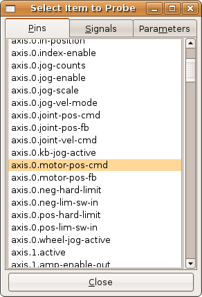

2. Halmeter
halmeter is like a voltmeter for the HAL. It lets you look at a pin, signal, or parameter, and displays the current value of that item. It is pretty simple to use. Start it by typing halmeter in an X windows shell. Halmeter is a GUI application. It will pop up a small window, with two buttons labeled "Select" and "Exit". Exit is easy - it shuts down the program. Select pops up a larger window, with three tabs. One tab lists all the pins currently defined in the HAL. The next lists all the signals, and the last tab lists all the parameters. Click on a tab, then click on a pin/signal/parameter. Then click on "OK". The lists will disappear, and the small window will display the name and value of the selected item. The display is updated approximately 10 times per second. If you click "Accept" instead of "OK", the small window will display the name and value of the selected item, but the large window will remain on the screen. This is convenient if you want to look at a number of different items quickly.
You can have many halmeters running at the same time, if you want to monitor several items. If you want to launch a halmeter without tying up a shell window, type halmeter & to run it in the background. You can also make halmeter start displaying a specific item immediately, by adding pin|sig|par[am] _<name>_ to the command line. It will display the pin, signal, or parameter <name> as soon as it starts - if there is no such item, it will simply start normally. And finally, if you specify an item to display, you can add -s before the pin|sig|param to tell halmeter to use a small window. The item name will be displayed in the title bar instead of under the value, and there will be no buttons. Useful when you want a lot of meters in a small amount of screen space.
In the Halmeter Tutorial you will find for more information.
halmeter can be loaded from a terminal or from AXIS. halmeter is faster than halshow at displaying values. halmeter has two windows, one to pick the pin, signal, or parameter to monitor and one that displays the value. Multiple ``halmeter``s can be open at the same time. If you use a script to open multiple ``halmeter``s you can set the position of each one with -g X Y relative to the upper left corner of your screen. For example:
loadusr halmeter pin hm2.0.stepgen.00.velocity-fb -g 0 500
See the man page for more options and the section Halmeter.
Halmeter selection window
Figure 1. Halmeter selection window
Halmeter watch window
Figure 2. Halmeter watch window

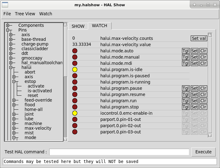

3. Halshow
halshow shows the values of chosen pins, parameters or signals of a running HAL. It further provides buttons to also modify those items. The WATCH tab provides a continuous display of selected pin, parameters, and signal items. The File menu provides buttons to save the watch items to a watch list and to load an existing watch list. The watch list items can also be loaded automatically on startup.
More detailed information can be found in the section Halshow in the tutorial chapter.
It can be started from the command line:
halshow --help
Usage:
  halshow [Options] [watchfile]
  Options:
           --help    (this help)
           --fformat format_string_for_float
           --iformat format_string_for_int
Notes:
  Create watchfile in halshow using: 'File/Save Watch List'.
  LinuxCNC must be running for standalone usage.
Halshow Watch Tab
Figure 3. Halshow Watch Tab
A watchfile created using the File/Save Watch List menu item is formatted as a single line with tokens "pin+", "param+", "sig=+", followed by the appropriate pin, param, or signal name. The token-name pairs are separated by a space character.
Single Line Watchfile Example
pin+joint.0.pos-hard-limit pin+joint.1.pos-hard-limit sig+estop-loop
A watchfile created using the File/Save Watch List (multiline) menu item is formatted with separate lines for each item identified with token-name pairs as described above.
Separated Lines Watchfile Example
sig+estop-loop
When loading a watchfile with the File/Load Watch List menu item, the token-name pairs may appear as single or multiple lines. Blank lines and lines beginning with a # character are ignored.

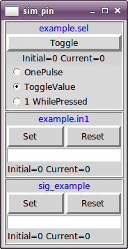

5. Sim Pin
sim_pin is a command line utility to display and update any number of writable pins, parameters or signals.
sim_pin Usage
Usage:
        sim_pin [Options] name1 [name2 ...] &
Options:
        --help                (this text)
        --title title_string  (window title, default: sim_pin)
Note:  LinuxCNC (or a standalone HAL application) must be running
        A named item can specify a pin, param, or signal
        The item must be writable, e.g.:
          pin:    IN or I/O (and not connected to a signal with a writer)
          param:  RW
          signal: connected to a writable pin
        HAL item types bool,sint,uint,real are supported.
        When a bool item is specified, a pushbutton is created
        to manage the item in one of three manners specified
        by radio buttons:
            toggle: Toggle value when button pressed
            pulse:  Pulse item to 1 once when button pressed
            hold:   Set to 1 while button pressed
        The bool pushbutton mode can be specified on the command
        line by formatting the item name:
            namei/mode=[toggle | pulse | hold]
        If the mode begins with an uppercase letter, the radio
        buttons for selecting other modes are not shown
For complete information, see the man page:
man sim_pin
sim_pin Example (with LinuxCNC running)
halcmd loadrt mux2 names=example; halcmd net sig_example example.in0
sim_pin example.sel example.in1 sig_example &
sim_pin Window
Figure 4. sim_pin Window

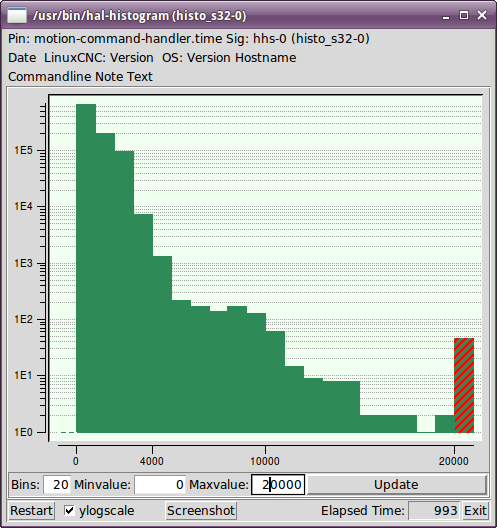

7. HAL Histogram
hal-histogram is a command line utility to display histograms for HAL pins.
Uso:
   hal-histogram --help | -?
o
   hal-histogram [Opciones] [nombre-de-pin]
Table 1. Opciones:
Option Valor Descripción
--minvalue
minvalue
minimum bin, default: 0
--binsize
binsize
binsize, default: 100
--nbins
nbins
number of bins, default: 50
--logscale
0/1
y axis log scale, default: 1
--text
note
text display, default: ""
--show
show count of undisplayed nbins, default off
--verbose
progress and debug, default off
Notas:
  1. LinuxCNC (or another HAL application) must be running.
  2. If no pinname is specified, default is: motion-command-handler.time.
  3. This app may be opened for 5 pins.
  4. Pintypes real, sint, uint, bool are supported.
  5. The pin must be associated with a realtime thread.
hal-histogram Window
Figure 6. hal-histogram Window
