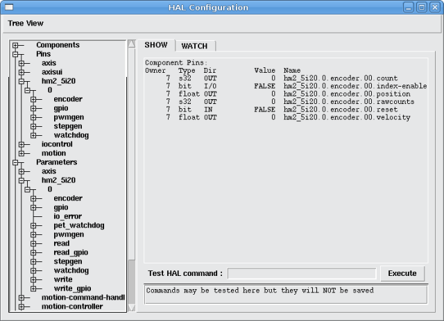

10. HAL Pins
The HAL pins for each configuration can be seen by opening up Show HAL Configuration from the Machine menu. All the HAL pins and parameters can be found there. The following figure is of the 5I20 configuration used above.
5i20 HAL Pins
Figure 1. 5i20 HAL Pins
