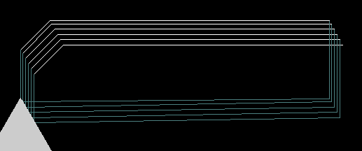

40. G64 Path Blending
G64 <P- <Q-> <R->>
  • P - motion blending tolerance
  • Q - naive cam tolerance
  • R - trajectory planner selection and cornering aggressiveness (this fork only)
  • G64 - best possible speed. Without P (Or a default value in RS274NGC) means to keep the best speed possible, no matter how far away from the programmed point you end up.
  • G64 P- - Blend between best speed and deviation tolerance
  • G64 P- <Q- > blending with tolerance. It is a way to fine tune your system for best compromise between speed and accuracy. The P- tolerance means that the actual path will be no more than P- away from the programmed endpoint. The velocity will be reduced if needed to maintain the path. If you set Q to a non-zero value it turns on the Naive CAM Detector: when there are a series of linear XYZ feed moves at the same feed rate that are less than Q- away from being collinear, they are collapsed into a single linear move. On G2/G3 moves in the G17 (XY) plane when the maximum deviation of an arc from a straight line is less than the G64 P- tolerance the arc is broken into two lines (from start of arc to midpoint, and from midpoint to end). those lines are then subject to the naive cam algorithm for lines. Thus, line-arc, arc-arc, and arc-line cases as well as line-line benefit from the Naive CAM Detector. This improves contouring performance by simplifying the path. It is OK to program for the mode that is already active. See also the Trajectory Control section for more information on these modes. If Q is not specified then it will have the same behavior as before and use the value of P-. Set Q to zero to disable the Naive CAM Detector.
40.1. G64 R: planner selection
The optional R word selects the trajectory planner and its cornering aggressiveness in one modal dial:
  • R omitted - the planner is left exactly as it was (modal).
  • R0 (or negative) - trapezoidal planner: acceleration is bounded but can step instantly (jerk is not limited).
  • R0.1 .. R1.0 - jerk-limited (S-curve) planner. The value sets the cornering aggressiveness as the fraction of the jerk-feasible corner speed that the look-ahead may use: R1.0 is full corner speed, lower values corner more gently (R0.5 matches the initial S-curve release). Values outside 0.1..1.0 are clamped.
The program only requests trapezoidal or smooth; which smooth planner implements the request is machine configuration ([TRAJ]SMOOTH_PLANNER), so part programs remain valid when the machine’s planner implementation changes.
Note
R0 to R0.1 is a regime flip, not the gentle end of a gradient: the trapezoidal planner is the jerk-unlimited, most aggressive setting, while R0.1 is the gentlest (jerk-limited and slowest through corners). Within R0.1..R1.0 the motion is equally smooth in the jerk sense; only the corner speed changes.
Behavior details:
  • A planner switch requested while queued motion remains is latched and applied automatically once no queued motion is left; a message informs the operator and motion is never aborted. The request persists until applied or superseded. Set G64 …​ R in the program preamble, where the switch is instant.
  • If the machine has no smooth planner available (SMOOTH_PLANNER = 0 or no usable jerk limit configured), R > 0 is refused with an operator error instead of being silently ignored.
  • The R word cannot be used on a line that also contains M19 (the R meanings would be ambiguous); this is an error.
It is a good idea to include a path control specification in the preamble of each G-code file.
It is an error if:
  • The path control mode is changed (G61, G61.1 or G64) while cutter radius compensation is active.
G64 P- Q- Example Line
G64 P0.015 Q0.015 (set path following to be within 0.015 of the actual path)
The P- and Q- values ​​are chosen small. Usually smaller than the machine accuracy or the accuracy of commonly manufactured parts. Below are examples with extreme P- and Q- values ​​to understand the G64 function.

G76 Threading
Figure 7. G76 Threading

G76 P0.05 Z-1 I-.075 J0.008 K0.045 Q29.5 L2 E0.045
In the figure the tool is in the final position after the G76 cycle is completed. You can see the entry path on the right from the Q29.5 and the exit path on the left from the L2 E0.045. The white lines are the cutting moves.
G76 Example
Figure 8. G76 Example
