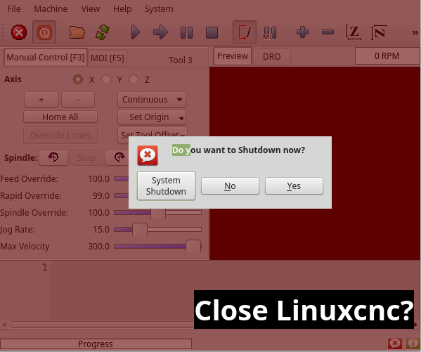

1.4. FocusOverlay - Focus Overlay Widget
This widget places a colored overlay over the screen, usually while a dialog is showing.
QtVCP focus overlay
Figure 1. Focus overlay example for confirm close prompt
Used to create a focused feel and to draw attention to critical information.
It can also show a translucent image.
It can also display message text and buttons.
This widget can be controlled with STATUS messages.

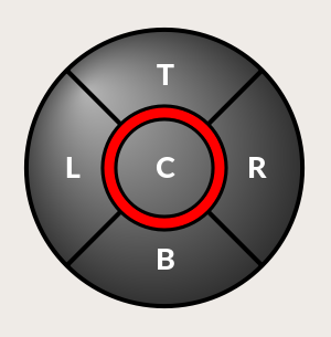

1.10. HALPad - HAL Buttons Joypad
QtVCP HALPad: HAL Buttons Joypad
Figure 4. QtVCP HALPad: HAL Buttons Joypad
This widget looks and acts like a 5 buttons D-pad, with an LED ring.
Each button has an selectable type (Bit, S32 or Float) output HAL pin.
The LED center ring has selectable colors for off and on and is controlled by a bit HAL pin.

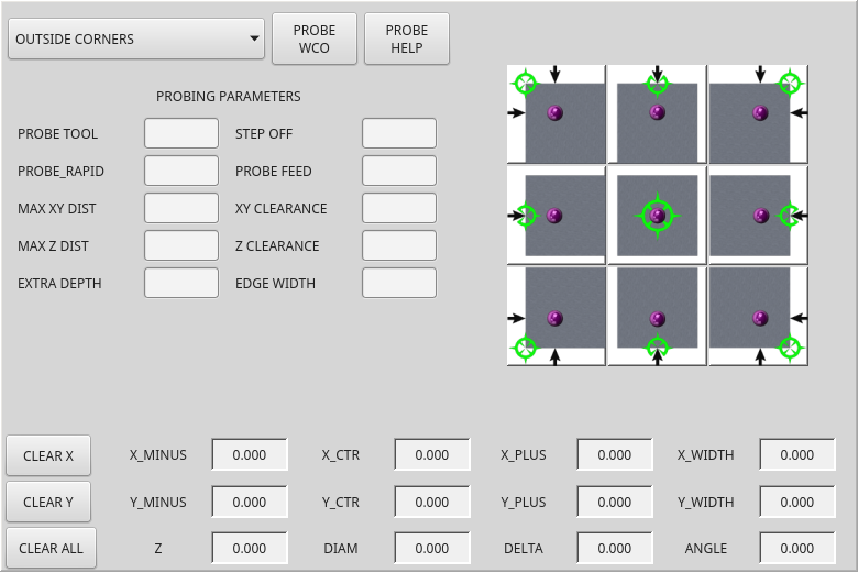

2.4. BasicProbe - Simple Mill Probing Widget
QtVCP BasicProbe: Simple Mill Probing Widget
Figure 6. QtVCP BasicProbe: Simple Mill Probing Widget
Widget for probing on a mill. Used by the QtDragon screen.

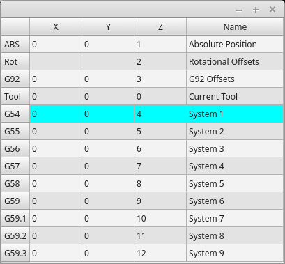

2.6. DROLabel - Axis Position Display Widget
This will display the current position of an axis.
You can also click on the label and see a list of actions.
Qjoint_number
Joint index number (X=0 Y=1) of offset to display (10 will specify rotational offset).
Qreference_type
Actual, relative or distance to go (0,1,2).
metric_template
Format of display, e.g. %10.3f.
imperial_template
format of display, e.g. %9.4f.
angular_template
Format of display, e.g. %Rotational: 10.1f.
always_display_diameter
Toggles display option
always_display_radius
display_as_per_m7m8
Toggles display option. Will follow the current M7/8 mode.
follow_reference_changes
Toggles display option. Will follow the STATUS message reference mode, i.e. you can use Action buttons to set how it is currently displayed.
These are the click-on-menu options:
showLast
Show the Set to last action.
showDivide
Show the Divide by 2 action.
showGotoOrigin
Show the Go to G53/G5x origin action.
showZeroOrigin
Show the Zero Origin action.
showSetOrigin
Show the Set Origin action.
dialogName
Sets which dialog window will pop up with numerical entry, i.e. ENTRY or CALCULATOR.
The DROLabel widget holds a property isHomed that can be used with a stylesheet to change the color of the DRO_Label based on homing state of the joint number in LinuxCNC.
Here is a sample stylesheet entry that:
  • Sets the font of all DRO_Label widgets,
  • Sets the text template (to set resolution) of the DRO,
  • Then sets the text color based on the Qt isHomed property.
  • show all the menu options.
DROLabel {
    font: 25pt "Lato Heavy";
    qproperty-imperial_template: '%9.4f';
    qproperty-metric_template: '%10.3f';
    qproperty-angular_template: '%11.2f';
    /* Modify all the menu options */
    qproperty-showLast: true;
    qproperty-showDivide : true;
    qproperty-showGotoOrigin: true;
    qproperty-showZeroOrigin: true;
    qproperty-showSetOrigin: true;
    qproperty-dialogName: CALCULATOR;
DROLabel[isHomed=false] {
    color: red;
DROLabel[isHomed=true] {
    color: green;
Here is how you specify a particular widget by its objectName in Qt Designer:
DROLabel #dr0_x_axis [isHomed=false] {
    color: yellow;
It is based on PyQt’s QLabel.

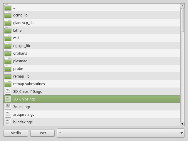

2.7. FileManager - File Loading Selector Widget
QtVCP FileManager: File Loading Selector Widget
Figure 7. QtVCP FileManager: File Loading Selector Widget
This widget is used to select files to load.

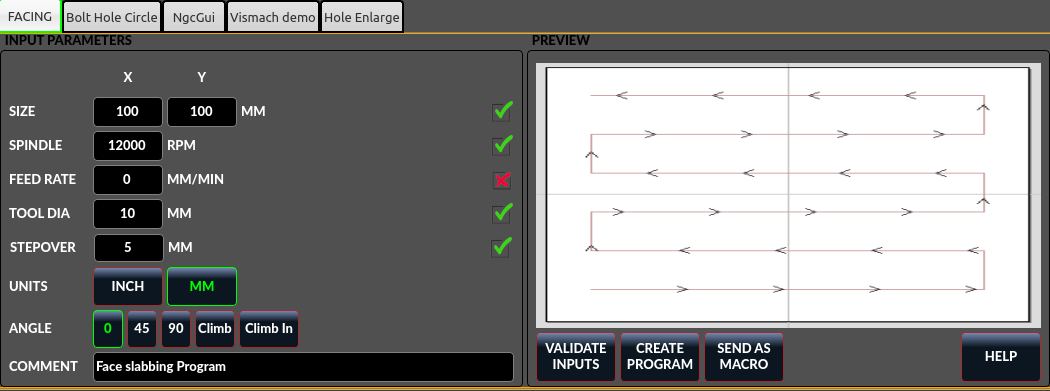

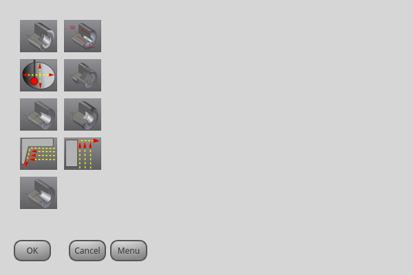

2.13. MacroTab - Special Macros Widget
QtVCP MacroTab: Special Macros Widget
Figure 9. QtVCP MacroTab: Special Macros Widget
This widget allows a user to select and adjust special macro programs for doing small jobs.
It uses images for visual representation of the macro and for an icon.
It searches for special macros using the INI definition:
[RS274NGC]
SUBROUTINE_PATH =
The macros are O-word subroutines with special comments to work with the launcher. The first three lines must have the keywords below, the fourth is optional.
Here is a sample for the first four lines in an O-word file:
; MACROCOMMAND = Entry1,Entry2
; MACRODEFAULTS = 0,true
; MACROIMAGE = my_image.svg,Icon layer number,Macro layer number
; MACROOPTIONS = load:yes,save:yes,default:default.txt,path:~/macros
MACROCOMMAND
This is the first line in the O-word file.
It is a comma separated list of text to display above an entry.
There will be one for every variable required in the O-word function.
If the macro does not require variables, leave it empty:
; MACROCOMMAND=
MACRODEFAULTS
This must be the second line in the O-word file.
It is a comma separated list of the default values for each variable in the O-word function.
If you use the word radiotrue, radiofalse, true or false in the list, a *radiobutton* will be shown.
If you use the word checktrue or checkfalse in the list, a *checkbox* will be shown.
If you use the word buttontrue or buttonfalse in the list, a *Checkable Pushbutton* will be shown.
If the default has a decimal, macroTab assumes you want a float value otherwise an integer.
Note
When using radiobuttons, only set one radiobutton as true. Radio button are used for exclusive choices.
MACROIMAGE
This must be the third line in the O-word file.
  • SVG Images
    If using SVG image files, they must end with the .svg extension.
    The images must be added to SVG layers which are used to define the different images for macro and icon.
    Value is comma separated list of three ordered fields:
    ; MACROIMAGE=filename.svg,macro_layer_name[,icon_layer_name]
    With:
    _filename_.svg
    SVG image file name as first field.
    It is assumed to be in the same folder as the O-word file.
    *macro_layer_name
    Macro image layer name as second field.
    icon_layer_name
    Icon image layer name as optional third field. If the third entry is missing, the same image will be used for macro and icon.
  • PNG/JPG Images:
    Value remains a comma separated list:
    ; MACROIMAGE=macro_image.(png|jpg)[,icon_image.(png|jpg)]
    With:
    _macro_image_.(png|jpg)
    Macro image file name as first field.
    It is assumed that the image file are in the same folder than the macro.
    _icon_image_.(png|jpg)
    Icon image file name as optional second field.
    If the second entry is missing the same image will be used for macro and image.
If the keyword is present but the entries are missing, no images will be used.
MACROOPTIONS
This optional line must be the fourth line in the O-word file.
It is a comma separated list of keyword and data, all of which are optional:
LOAD:yes
Shows a load button.
SAVE:yes
Shows a save button.
DEFAULT:ThisMacroData.txt
Sets the default preselected filename when loading/saving data for this macro.
It can be any valid filename but must end in .txt.
PATH:~/linuxcnc/nc_files/mySavedMacrosData
Sets the default directory folder to preselect when loading/saving data for this macro.

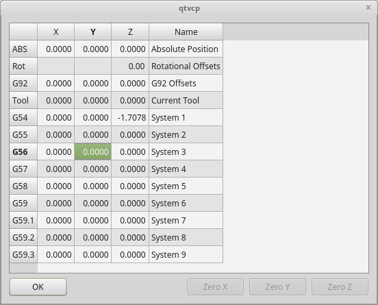

2.18. OriginOffsetView - Origins View and Setting Widget
QtVCP OriginOffsetsView: Origins View and Setting Widget
Figure 11. QtVCP OriginOffsetsView: Origins View and Setting Widget
This widget allows one to visualize and modify User System Origin offsets directly.
It will update LinuxCNC’s Parameter file for changes made or found.
The settings can only be changed in LinuxCNC after homing and when the motion controller is idle.
The display and entry will change between metric and imperial, based on LinuxCNC’s current G20 / G21 setting.
The current in-use user system will be highlighted.
Extra actions can be integrated to manipulate settings.
These actions depend on extra code added either to a combined widget, like originoffsetview dialog, or the screens handler code.
Typical actions might be Clear Current User offsets or Zero X.
Clicking on the columns and rows allows one to adjust the settings.
A dialog can be made to popup for data or text entry.
The comments section will be recorded in the preference file.
It is based on PyQt’s QTableView, QAbstractTableModel, and ItemEditorFactory.
Properties, functions and styles of the PyQt base objects are always available.

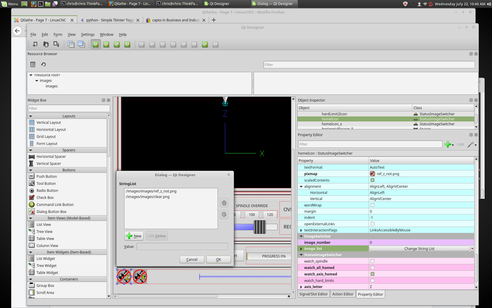

2.23. StatusImageSwitcher - Controller Status Image Switcher
Status image switcher will switch between images based on LinuxCNC states.
*watch_spindle
Toggles between 3 images: stop, fwd, revs.
*watch_axis_homed
Toggles between 2 images: axis not homed, axis homed.
*watch_all_homed
Would toggle between 2 images: not all homed, all homed.

Here is an example of using it to display an icon of Z axis homing state:
QtVCP StatusImageSwitcher: Controller Status Image Switcher
Figure 12. QtVCP StatusImageSwitcher: Controller Status Image Switcher
In the properties section notice that:
  • watch_axis_homed is checked
  • axis_letter is set to Z
If you double click the image_list a dialog will show and allow you to add image paths to.
If you have one image as an icon and one clear image then that will look like it shows and hides the icon.
Selecting image paths can be done by selecting the pixmap property and selecting an image.
Note
The pixmap setting is for test display only and will be ignored outside of Qt Designer.
  • Right click the image name and you should see Copy path.
  • Click Copy path.
  • Now double click the image list property so the dialog shows.
  • Click the New button.
  • Paste the image path in the entry box.
Do that again for the next image.
Use a clear image to represent a hidden icon.
You can test the images display from the image list by changing the image number. In this case 0 is unhomed and 1 would be homed.
This is for test display only and will be ignored outside of Qt Designer.

catch_close_option
Catching the close event to pop up a 'are you sure' prompt.
close_overlay_color
Color of transparent layer shown when quitting.

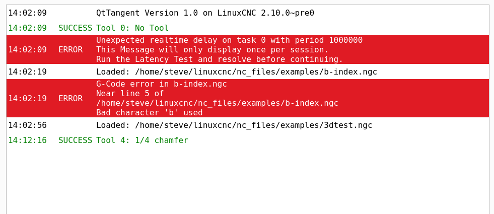

catch_error_option
Monitoring of the LinuxCNC error channel.
This also sends the message through STATUS to anything that registers.

closeDialog_option
Sets up the standard close screen prompt dialog.

vesaProbe_option
Sets up the Versa style probe dialog.
versaProbe_overlay_color
Color of transparent layer shown when the versaProbe dialog is shown.

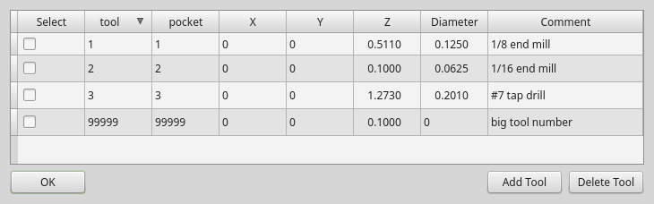

toolOffset_option
Sets up the tool offset display/editor dialog.

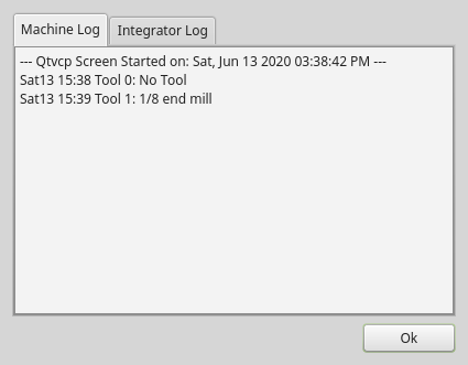

machineLogDialog_option
Sets up a dialog to display logs from the machine and QtVCP.
machineLog_overlay_color

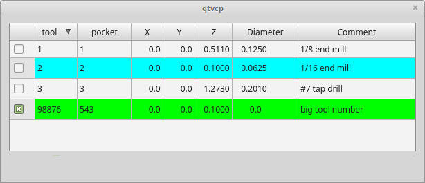

2.32. ToolOffsetView - Tools Offsets View And Edit Widget
QtVCP ToolOffsetView: Tools Offsets View And Edit Widget
Figure 13. QtVCP ToolOffsetView: Tools Offsets View And Edit Widget
This widget displays and allows one to modify tools offsets.
It will update LinuxCNC’s tool table for changes made or found.
The tool settings can only be changed in LinuxCNC after homing and when the motion controller is idle.
The display and entry will change between metric and imperial based on LinuxCNC’s current G20/G21 setting.
The current in-use tool will be highlighted, and the current selected tool will be highlighted in a different color.
The checkbox beside each tool can be used to select too for an action that depends on extra code added either to a combined widget, like the toolOffsetView dialog or the screens handler code.
Typical actions are load selected tool, delete selected tools, etc.
The comments section will typically be displayed in the manual tool change dialog.
If using a lathe configuration, there can be columns for X and Z wear.
To use these columns to adjust the tool wear, it requires a remapped tool change routine.
Properties
ToolOffsetView has properties that can be set in Qt Designer, in Python handler code or (if appropriate) in stylesheets:
dialog_code_string
Sets which dialog will pop up with numerical entry.
text_dialog_code_string
Sets which dialog will pop up with text entry.
metric_template
Metric numerical data format.
imperial_template
Imperial numerical data format.
styleCodeHighlight
Current tool-in-use highlight color.
styleCodeSelected
Selected highlight color.
In a handler file:
self.w.tooloffsetview.setProperty('dialog_code','CALCULATOR')
self.w.tooloffsetview.setProperty('metric_template','%10.3f')
and in style sheets:
ToolOffsetView{
  qproperty-styleColorHighlist: lightblue;
  qproperty-styleColorSelected: #444;
Functions
ToolOffsetView has some functions useful for screen builders to add actions:
add_tool()
Adds a blank dummy tool (99) that the user can edit to suit.
delete_tools()
Deletes the currently checkbox selected tools.
get_checked_list()
Returns a list of tools selected by checkboxs.
set_all_unchecked()
Uncheck all selected tools.
Example for handler file executing aforementioned functions.
self.w.tooloffsetview.add_tool()
self.w.tooloffsetview.delete_tools()
toolList = self.w.tooloffsetview.get_checked_list()
self.w.tooloffsetview.set_all_unchecked()

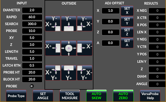

2.33. VersaProbe - Mill Probing Widget
QtVCP VersaProbe: Mill Probing Widget
Figure 14. QtVCP VersaProbe: Mill Probing Widget

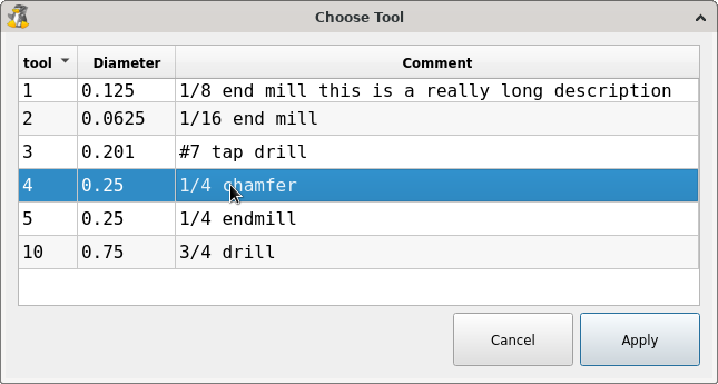

3.6. ToolChooserDialog - Tool Chooser Dialog Widget
QtVCP `ToolChooserDialog`: Tool Chooser Dialog Widget
Figure 19. QtVCP ToolChooserDialog: Tool Chooser Dialog Widget
This widget allows the operator to select one of the tools defined in the tool table. If a tool is selected and Apply is pressed or the tool is double-clicked, the dialog will return the tool number selected. This can be used in conjunction with the OperatorValueLine widget to create a tool change widget, for example.
If there is an Focus Overlay widget present, it will signal it to display.
When using STATUS 's request-dialog function, the default launch name is TOOLCHOOSER.
It is based on PyQt’s QDialog.

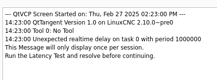

3.7. MachineLog - Machine Events Journal Display Widget
This widget displays various log event messages that have been output by the system during the current session. This includes informational messages as well as errors.
QtVCP `MachineLog`: Machine Log Widget
Figure 20. QtVCP MachineLog: Machine Events Log in machine_log (plain) mode
Figure 21. QtVCP MachineLog: Machine Events Log in machine_log_severity mode
Two distinct types of logs may be displayed:
  • machine log (plain text or severity highlighted)
  • integrator log (plain text only)
The type of log shown by the widget is controlled by the option properties of the widget. By selecting machine_log_option or integrator_log_option the appropriate log will be displayed. These options will display plain styled logs in a Qt QTextEdit widget.
Additionally, there is a machine_log_severity_option property that may be chosen that will display the machine log in a variety of colors depending on the severity of the message, by using a QTableWidget. The colors may be configured with the properties of the widget.
3.7.1. Emitting Log messages with Severity
Severity is conveyed via the option value sent along with the STATUS signal called update-machine-log. The option parameter is a comma-delimited list, containing typically
text = 'an error has occurred.'
STATUS.emit('update-machine-log', text, 'TIME,ERROR')

3.8. MacroTabDialog - Macro Launch Dialog Widget
This is a dialog to display the macrotab widget.
MacroTab displays a choice of macro programs to run using icons.
If there is a Focus Overlay widget present, it will signal it to display.
When using ``STATUS`’s request-dialog function, the default launch name is MACROTAB.

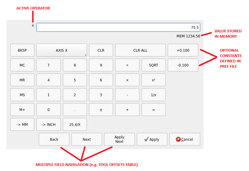

3.11. CalculatorDialog - Calculator Dialog Widget
This is a dialog to display a calculator for numeric entry, such as origin offset, spindle RPM, etc. It is primarily intended for touchscreen use, but it has support for physical keyboard input as well.
QtVCP CalculatorDialog: Calculator Dialog Widget
Figure 22. QtVCP CalculatorDialog: Calculator Dialog Widget
It returns the entry via STATUS messages using a Python DICT.
The DICT contains at minimum, the name of the dialog requested and an ID code.
When using ``STATUS`’s request-dialog function, the default launch name is CALCULATOR.
3.11.1. Preferences file options
In the CALCULATOR section of the preferences file the following options may be set:
  • constValuesList - A comma-delimited list of common values you might enter, that will appear on a dedicated row of buttons at the bottom of the calculator. e.g. setting to 0.100, -0.100 would provide two buttons for +0.100 and -0.100 which are commonly used when edge-finding on inch mills. Up to six (6) values may be entered, beyond that the list will be truncated. Values must be valid floating point or integer.
  • onShowBehavior - A list of optional behaviors that will be triggered when the calculator dialog is shown. Each option must be separated by a comma.
    • CLEAR_ALL to issue a Clear All each time the calculator is shown. This will clear any previously entered values from the last time the calculator was used and open with the display value set to 0
    • FORCE_FOCUS will force the focus to the calculator input field when the widget is shown. This will allow a physical keyboard to provide input to the widget properly without additional clicks. Also, it has the side-effect of selecting the current value, such that typing from a physical keyboard will replace the existing value unless the text selection is changed.
  • acceptOnReturnKey - If set to True, the calculator will accept the current value and close the dialog when the keyboard return/enter key is pressed. If set to False, the return key will be ignored and the Apply button must be clicked. For cases where the Apply Next button is available, the return key will perform this action instead, and the dialog will remain open.
3.11.2. Physical keyboard support
While the intent of this widget is to provide a touchscreen-friendly interface, it is possible to use a physical keyboard to enter values, typically via a numeric keypad. The keys perform mostly as one would expect, but a few special key functions also exist:
  • the Enter or Return key is equivalent to the Equal (=) operator in the cases where a calculation is pending. Otherwise it will perform the Apply function if it is enabled via the acceptOnReturnKey preference.

3.13. VersaProbeDialog - Part Touch Probing Dialog Widget
QtVCP VersaProbeDialog: Part Touch Probing Dialog Widget
Figure 24. QtVCP VersaProbeDialog: Part Touch Probing Dialog Widget
This is a dialog to display a part probing screen based on Verser Probe v2.
3.14. MachineLogDialog - Machine and Debugging Logs Dialog Widget
QtVCP MachineLogDialog: Machine and Debugging Logs Dialog Widget
Figure 25. QtVCP MachineLogDialog: Machine and Debugging Logs Dialog Widget
This is a dialog to display the machine log and QtVCP’s debugging log.

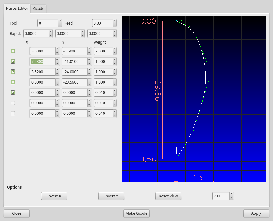

4.1. NurbsEditor - NURBS Editing Widget
QtVCP NurbsEditor: NURBS Editing Widget
Figure 26. QtVCP NurbsEditor: NURBS Editing Widget
The Nurbs editor allows you to manipulate a NURBS based geometry on screen and then convert NURBS to G-code.
You can edit the G-code on screen and then send it to LinuxCNC.
4.2. JoyPad - 5 button D-pad Widget
It is the base class for the HALPad widget.
This widget looks and acts like a 5 button D-pad, with a LED like indicators in a ring.
You can put text or icons in each of the button positions.
You can connect to output signals when the buttons are pressed.
There are also input slots to change the color of the indicator(s).

6.3. Facing
QtVCP Facing: Shown from QtDragon
Slab or face a definable area with different strategies.

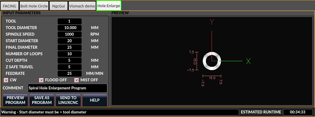

6.5. Hole Enlarge
Use an end mill to enlarge a drilled hole.

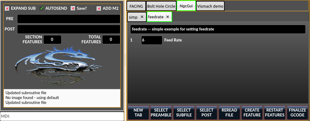

6.6. Qt NGCGUI
QtVCP NGCGUI: Shown from QtDragon
QtVCP’s version of NGC subroutine selector (Shown as used in QtDragon).
6.6.1. INI settings
LinuxCNC needs to know where to look to run the subroutines.
If the subroutine calls other subroutines or custom M codes, those paths must be added too.
[RS274NGC]
SUBROUTINE_PATH = ~/linuxcnc/nc_files/examples/ngcgui_lib:~/linuxcnc/nc_files/examples/ngcgui_lib/utilitysubs
QtVCP needs to know where to open subroutines from.
You can also specify subroutines to be pre-opened in tabs.
[DISPLAY]
# NGCGUI subroutine path.
# This path must also be in [RS274NGC] SUBROUTINE_PATH
NGCGUI_SUBFILE_PATH = ~/linuxcnc/nc_files/examples/ngcgui_lib
# pre selected programs tabs
# specify filenames only, files must be in the NGCGUI_SUBFILE_PATH
NGCGUI_SUBFILE = slot.ngc
NGCGUI_SUBFILE = qpocket.ngc
6.6.2. Buttons
  • NEW TAB - add new blank tab to NGCGUI
  • SELECT PREAMBLE - select a file that add preamble G-code
  • SELECT SUBFILE - select a NGCGUI subroutine file
  • SELECT POST - select a file that add post G-code
  • REREAD FILE - reload the subroutine file
  • CREATE FEATURE - add feature to the list
  • RESTART FEATURE - remove all features from the list
  • FINALIZE GCODE - create the full G-code and send it to LinuxCNC/a file
6.6.3. Adding Custom Subroutines
You can create your own subroutines for use with NGCGUI. They must follow these rules:
  • For creating a subroutine for use with NGCGUI, the filename and the subroutine name must be the same.
  • The subroutine must be in a folder within LinuxCNC’s INI designated search path.
  • On the first line there may be a comment of type info:
  • The subroutine must be surrounded by the sub and endsub tags.

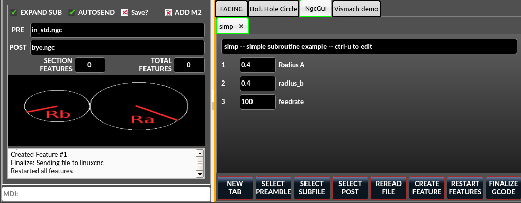

  • The variables used must be numbered variables and must not skip number.
  • Comments and presets may be included.
  • If an image file of the same name is in the folder, it will be shown.
(info: feedrate -- simple example for setting feedrate)
o<feedrate> sub
    #<feedrate>       = #1 (= 6 Feed Rate) ; comments in brackets will be shown in ngcui
    f#<feedrate>
o<feedrate> endsub
QtVCP NGCGUI Custom Sub
