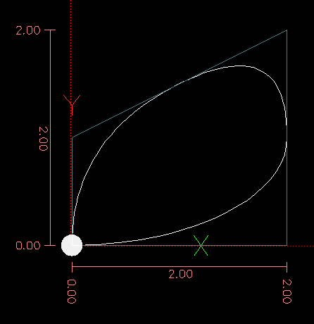

7. G5 Cubic Spline
G5 X- Y- <I- J-> P- Q-
I - X incremental offset from start point to first control point
J - Y incremental offset from start point to first control point
P - X incremental offset from end point to second control point
Q - Y incremental offset from end point to second control point
G5 creates a cubic B-spline in the XY plane with the X and Y axes only. P and Q must both be specified for every G5 command.
For the first G5 command in a series of G5 commands, I and J must both be specified. For subsequent G5 commands, either both I and J must be specified, or neither. If I and J are unspecified, the starting direction of this cubic will automatically match the ending direction of the previous cubic (as if I and J are the negation of the previous P and Q).
For example, to program a curvy N shape:
G90 G17
G0 X0 Y0
G5 I0 J3 P0 Q-3 X1 Y1
A second curvy N that attaches smoothly to this one can now be made without specifying I and J:
G5 P0 Q-3 X2 Y2

G5.3
Warning
G5.2, G5.3 is experimental and not fully tested. |
G5.2 is for opening the data block defining a NURBS and G5.3 for closing the data block. In the lines between these two codes the curve control points are defined with both their related weights (P) and the parameter (L) which determines the order of the curve.
The current coordinate, before the first G5.2 command, is always taken as the first NURBS control point. To set the weight for this first control point, first program G5.2 P- without giving any X Y.
The default weight if P is unspecified is 1. The default order if L is unspecified is 3.
G0 X0 Y0 (rapid move)
F10 (set feed rate)
G5.2 P1 L3
X0 Y1 P1
X2 Y2 P1
X2 Y0 P1
X0 Y0 P2
G5.3
; The rapid moves show the same path without the NURBS Block
G0 X0 Y1
X2 Y2
X2 Y0
X0 Y0
M2

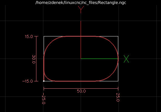

40. G64 Path Blending
G64 <P- <Q-> <R->>
P - motion blending tolerance
Q - tolérance CAM naïve
R - trajectory planner selection and cornering aggressiveness (this fork only)
G64 - meilleure vitesse possible. Sans P (ou une valeur par défaut dans RS274NGC), signifie conserver la meilleure vitesse possible, peu importe l’écart final par rapport au point programmé.
G64 P- - Blend between best speed and deviation tolerance
G64 P- <Q- > lissage avec tolérance. C’est un moyen d’affiner votre système afin d’obtenir le meilleur compromis entre vitesse et précision. La tolérance P- signifie que la trajectoire réelle ne s’écartera pas de plus de P- du point final programmé. La vitesse sera réduite si nécessaire pour maintenir la trajectoire. Si vous définissez Q à une valeur non nulle, cela active le « détecteur CAM naïf » : lorsqu’une série de déplacements linéaires XYZ à la même vitesse d’avance s’écarte de la colinéarité de moins de Q-, ces déplacements sont fusionnés en un seul déplacement linéaire. Sur les déplacements G2/G3 dans le plan G17 (XY), lorsque l’écart maximal d’un arc par rapport à une ligne droite est inférieur à la tolérance G64 P-, l’arc est divisé en deux lignes (du début de l’arc au point milieu, et du point milieu à la fin). Ces lignes sont ensuite soumises à l’algorithme CAM naïf pour les lignes. Ainsi, les cas ligne-arc, arc-arc et arc-ligne, tout comme les cas ligne-ligne, bénéficient du « détecteur CAM naïf ». Cela améliore les performances de contournage en simplifiant la trajectoire. Il est permis de programmer le mode qui est déjà actif. Voir aussi la section Contrôle de trajectoire pour plus d’informations sur ces modes. Si Q n’est pas spécifié, le comportement sera le même qu’auparavant et utilisera la valeur de P-. Mettez Q à zéro pour désactiver le « détecteur CAM naïf ».
40.1. G64 R: planner selection
The optional R word selects the trajectory planner and its cornering aggressiveness in one modal dial:
R omitted - the planner is left exactly as it was (modal).
R0 (or negative) - trapezoidal planner: acceleration is bounded but can step instantly (jerk is not limited).
R0.1 .. R1.0 - jerk-limited (S-curve) planner. The value sets the cornering aggressiveness as the fraction of the jerk-feasible corner speed that the look-ahead may use: R1.0 is full corner speed, lower values corner more gently (R0.5 matches the initial S-curve release). Values outside 0.1..1.0 are clamped.
The program only requests trapezoidal or smooth; which smooth planner implements the request is machine configuration ([TRAJ]SMOOTH_PLANNER), so part programs remain valid when the machine’s planner implementation changes.
Note
R0 to R0.1 is a regime flip, not the gentle end of a gradient: the trapezoidal planner is the jerk-unlimited, most aggressive setting, while R0.1 is the gentlest (jerk-limited and slowest through corners). Within R0.1..R1.0 the motion is equally smooth in the jerk sense; only the corner speed changes. |
Behavior details:
A planner switch requested while queued motion remains is latched and applied automatically once no queued motion is left; a message informs the operator and motion is never aborted. The request persists until applied or superseded. Set G64 … R in the program preamble, where the switch is instant.
If the machine has no smooth planner available (SMOOTH_PLANNER = 0 or no usable jerk limit configured), R > 0 is refused with an operator error instead of being silently ignored.
The R word cannot be used on a line that also contains M19 (the R meanings would be ambiguous); this is an error.
It is a good idea to include a path control specification in the preamble of each G-code file.
It is an error if:
The path control mode is changed (G61, G61.1 or G64) while cutter radius compensation is active.
G64 P0.015 Q0.015 (set path following to be within 0.015 of the actual path)
The P- and Q- values are chosen small. Usually smaller than the machine accuracy or the accuracy of commonly manufactured parts. Below are examples with extreme P- and Q- values to understand the G64 function.
G64 (set without P- and Q- values)
G64 P0.015 Q6
G64 P0.015 Q2
