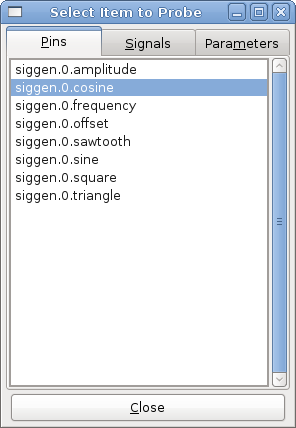

At this point we have the siggen component loaded and running. It’s time to start halmeter.
Starting Halmeter
halcmd: loadusr halmeter
The first window you will see is the "Select Item to Probe" window.
Halmeter Select Window
Figure 1. Halmeter Select Window
This dialog has three tabs. The first tab displays all of the HAL pins in the system. The second one displays all the signals, and the third displays all the parameters. We would like to look at the pin siggen.0.cosine first, so click on it then click the "Close" button. The probe selection dialog will close, and the meter looks something like the following figure.
Halmeter Window
Figure 2. Halmeter Window
To change what the meter displays press the "Select" button which brings back the "Select Item to Probe" window.
You should see the value changing as siggen generates its cosine wave. Halmeter refreshes its display about 5 times per second.
To shut down halmeter, just click the exit button.

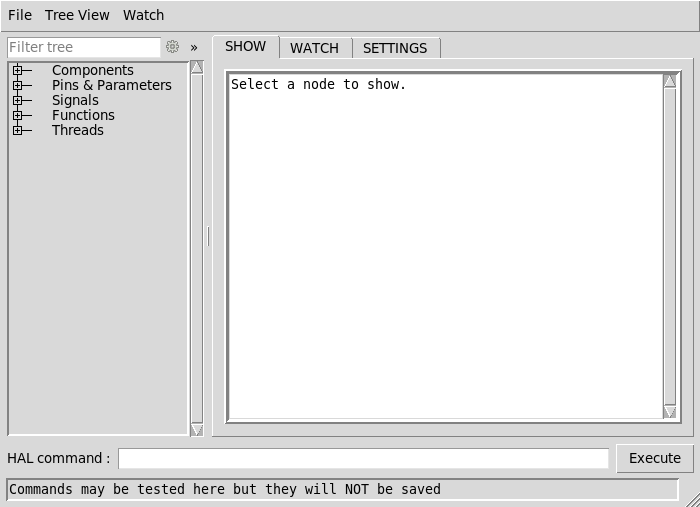

Halshow Layout
Figure 3. Halshow Layout
At the left of its display as shown in above figure is a tree view, resembling what you may have seen as file browsers. At the right is a tabbed notebook with tabs for show, watch and settings.

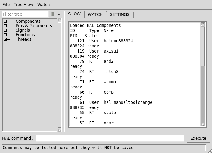

6.3. HAL Show Area
Halshow: Show Tab
Figure 4. Halshow: Show Tab
Clicking on the node name, "Components" in the tree for example, will show you (under the "Show" tab) all that HAL knows about the contents of that node. Figure Halshow Show Tab shows a list exactly like you will see if you click the "Components" name. The information display is exactly like those shown in traditional text based HAL analysis tools. The advantage here is that we have mouse click access, access that can be as broad or as focused as you need.
If we take a closer look at the tree display we can see that the six major parts of a HAL can all be expanded at least one level. As these levels are expanded you can get more focused with the reply when you click on the rightmost tree node. You will find that there are some HAL pins and parameters that show more than one reply. This is due to the nature of the search routines in halcmd itself. If you search one pin you may get two, like this:
Component Pins:
Owner  Type  Dir  Value  Name
06     bit    -W   TRUE  parport.0.pin-10-in
06     bit    -W  FALSE  parport.0.pin-10-in-not
The second pin’s name contains the complete name of the first.
Selected text inside the Show tab can be copied by right-click or CTRL-C.
The Show area allows to add pins from selected text by using the right-click menu. All valid pins that are enclosed in the selection are added to the Watch tab.

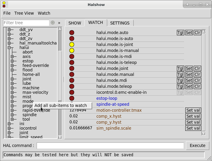

6.4. Watch Tab Area
Clicking the watch tab produces a blank canvas. You can add signals and pins to this canvas and watch their values. You can add signals or pins when the watch tab is displayed by clicking on the name of it in the tree view.
You can also add all sub-items of this node by selecting that in the right click menu (see figure Halshow Watch Tab).
The following figure shows this canvas with several pins.
Halshow Watch Tab
Figure 5. Halshow: Watch Tab
Watch displays bit type (binary) values using colored circles representing LEDs. They show as dark red when a bit signal or pin is false, and as light yellow whenever that signal is true. If you select a pin or signal that is not a bit type (binary) signal, watch will show it as a numerical value. Pins are displayed in black, signals in blue and parameters in brown.
Watch will quickly allow you to test switches or see the effect of changes that you make to LinuxCNC while using the graphical interface. Watch’s refresh rate is a bit slow to see stepper pulses, but you can use it for these if you move an axis very slowly or in very small increments of distance.
The pins and signals that are writable have buttons for manipulation on the right side. Pins that are linked to a signal have disabled buttons. To set these values, the corresponding pin has to be unlinked from the signal. That can be done by right-click on the signal name and select "Unlink pin", see Watch Tach Context Menu.
The watch list will be saved automatically on exit. If you don’t want Halshow to save your watchlist, it can be disabled in the Settings.

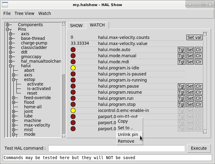

Context Menu
The context menu allows further:
  • Copy the pin name to clipboard
  • Set a value
  • Unlink a pin (if linked to a signal)
  • Show apin in the Tree view (highlights the pin, doesn’t scroll to the position)
  • Remove a pin from the list
Halshow: Watch Tab Context Menu
Figure 6. Halshow: Watch Tab Context Menu

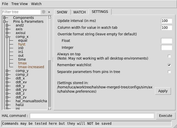

6.6. Settings
The geometry of the window and the settings are saved in a file in the configuration directory on exit. If that path cannot be determined, they are stored in the home directory. The path will be displayed in the settings page. You can omit using the preferences file by calling halshow with the command line argument --no-prefs.
Override format string
Sets the format of the displayed values, for more information refer to the Tcl format man page.
Always on top
Keeps the halshow window on top.
Remember watchlist
Keeps the saved items in the watchlist on exit.
Separate parameters from pins in tree
Lists pins and parameters in separate Pins and Parameters branches of the tree, instead of the combined Pins & Parameters branch. The setting takes effect when you press Apply and is remembered between sessions.
The further settings should be self-explaining.
Halshow Settings
Figure 7. Halshow Settings

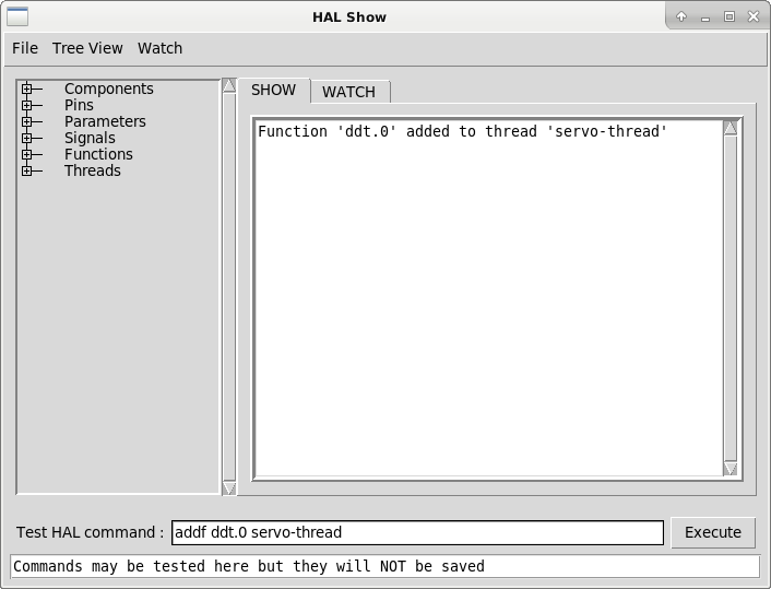

Here we look for owner #08 and see a function named ddt.0. We should be able to add ddt.0 to the servo thread and it will do its math each time the servo thread is updated. Once again we look up the addf command and find that it uses three arguments like this:
addf <functname> <threadname> [<position>]
We already know the functname=ddt.0 so let’s get the thread name right by expanding the thread node in the tree. Here we see two threads, servo-thread and base-thread. The position of ddt.0 in the thread is not critical. So we add the function ddt.0 to the servo-thread:
addf ddt.0 servo-thread
This is just for viewing, so we leave position blank and get the last position in the thread. The following figure shows the state of halshow after this command has been issued.
Addf command
Figure 8. Addf command

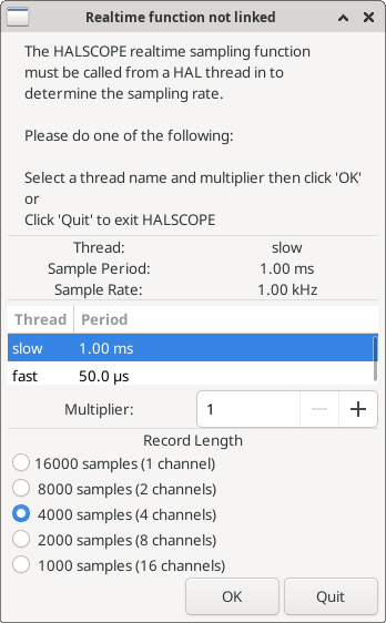

If LinuxCNC is not running or the autosave.halscope file does not match the pins available in the current running LinuxCNC the scope GUI window will open, immediately followed by a Realtime function not linked dialog that looks like the following figure. To change the sample rate left click on the samples box.
Figure 9. Realtime function not linked dialog

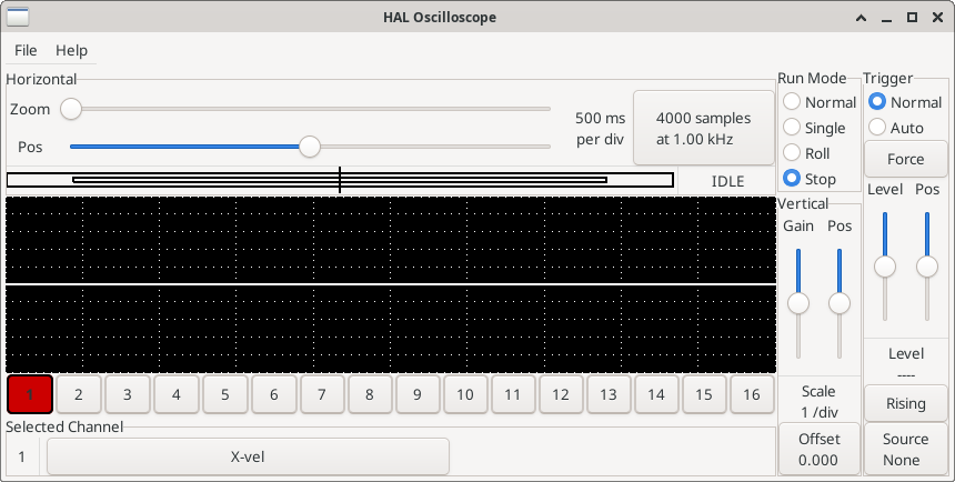

This dialog is where you set the sampling rate for the oscilloscope. For now we want to sample once per millisecond, so click on the 1.00 ms thread slow and leave the multiplier at 1. We will also leave the record length at 4000 samples, so that we can use up to four channels at one time. When you select a thread and then click OK, the dialog disappears, and the scope window looks something like the following figure.

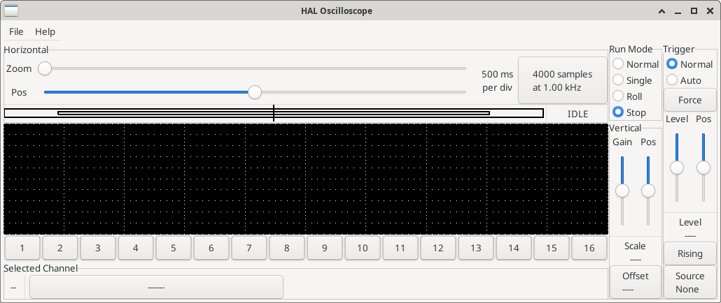

Initial scope window
Figure 10. Initial scope window
7.1. Hooking up the scope probes
At this point, Halscope is ready to use. We have already selected a sample rate and record length, so the next step is to decide what to look at. This is equivalent to hooking virtual scope probes to the HAL. Halscope has 16 channels, but the number you can use at any one time depends on the record length - more channels means shorter records, since the memory available for the record is fixed at approximately 16,000 samples.

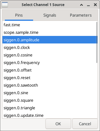

The channel buttons run across the bottom of the halscope screen. Click button 1, and you will see the Select Channel Source dialog as shown in the following figure. This dialog is very similar to the one used by Halmeter. We would like to look at the signals we defined earlier, so we click on the Signals tab, and the dialog displays all of the signals in the HAL (only two for this example).
Figure 11. Select Channel Source
To choose a signal, just click on it. In this case, we want channel 1 to display the signal X-vel. Click on the Signals tab then click on X-vel and the dialog closes and the channel is now selected.
Select Signal
Figure 12. Select Signal

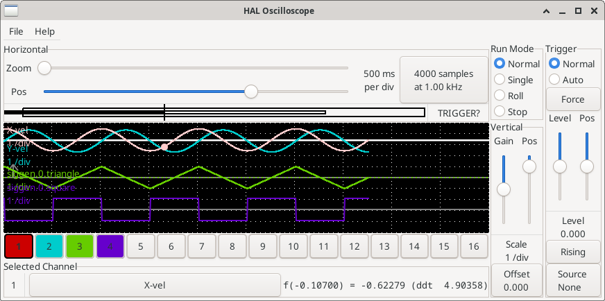

7.2. Capturing our first waveforms

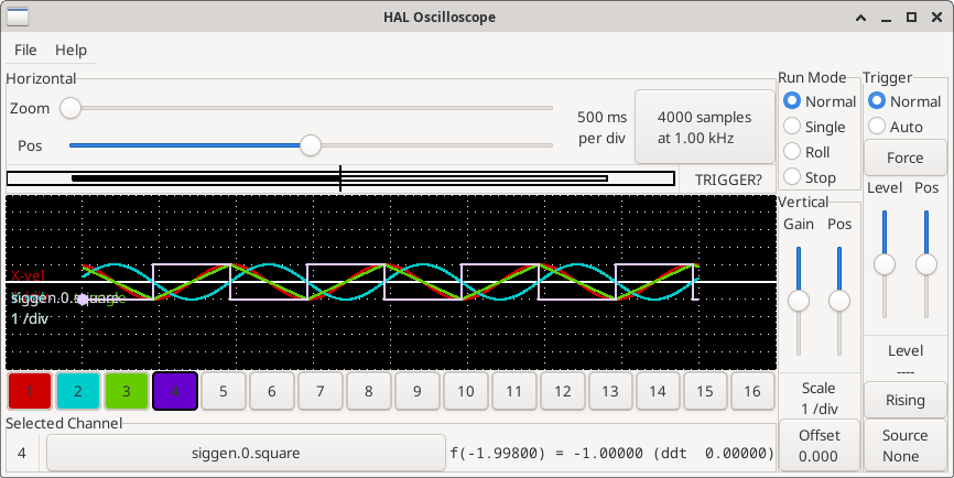

Now that we have several probes hooked to the HAL, it’s time to capture some waveforms. To start the scope, click the Normal button in the Run Mode section of the screen (upper right). Since we have a 4000 sample record length, and are acquiring 1000 samples per second, it will take halscope about 2 seconds to fill half of its buffer. During that time a progress bar just above the main screen will show the buffer filling. Once the buffer is half full, the scope waits for a trigger. Since we haven’t configured one yet, it will wait forever. To manually trigger it, click the Force button in the Trigger section at the top right. You should see the remainder of the buffer fill, then the screen will display the captured waveforms. The result will look something like the following figure.
Captured Waveforms
Figure 14. Captured Waveforms
The Selected Channel box at the bottom tells you that the purple trace is the currently selected one, channel 4, which is displaying the value of the pin siggen.0.square. Try clicking channel buttons 1 through 3 to highlight the other three traces.

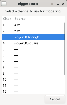

Using the Force button is a rather unsatisfying way to trigger the scope. To set up real triggering, click on the Source button at the bottom right. It will pop up the Trigger Source dialog, which is simply a list of all the probes that are currently connected. Select a probe to use for triggering by clicking on it. For this example we will use channel 3, the triangle wave as shown in the following figure.
Trigger Source Dialog
Figure 16. Trigger Source Dialog
After setting the trigger source, you can adjust the trigger level and trigger position using the sliders in the Trigger box along the right edge. The level can be adjusted from the top to the bottom of the screen, and is displayed below the sliders. The position is the location of the trigger point within the overall record. With the slider all the way down, the trigger point is at the end of the record, and halscope displays what happened before the trigger point. When the slider is all the way up, the trigger point is at the beginning of the record, displaying what happened after it was triggered. The trigger point is visible as a vertical line in the progress box above the screen. The trigger polarity can be changed by clicking the button just below the trigger level display. It will then become descendant. Note that changing the trigger position stops the scope once the position has been adjusted, you relaunch the scope by clicking on the Normal button of Run mode the group.

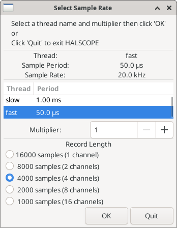

Sample Rate Dialog
Figure 18. Sample Rate Dialog

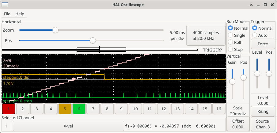

Now let’s look at the step pulses. Halscope has 16 channels, but for this example we are using only 4 at a time. Before we select any more channels, we need to turn off a couple. Clicking on a selected channel button (black border) will turn the channel off. So click on the channel 2 button, then click again on this button and the channel will turn off. Then click twice on channel 3 and do the same for channel 4. Even though the channels are turned off, they still remember what they are connected to, and in fact we will continue to use channel 3 as the trigger source. To add new channels, select channel 5, and choose pin stepgen.0.dir, then channel 6, and select stepgen.0.step. Then click run mode Normal to start the scope, and adjust the horizontal zoom to 5 ms per division. You should see the step pulses slow down as the velocity command (channel 1) approaches zero, then the direction pin changes state and the step pulses speed up again. You might want toincrease the gain on channel 1 to about 20 milli per division to better see the change in the velocity command. The result should look like the following figure.
Step Pulses
Figure 19. Step Pulses
