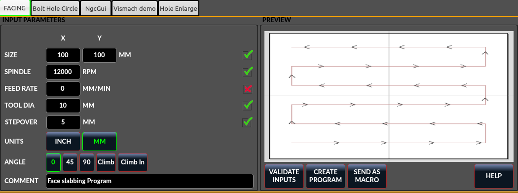

1.2. DetachTabWidget - Container Widget With User Detachable Panels
This container widget works just like a QTabWidget -it displays multiple panels one at a time with tabs to select.
If you double click the tab or drag the tab, the tab will detach from the main window.
When a tab is detached, the contents are placed into a QDialog.
The tab can be re-attached by closing the dialog or by double clicking on its window frame.
Он основан на PyQt’s QTabWidget.

2.13. MacroTab - Special Macros Widget
QtVCP MacroTab: Special Macros Widget
Figure 9. QtVCP MacroTab: Special Macros Widget
This widget allows a user to select and adjust special macro programs for doing small jobs.
It uses images for visual representation of the macro and for an icon.
It searches for special macros using the INI definition:
[RS274NGC]
SUBROUTINE_PATH =
The macros are O-word subroutines with special comments to work with the launcher. The first three lines must have the keywords below, the fourth is optional.
Here is a sample for the first four lines in an O-word file:
; MACROCOMMAND = Entry1,Entry2
; MACRODEFAULTS = 0,true
; MACROIMAGE = my_image.svg,Icon layer number,Macro layer number
; MACROOPTIONS = load:yes,save:yes,default:default.txt,path:~/macros
MACROCOMMAND
This is the first line in the O-word file.
It is a comma separated list of text to display above an entry.
There will be one for every variable required in the O-word function.
If the macro does not require variables, leave it empty:
; MACROCOMMAND=
MACRODEFAULTS
This must be the second line in the O-word file.
It is a comma separated list of the default values for each variable in the O-word function.
If you use the word radiotrue, radiofalse, true or false in the list, a *radiobutton* will be shown.
If you use the word checktrue or checkfalse in the list, a *checkbox* will be shown.
If you use the word buttontrue or buttonfalse in the list, a *Checkable Pushbutton* will be shown.
If the default has a decimal, macroTab assumes you want a float value otherwise an integer.
Note
When using radiobuttons, only set one radiobutton as true. Radio button are used for exclusive choices.
MACROIMAGE
This must be the third line in the O-word file.
  • SVG Images
    If using SVG image files, they must end with the .svg extension.
    The images must be added to SVG layers which are used to define the different images for macro and icon.
    Value is comma separated list of three ordered fields:
    ; MACROIMAGE=filename.svg,macro_layer_name[,icon_layer_name]
    With:
    _filename_.svg
    SVG image file name as first field.
    It is assumed to be in the same folder as the O-word file.
    *macro_layer_name
    Macro image layer name as second field.
    icon_layer_name
    Icon image layer name as optional third field. If the third entry is missing, the same image will be used for macro and icon.
  • PNG/JPG Images:
    Value remains a comma separated list:
    ; MACROIMAGE=macro_image.(png|jpg)[,icon_image.(png|jpg)]
    With:
    _macro_image_.(png|jpg)
    Macro image file name as first field.
    It is assumed that the image file are in the same folder than the macro.
    _icon_image_.(png|jpg)
    Icon image file name as optional second field.
    If the second entry is missing the same image will be used for macro and image.
If the keyword is present but the entries are missing, no images will be used.
MACROOPTIONS
This optional line must be the fourth line in the O-word file.
It is a comma separated list of keyword and data, all of which are optional:
LOAD:yes
Shows a load button.
SAVE:yes
Shows a save button.
DEFAULT:ThisMacroData.txt
Sets the default preselected filename when loading/saving data for this macro.
It can be any valid filename but must end in .txt.
PATH:~/linuxcnc/nc_files/mySavedMacrosData
Sets the default directory folder to preselect when loading/saving data for this macro.

6.3. Facing
QtVCP Facing: Shown from QtDragon
Slab or face a definable area with different strategies.
