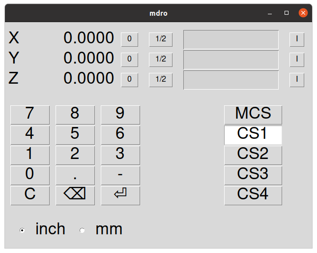

3. MDRO Window
The MDRO window contains the following elements:
A row for each axis. Each row includes:
the name of the axis,
the current value,
a "z" button that zeros the value,
a "1/2" button that halves the value,
a entry field that can be used to set a user-defined value. This field can be set from the keyboard or from the on-screen keypad.
A "I" button that starts an index operation (see below),
a keypad used to set values in the entry field via a mouse or touchscreen,
coordinate system selection buttons:
The "mcs" button selects the machine coordinate system. These are the raw values from the encoders connected to the
mdro.axis.npins. -
The "cs1" - "cs4" buttons allow the user to select among one of four user-defined coordinate systems. If the program is started with the
MDRO_VAR_FILE =option, the labels will be changed to "g54" - "g57" and the values from the specified .var file will be preloaded. Note that any changes to the values are not persistent: the .var file is never changed.
Inch/Millimeter selection buttons.
