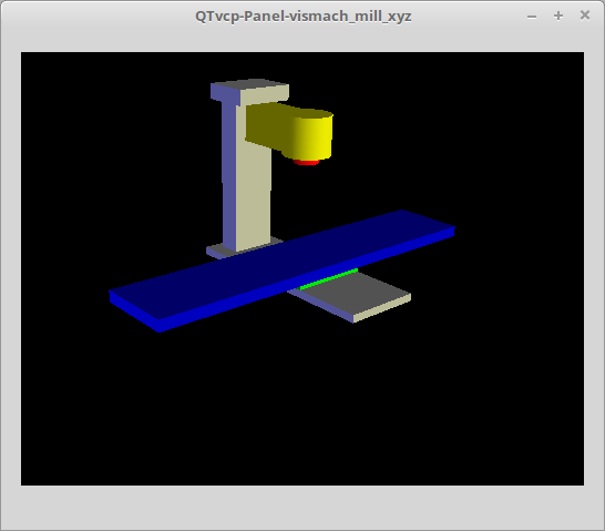

Vismach displays the model in a 3D viewport and the model parts are animated as the values of associated HAL pins change.
QtVismach 3D Viewport
The Vismach 3D viewport view can be manipulated as follows:
  • zoom by scroll wheel
  • pan by middle button drag
  • rotate by right-button drag
  • tilt by left button drag

Taking the mill shown in the 3D Viewport picture above for example:
  • If you move X, it can move on its own,
  • but if you move Y, it will also move X assembly, as it is attached to Y assembly.
So for this machine, the tree looks like this:
