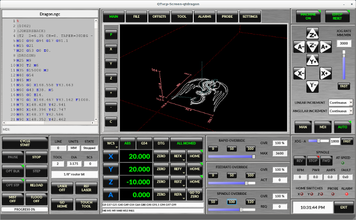

Enrutador QtDragon
Figure 1. QtDragon - 3/4-Axis Sample

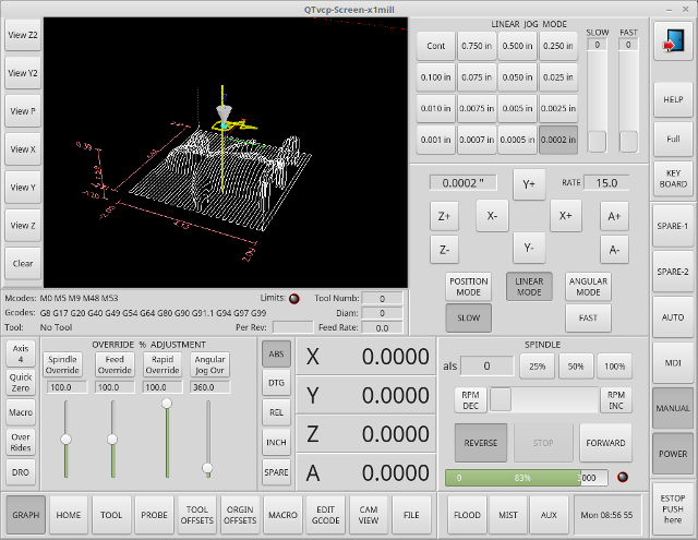

Qtscreen x1mill
Figure 5. X1mill - 4-Axis Sample
