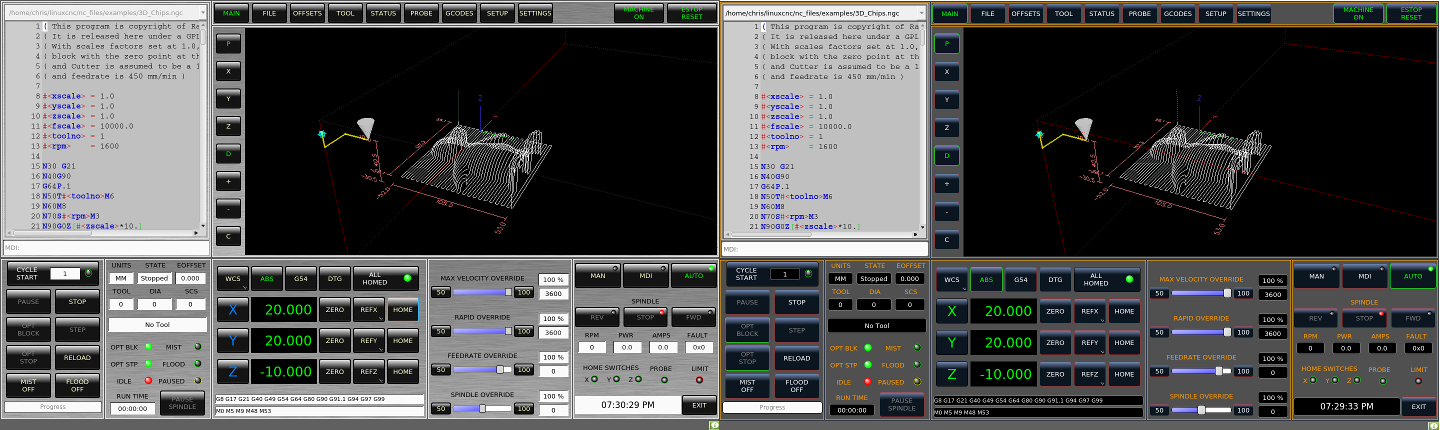

1. Introduction

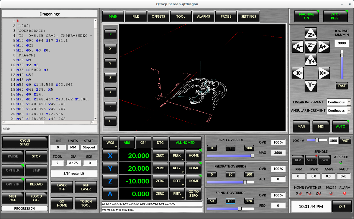

QtDragon and QtDragon_hd are built with the QtVCP framework. It is the creative vision of forum personality Persei8. Much of it is based on the excellent work of others in the LinuxCNC community. LinuxCNC’s version is adapted from Persei8’s Github versions. It is primarily meant for 3/4 axes machines such as mills or routers. It works well with a touchscreen and/or mouse. QtDragon supports multiple ways to touch off tools and probing work pieces. You can use LinuxCNC’s external offsets capability to automatically raise the spindle during a pause. If you the VersaProbe option and remap code you can add auto tool length probing at tool changes.
QtDragon and QtVCP are relatively new programs added into LinuxCNC. Bugs and oddities are possible. Please test carefully when using a dangerous machine. Please forward reports to the forum or maillist.

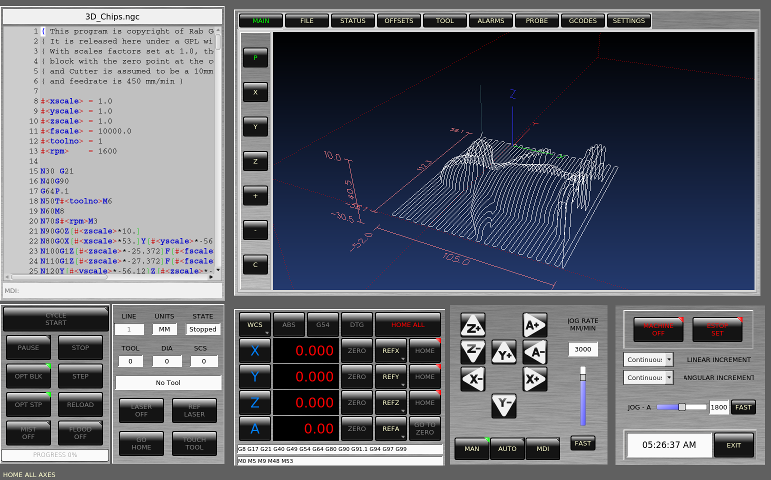

1.1. QtDragon
QtDragon Router
QtDragon is resizable from a resolution of 1280x768 to 1680x1200. It will work in window mode on any monitor with higher resolution but not on monitors with lower resolution.

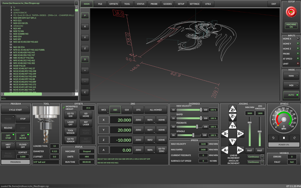

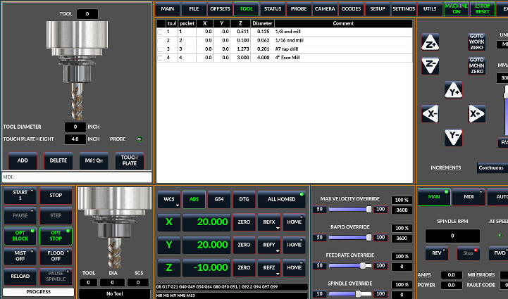

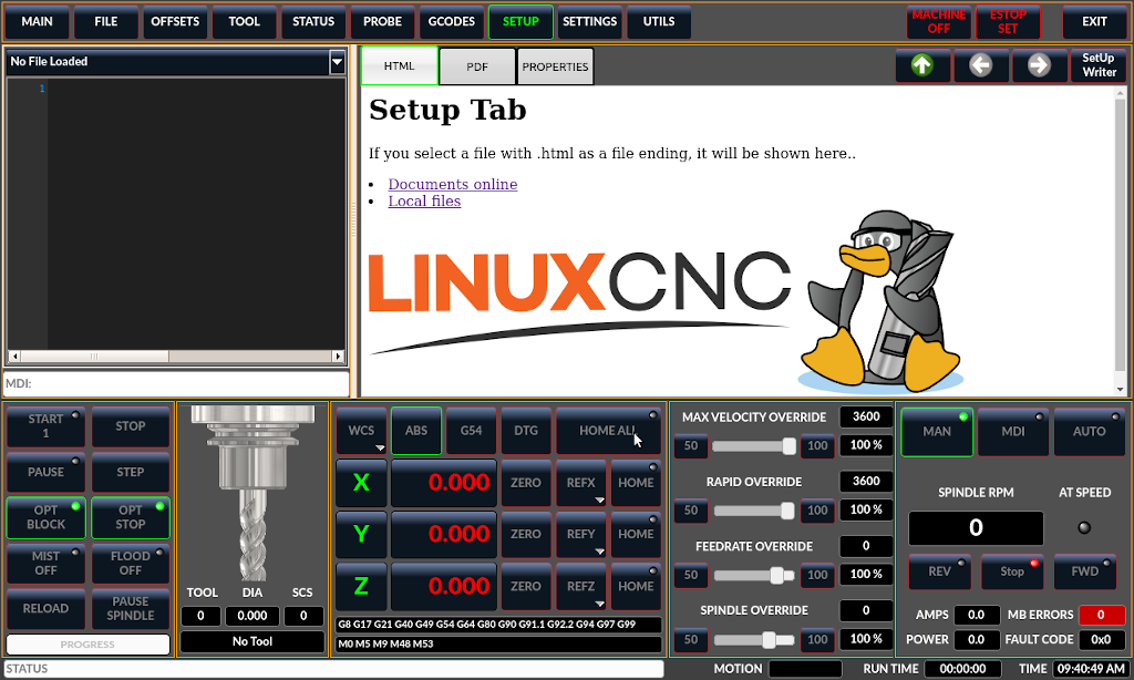

1.2. QtDragon_hd
QtDragon_hd
QtDragon_hd is a similar design as QtDragon but modified to utilize the extra space of modern larger monitors. There are some small differences in layout and utility.
QtDragon_hd has a resolution of 1920x1056 and is not resizeable. It will work in window mode on any monitor with higher resolution but not on monitors with lower resolution.

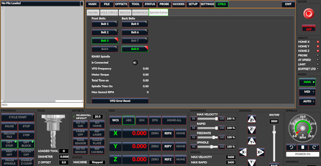

2.9.2. Embedding Spindle Belts Panel
This example panel is designed to display additional RS485 VFD data and also to configure a 4 sheave, 2 belt spindle drive via a series of buttons.
QtDragon spindle_belts Panel - Spindle Belts VCP
[DISPLAY]
EMBED_TAB_NAME = Spindle Belts
EMBED_TAB_COMMAND = qtvcp spindle_belts
EMBED_TAB_LOCATION = tabWidget_utilities

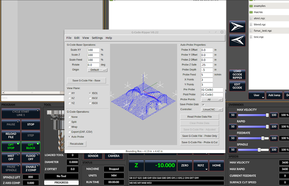

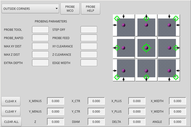

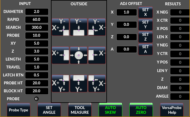

2.13. Probe/Touchplate/Laser Settings
QtDragon has INI entries for two optional probing tab screens available. Comment/uncomment which ever you prefer.
  • Versa probe is a QtVCP ported version of a popular GladeVCP probing panel.
  • Basic Probe is a QtVCP ported version based on the third party basic probe screen.
Both perform similar probing routines, though Versa probe optionally handles auto tool measurement.
[PROBE]
#USE_PROBE = versaprobe
USE_PROBE = basicprobe

These pins are inputs related to spindle VFD indicating.
The volt and amp pins are used to calculate spindle power. You must also set the MAX_SPINDLE_POWER in the INI.
This bit pin is an output to the spindle control to pause it.
You would connect it to spindle.0.inhibit.
QtDragon spindle speed display and spindle-at-speed LED require that spindle.0.speed-in be connected to spindle speed feedback.
Encoder or VFD feedback could be used, as long as the feedback is in revolutions per second (RPS).
If no feedback is available you can have the display show the requested speed by connecting pins like so:

11.1. Using G-code Ripper for Z level Compensation
QtDragon G-code Ripper
G-code Ripper offers many functions that we will not go in to here. This is only available in the QtDragon_hd version.
  • In qtdragon_hd, switch to the file tab and press the load G-code Ripper button.
  • Set origin to match the origin of the G-code file to be probed.
  • Under G-Code Operations, check Auto Probe.
  • File -> Open G-Code File (The file you will run after compensation)
  • If necessary, make adjustments and press Recalculate.
  • Press Save G-Code File - Probe Only.
  • Save the generated file to the nc_files folder.
  • Exit gcode_ripper.
  • Without changing the offsets, run this program. Make sure the probe tool is installed. When complete, there will be a file in the config directory called probe_points.txt.
  • In qtdragon_hd, press the Enable Z Comp button to enable compensation. Look at the status line for indication of success or failure. Active compensation will be displayed beside the label: Z Level Comp While jogging that display should change based on the compensation component.
If you use auto raise Z to lift the spindle on pause, you must combine the two with a HAL component and feed that to LinuxCNC’s motion component.

12.1. Versa Probe
QtDragon Probe
Versa probe is used to semi-automatically probe work pieces to find edges, centers and angles.
It can also be sued to auto probe tool length at tool changes with added remap code.
You must carefully set the Probing Parameters:
  • DIAMETER:: This is the diameter of the probe tip. The accuracy of probe measurements is directly affected by the accuracy of the probe tip diameter.
  • TRAVEL:: The distance that the probe will travel during the initial search. If the search distance is too short, you will receive a message like "G38 finished without making contact". For safety reasons, it is recommended to set this parameter to 3-4 mm more than probe stylus diameter.
  • LATCH RTN:: The distance the probe is retracted after making initial contact with the workpiece. This should be a short distance because the second approach will be at a slow speed, but large enough for the probe to break contact and bring it to the search ready state. If the Latch Rtn distance too large, you will end up spending a lot of time waiting for the search to complete. Recommendation: 1-2 mm
  • SEARCH:: This is the feed rate at which the probe searches for the target workpiece in machine units per minute. The search speed should be slow enough to give an acceptable initial accuracy, but fast enough to not waste time waiting for movement. Recommendation: 200-500 mm/min.
  • PROBE:: Once initial contact has been made and the probe is retracted, it will wait for 0.5 seconds before performing the search again at a lower speed, the probe velocity. This lower speed ensures the machine can stop movement as quickly as possible on contact with the workpiece.
  • RAPID:: Axis movements not associated with searching are done at the speed defined by RAPID in machine units per minute.
  • SIDE/EDGE LENGTH:: This is the distance the probe will move at the rapid rate to the position where it will begin a search. If measuring a corner, it will move EDGE LENGTH units away from the corner, then move away from the workpiece by XY CLEARANCE, lower by Z CLEARANCE and begin the initial search. If measuring an inner circle, then EDGE LENGTH should be set to the approximate radius of the circle. Note: NOT the diameter.
  • PROBE HT:: The height of the tool sensor from the machine table surface. This value is used to calculate the Z zero height for the current work coordinate system when using the probe with a tool setter sensor.
  • BLOCK HT:: The height of the top of the workpiece from the machine table surface. This value is used to calculate the Z zero height for the current work coordinate system when using the probe with a tool setter sensor.
  • XY CLEARANCE:: The distance that the probe will move away from an edge or corner before performing a search. It should be large enough to ensure that the probe will not contact the workpiece or any other fixtures before moving down. It should be small enough to avoid excessive waiting for movement while searching.
  • Z CLEARANCE:: The distance that the probe will move down before performing a search. If measuring an inside hole, the probe could be manually jogged to the starting Z height and then set Z CLEARANCE to 0.
There are three toggle buttons:
  • Auto Zero This selects if after probing the relevant axis is set to zero in the current user system.
  • Auto Skew This selects if after probing, the system will be rotated or just display the calculated rotation.
  • Tool Measure This (if integrated) turns auto tool probing on and off.
12.2. Basic probe
QtDragon Probe
Basic probe is used to semi-automatically probe work pieces to find edges, centers and angles. The combo box allows selecting the basic type of probing buttons shown:
  • Outside Corners
  • Inside Corners
  • Edge Angles
  • Boss and Pockets
  • Ridge and Valleys
  • Calibration
  • Probe Tool: will only allow probing if this tool number is in the spindle
  • Probe Diameter: the size of the probe tip
  • Probe Rapid: the speed of rapid moves in machine units
  • Probe Search: the speed of the first rough search in machine units
  • Probe Feed: the speed of the second fine search in machine units
  • Step Off: back off and re-probe distance
  • Max XY Distance: the maximum distance the probe will search for in X and Y before failing with error
  • Max Z Distance: the maximum distance the probe will search for in Z before failing with error
  • XY Clearance: clearance distance from probe to wall edge before rapid traversing down in Z and rough probing
  • Z Clearance: clearance distance from probed to top of material
  • Extra Depth: distance from top of material to desired probe depth
There are also hint parameters depending on selected probing type:
  • Edge Width: desired distance from the probe start position, along wall edge before starting to probe
  • Diameter Hint: used by Round Boss or Round Pocket probing (start move: 1/2 diameter plus XY clearance)
  • X Hint: used by Rectangular Boss/Pocket probing (start move: 1/2 X length plus XY clearance)
  • Y Hint: used by Rectangular Boss/Pocket probing (start move: 1/2 Y length plus XY clearance)
After setting the parameters and hints:
  • Manually move the probe to the approximate position represented by the green target on the button.
  • Confirm the parameters are reasonable.
  • Press the desired probing button.
The probing routine will start immediately.
Pressing the stop button or the keyboard escape key, will abort the probing.
12.2.1. Corner Probe Example
Lets discuss inside corner probing using the top right button in Basic Probe (back_right_inside). While all probe entries must be correct, the most important settings to change for each each probe:
  • XY CLEARANCE - distance away from edge before rough probing,
  • Z CLEARANCE - distance from probe to top of material,
  • EXTRA DEPTH - distance to lower probe from top of material,
  • EDGE WIDTH - distance along edge wall (away from corner) to start probing.
These distance are always to be set in machine units (mm for metric machine, inch for imperial machine).
Preset:
  • manual set probe at the intersection of the edges (ie corner) of material as described by the green bullseye on the button. Set it Z CLEARANCE above the top of material. These can be done by eye.
  • set EXTRA CLEARANCE to a value that you want the probe to go below the top of material. (So the probe will move from its start position down Z Clearance + Extra Clearance distance.)
  • set XY CLEARANCE to a value that definitely gives clearance from the wall so when the probe goes down it does not hit anything.
  • set EDGE WIDTH to a value that describes the distance measured from the corner, along the wall to where you wish to probe. this edge distance will be used along the X wall and then the Y wall.
Sequence after pressing the probe button:
  1. Rapid EDGE WIDTH distance away from corner at the same time moving XY CLEARANCE away from edge. So this is a slightly diagonal move.
  2. Move probe down by Z CLEARANCE + EXTRA DEPTH,
  3. probe wall twice (rough and fine),
  4. move diagonally to the other wall as set by EDGE WIDTH and XY CLEARANCE,
  5. probe wall twice,
  6. raise probe up by Z CLEARANCE + EXTRA DEPTH (returns to starting height),
  7. rapid back to starting corner (now calculated using the probed walls),
  8. if auto zero button is enabled, set X and Y of the current user system to zero.

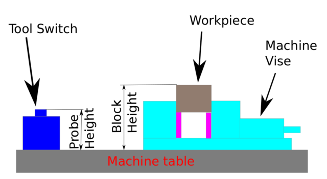

14. Auto Tool Measurement
QtDragon can be setup to do integrated auto tool measurement using the Versa Probe widget and remap code. To use this feature, you will need to do some additional settings and you may want to use the offered HAL pin to get values in your own ngc remap procedure.
Before starting the first test, do not forget to enter the probe height and probe velocities on the versa probe settings page.
Tool Measurement in QtDragon is done with the following steps:
  • Touch off your workpiece in X and Y.
  • Measure the height of your block from the base, where your tool switch is located, to the upper face of the block (including chuck etc.).
  • In the Versa probe tab, enter the measured value for block height.
  • Make sure the use tool measurement button in the Vesa probe tab is enabled.
  • Go to auto mode and start your program.
When fist setting up auto tool measurement, please use caution until you confirm tool change and probe locations - it is easy to break a tool/probe. Abort will be honoured while the probe is in motion.
images/sketch_auto_tool_measurement.png
With the first given tool change the tool will be measured and the offset will be set automatically to fit the block height. The advantage of this way is, that you do not need a reference tool.
Your program must contain a tool change at the beginning. The tool will be measured, even it has been used before, so there is no danger if the block height has changed. There are several videos on you tube that demonstrate the technique using GMOCCAPY. The GMOCCAPY screen pioneered the technique.
The sequence of events (using the default files):
  • Rapid move in Z to position defined in the INI’s [TOOL_CHANGE] Z
  • Rapid move in X and Y to number defined in INI’s [TOOL_CHANGE] X and Y
  • Request tool change
  • Rapid move in X and Y to position defined in the INI’s [VERSA_TOOLSETTER] X and Y
  • Rapid move down in Z to position defined in the INI’s [VERSA_TOOLSETTER] Z
  • Probe down in Z to maximum defined in the INI’s [VERSA_TOOLSETTER] MAXPROBE
  • Return Z to position defined in the INI’s [TOOL_CHANGE] Z
The [TOOL_CHANGE] Z position should be high enough so the tool will not hit the tool probe when moving to the [VERSA_TOOLSETTER] X and Y position. MAXPROBE distance needs to be high enough for the tool to touch the probe.

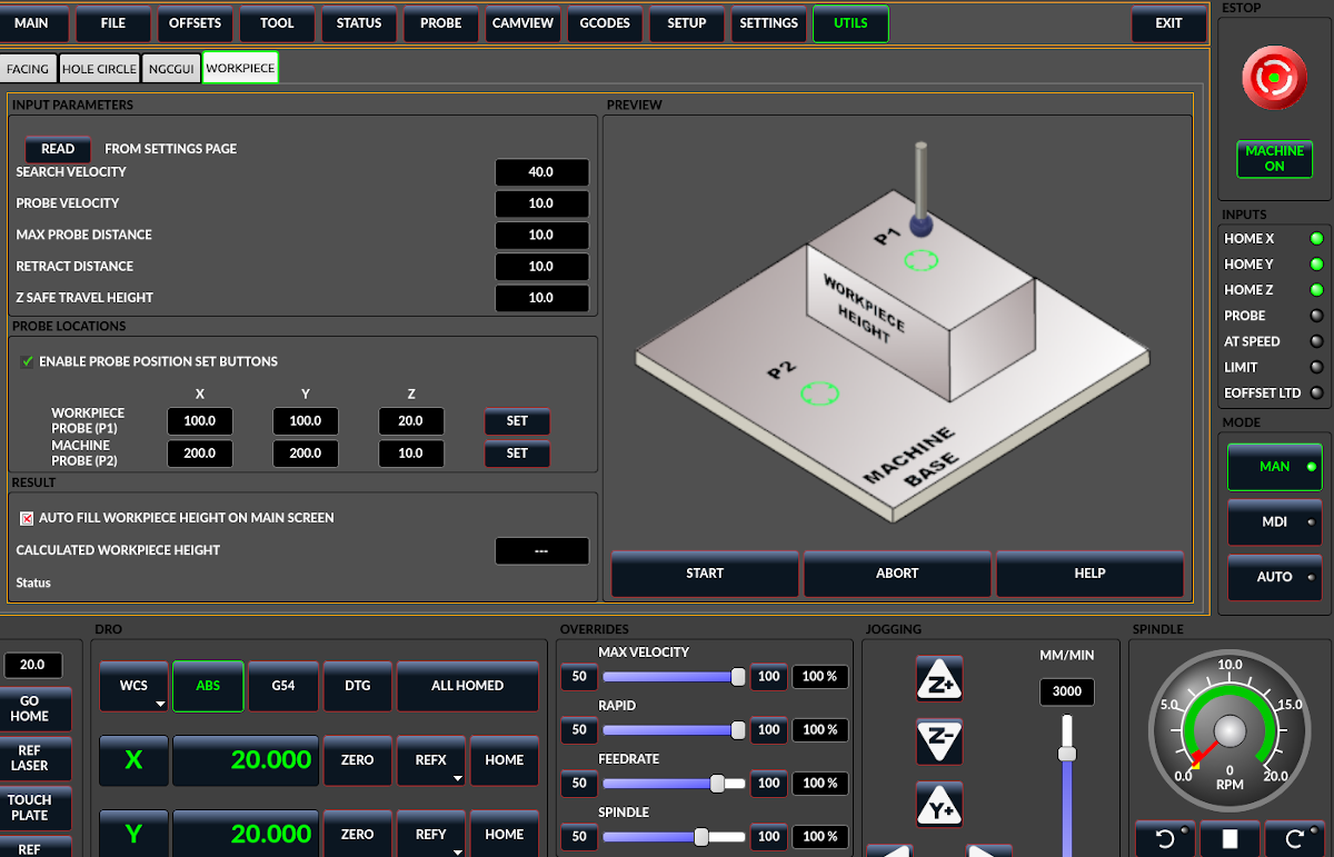

14.1. Work Piece Height Probing
QtDragon_hd height probing
This program probes 2 user specified locations in the Z axis and calculates the difference in heights.
Enable Probe Position Set Buttons
  • When checked, the SET buttons are enabled.
  • This allows the user to automatically fill in the X, Y and Z parameters with the current position as displayed on the DROs.
Autofill Workpiece Height on Main Screen
  • When checked, the calculated height is automatically transferred to the Workpiece Height field in the main screen.
  • Otherwise, the main screen is not affected.
Workpiece Probe At
  • the X, Y and Z coordinates specify where the first probing routine should start, in current WCS
Machine Probe At
  • the X, Y and Z coordinates specify where the second probing routine should start, in current WCS
Z Safe Travel Height
  • The machine is raised to the Z safe travel height before jogging to the X and Y coordinates.
  • The spindle then lowers to the specified Z coordinate.
  • It should be selected so that the tool clears all obstructions while jogging.
START button
  • The machine will jog to the first location and then probe down.
  • The machine then jogs to the second location and probes down again.
  • The difference in probed values is reported as Calculated Workpiece Height.
  • The parameters for search velocity, probe velocity, maximum probe distance and return distance are read from the main GUI Settings page.
ABORT button
  • causes all jog and probe routines currently executing to stop.
HELP button
  • displays this help file.
  • Any 2 points within the machine operating volume can be specified.
  • If the first point is higher than the second, the calculated height will be a positive number.
  • If the first point is lower than the second, the calculated height will be a negative number.
  • Units are irrelevant in this program. The probed values are not saved and only the difference is reported.

Versaprobe offers 5 output pins for tool measurement purpose. The pins are used to be read from a remap G-code subroutine, so the code can react to different values.
  • qtversaprobe.enable (HAL_BIT) measurement enabled or not tool. Reflects screen button state.
  • qtversaprobe.blockheight (HAL_FLOAT) the measured height of the top face of the workpiece. Reflects screen entry.
  • qtversaprobe.probeheight (HAL_FLOAT) the toolsetter probe switch height. Reflects screen entry.
  • qtversaprobe.searchvel (HAL_FLOAT) the velocity to search for the tool probe switch
  • qtversaprobe.probevel (HAL_FLOAT) the velocity to probe tool length. Reflects screen entry.
  • qtversaprobe.backoffdist (HAL_FLOAT) the distance the probe backs off after triggering. Reflects screen entry.

17.4. Tool Tab
You can monitor/modify tool offsets from this tab. Adding and deleting tools from the tool file can also be done from this tab. When this tab is selected the individual home buttons in the DRO area will change to tool offset setting buttons. They will return to home buttons when you select another tab. Pressing this tool button will drop down a when menu of options:

17.6. Probe Tab
Probing routines options are displayed on this tab. Depending on INI options, this could be VersaProbe or BasicProbe style. They are functionally similar. QtDragon_hd will also show a smaller graphics display window.

17.9. Setup Tab
It’s possible to load HTML or PDF file (.html / .pdf ending) with setup notes, and will be displayed in the setup tab.
If you load a G-code program and there is an HTML/PDF file of the same name, it will load automatically.
Some program, such as Fusion 360 and Aspire will create these files for you. You can also write your own HTML docs with the included SetUp Writer button.
There are three sub tabs:
  • HTML - any loaded HTML pages are displayed here. The navigation buttons work on this page.
  • PDF - any loaded PDF setup pages are displayed here.
  • PROPERTIES - when a program is loaded its G-code properties are displayed here.
There are navigation buttons for HTML page:
  • The up arrow returns you to the default HTML page.
  • The left arrow moves backward one HTML page.
  • The right arrow moves forward one HTML page.
If you wish to include a custom default HTML page, name it default_setup.html and place it in your configuration folder.
Custom QtVCP panels can be displayed in this tab by setting the EMBED_TAB_LOCATION option to tabWidget_setup.

17.11. Utilities Tab
This tabs will display another stab election of G-code utility programs:
  • Facing: allows quick face milling of a definable area at angles of 0,45 and 90 degrees.
  • Hole Circle: allows quick setting of a program to drill a bolt circle of definable diameter and number of holes.
  • NGCGUI: is a QtVCP version of the popular G-code subroutine builder/selector, see Widgets-NGCGUI.
Custom QtVCP panels can be displayed here by setting the EMBED_TAB_LOCATION option to tabWidget_utilities
