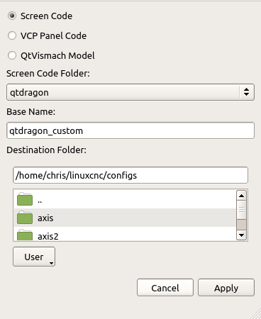

1.1. copy
Used for copying QtVCP’s builtin Screens/VCP Panels/QtVismach code to a folder so one can customize it.
In a terminal run:
QtVCP copy Dialog - Screen, Panel or Vismach Code Copy Panel

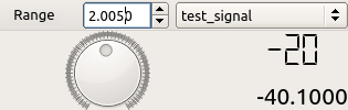

1.3. test_dial
  • This panel has a dial that adjusts S32 and Float HAL output pins.
  • The dial’s range can be adjusted from a drop down menu.
  • The output can be scaled with the spinbox.
  • A combobox can be used to automatically select and connect to a signal.
QtVCP test_dial Panel - Test Dial VCP

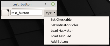

1.4. test_button
  • This panel has a button that will set a HAL pin.
  • The button can be selected as a momentary or a toggle button.
  • The button’s indicator color can be adjusted from a drop down menu.
  • You can add more buttons from the drop down menu.
  • You can load a Halmeter from the drop down menu.
  • You can load a test LED from the drop down menu.
  • The button can be detached from the main windows.
Here is how to load test_button from a HAL script:
The -o switch sets how many buttons the panel starts with.
If loading directly from a terminal omit the loadusr.
QtVCP test_button - Test Button VCP

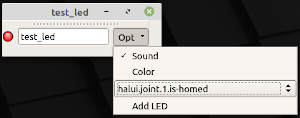

1.5. test_led
  • This panel has an LED that can selected to watch HAL bit pins/signals.
  • The LED’s color can be adjusted from a drop down menu.
  • The text box and state can be output as speech if sound is selected.
  • A combobox can be used to automatically select and connect to a pin/signal.
  • You can add more LEDs from the drop down menu.
  • The LED can be detached from the main windows.
Here is how to load test_led from a HAL script:
The -o switch sets how many LEDs the panel starts with.
QtVCP test_dial Panel - Test LED VCP

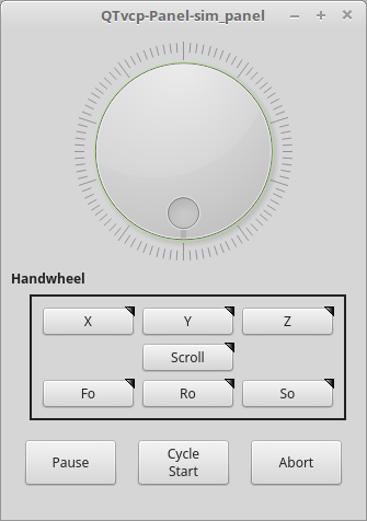

1.8. sim_panel
Small control panel to simulate MPG jogging controls etc for simulated configurations.
The MPG, selection buttons and control buttons export HAL pins to connect to linuxcnc.
The selection and control group boxes can be hidden if not needed by using the -o hide= option.
groupBoxControl and groupBoxSelection are the widget names that can be hidden.
If you want to hide both, use a comma between them with no spaces.
The -a option will make the panel always-on-top of all windows.
Here we load the panel with no MPG selection buttons and the always-on-top option.
QtVCP sim_panel - Simulated Controls Panel For Screen Testing

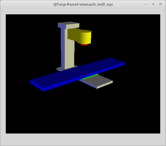

2.1. QtVCP vismach_mill_xyz
3D OpenGL view of a 3-Axis milling machine.
QtVCP vismach_mill_xyz - 3-Axis Mill 3D View Panel

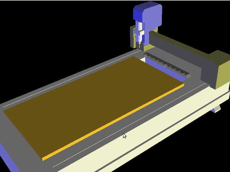

2.2. QtVCP vismach_router_atc
3D OpenGL view of a 3-Axis router style, gantry bed milling machine.
This particular panel shows how to define and connect the model parts in the handler file, rather then importing the pre-built model from QtVCP’s vismach library.
QtVCP vismach_router_atc - 3-Axis Gantry Bed Mill 3D View Panel

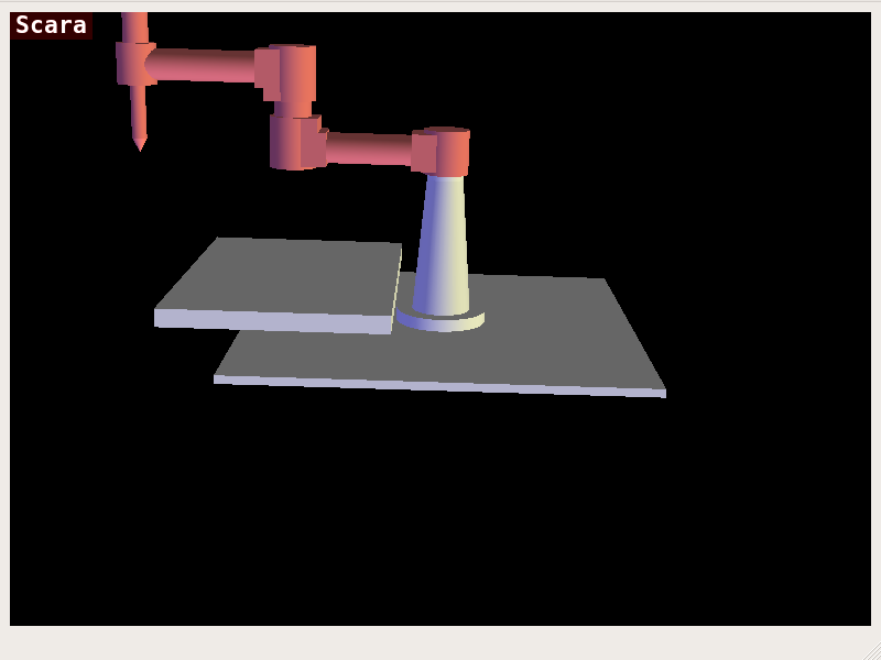

2.3. QtVCP vismach_scara
3D OpenGL view of a SCARA based milling machine.
QtVCP vismach_scara - SCARA Mill 3D View Panel

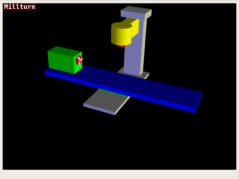

2.4. QtVCP vismach_millturn
3D OpenGL view of a 3-Axis milling machine with an A axis/spindle.
QtVCP vismach_millturn - 4 Axis MillTurn 3D View Panel

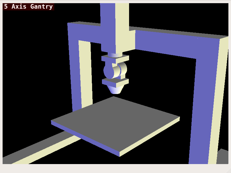

2.5. QtVCP vismach_mill_5axis_gantry
3D OpenGL view of a 5-Axis gantry type milling machine.
QtVCP vismach_mill_5axis_gantry - 5-Axis Gantry Mill 3D View Panel

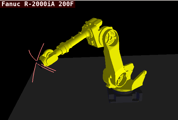

2.6. QtVCP vismach_fanuc_200f
3D openGL view of a 6 joint robotic arm.
QtVCP vismach_fanuc_200f - 6 Joint Robotic Arm
