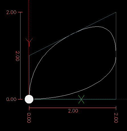

7. G5 Cubic Spline
  • I - X incremental offset from start point to first control point
  • J - Y incremental offset from start point to first control point
  • P - X incremental offset from end point to second control point
  • Q - Y incremental offset from end point to second control point
G5 creates a cubic B-spline in the XY plane with the X and Y axes only. P and Q must both be specified for every G5 command.
For the first G5 command in a series of G5 commands, I and J must both be specified. For subsequent G5 commands, either both I and J must be specified, or neither. If I and J are unspecified, the starting direction of this cubic will automatically match the ending direction of the previous cubic (as if I and J are the negation of the previous P and Q).
For example, to program a curvy N shape:
G5 Sample initial cubic spline
A second curvy N that attaches smoothly to this one can now be made without specifying I and J:
G5 Sample subsequent cubic spline

G5.2 Example
Sample NURBS Output
Sample NURBS Output
More information on NURBS can be found here:

35. G61 Exact Path Mode
  • G61 - Exact path mode, movement exactly as programmed. Moves will slow or stop as needed to reach every programmed point. If two sequential moves are exactly co-linear movement will not stop.
36. G61.1 Exact Stop Mode
  • G61.1 - Exact stop mode, movement will stop at the end of each programmed segment.
37. G64 Path Blending
  • P - motion blending tolerance
  • Q - naive cam tolerance
  • G64 - best possible speed. Without P means to keep the best speed possible, no matter how far away from the programmed point you end up.
  • G64 P- - Blend between best speed and deviation tolerance
  • G64 P- <Q- > blending with tolerance. It is a way to fine tune your system for best compromise between speed and accuracy. The P- tolerance means that the actual path will be no more than P- away from the programmed endpoint. The velocity will be reduced if needed to maintain the path. If you set Q to a non-zero value it turns on the Naive CAM Detector: when there are a series of linear XYZ feed moves at the same feed rate that are less than Q- away from being collinear, they are collapsed into a single linear move. On G2/G3 moves in the G17 (XY) plane when the maximum deviation of an arc from a straight line is less than the G64 P- tolerance the arc is broken into two lines (from start of arc to midpoint, and from midpoint to end). those lines are then subject to the naive cam algorithm for lines. Thus, line-arc, arc-arc, and arc-line cases as well as line-line benefit from the Naive CAM Detector. This improves contouring performance by simplifying the path. It is OK to program for the mode that is already active. See also the Trajectory Control section for more information on these modes. If Q is not specified then it will have the same behavior as before and use the value of P-. Set Q to zero to disable the Naive CAM Detector.
G64 P- Example Line
It is a good idea to include a path control specification in the preamble of each G-code file.

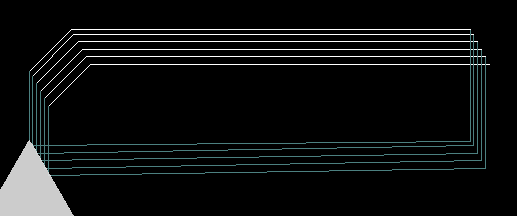

38. G70 Lathe finishing cycle
  • Q - The subroutine number.
  • X - The starting X position, defaults to the initial position.
  • Z - The starting Z position, defaults to the initial position.
  • D - The starting distance of the profile, defaults to 0.
  • E - The ending distance of the profile, defaults to 0.
  • P - The number of passes to use, defaults to 1.
The G70 cycle is intended to be used after the shape of the profile given in the subroutine with number Q has been cut with G71 or G72.
  • Preliminary motion.
    • If Z or X are used a rapid move to that position is done. This position is also used between each finishing pass.
    • Then a rapid move to the start of the profile is executed.
    • The path given in Q- is followed using the G1 and [gcode:g2-g3] commands.
    • If a next pass is required there is another rapid to the intermediate location, before a rapid is done to the start of the profile.
    • After the final pass, the tool is left at the end of the profile including E-.
  • Multiple passes. The distance between the pass and the final profile is (pass-1)*(D-E)/P+E. Where pass the pass number and D,E and P are the D/E/P numbers.
  • The distance is computed using the starting position of the cycle, with a positive distance towards this point.
  • Fillet and chamfers in the profile. It is possible to add fillets or chamfers in the profile, see [gcode:g71-g72] for more details.
It is an error if:
  • There is no subroutine defined with the number given in Q.
  • The path given in the profile is not monotonic in Z or X.
  • [gcode:g17-g19.1] has not been used to select the ZX plane.
