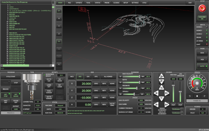

1.1. QtDragon
QtDragon Router
Figure 1. QtDragon - 3 to 5 axis sample (1440x860) in silver theme
QtDragon is resizable from a resolution of 1280x768 to 1680x1200. It will work in window mode on any monitor with higher resolution but not on monitors with lower resolution.

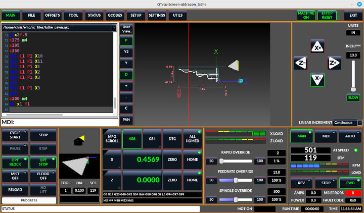

1.2. QtDragon_lathe
QtDragon Lathe
QtDragon_lathe is a modified version of QtDragon more suitable for lathes.
It is resizable from a resolution of 1280x768 to 1680x1200.

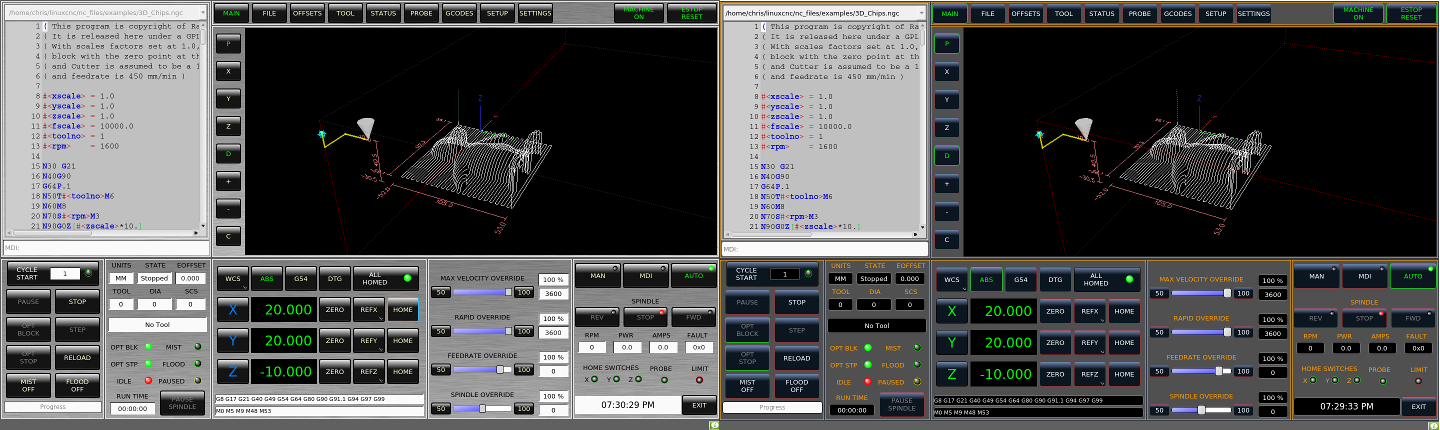

1.3. QtDragon_hd
QtDragon_hd
Figure 2. QtDragon_hd - 3 to 5 axis sample for larger monitors (1920x1056) in dark theme
QtDragon_hd is a similar design as QtDragon but modified to utilize the extra space of modern larger monitors. There are some small differences in layout and utility.
QtDragon_hd has a resolution of 1920x1056 and is not resizeable. It will work in window mode on any monitor with higher resolution but not on monitors with lower resolution.

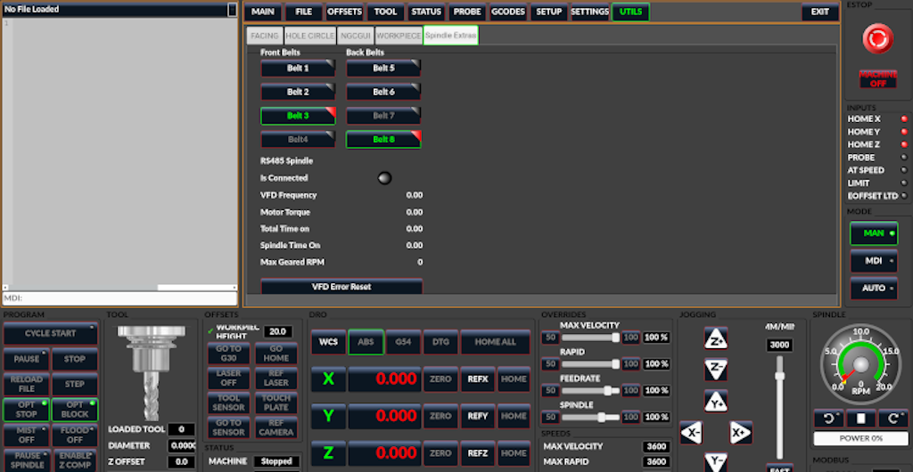

2.10.2. Embedding Spindle Belts Panel
This example panel is designed to display additional RS485 VFD data and also to configure a 4 sheave, 2 belt spindle drive via a series of buttons.
QtDragon spindle_belts Panel - Spindle Belts VCP
[DISPLAY]
EMBED_TAB_NAME = Spindle Belts
EMBED_TAB_COMMAND = qtvcp spindle_belts
EMBED_TAB_LOCATION = tabWidget_utilities

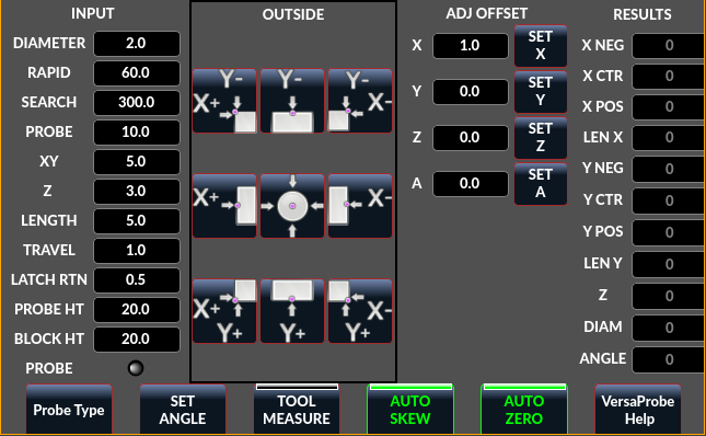

2.14. Probe/Touchplate/Laser Settings
QtDragon has INI entries for two optional probing tab screens available. Comment/uncomment which ever you prefer.
  • Versa probe is a QtVCP ported version of a popular GladeVCP probing panel.
  • Basic Probe is a QtVCP ported version based on the third party basic probe screen.
Both perform similar probing routines, though Versa probe optionally handles auto tool measurement.
[PROBE]
#USE_PROBE = versaprobe
USE_PROBE = basicprobe

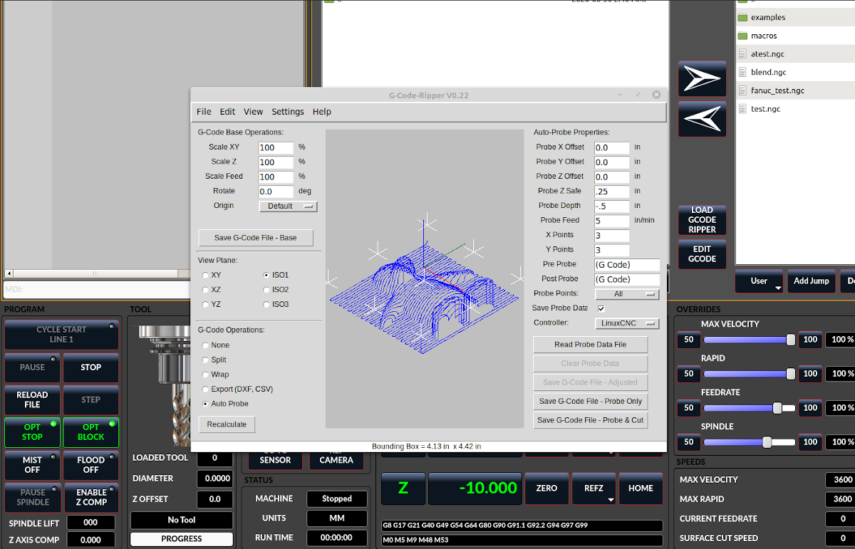

11.1. Using G-code Ripper for Z level Compensation
QtDragon G-code Ripper
Figure 3. QtDragon_hd showing G-code Ripper
Note
G-code Ripper offers many functions that we will not go in to here. This is only available in the QtDragon_hd version.
  • In qtdragon_hd, switch to the file tab and press the load G-code Ripper button.
  • Set origin to match the origin of the G-code file to be probed.
  • Under G-Code Operations, check Auto Probe.
  • File -> Open G-Code File (The file you will run after compensation)
  • If necessary, make adjustments and press Recalculate.
  • Press Save G-Code File - Probe Only.
  • Save the generated file to the nc_files folder.
  • Exit gcode_ripper.
  • Without changing the offsets, run this program. Make sure the probe tool is installed. When complete, there will be a file in the config directory called probe_points.txt.
  • In qtdragon_hd, press the Enable Z Comp button to enable compensation. Look at the status line for indication of success or failure. Active compensation will be displayed beside the label: Z Level Comp While jogging that display should change based on the compensation component.

Versa probe is used to semi-automatically probe work pieces to find edges, centers and angles.
It can also be sued to auto probe tool length at tool changes with added remap code.
You must carefully set the Probing Parameters:
DIAMETER
This is the diameter of the probe tip. The accuracy of probe measurements is directly affected by the accuracy of the probe tip diameter.
TRAVEL
The distance that the probe will travel during the initial search. If the search distance is too short, you will receive a message like "G38 finished without making contact". For safety reasons, it is recommended to set this parameter to 3-4 mm more than probe stylus diameter.
LATCH RTN
The distance the probe is retracted after making initial contact with the workpiece. This should be a short distance because the second approach will be at a slow speed, but large enough for the probe to break contact and bring it to the search ready state. If the Latch Rtn distance too large, you will end up spending a lot of time waiting for the search to complete. Recommendation: 1-2 mm
SEARCH
This is the feed rate at which the probe searches for the target workpiece in machine units per minute. The search speed should be slow enough to give an acceptable initial accuracy, but fast enough to not waste time waiting for movement. Recommendation: 200-500 mm/min.
PROBE
Once initial contact has been made and the probe is retracted, it will wait for 0.5 seconds before performing the search again at a lower speed, the probe velocity. This lower speed ensures the machine can stop movement as quickly as possible on contact with the workpiece.
RAPID
Axis movements not associated with searching are done at the speed defined by RAPID in machine units per minute.
SIDE/EDGE LENGTH
This is the distance the probe will move at the rapid rate to the position where it will begin a search. If measuring a corner, it will move EDGE LENGTH units away from the corner, then move away from the workpiece by XY CLEARANCE, lower by Z CLEARANCE and begin the initial search. If measuring an inner circle, then EDGE LENGTH should be set to the approximate radius of the circle. Note: NOT the diameter.

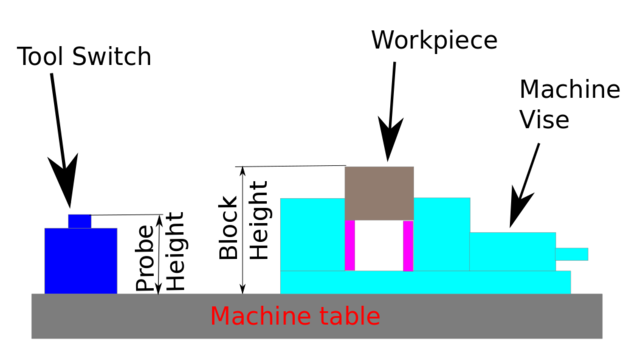

PROBE HT
The height of the tool sensor from the machine table surface. This value is used to calculate the Z zero height for the current work coordinate system when using the probe with a tool setter sensor.
BLOCK HT
The height of the top of the workpiece from the machine table surface. This value is used to calculate the Z zero height for the current work coordinate system when using the probe with a tool setter sensor.
XY CLEARANCE
The distance that the probe will move away from an edge or corner before performing a search. It should be large enough to ensure that the probe will not contact the workpiece or any other fixtures before moving down. It should be small enough to avoid excessive waiting for movement while searching.
Z CLEARANCE
The distance that the probe will move down before performing a search. If measuring an inside hole, the probe could be manually jogged to the starting Z height and then set Z CLEARANCE to 0.
There are three toggle buttons:
Auto Zero
This selects if after probing the relevant axis is set to zero in the current user system.
Auto Skew
This selects if after probing, the system will be rotated or just display the calculated rotation.
Tool Measure
This (if integrated) turns auto tool probing on and off.

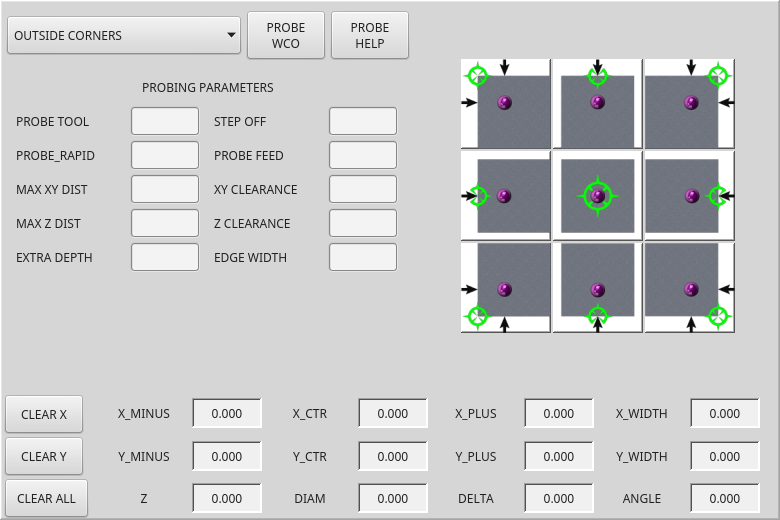

12.2. Basic probe
QtDragon Probe
Figure 5. QtDragon - Basic Probe Option
Basic probe is used to semi-automatically probe work pieces to find edges, centers and angles. The combo box allows selecting the basic type of probing buttons shown:
  • Outside Corners
  • Inside Corners
  • Edge Angles
  • Boss and Pockets
  • Ridge and Valleys
  • Calibration
Probe Tool
Will only allow probing if this tool number is in the spindle
Probe Diameter
The size of the probe tip
Probe Rapid
The speed of rapid moves in machine units
Probe Search
The speed of the first rough search in machine units
Probe Feed
The speed of the second fine search in machine units
Step Off
Back off and re-probe distance
Max XY Distance
The maximum distance the probe will search for in X and Y before failing with error
Max Z Distance
The maximum distance the probe will search for in Z before failing with error
XY Clearance
Clearance distance from probe to wall edge before rapid traversing down in Z and rough probing
Z Clearance
Clearance distance from probed to top of material
Extra Depth
Distance from top of material to desired probe depth
There are also hint parameters depending on selected probing type:
Edge Width
Desired distance from the probe start position, along wall edge before starting to probe
Diameter Hint
Used by Round Boss or Round Pocket probing (start move: 1/2 diameter plus XY clearance)
X Hint
Used by Rectangular Boss/Pocket probing (start move: 1/2 X length plus XY clearance)
Y Hint
Used by Rectangular Boss/Pocket probing (start move: 1/2 Y length plus XY clearance)
After setting the parameters and hints:
  • Manually move the probe to the approximate position represented by the green target on the button.
  • Confirm the parameters are reasonable.
  • Press the desired probing button.
The probing routine will start immediately.
Note
Pressing the stop button or the keyboard escape key, will abort the probing.

  1. Zero the probe tool by measuring the tool setter with the spindle probe installed
  2. Touch off your workpiece in X and Y.
  3. Measure the height of your block from the base, where your tool switch is located, to the upper face of the block (including chuck etc.).
  4. In the Versa probe tab, enter the measured value for block height.

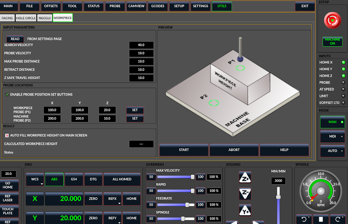

14.5. Work Piece Height Probing
QtDragon_hd height probing
Figure 8. QtDragon_hd - Work piece Height probing
This program probes 2 user specified locations in the Z axis and calculates the difference in heights.
Note
Enable Probe Position Set Buttons
  • When checked, the SET buttons are enabled.
  • This allows the user to automatically fill in the X, Y and Z parameters with the current position as displayed on the DROs.
Autofill Workpiece Height on Main Screen
  • When checked, the calculated height is automatically transferred to the Workpiece Height field in the main screen.
  • Otherwise, the main screen is not affected.
Workpiece Probe At
  • the X, Y and Z coordinates specify where the first probing routine should start, in current WCS
Machine Probe At
  • the X, Y and Z coordinates specify where the second probing routine should start, in current WCS
Z Safe Travel Height
  • The machine is raised to the Z safe travel height before jogging to the X and Y coordinates.
  • The spindle then lowers to the specified Z coordinate.
  • It should be selected so that the tool clears all obstructions while jogging.
START button
  • The machine will jog to the first location and then probe down.
  • The machine then jogs to the second location and probes down again.
  • The difference in probed values is reported as Calculated Workpiece Height.
  • The parameters for search velocity, probe velocity, maximum probe distance and return distance are read from the main GUI Settings page.
ABORT button
  • causes all jog and probe routines currently executing to stop.
HELP button
  • displays this help file.
  • Any 2 points within the machine operating volume can be specified.

Versaprobe offers 5 output pins for tool measurement purpose. The pins are used to be read from a remap G-code subroutine, so the code can react to different values.
qtversaprobe.enable (HAL_BIT)
Measurement enabled or not tool. Reflects screen button state.
qtversaprobe.blockheight (HAL_FLOAT)
The measured height of the top face of the workpiece. Reflects screen entry.
qtversaprobe.probeheight (HAL_FLOAT)
The toolsetter probe switch height. Reflects screen entry.
qtversaprobe.searchvel (HAL_FLOAT)
The velocity to search for the tool probe switch
qtversaprobe.probevel (HAL_FLOAT)
The velocity to probe tool length. Reflects screen entry.
qtversaprobe.backoffdist (HAL_FLOAT)
The distance the probe backs off after triggering. Reflects screen entry.

17.1. Main tab
This tab displays the graphical representation of the current program. The side buttons will control the display.
  • User View: Select/restore a user set view of the current program.
  • P,X,Y,Z: Set standard views.
  • D: Toggle display of dimensions.
  • +, -: Zoom controls.
  • C: Clear graphics of tool movement lines.
In qtdragon_hd there are also macro buttons available on the right side. Up to tens buttons can be defined in the INI.

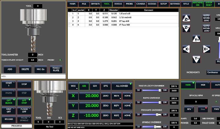

17.4. Tool Tab
You can monitor/modify tool offsets from this tab. Adding and deleting tools from the tool file can also be done from this tab. When this tab is selected the individual home buttons in the DRO area will change to tool offset setting buttons. They will return to home buttons when you select another tab. Pressing this tool button will drop down a when menu of options:
  • Set Current Tool Position
  • Adjust Current Tool Position
  • Zero Current Tool Position
  • Set Tool Offset Directly
  • Reset To Last

QtDragon customized
Figure 11. QtDragon - Customized QtDragon
