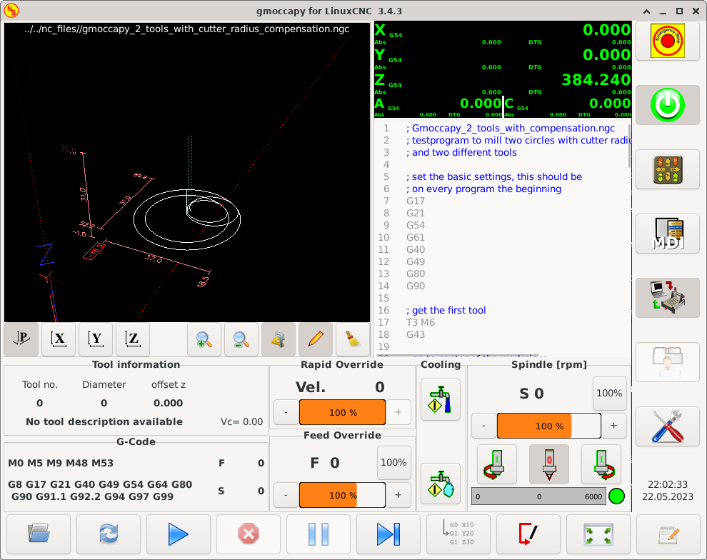

1. Introduction
GMOCCAPY is a GUI for LinuxCNC, designed to be used with a touch screen, but can also be used on normal screens with a mouse or hardware buttons and MPG wheels, as it presents HAL Pins for the most common needs. Please find more information in the following.
It offers the possibility to display up to 9 axes, support a lathe mode for normal and back tool lathe and can be adapted to nearly every need, because GMOCCAPY supports embedded tabs and side panels. As a good example for that see gmoccapy_plasma.
GMOCCAPY 3 does support up to 9 axes and 9 joints. As GMOCCAPY 3 has been changed in code to support the joint / axis changes in LinuxCNC it does not work on 2.7 or 2.6 branch!
It has support for integrated virtual keyboard (onboard or matchbox-keyboard), so there is no need for a hardware keyboard or mouse, but it can also be used with that hardware. GMOCCAPY offers a separate settings page to configure most settings of the GUI without editing files.
GMOCCAPY can be localized very easy, because the corresponding files are separated from the linuxcnc.po files, so there is no need to translate unneeded stuff. The files are placed in /src/po/gmoccapy. You could just copy the gmoccapy.pot file to something like it.po and translate that file with gtranslator or poedit. After rebuilding, you’d get the GUI in your preference language. To facilitate the sharing of the translation, GMOCCAPY is available on the Weblate web interface. GMOCCAPY is currently available in English, German, Spanish, Polish, Serbian and Hungarian. Feel free to help me to introduce more languages, be it locally or via the web. If you need help, don’t hesitate to contact me on nieson@web.de.

You will get a similar screen to the following (the design may vary depending on your config):

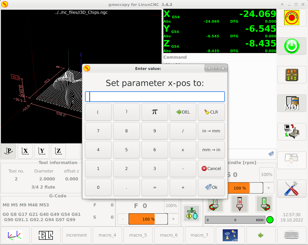

GMOCCAPY will also accept macros asking for parameters like:
[MACRO]
MACRO = go_to_position X-pos Y-pos Z-pos
The parameters must be separated by spaces. This example calls a file go_to_position.ngc with the following content:
; Test file "go to position"
; will jog the machine to a given position
O<go_to_position> sub
G17
G21
G54
G61
G40
G49
G80
G90
;#1 = <X-Pos>
;#2 = <Y-Pos>
;#3 = <Z-Pos>
(DBG, Will now move machine to X = #1 , Y = #2 , Z = #3)
G0 X #1 Y #2 Z #3
O<go_to_position> endsub
M2
After pushing the execute macro button, you will be asked to enter the values for X-pos Y-pos Z-pos and the macro will only run if all values have been given.
Note
If you would like to use a macro without any movement, see also the notes in known problems.
Macro example using the "go to position"-macro

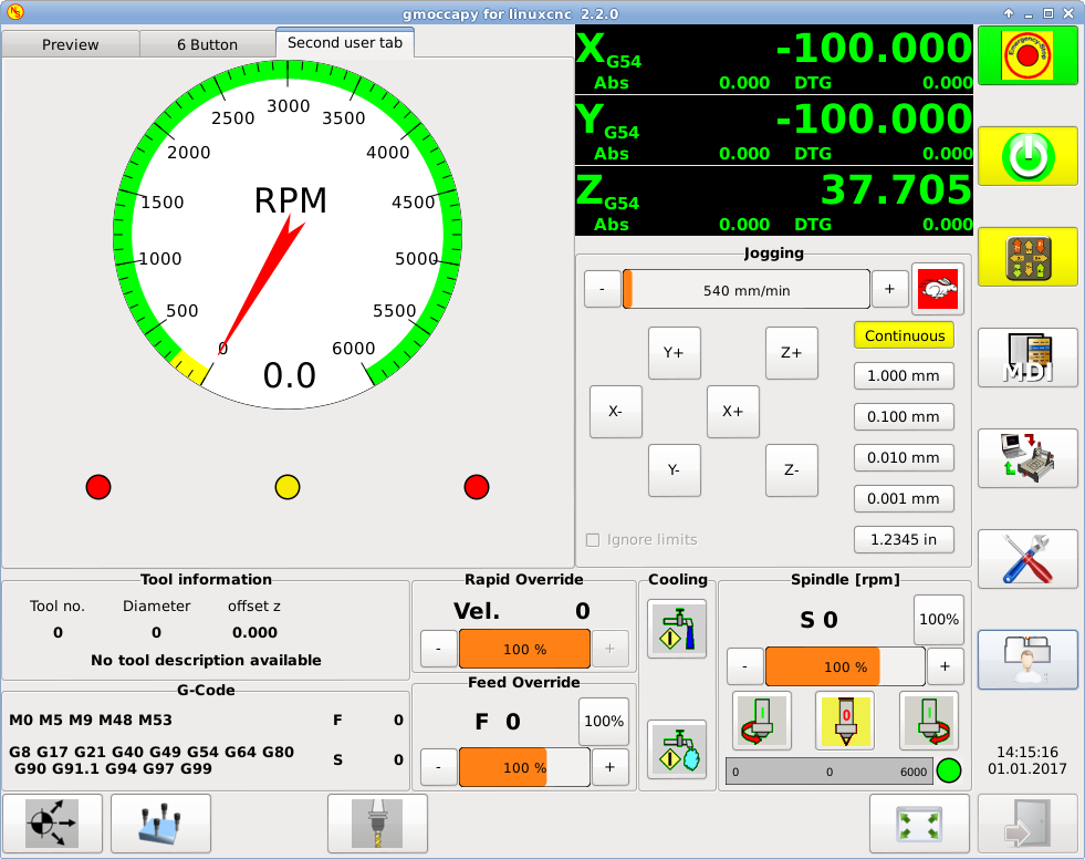

You can add embedded programs to GMOCCAPY like you can do in AXIS, Touchy and Gscreen. All is done by GMOCCAPY automatically if you include a few lines in your INI file in the DISPLAY section.
If you have never used a Glade panel, I recommend to read the excellent documentation on Glade VCP.
Embedded Tab Example
EMBED_TAB_NAME = DRO
EMBED_TAB_LOCATION = ntb_user_tabs
EMBED_TAB_COMMAND = gladevcp -x {XID} dro.glade
EMBED_TAB_NAME = Second user tab
EMBED_TAB_COMMAND = gladevcp -x {XID} vcp_box.glade
All you have to take care of, is that you include for every tab or side panel the mentioned three lines:
  • EMBED_TAB_NAME = Represents the name of the tab or side panel, it is up to you what name you use, but it must be present!
  • EMBED_TAB_LOCATION = The place where your program will be placed in the GUI, see figure Embedded tab locations. Valid values are:
    • ntb_user_tabs (as main tab, covering the complete screen)
    • ntb_preview (as tab on the preview side (1))
    • hbox_jog (will hide the jog buttons and introduce your glade file here (2))
    • box_left (on the left, complete high of the screen)
    • box_right (on the right, in between the normal screen and the button list)
    • box_tool_and_code_info (will hide the Tool information and G-code frames and introduce your glade file here (3))
    • box_tool_info (will hide the Tool information frame and introduce your glade file here)
    • box_code_info (will hide the G-code information frame and introduce your glade file here)
    • box_vel_info (will hide the velocity frames and introduce your glade file (4))
    • box_coolant_and_spindle (will hide the coolant and spindle frames and introduce your glade file here (5)+(6))
    • box_cooling (will hide the cooling frame and introduce your glade file (5))
    • box_spindle (will hide the spindle frame and introduce your glade file (6))
    • box_custom_1 (will introduce your glade file left of vel_frame)
    • box_custom_2 (will introduce your glade file left of cooling_frame)
    • box_custom_3 (will introduce your glade file left of spindle_frame)
    • box_custom_4 (will introduce your glade file right of spindle_frame)
    • box_dro_side (will introduce your glade file right of the DRO)
Note
See also the included sample INI files to see the differences.
  • EMBED_TAB_COMMAND = The command to execute, i.e.
    includes a custom glade file called dro.glade in the mentioned location. The file must be placed in the config folder of your machine.
    gladevcp h_buttonlist.glade
    will just open a new user window called h_buttonlist.glade note the difference. This one is stand alone, and can be moved around independent from GMOCCAPY window.
    gladevcp -c gladevcp -u hitcounter.py -H manual-example.hal manual-example.ui
    will add a the panel manual-example.ui, include a custom Python handler, hitcounter.py and make all connections after realizing the panel according to manual-example.hal.
    hide
    will hide the chosen box.
images/gmoccapy_embedded_tabs.png
Figure 1. Embedded tab locations

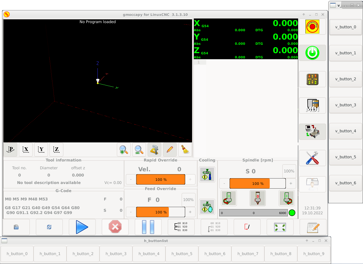

5.1. Right and Bottom Button Lists
The screen has two main button lists, one on the right side an one on the bottom. The right handed buttons will not change during operation, but the bottom button list will change very often. The buttons are count from up to down and from left to right beginning with 0.
Note
The pin names have changed in GMOCCAPY 2 to order them in a better way.
The pins for the right (vertical) buttons are:
  • gmoccapy.v-button.button-0 (bit IN)
  • gmoccapy.v-button.button-1 (bit IN)
  • gmoccapy.v-button.button-2 (bit IN)
  • gmoccapy.v-button.button-3 (bit IN)
  • gmoccapy.v-button.button-4 (bit IN)
  • gmoccapy.v-button.button-5 (bit IN)
  • gmoccapy.v-button.button-6 (bit IN)
For the bottom (horizontal) buttons they are:
  • gmoccapy.h-button.button-0 (bit IN)
  • gmoccapy.h-button.button-1 (bit IN)
  • gmoccapy.h-button.button-2 (bit IN)
  • gmoccapy.h-button.button-3 (bit IN)
  • gmoccapy.h-button.button-4 (bit IN)
  • gmoccapy.h-button.button-5 (bit IN)
  • gmoccapy.h-button.button-6 (bit IN)
  • gmoccapy.h-button.button-7 (bit IN)
  • gmoccapy.h-button.button-8 (bit IN)
  • gmoccapy.h-button.button-9 (bit IN)
As the buttons in the bottom list will change according to the mode and other influences, the hardware buttons will activate the displayed functions. So you don’t have to take care about switching functions around in HAL, because that is done completely by GMOCCAPY!
For a three axes XYZ machine the HAL pins will react as shown in the following three tables:
Table 1. Functional assignment of horizontal buttons (1)
Pin Manual Mode MDI Mode Auto Mode
open homing button
macro_0 or nothing
open file
open touch off stuff
macro_1 or nothing
reload program
macro_2 or nothing
run
open tool dialogs
macro_3 or nothing
stop
macro_4 or nothing
pause
macro_5 or nothing
step by step
macro_6 or nothing
run from line if enabled in settings, otherwise Nothing
macro_7 or nothing
optional blocks
full-size preview
macro_8 or switch page to additional macros
full-size preview
exit if machine is off, otherwise no reaction
open keyboard or abort if macro is running
edit code
Table 2. Functional assignment of horizontal buttons (2)
Pin Settings Mode Homing Mode Touch off Mode
delete MDI history
edit offsets
home all
touch X
touch Y
home x
touch Z
open classic ladder
home y
open HAL scope
home z
open HAL status
zero G92
open HAL meter
open HAL calibration
unhome all
set selected
open HAL show
back
back
Table 3. Functional assignment of horizontal buttons (3)
Pin Tool Mode Edit Mode Select File
delete tool(s)
go to home directory
new tool
reload file
one directory level up
reload tool table
save
apply changes
save as
move selection left
change tool by number T? M6
move selection right
set tool by number without change M61 Q?
jump to directory as set in settings
change tool to the selected one
new file
select / ENTER
touch of tool in Z
show keyboard
back
back
back
So we have 67 reactions with only 10 HAL pins!
These pins are made available to be able to use the screen without a touch panel, or protect it from excessive use by placing hardware buttons around the panel. They are available in a sample configuration like shown in the image below.
Sample configuration "gmoccapy_sim_hardware_button" showing the side buttons
images/gmoccapy_sim_hardware_button_mid.png

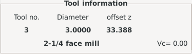

Tool Offset Pins
These pins allow you to show the active tool offset values for X and Z in the tool information frame. You should know that they are only active after G43 has been sent.
Tool information
Figure 3. Tool information area
  • gmoccapy.tooloffset-x (float IN)
  • gmoccapy.tooloffset-z (float IN)
Note
The tooloffset-x line is not needed on a mill, and will not be displayed on a mill with trivial kinematics.
To display the current offsets, the pins have to be connected like this in the postgui HAL file:
net tooloffset-x gmoccapy.tooloffset-x <= motion.tooloffset.x
net tooloffset-z gmoccapy.tooloffset-z <= motion.tooloffset.z

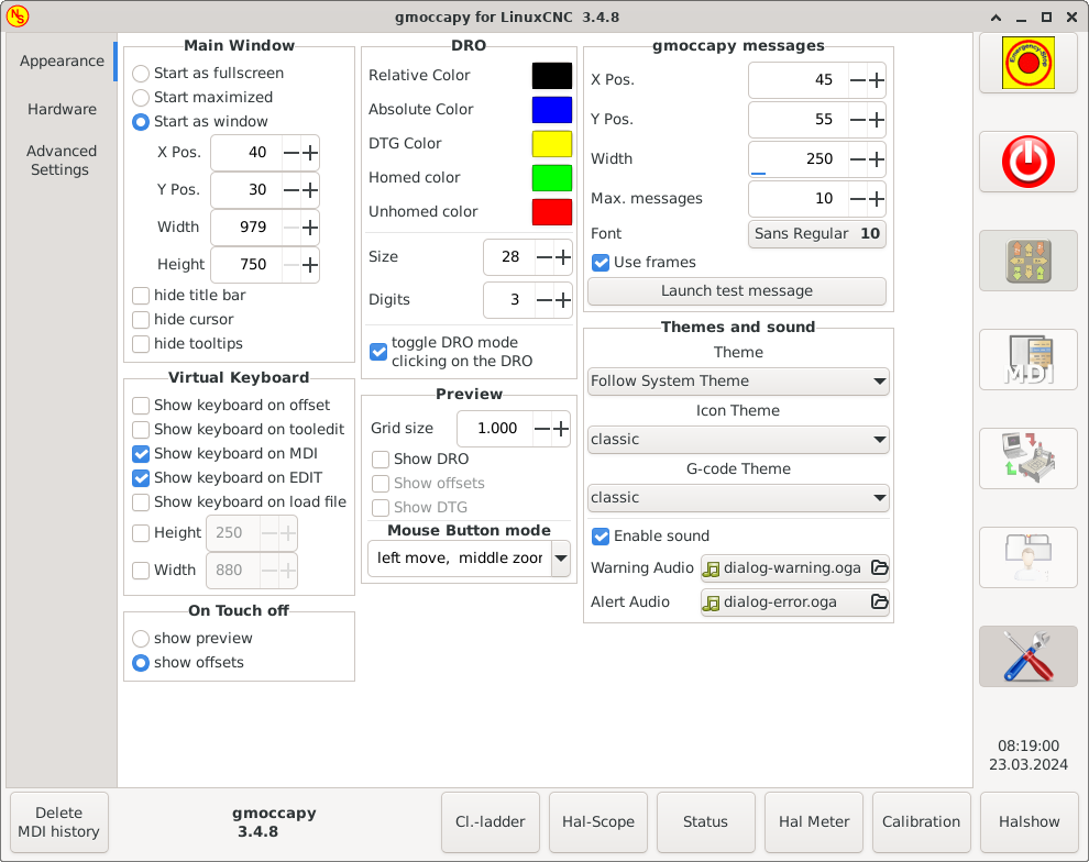

7. The Settings Page
To enter the page you will have to click on images/gmoccapy_settings_button.png and give an unlock code, which is 123 by default. If you want to change it at this time you will have to edit the hidden preference file, see the display section for details.
The page is separated in three main tabs:
7.1. Appearance
Configuration page
Figure 5. GMOCCAPY settings page Appearance
On this tab you will find the following options:
Main Window
Here you can select how you wish the GUI to start. The main reason for this was the wish to get an easy way for the user to set the starting options without the need to touch code. You have three options:
  • Start as full screen
  • Start maximized
  • Start as window - If you select start as window the spinboxes to set the position and size will get active. One time set, the GUI will start every time on the place and with the size selected. Nevertheless the user can change the size and position using the mouse, but that will not have any influence on the settings.
  • Window decorated - Allows the title bar to be hidden. (default: title bar visible)
  • hide cursor - Does allow to hide the cursor, what is very useful if you use a touch screen.
  • hide tooltips - Hides the tool tips.

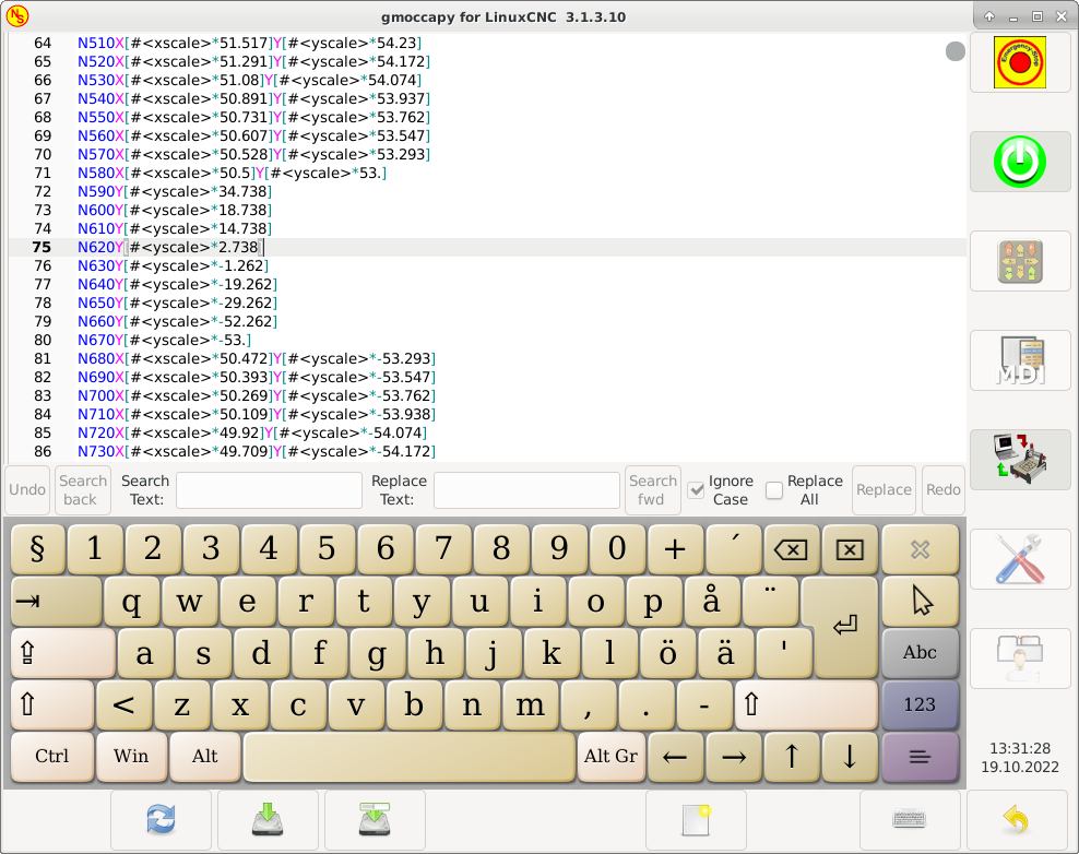

Keyboard
The checkboxes allow the user to select if he wants the on board keyboard to be shown immediately, when entering the MDI Mode, when entering the offset page, the tooledit widget or when open a program in the EDIT mode. The keyboard button on the bottom button list will not be affected by these settings, so you are able to show or hide the keyboard by pressing the button. The default behavior will be set by the checkboxes.
Default are :
Note
If this section is not sensitive, you have not installed a virtual keyboard, supported ones are onboard and matchbox-keyboard.
  • Show keyboard on offset
  • Show keyboard on tooledit
  • Show keyboard on MDI
  • Show keyboard on EDIT
  • Show keyboard on load file
If the keyboard layout is not correct, i.e. clicking Y gives Z, than the layout has not been set properly, related to your locale settings. For onboard it can be solved with a small batch file with the following content:
#!/bin/bash
setxkbmap -model pc105 -layout de -variant basic
The letters "de" are for German, you will have to set them according to your locale settings. Just execute this file before starting LinuxCNC, it can be done also adding a starter to your local folder.
./config/autostart
So that the layout is set automatically on starting.
For matchbox-keyboard you will have to make your own layout, for a German layout ask in the forum.

Preview
  • Grid Size - Sets the grid size of the preview window. Unfortunately the size has to be set in inches, even if your machine units are metric. We do hope to fix that in a future release.
Note
The grid will not be shown in perspective view.
  • Show DRO - Will show the a DRO also in the preview pane, it will be always shown in fullsize preview.
  • Show DTG - Will show the DTG (direct distance to end point) in the preview pane if Show DRO is active. Otherwise only in full size preview.
  • Show Offsets - Will show the offsets in the preview pane when Show DRO is active. Otherwise only in full size preview.
  • Mouse Button Mode - This combobox allows you to select the button behavior of the mouse to rotate, move or zoom within the preview:
    • left rotate, middle move, right zoom
    • left zoom, middle move, right rotate
    • left move, middle rotate, right zoom
    • left zoom, middle rotate, right move
    • left move, middle zoom, right rotate
    • left rotate, middle zoom, right move
      Default is left move, middle zoom, right rotate.
The mouse wheel will still zoom the preview in every mode.
Tip
If you select an element in the preview, the selected element will be taken as rotation center point and in auto mode the corresponding code line will be highlighted.
File to load on start up
Select the file you want to be loaded on start up. If a file is loaded, it can be set by pressing the current button. To avoid that any program is loaded at start up, just press the None button.
The file selection screen will use the filters you have set in the INI file, if there aren’t any filters given, you will only see NGC files. The path will be set according to the INI settings in [DISPLAY] PROGRAM_PREFIX.
Jump to dir
You can set here the directory to jump to if you press the corresponding button in the file selection dialog.
Themes and Sounds
This lets the user select what desktop theme to apply and what error and messages sounds should be played. By default "Follow System Theme" is set.
It further allows to change the icon theme. Currently there are three themes available:
  • classic
  • material
  • material light
To create custom icon themes, see section Icon Theme for details.

7.3. Advanced Settings
Advanced settings
Tool Measurement
Please check Auto Tool Measurement
Note
If this part is not sensitive, you do not have a valid INI file configuration to use tool measurement.
  • Use auto tool measurement - If checked, after each tool change, a tool measurement will be done, the result will be stored in the tool table and a G43 will be executed after the change.
    Probe Information
    The following information is taken from your INI file and must be given in absolute coordinates.
    • X Pos. - The X position of the tool switch.
    • Y Pos. - The Y position of the tool switch.
    • Z Pos. - The Z position of the tool switch, we will go as rapid move to this coordinate.
    • Max. Probe The distance to search for contact, an error will be launched, if no contact is given in this range. The distance has to be given in relative coordinates, beginning the move from Z Pos., so you have to give a negative value to go down!
    • Probe Height - The height of your probe switch, you can measure it. Just touch off the base where the probe switch is located and set that to zero. Then make a tool change and watch the tool_offset_z value, that is the height you must enter here.
    Probe velocities
    • Search Vel. - The velocity to search for the tool switch. After contact the tool will go up again and then goes towards the probe again with probe vel, so you will get better results.
    • Probe Vel. - The velocity for the second movement to the switch. It should be slower to get better touch results. In simulation mode, this is commented out in macros/change.ngc, otherwise the user would have to click twice on the probe button.
Reload Tool
  • Reload Tool on Start - Loads the last tool on start after homing.
Run From Line Option
You can allow or disallow the run from line. This will set the corresponding button insensitive (grayed out), so the user will not be able to use this option. The default is disable run from line.
Warning
It is not recommend to use run from line, as LinuxCNC will not take care of any previous lines in the code before the starting line. So errors or crashes are fairly likely.
Message Behavior And Appearance
This will display small pop up windows displaying a message or error text, similar to the ones known from AXIS. You can delete a specific message by clicking on its close button. If you want to delete the last one, just hit the WINDOWS key on your keyboard, or delete all messages at once with Control + Space.
You are able to set some options:
  • X Pos - The position of the top left corner of the message in X counted in pixel from the top left corner of the screen.
  • Y Pos - The position of the top left corner of the message in Y counted in pixel from the top left corner of the screen.
  • Width - The width of the message box.
  • Max Messages - The maximum number of messages you want to see at once. If you set this to 10, the 11th message will delete the first one, so you will only see the last 10.
  • Font - The font and size you want to use to display the messages.
  • Use frames - If you activate the checkbox, each message will be displayed in a frame, so it is much easier to distinguish the messages. But you will need a little bit more space.
  • Launch test message-button - It will show a message, so you can see the changes of your settings without the need to generate an error.
