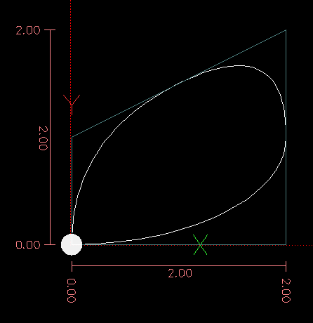

7. G5 Cubic Spline
G5 X- Y- <I- J-> P- Q-
  • I - X incremental offset from start point to first control point
  • J - Y incremental offset from start point to first control point
  • P - X incremental offset from end point to second control point
  • Q - Y incremental offset from end point to second control point
G5 creates a cubic B-spline in the XY plane with the X and Y axes only. P and Q must both be specified for every G5 command.
For the first G5 command in a series of G5 commands, I and J must both be specified. For subsequent G5 commands, either both I and J must be specified, or neither. If I and J are unspecified, the starting direction of this cubic will automatically match the ending direction of the previous cubic (as if I and J are the negation of the previous P and Q).
For example, to program a curvy N shape:
G5 Sample initial cubic spline
G90 G17
G0 X0 Y0
G5 I0 J3 P0 Q-3 X1 Y1
A second curvy N that attaches smoothly to this one can now be made without specifying I and J:
G5 Sample subsequent cubic spline
G5 P0 Q-3 X2 Y2
It is an error if:
  • P and Q are not both specified.
  • Just one of I or J are specified.
  • I or J are unspecified in the first of a series of G5 commands.
  • An axis other than X or Y is specified.
  • The active plane is not G17.
