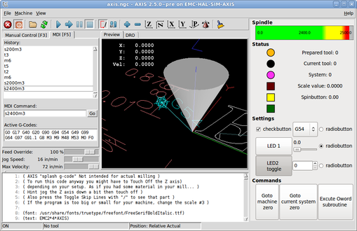

Run the sample GladeVCP panel integrated into Axis like PyVCP as follows:
$ cd configs/sim/axis/gladevcp
$ linuxcnc gladevcp_panel.ini

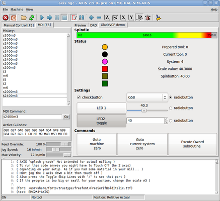

Run the same panel, but as a tab inside Axis:
$ linuxcnc gladevcp_tab.ini
images/example-tabbed-small.png

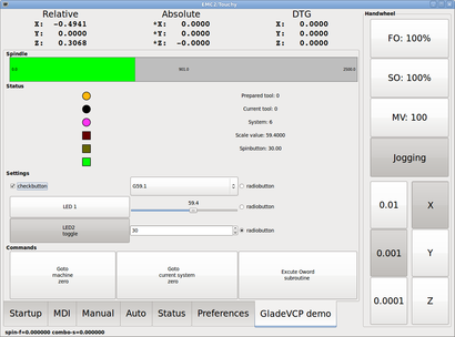

To run this panel inside Touchy:
$ cd configs/sim/touchy/gladevcp
$ linuxcnc gladevcp_touchy.ini
images/touchy-tab-33.png
Functionally these setups are identical - they only differ in screen real estate requirements and visibility. Since it is possible to run several GladeVCP components in parallel (with different HAL component names), mixed setups are possible as well - for instance a panel on the right hand side, and one or more tabs for less-frequently used parts of the interface.

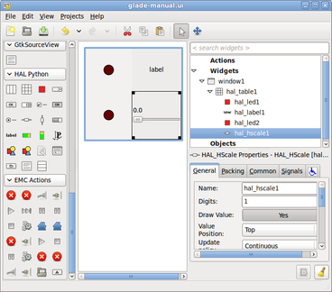

3.2. Running Glade to create a new user interface
This section just outlines the initial LinuxCNC-specific steps. For more information and a tutorial on glade, see http://glade.gnome.org. Some glade tips & tricks may also be found on youtube.
Either modify an existing UI component by running glade <file>.ui or start a new one by just running the glade command from the shell.
  • If LinuxCNC was not installed from a package, the LinuxCNC shell environment needs to be set up with . <linuxcncdir>/scripts/rip-environment, otherwise glade won’t find the LinuxCNC-specific widgets.
  • When asked for unsaved Preferences, just accept the defaults and hit Close.
  • From Toplevel (left pane), pick Window (first icon) as top level window, which by default will be named window1. Do not change this name - GladeVCP relies on it.
  • In the left tab, scroll down and expand HAL Python and VCP Actions.
  • add a container like a HAL_Box or a HAL_Table from HAL Python to the frame
  • pick and place some elements like LED, button, etc. within a container
This will look like so:
images/glade-manual-small.png
Glade tends to write a lot of messages to the shell window, which mostly can be ignored. Select File→Save as, give it a name like myui.ui and make sure it’s saved as GtkBuilder file (radio button left bottom corner in Save dialog). GladeVCP will also process the older libglade format correctly but there is no point in using it. The convention for GtkBuilder file extension is .ui.

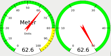

6.16. Meter
HAL Meter is a widget similar to PyVCP meter - it represents a float value and has one input FLOAT hal pin. HAL Meter has the following properties:
min, max
Minimum and maximum value of desired range. It is not an error condition if the current value is outside this range.
force_size
Forced diameter of widget. If not set then size will be deduced from packing or from fixed widget size and meter will fill all available space with respect to aspect ratio.
text_template
Like in Label sets text format for current value. Can be used to turn off value display.
label
Large label above center of meter.
sublabel
Small label below center of meter.
bg_color
Background color of meter.
z0_color, z1_color, z2_color
Colors of different value zones. Defaults are green, yellow and red. For description of zones see z*_border properties.
z0_border, z1_border
Define up bounds of color zones. By default only one zone is enabled. If you want more then one zone set z0_border and z1_border to desired values so zone 0 will fill from min to first border, zone 1 will fill from first to second border and zone 2 — from last border to max. Borders are set as values in range min-max.
Example HAL Meters: images/hal_meter.png

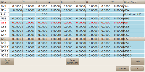

6.19. HAL_Offset
The HAL_Offset widget is used to display the offset of a single axis. It has the following properties:
Joint Number
Used to select which axis (technically which joint) is displayed. On a trivialkins machine (mill, lathe, router) axis vrs joint number are:
    0:X  1:Y  2:Z  3:A  4:B  5:C  6:U  7:V  8:W
Text template for metric units::
    You can use python formatting to display the position with different precision.
Text template for imperial units::
Reference Type::
    0:G5x 1:tool 2:G92 3:Rotation around Z

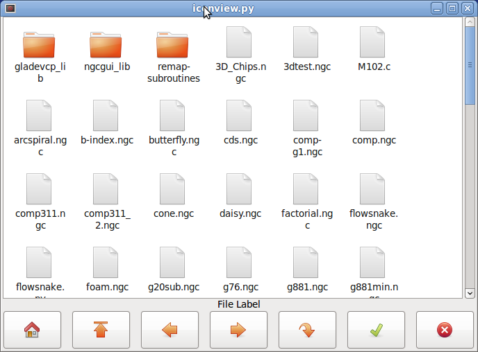

6.22. IconView (File Select)
This is touch screen friendly widget to select a file and to change directories.
The widget has the following properties:
icon_size
Sets the size of the displayed icon.
Allowed values are integers in the range from 12 to 96
default is 48
start_dir
Sets the directory to start in when the widget is shown first time,
must be a string, containing a valid directory path,
default is "/"
jump_to_dir
Sets the directory "jump to" directory, witch is selected by the corresponding button in the bottom button list, the 5th button counting from the left,
default is "~"
filetypes
Sets the file filter for the objects to be shown
Must be a string containing a comma separated list of extensions to be shown
Default is "ngc,py"
sortorder
Sets the sorting order of the displayed icon must be an integer value from 0 to 3, where
0 = ASCENDING (sorted according to file names)
1 = DESCENDING (sorted according to file names)
2 = FOLDERFIRST (show the folders first, then the files)
3 = FILEFIRST (show the files first, then the folders),
Default = 2 = FOLDERFIRST
Direct program control
Using goobject to set the above listed properties:
[widget name].set_property(property,Value)
There are python methods to control the widget:
[widget name].show_buttonbox(state)
    if False the bottom button box will be hidden, this is helpful in custom screens,
    with special buttons layouts to not alter the layout of the GUI, good example
    for that is gmoccapy
    state = boolean (True or False)
    Default is True
[widget name].show_filelabel(state)
    if True the file label (between the IconView window and the bottom button box will be shown.
    Hiding this label may save place, but showing it is very useful for debugging reasons,
    Default is True
[widget name].set_icon_size(iconsize)
    sets the icon size
    must be an integer in the range from 12 to 96
    Default = 48
[widget name].set_directory(directory)
    Allows to set an directory to be shown
    directory = string (a valid file path)
[widget name].set_filetypes(filetypes)
    sets the file filter to be used, only files with the given extensions will be shown
    filetypes = string containing a comma separated list of extensions
    Default = "ngc,py"
[widget name].get_selected()
    Returns the path of the selected file, or None if an directory has been selected
[widget name].refresh_filelist()
    Refreshes the filelist, needed if you add a file without changing the directory
If the button box has been hidden, you can reach the functions of this button through it’s clicked signals like so:
[widget name].btn_home.emit("clicked")
[widget name].btn_jump_to.emit("clicked")
[widget name].btn_sel_prev.emit("clicked")
[widget name].btn_sel_next.emit("clicked")
[widget name].btn_get_selected.emit("clicked")
[widget name].btn_dir_up.emit("clicked")
[widget name].btn_exit.emit("clicked")
The widget will emit the following signals:
selected
    This signal is emitted, when the user selects an icon, it will return a string containing a
    file path if a file has been selected, or None if an directory has been selected
sensitive
    This signal is emitted, when the buttons change there state from sensitive to not sensitive or vice versa.
    This signal is usefull to mantain surrounding GUI synconized with the button of the widget. See gmoccapy as example.
    It will return the buttonname and the new state. Buttonname is one of "btn_home", "btn_dir_up", "btn_sel_prev",
    "btn_sel_next", "btn_jump_to" or "btn_select". State is a boolean and will be True or False.
exit
    This signal is Emmit, when the exit button has been pressed to close the IconView
    mostly needed if the application is started as stand alone.
Example:
images/iconview.png

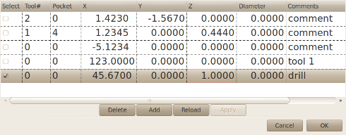

6.24. Tooleditor widget
This is a tooleditor widget for displaying and modifying a tool editor file.
It checks the current file once a second to see if linuxcnc updated it.
Hidden Columns
This will hide the given columns: The columns are designated (in order) as such:
s,t,p,x,y,z,a,b,c,u,v,w,d,i,j,q,;
You can hide any number of columns including the select and comments
There a couple ways to directly control the widget using Python.
using goobject to set the above listed properties:
    [widget name].set_properties('hide_columns','uvwijq')
        This would hide the uvwij and q columns and show all others.
There are python methods:
    [widget name].set_visible("ijq",False)
        Would hide ij and Q columns and leave the rest as they were.
    [widget name].set_filename(path_to_file)
        Sets and loads the tool file.
    [widget name].reload(None)
        Reloads the current toolfile
images/gtk-tooledit.png
6.25. Offsetpage
The Offsetpage widget is used to display/edit the offsets of all the axes.
It has convience buttons for zeroing G92 and Rotation-Around-Z offsets.
It will only allow you to select the edit mode when the machine is on and idle.
You can directly edit the offsets in the table at this time. Unselect the edit
button to allow the OffsetPage to reflect changes.
Hidden Columns
A no-space list of columns to hide: The columns are designated (in order) as such:
xyzabcuvwt
You can hide any of the columns.
Hidden Rows
A no-space list of rows to hide: the rows are designated (in order) as such
0123456789abc
You can hide any of the rows.
Pango Font
Sets text font type and size
HighLight color
when editing this is the high light color
Active color
when OffsetPage detects an active user coordinate system it will use this
color for the text
[widget name].set_property("highlight_color",gtk.gdk.Color('blue'))
[widget name].set_property("foreground_color",gtk.gdk.Color('black'))
[widget name].set_property("hide_columns","xyzabcuvwt")
[widget name].set_property("hide_rows","123456789abc")
[widget name].set_property("font","sans 25")
[widget name].set_filename("../../../configs/sim/gscreen/gscreen_custom/sim.var")
[widget name].set_col_visible("Yabuvw",False)
[widget name].set_row_visible("456789abc",False)
[widget name].set_to_mm()
[widget name].set_to_inch()
[widget name].hide_button_box(True)
[widget name].set_font("sans 20")
[widget name].set_highlight_color("violet")
[widget name].set_foreground_color("yellow")
[widget name].mark_active("G55")
    Allows you to directly set a row to highlight.
    (eg in case you wish to use your own navigation controls.
    See <<cha:gmoccapy,Gmoccapy Chapter>>
[widget name].selection_mask = ("Tool","Rot","G5x")
    These rows are NOT selectable in edit mode.
[widget name].set_names([['G54','Default'],["G55","Vice1"],['Rot','Rotational']])
    This allows you to set the text of the 'T' column of each/any row.
    This is a list of a list of offset-name/user-name pairs.
    The default text is the same as the offset name.
[widget name].get_names()
    This returns a list of a list of row-keyword/user-name pairs.
    The user name column is editable, so saving this list is user friendly.
    see set_names above.
images/offsetpage.png

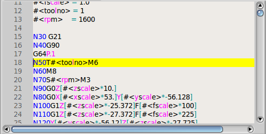

6.26. HAL_sourceview widget
This is for displaying and simple editing of Gcode.
It looks for .ngc highlight specs in ~/share/gtksourceview-2.0/language-specs/ The current running line will be highlighted.
With external python glue code:
*It can search for text, undo and redo changes.
*It can be used for program line selection.
[widget name].redo()
    redo one level of changes.
[widget name].undo()
    undo one level of changes
[widget name].text_search(direction=True,mixed_case=True,text='G92')
    Searches forward (direction = True) or back, +
    Searches with mixed case (mixed_case = True) or exact match
[widget name].set_line_number(linenumber)
    Sets the line to high light. Uses the sourceview line numbers.
[widget name].get_line_number()
    returns the currenly high lighted line.
[widget name].line_up()
    Moves the High lighted line up one line
[widget name].line_down()
    Moves the High lighted line down one line
[widget name].load_file('filename')
    loads a file. Using None (not a filename string) will reload the same program.
[widget name].get_filename()

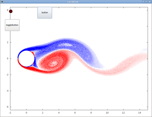

6.28. Animated function diagrams: HAL widgets in a bitmap
For some applications it might be desirable to have background image - like a functional diagram - and position widgets at appropriate places in that diagram. A good combination is setting a bitmap background image, like from a .png file, making the gladevcp window fixed-size, and use the glade Fixed widget to position widgets on this image.
The code for the below example can be found in configs/apps/gladevcp/animated-backdrop:
images/small-screenshot.png

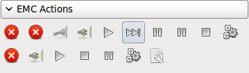

GladeVcp includes a collection of "canned actions" called VCP Action Widgets for the Glade user interface editor. Other than HAL widgets, which interact with HAL pins, VCP Actions interact with LinuxCNC and the G-code interpreter.
VCP Action Widgets are derived from the Gtk.Action widget. The Action widget in a nutshell:
  • it is an object available in Glade
  • it has no visual appearance by itself
  • it’s purpose: associate a visible, sensitive UI component like menu, toolbutton, button with a command. See these widget’s General→Related Action property.
  • the "canned action" will be executed when the associated UI component is triggered (button press, menu click..)
  • it provides an easy way to execute commands without resorting to Python programming.
The appearance of VCP Actions in Glade is roughly as follows:
images/vcp-actions.png

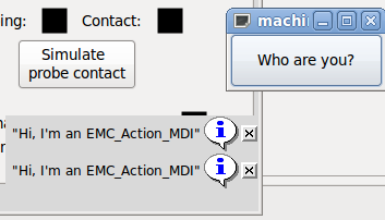

7.4. A simple example: Execute MDI command on button press
configs/apps/gladevcp/mdi-command-example/whoareyou.ui is a Glade UI file which conveys the basics:
Open it in Glade and study how it’s done. Start Axis, and then start this from a terminal window with gladevcp whoareyou.ui. See the hal_action_mdi1 Action and it’s MDI command property - this just executes (MSG, "Hi, I’m an VCP_Action_MDI") so there should be a message popup in Axis like so:
images/whoareyou.png
You’ll notice that the button associated with the Action_MDI action is grayed out if the machine is off, in E-Stop or the interpreter is running. It will automatically become active when the machine is turned on and out of E-Stop, and the program is idle.

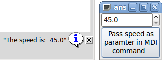

Optionally, MDI command strings may have parameters substituted before they are passed to the interpreter. Parameters currently may be names of HAL pins in the GladeVCP component. This is how it works:
  • assume you have a HAL SpinBox named speed, and you want to pass it’s current value as a parameter in an MDI command.
  • The HAL SpinBox will have a float-type HAL pin named speed-f (see HalWidgets description).
  • To substitute this value in the MDI command, insert the HAL pin name enclosed like so: ${pin-name}
  • for the above HAL SpinBox, we could use (MSG, "The speed is: ${speed-f}") just to show what’s happening.
The example UI file is configs/apps/gladevcp/mdi-command-example/speed.ui. Here’s what you get when running it:
images/speed.png

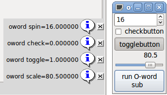

7.6. An advanced example: Feeding parameters to an O-word subroutine
It’s perfectly OK to call an O-word subroutine in an MDI command, and pass HAL pin values as actual parameters. An example UI file is in configs/apps/gladevcp/mdi-command-example/owordsub.ui.
Place nc_files/gladevcp_lib/oword.ngc so Axis can find it, and run gladevcp owordsub.ui from a terminal window. This looks like so:
