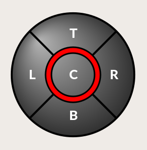

1.8. HALPad - HAL Buttons Joypad
QtVCP HALPad: HAL Buttons Joypad
Figure 4. QtVCP HALPad: HAL Buttons Joypad
This widget looks and acts like a 5 buttons D-pad, with an LED ring.
Each button has an selectable type (Bit, S32 or Float) output HAL pin.
The LED center ring has selectable colors for off and on and is controlled by a bit HAL pin.
HALPad ENUMS
There are enumerated constants used:
  • To reference indicator positions:
    • NONE
    • LEFT
    • RIGHT
    • CENTER
    • TOP
    • BOTTOM
    • LEFTRIGHT
    • TOPBOTTOM
  • For HAL pins type:
    • NONE
    • BIT
    • S32
    • FLOAT
You use the widget name in Qt Designer plus the reference constant:
self.w.halpadname.set_highlight(self.w.halpadname.LEFTRIGHT)
HALPad Properties
pin_name
Optional name to use for the HAL pins basename. If left blank, the Qt Designer widget name will be used.
pin_type
Select the HAL output pin type. This property is only used at startup. Selection can be set in Qt Designer:
  • NONE
  • BIT
  • S32
  • FLOAT
left_image_path
right_image_path
center_image_path
top_image_path
bottom_image_path
File or resource path to an image to display in the described button location.
If the reset button is pressed in the Qt Designer editor property, the image will not be displayed (allowing optional text).
left_text
right_text
center_text
top_text
bottom_text
A text string to be displayed in the described button location.
If left blank an image can be designated to be displayed.
true_color
false_color
Color selection for the center LED ring to be displayed when the <BASENAME>.light.center HAL pin is True or False.
text_color
Color selection for the button text.
text_font
Font selection for the button text.
HALPad Styles
The above properties could be set in styles sheets.
HALPad{
    qproperty-on_color: #000;
    qproperty-off_color: #444;

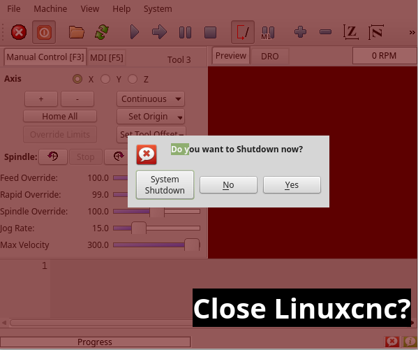

1.10. focusOverlay - Focus Overlay Widget
This widget places a colored overlay over the screen, usually while a dialog is showing.
QtVCP focus overlay
Figure 5. Focus overlay example for confirm close prompt
Used to create a focused feel and to draw attention to critical information.
It can also show a translucent image.
It can also display message text and buttons.
This widget can be controlled with STATUS messages.

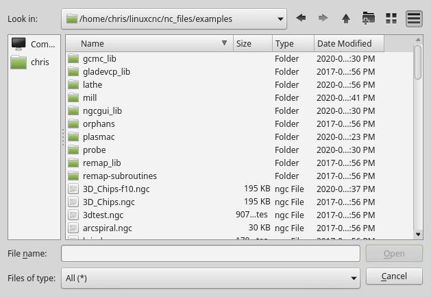

load dialog
Requires a dialog widget present.

exit screen
Closes down LinuxCNC

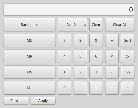

2.4. AxisToolButton - Select and Set Axis Widget
This allows one to select and set an axis.
If the button is set checkable, it will indicate which axis is selected.
If you press and hold the button a pop up menu will show allowing one to:
  • Zero the axis
  • Divide the axis by 2
  • Set the axis arbitrarily
  • Reset the axis to the last number recorded
You must have selected an entry dialog that corresponds to the dialog_code_string, usually this is selected from the screenOptions widget.
You can select the property halpin_option, it will then set a HAL pin true when the axis is selected. The property joint_number should be set to the appropriate joint number. The property axis_letter should be set to the appropriate axis letter.
The property dialog_code_string can be changed to ENTRY or CALCULATOR to call a typing only entry dialog or a touch/typing calculator type entry dialog.
It is based on PyQt’s QToolButton.

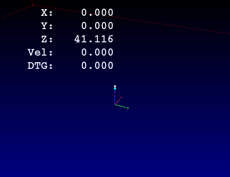

2.9. GCodeGraphics - G-code Graphic Backplot Widget
QtVCP GcodeGraphics: G-code Graphic Backplot Widget
Figure 6. QtVCP GcodeGraphics: G-code Graphic Backplot Widget
This displays the current G-code in a graphical form.
Stylesheets Properties
dro-font/dro-large-font (string)
Sets the small and large DRO font properties
Here we reference with the widget base name; GCodeGraphics
GCodeGraphics{
    qproperty-dro_font:"monospace  bold 12";
GCodeGraphics{
    qproperty-dro_large_font:"Times 25";
_view (string)
Sets the default view orientation on GUI load.
Valid choices for a lathe are p, y, y2. For other screens, valid choices are p, x, y, z, z2.
The following shows an example of how to set this property (referenced using the widget user selected name):
#gcodegraphics{
    qproperty-_view: z;
_dro (bool)
Determines whether or not to show the DRO.
The following shows an example of how to set this property:
#gcodegraphics{
    qproperty-_dro: False;
_dtg (bool)
Determine whether or not to show the Distance To Go.
#gcodegraphics{
    qproperty-_dtg: False;
_metric (bool)
Determines whether or not to show the units in metric by default.
#gcodegraphics{
    qproperty-_metric: False;
_overlay (bool)
Determines whether or not to show the overlay by default.
#gcodegraphics{
    qproperty-_overlay: False;
_offsets (bool)
Determines whether or not to show the offsets by default.
#gcodegraphics{
    qproperty-_offsets: False;

calculatorDialog_option
Sets up the calculator entry dialog.
calculator_overlay_color
Color of transparent layer shown when the calculator dialog is shown.

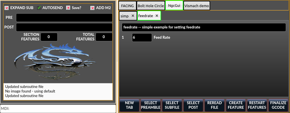

2.20. MacroTab - Special Macros Widget
QtVCP MacroTab: Special Macros Widget
Figure 8. QtVCP MacroTab: Special Macros Widget
This widget allows a user to select and adjust special macro programs for doing small jobs.
It uses images for visual representation of the macro and for an icon.
It searches for special macros using the INI definition:
[RS274NGC]
SUBROUTINE_PATH =
The macros are O-word subroutines with special comments to work with the launcher. The first three lines must have the keywords below, the fourth is optional.
Here is a sample for the first four lines in an O-word file:
; MACROCOMMAND = Entry1,Entry2
; MACRODEFAULTS = 0,true
; MACROIMAGE = my_image.svg,Icon layer number,Macro layer number
; MACROOPTIONS = load:yes,save:yes,default:default.txt,path:~/macros
MACROCOMMAND
This is the first line in the O-word file.
It is a comma separated list of text to display above an entry.
There will be one for every variable required in the O-word function.
If the macro does not require variables, leave it empty:
; MACROCOMMAND=
MACRODEFAULTS
This must be the second line in the O-word file.
It is a comma separated list of the default values for each variable in the O-word function.
If you use the word true or false in the list, a *checkbutton* will be shown.
MACROIMAGE
This must be the third line in the O-word file.
  • SVG Images
    If using SVG image files, they must end with the .svg extension.
    The images must be added to SVG layers which are used to define the different images for macro and icon.
    Value is comma separated list of three ordered fields:
    ; MACROIMAGE=filename.svg,macro_layer_name[,icon_layer_name]
    With:
    _filename_.svg
    SVG image file name as first field.
    It is assumed to be in the same folder as the O-word file.
    *macro_layer_name
    Macro image layer name as second field.
    icon_layer_name
    Icon image layer name as optional third field. If the third entry is missing, the same image will be used for macro and icon.
  • PNG/JPG Images:
    Value remains a comma separated list:
    ; MACROIMAGE=macro_image.(png|jpg)[,icon_image.(png|jpg)]
    With:
    _macro_image_.(png|jpg)
    Macro image file name as first field.
    It is assumed that the image file are in the same folder than the macro.
    _icon_image_.(png|jpg)
    Icon image file name as optional second field.
    If the second entry is missing the same image will be used for macro and image.
If the keyword is present but the entries are missing, no images will be used.
MACROOPTIONS
This optional line must be the fourth line in the O-word file.
It is a comma separated list of keyword and data:
LOAD:yes
Shows a load button.
SAVE:yes
Shows a save button.

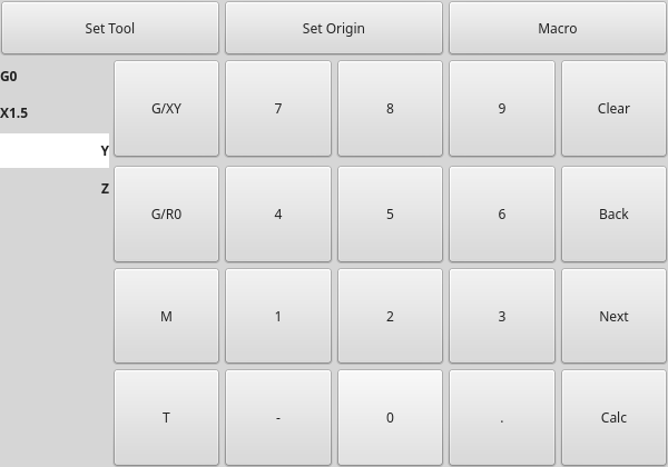

2.23. MDITouchy - Touch Screen MDI Entry Widget
QtVCP MDITouchy: Touch Screen MDI Entry Widget
Figure 9. QtVCP MDITouchy: Touch Screen MDI Entry Widget
This widget displays buttons and entry lines to use for entering MDI commands.
Based on LinuxCNC’s Touchy screen’s MDI entry process, its large buttons are most useful for touch screens.
To use MDITouchy:
  • First press one of the G/XY, G/RO, M or T button. On the left will show the entry fields that can be filled out.
  • Then press Next and Back to navigate between fields.
  • Calc will pop up a calculator dialog.
  • Clear clears the current entry.
  • Set Tool will call for a tool change.
  • Set Origin will allow setting the origin of the current G6x system.
  • Macro will call any available macro ngc programs.
The widget requires an explicit call to MDITouchy Python code to actually run the MDI command:
  • For handler file code
    If the widget was named mditouchy in Qt Designer, the command below would run the displayed MDI command:
    self.w.mditouchy.run_command()
  • For action button use
    If the widget was named mditouchy in Qt Designer, use the action button’s Call Python commands option and enter:
    INSTANCE.mditouchy.run_command()
The macro button cycles though macros defined in the INI [DISPLAY] heading.
Add one or more MACRO lines of the following format:
MACRO = macro_name [param1] [... paramN]
In the example below, increment is the name of the macro, and it accepts two parameters, named xinc and yinc.
MACRO = incerment xinc yinc
Now, place the macro in a file named macro_name.ngc in the PROGRAM_PREFIX directory, or into any directory in the SUBROUTINE_PATH specified in the INI file.
Keeping on with the example above, it would be named increment.ngc and its content could look like:
O<increment> sub
G91 G0 X#1 Y#2
G90
O<increment> endsub
Notice the name of the sub matches the file name and macro name exactly, including case.
When you invoke the macro by pressing the Macro button you can enter values for parameters (xinc and yinc in our example).
These are passed to the macro as positional parameters: #1, #2#N respectively.
Parameters you leave empty are passed as value 0.
If there are several different macros, press the Macro button repeatedly to cycle through them.
In this simple example, if you enter -1 for xinc and invoke the running of the MDI cycle, a rapid G0 move will be invoked, moving one unit to the left.
This macro capability is useful for edge/hole probing and other setup tasks, as well as perhaps hole milling or other simple operations that can be done from the panel without requiring specially-written G-code programs.

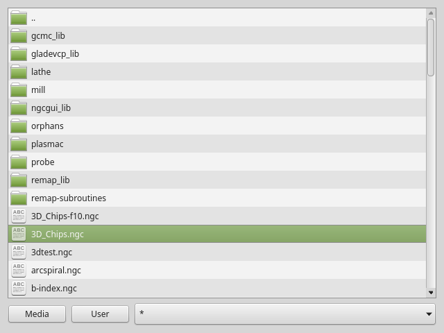

2.29. FileManager - File Loading Selector Widget
QtVCP FileManager: File Loading Selector Widget
Figure 11. QtVCP FileManager: File Loading Selector Widget
This widget is used to select files to load.
It has a the ability to scroll the names with hardware such as a MPG.
One can class patch the function load(self,fname) to customize file loading.
The function getCurrentSelected() will return a Python tuple, containing the file path and whether it is a file.
temp = FILEMANAGER.getCurrentSelected()
print('filepath={}'.format(temp[0]))
if temp[1]:
    print('Is a file')
doubleClickSelection (bool)
Determines whether or not to require double clicking on a folder.
Single clicking a folder (False) is enabled by default and is intended for touch screen users.
#filemanager {
    qproperty-doubleClickSelection: True;
showListView (bool)
Determines whether or not to show the file/folder structure in list form.
Table view (False) is enabled by default.
#filemanager {
    qproperty-showListView: True;
It is based on PyQt’s FIXME

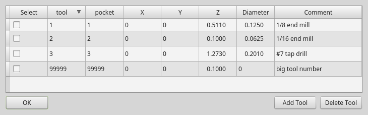

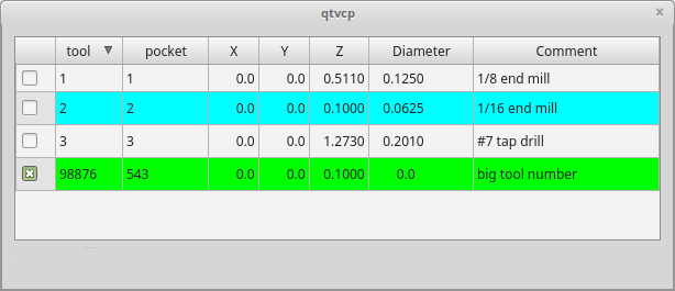

2.31. ToolOffsetView - Tools Offsets View And Edit Widget
QtVCP ToolOffsetView: Tools Offsets View And Edit Widget
Figure 12. QtVCP ToolOffsetView: Tools Offsets View And Edit Widget
This widget displays and allows one to modify tools offsets.
It will update LinuxCNC’s tool table for changes made or found.
The tool settings can only be changed in LinuxCNC after homing and when the motion controller is idle.
The display and entry will change between metric and imperial based on LinuxCNC’s current G20/G21 setting.
The current in-use tool will be highlighted, and the current selected tool will be highlighted in a different color.
The checkbox beside each tool can be used to select too for an action that depends on extra code added either to a combined widget, like the toolOffsetView dialog or the screens handler code.
Typical actions are load selected tool, delete selected tools, etc.
Clicking on the columns and rows allows one to adjust the settings.
A dialog can be made to popup for data or text entry.
The comments section will typically be displayed in the manual tool change dialog.
If using a lathe configuration, there can be columns for X and Z wear.
To use these columns to adjust the tool wear, it requires a remapped tool change routine.
It is based on PyQt’s QTableView, QAbstractTableModel, and ItemEditorFactory.
Properties, functions and styles of the PyQt base objects are always available.
Properties
ToolOffsetView has properties that can be set in Qt Designer, in Python handler code or (if appropriate) in stylesheets:
dialog_code_string
Sets which dialog will pop up with numerical entry.
test_dialog_code_string
Sets which dialog will pop up with text entry.
metric_template
Metric numerical data format.
imperial_template
Imperial numerical data format.
styleCodeHighlight
Current tool-in-use highlight color.
styleCodeSelected
Selected highlight color.
In a handler file:
self.w.tooloffsetview.setProperty('dialog_code','CALCULATOR')
self.w.tooloffsetview.setProperty('metric_template','%10.3f')
and in style sheets:
ToolOffsetView{
  qproperty-styleColorHighlist: lightblue;
  qproperty-styleColorSelected: #444;
Functions
ToolOffsetView has some functions useful for screen builders to add actions:
add_tool()
Adds a blank dummy tool (99) that the user can edit to suit.
delete_tools()
Deletes the currently checkbox selected tools.
get_checked_list()
Returns a list of tools selected by checkboxs.
set_all_unchecked()
Uncheck all selected tools.
Example for handler file executing aforementioned functions.
self.w.tooloffsetview.add_tool()
self.w.tooloffsetview.delete_tools()
toolList = self.w.tooloffsetview.get_checked_list()
self.w.tooloffsetview.set_all_unchecked()

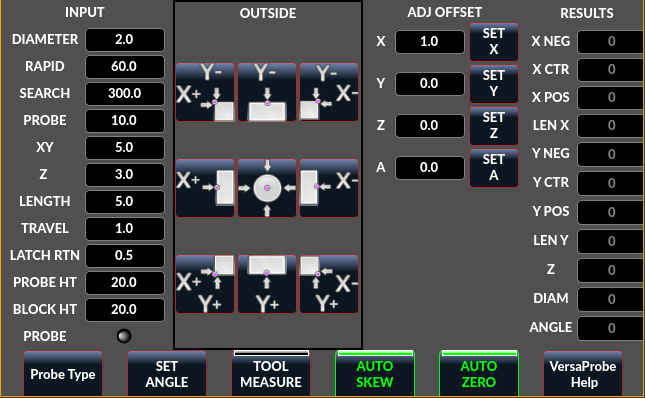

2.33. VersaProbe - Mill Probing Widget
QtVCP VersaProbe: Mill Probing Widget
Figure 14. QtVCP VersaProbe: Mill Probing Widget
Widget for probing on a mill. Used by the QtDragon screen.

3.1. LcncDialog - General Message Dialog Widget
This is a general message dialog widget.
If there is a Focus Overlay widget present, it can signal it to display.
If the sound library is set up it can play sounds.
There are options that can be set when requesting a dialog, these would be added to the message dict.
TITLE
Title of the dialog window.
MESSAGE
Title message text in bold.
MORE
Standard text under the heading.
DETAILS
Initial hidden text.
TYPE (OK|YESNO|OKCANCEL)
ICON (QUESTION|INFO|CRITICAL|WARNING)
PINNAME
Not implemented yet.
FOCUSTEXT (overlay text|None)
Text to display if focus overlay is used. Use None for no text.
FOCUSCOLOR (QColor(_R, G, B, A_))
Color to use if focus overlay is used.
PLAYALERT
Sound to play if sound is available, i.e., SPEAK <spoken_message> .
When using STATUS 's request-dialog function, the default launch name is MESSAGE.
It is based on PyQt’s QMessagebox.

3.3. FileDialog - Load and Save File Chooser Dialog Widget
QtVCP FileDialog: Load and Save File Chooser Widget
Figure 16. QtVCP FileDialog: Load and Save File Chooser Widget
This is used to load G-code files.
If there is a Focus Overlay widget present, it will signal it to display.
When using STATUS 's request-dialog function, the default launch names are LOAD or SAVE.
There are options that can be set when requesting a dialog, these would be added to the message dict:
EXTENSIONS
FILENAME
DIRECTORY
An example Python call, for a load dialog:
mess = {'NAME':'LOAD','ID':'_MY_DIALOG_',
            'TITLE':'Load Some text File',
            'FILENAME':'~/linuxcnc/nc_files/someprogram.txt',
            'EXTENSIONS':'Text Files (*.txt);;ALL Files (*.*)'
ACTION.CALL_DIALOG(mess)
And for a save dialog
mess = {'NAME':'SAVE','ID':'_MY_DIALOG_',
            'TITLE':'Save Some text File',

3.5. ToolOffsetDialog - Tool Offset Setting Dialog Widget
QtVCP `ToolOffsetDialog`: Tool Offset Setting Dialog Widget
Figure 18. QtVCP ToolOffsetDialog: Tool Offset Setting Dialog Widget
This widget allows one to modify Tool offsets directly in a dialog form.
If there is an Focus Overlay widget present, it will signal it to display.
When using STATUS 's request-dialog function, the default launch name is TOOLOFFSET.
It is based on PyQt’s QDialog.

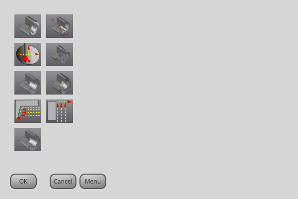

3.6. MacroTabDialog - Macro Launch Dialog Widget
This is a dialog to display the macrotab widget.
MacroTab displays a choice of macro programs to run using icons.
When using ``STATUS``'s request-dialog function, the default launch name is MACROTAB.

3.9. CalculatorDialog - Calculator Dialog Widget
QtVCP CalculatorDialog: Calculator Dialog Widget
Figure 19. QtVCP CalculatorDialog: Calculator Dialog Widget
This is a dialog to display a calculator for numeric entry, such as origin offset.
It returns the entry via STATUS messages using a Python DICT.
The DICT contains at minimum, the name of the dialog requested and an ID code.
When using ``STATUS``'s request-dialog function, the default launch name is CALCULATOR.

3.11. VersaProbeDialog - Part Touch Probing Dialog Widget
QtVCP VersaProbeDialog: Part Touch Probing Dialog Widget
Figure 21. QtVCP VersaProbeDialog: Part Touch Probing Dialog Widget
This is a dialog to display a part probing screen based on Verser Probe v2.

4.2. JoyPad - 5 button D-pad Widget
It is the base class for the HALPad widget.
This widget looks and acts like a 5 button D-pad, with a LED like indicators in a ring.
You can put text or icons in each of the button positions.
You can connect to output signals when the buttons are pressed.
There are also input slots to change the color of the indicator(s).
ENUMS
There are enumerated constants used to reference indicator positions.
They are used in Qt Designer editor’s property editor or in Python code.
NONE
LEFT, L
RIGHT, R
CENTER, C
TOP, T
BOTTOM, B
LEFTRIGHT, X
TOPBOTTOM, A
For Python handler code, you use the widget name in Qt Designer plus the reference constant:
self.w.joypadname.set_highlight(self.w.joypadname.LEFT)
Useful Override-able Functions
def _pressedOutput(self, btncode):
    self.joy_btn_pressed.emit(btncode)
    self[''.format(btncode.lower())].emit(True)
def _releasedOutput(self, btncode):
    self.joy_btn_released.emit(btncode)
    self['joy_{}_pressed'.format(btncode.lower())].emit(False)
As coded these function issue (emit) PyQt5 signals (joy_btn_pressed and joy<letter>_pressed) for the any button pressed or released_.
Signal joy_btn_pressed outputs a string code for the button.
Signal joy_<letter>_pressed outputs a bool value.
You could override the functions to do something else if making a custom widget:
Callable Functions
reset_highlight()
Clears the highlight indicator.
set_highlight(_button_, state=_True_)
Set the highlight indicator in position button to state state.
You can use strings letters (LRCTBXA) or position ENUMS for the button argument.
set_button_icon(_button_, _pixmap_)
Sets the button’s icon pixmap.
set_button_text(_button_, _text_)
Sets the button’s icon text.
set_tooltip(_button_, _text_)
Sets the buttons pop-up tooltip descriptive text.
setLight(_state_)
Sets the highlight indicator to the True color or False color.
The set_highlight() function must be used prior to set the indicator to use.
Signals
These signals will be sent when buttons are pressed.
They can be connected to in Qt Designer editor or Python code.
The first two output a string that indicates the button pressed:
joy_btn_pressed (string)
joy_btn_released (string)
joy_l_pressed (bool)
joy_l_released (bool)
joy_r_pressed (bool)
joy_r_released (bool)
joy_c_pressed (bool)
joy_c_released (bool)
joy_t_pressed (bool)
joy_t_released (bool)
joy_b_pressed (bool)
joy_b_released (bool)
They are based on PyQt’s Signal (QtCore.pyqtSignal())
Slots
Slots can be connected to in Qt Designer editor or Python code:
set_colorStateTrue()
set_colorStateFalse()
set_colorState(_bool_)
set_true_color(_str_)
set_true_color(_qcolor_)
set_false_color(_str_)
set_false_color(_qcolor_)
Properties
These can be set in stylesheets or Python code:
highlightPosition
Set the indicator position.
setColorState
Select the color state of the indicator.
left_image_path
right_image_path
center_image_path
top_image_path
bottom_image_path
A file path or resource path to an image to display in the described button location.
If the reset button is pressed in Qt Designer editor property, the image will not be displayed (allowing optionally text).
left_text
right_text
center_text
top_text
bottom_text
true_color
false_color
Color selection for the center LED ring to be displayed, when the BASENAME.light.center HAL pin is True or False.
text_color
button_font
The above properties could be set in:
  • Stylesheets:
    You would usually use the Qt Designer widget name with # prefix to set individual widget properties, otherwise you would use the JoyPad class name to set all JoyPad widgets the same:
    #joypadname{
      qproperty-true_color: #000;
      qproperty-false_color: #444;
  • In Python handler code:
    self.w.joypadename.setProperty('true_color','green')

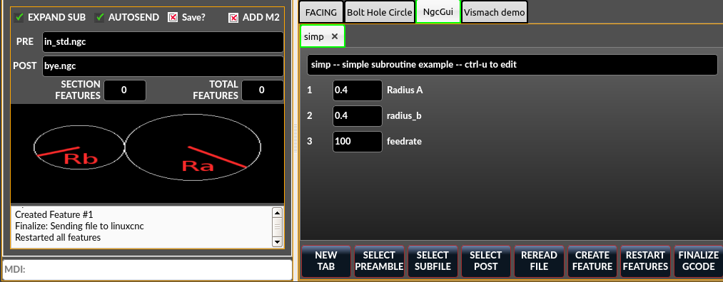

6.5. Qt NGCGUI
QtVCP NGCGUI: Shown from QtDragon
QtVCP’s version of NGC subroutine selector (Shown as used in QtDragon).
6.5.1. INI settings
LinuxCNC needs to know where to look to run the subroutines.
If the subroutine calls other subroutines or custom M codes, those paths must be added too.
[RS274NGC]
SUBROUTINE_PATH = ~/linuxcnc/nc_files/examples/ngcgui_lib:~/linuxcnc/nc_files/examples/ngcgui_lib/utilitysubs
QtVCP needs to know where to open subroutines from.
You can also specify subroutines to be pre-opened in tabs.
[DISPLAY]
# NGCGUI subroutine path.
# This path must also be in [RS274NGC] SUBROUTINE_PATH
NGCGUI_SUBFILE_PATH = ~/linuxcnc/nc_files/examples/ngcgui_lib
# pre selected programs tabs
# specify filenames only, files must be in the NGCGUI_SUBFILE_PATH
NGCGUI_SUBFILE = slot.ngc
NGCGUI_SUBFILE = qpocket.ngc
6.5.2. Buttons
  • NEW TAB - add new blank tab to NGCGUI
  • SELECT PREAMBLE - select a file that add preamble G-code
  • SELECT SUBFILE - select a NGCGUI subroutine file
  • SELECT POST - select a file that add post G-code
  • REREAD FILE - reload the subroutine file
  • CREATE FEATURE - add feature to the list
  • RESTART FEATURE - remove all features from the list
  • FINALIZE GCODE - create the full G-code and send it to LinuxCNC/a file
6.5.3. Adding Custom Subroutines
You can create your own subroutines for use with NGCGUI. They must follow these rules:
  • For creating a subroutine for use with NGCGUI, the filename and the subroutine name must be the same.
  • The subroutine must be in a folder within LinuxCNC’s INI designated search path.
  • On the first line there may be a comment of type info:
  • The subroutine must be surrounded by the sub and endsub tags.
  • The variables used must be numbered variables and must not skip number.
  • Comments and presets may be included.
  • If an image file of the same name is in the folder, it will be shown.
(info: feedrate -- simple example for setting feedrate)
o<feedrate> sub
    #<feedrate>       = #1 (= 6 Feed Rate) ; comments in brackets will be shown in ngcui
    f#<feedrate>
o<feedrate> endsub
QtVCP NGCGUI Custom Sub
