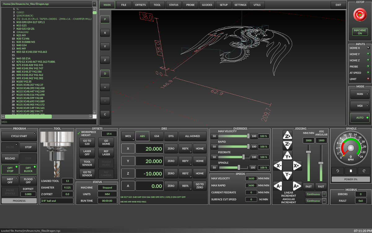

1.1. QtDragon
QtDragon Router
Figure 1. QtDragon - 3 or 4 axis sample (1440x860) in silver theme
QtDragon is resizable from a resolution of 1280x768 to 1680x1200. It will work in window mode on any monitor with higher resolution but not on monitors with lower resolution.
1.2. QtDragon_hd
QtDragon_hd
Figure 2. QtDragon_hd - 3 or 4 axis sample for larger monitors (1920x1056) in dark theme
QtDragon_hd is a similar design as QtDragon but modified to utilize the extra space of modern larger monitors. There are some small differences in layout and utility.
QtDragon_hd has a resolution of 1920x1056 and is not resizeable. It will work in window mode on any monitor with higher resolution but not on monitors with lower resolution.

19.2. Qt Designer and Python code
All aspects of the GUI are fully customization through Qt Designer and/or Python code. This capability is included with the QtVCP development environment. The extensive use of QtVCP widgets keeps the amount of required Python code to a minimum, allowing relatively easy modifications. The LinuxCNC website has extensive documentation on the installation and use of QtVCP libraries. See QtVCP for more information about QtVCP in general.
QtDragon can also utilize QtVCP’s rc file to do minor python code modifications without using a custom handler file.
[DISPLAY]
USER_COMMAND_FILE = CONFIGFOLDER/qtdragonrc.py
See Modifying Screens for more information about customization.
QtDragon customized
Figure 11. QtDragon - Customized QtDragon
