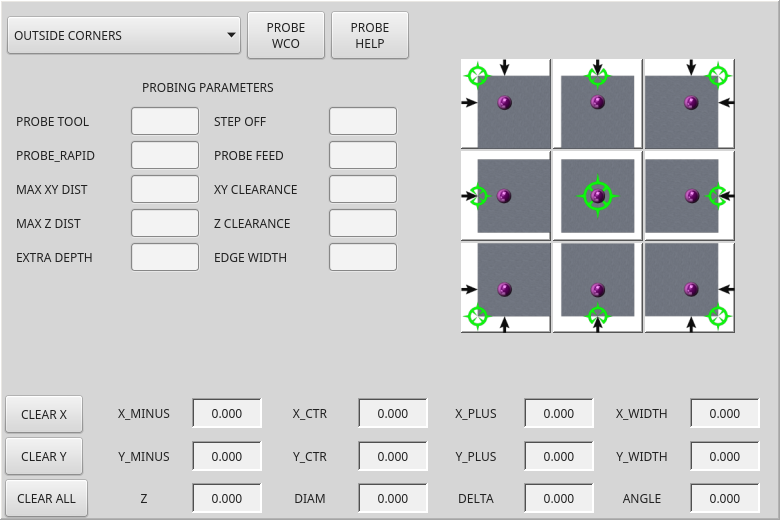

2.4. BasicProbe - Simple Mill Probing Widget
QtVCP BasicProbe: Simple Mill Probing Widget
Figur 6. QtVCP BasicProbe: Simple Mill Probing Widget
Widget for probing on a mill. Used by the QtDragon screen.

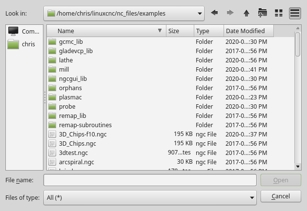

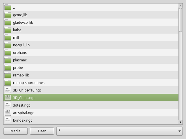

2.7. FileManager - File Loading Selector Widget
QtVCP FileManager: File Loading Selector Widget
Figur 7. QtVCP FileManager: File Loading Selector Widget
This widget is used to select files to load.
It has a the ability to scroll the names with hardware such as a MPG.
One can class patch the function load(self,fname) to customize file loading.
The function getCurrentSelected() will return a Python tuple, containing the file path and whether it is a file.
temp = FILEMANAGER.getCurrentSelected()
print('filepath={}'.format(temp[0]))
if temp[1]:
    print('Is a file')
Stylesheets Properties
doubleClickSelection (bool)
Determines whether or not to require double clicking on a folder.
Single clicking a folder (False) is enabled by default and is intended for touch screen users.
The following shows an example of how to set this property:
#filemanager {
    qproperty-doubleClickSelection: True;
showListView (bool)
Determines whether or not to show the file/folder structure in list form.
Table view (False) is enabled by default.
#filemanager {
    qproperty-showListView: True;
It is based on PyQt’s FIXME

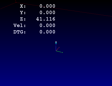

2.10. GCodeGraphics - G-code Graphic Backplot Widget
QtVCP GcodeGraphics: G-code Graphic Backplot Widget
Figur 8. QtVCP GcodeGraphics: G-code Graphic Backplot Widget
This displays the current G-code in a graphical form.
dro-font/dro-large-font (string)
Sets the small and large DRO font properties
Here we reference with the widget base name; GCodeGraphics
GCodeGraphics{
    qproperty-dro_font:"monospace  bold 12";
GCodeGraphics{
    qproperty-dro_large_font:"Times 25";
_view (string)
Sets the default view orientation on GUI load.
Valid choices for a lathe are p, y, y2. For other screens, valid choices are p, x, y, z, z2.
The following shows an example of how to set this property (referenced using the widget user selected name):
#gcodegraphics{
    qproperty-_view: z;
_dro (bool)
Determines whether or not to show the DRO.
#gcodegraphics{
    qproperty-_dro: False;
_dtg (bool)
Determine whether or not to show the Distance To Go.
#gcodegraphics{
    qproperty-_dtg: False;
_metric (bool)
Determines whether or not to show the units in metric by default.
#gcodegraphics{
    qproperty-_metric: False;
_overlay (bool)
Determines whether or not to show the overlay by default.
#gcodegraphics{
    qproperty-_overlay: False;
_offsets (bool)
Determines whether or not to show the offsets by default.
#gcodegraphics{
    qproperty-_offsets: False;
_small_origin (bool)
Determines whether or not to show the small origin by default.
#gcodegraphics{
    qproperty-_small_origin: False;
overlay_color (primary, secondary, or RGBA formatted color)
Sets the default overlay color.
#gcodegraphics{
    qproperty-overlay_color: blue;
overlay_alpha (float)
Sets the default overlay alpha value. This affects the opacity of the overlay when set between 0.0 and 1.0.
#gcodegraphics{
    qproperty-overlay_alpha: 0.15;
background_color (primary, secondary, or RGBA formatted color)
Sets the default background color.
#gcodegraphics{
    qproperty-background_color: blue;
+_use_gradient_background+ (bool)
Determines whether or not use a gradient background by default.
#gcodegraphics{
    qproperty-_use_gradient_background: False;
jog_color (primary, secondary, or RGBA formatted color)
Sets the default jog color.
#gcodegraphics{
    qproperty-jog_color: red;
Feed_color (primary, secondary, or RGBA formatted color)
Sets the default feed color.
#gcodegraphics{
    qproperty-Feed_color: green;
Rapid_color (primary, secondary, or RGBA formatted color)
Sets the default rapid color.
#gcodegraphics{
    qproperty-Rapid_color: rgba(0, 0, 255, .5);
InhibitControls (bool)
Determines whether or not to inhibit external controls by default.
#gcodegraphics{
    qproperty-InhibitControls:True;
MouseButtonMode (int)
Changes the mouse button behavior to rotate, move or zoom within the preview.
#gcodegraphics{
    qproperty-MouseButtonMode: 1;
There are 12 valid modes:
Mode
Move
Zoom
Rotate
0
Left
Middle
Right
1
Middle
Right
Left
2
Middle
Left
Right
3
Left
Right
Middle
4
Right
Left
Middle
5
Right
Middle
Left
Modes 6-11 are intended for machines that only require a 2D preview such as plasma or some lathes and have no rotate button assigned.
Mode
Move
Zoom
6
Left
Middle
7
Middle
Left
8
Right
Left
9
Left
Right
10
Middle
Right
11
Right
Middle
MouseWheelInvertZoom (bool)
Determines whether or not to invert the zoom direction when zooming with the mouse wheel.
#gcodegraphics{
    qproperty-MouseWheelInvertZoom:True;
ACTION functions
The ACTION library can control the G-code graphics widget.
ACTION.RELOAD_DISPLAY()
Reload the current program which recalculates the origin/offsets.
ACTION.SET_GRAPHICS_VIEW(_view_)
The following view commands can be sent:
  • clear
  • zoom-in
  • zoom-out
  • pan-up
  • pan-down
  • pan-right
  • pan-left
  • rotate-cw
  • rotate-ccw
  • rotate-up
  • rotate-down
  • overlay-dro-on
  • overlay-dro-off
  • overlay-offsets-on
  • overlay-offsets-off
  • alpha-mode-on
  • alpha-mode-off
  • inhibit-selection-on
  • inhibit-selection-off
  • dimensions-on
  • dimensions-off
  • grid-size
  • record-view
  • set-recorded-view
  • P
  • X
  • Y
  • Y2
  • Z
  • Z2
  • set-large-dro
  • set-small-dro
ACTION.ADJUST_PAN(_X,Y_)
Directly set the relative pan of view in x and y direction.
ACTION.ADJUST_ROTATE(_X,Y_)
Directly set the relative rotation of view in x and y direction.
It is based on PyQt’s OpenGL widget.

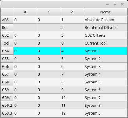

2.18. OriginOffsetView - Origins View and Setting Widget
QtVCP OriginOffsetsView: Origins View and Setting Widget
Figur 11. QtVCP OriginOffsetsView: Origins View and Setting Widget
This widget allows one to visualize and modify User System Origin offsets directly.
It will update LinuxCNC’s Parameter file for changes made or found.
The settings can only be changed in LinuxCNC after homing and when the motion controller is idle.
The display and entry will change between metric and imperial, based on LinuxCNC’s current G20 / G21 setting.
The current in-use user system will be highlighted.
Extra actions can be integrated to manipulate settings.
These actions depend on extra code added either to a combined widget, like originoffsetview dialog, or the screens handler code.
Typical actions might be Clear Current User offsets or Zero X.
Clicking on the columns and rows allows one to adjust the settings.
A dialog can be made to popup for data or text entry.
The comments section will be recorded in the preference file.
It is based on PyQt’s QTableView, QAbstractTableModel, and ItemEditorFactory.

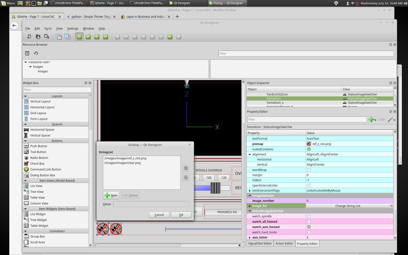

2.23. StatusImageSwitcher - Controller Status Image Switcher
Status image switcher will switch between images based on LinuxCNC states.
*watch_spindle
Toggles between 3 images: stop, fwd, revs.
*watch_axis_homed
Toggles between 2 images: axis not homed, axis homed.
*watch_all_homed
Would toggle between 2 images: not all homed, all homed.
*watch_hard_limits
Would toggle between 2 images or one per joint.
Here is an example of using it to display an icon of Z axis homing state:
QtVCP StatusImageSwitcher: Controller Status Image Switcher
Figur 12. QtVCP StatusImageSwitcher: Controller Status Image Switcher
In the properties section notice that:
  • watch_axis_homed is checked
  • axis_letter is set to Z
If you double click the image_list a dialog will show and allow you to add image paths to.
If you have one image as an icon and one clear image then that will look like it shows and hides the icon.
Selecting image paths can be done by selecting the pixmap property and selecting an image.
Not
The pixmap setting is for test display only and will be ignored outside of Qt Designer.
  • Right click the image name and you should see Copy path.
  • Click Copy path.
  • Now double click the image list property so the dialog shows.
  • Click the New button.
  • Paste the image path in the entry box.
Do that again for the next image.
Use a clear image to represent a hidden icon.
You can test the images display from the image list by changing the image number. In this case 0 is unhomed and 1 would be homed.
This is for test display only and will be ignored outside of Qt Designer.

2.31. StatusImageSwitcher - Controller Status Image Switching Widget
This widget will display images based on LinuxCNC status.
You can watch:
  • the state of the spindle,
  • the state of all homed,
  • the state of a certain axis homed,
  • the state of hard limits.

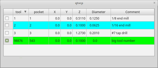

2.32. ToolOffsetView - Tools Offsets View And Edit Widget
QtVCP ToolOffsetView: Tools Offsets View And Edit Widget
Figur 13. QtVCP ToolOffsetView: Tools Offsets View And Edit Widget
This widget displays and allows one to modify tools offsets.
It will update LinuxCNC’s tool table for changes made or found.
The tool settings can only be changed in LinuxCNC after homing and when the motion controller is idle.
The display and entry will change between metric and imperial based on LinuxCNC’s current G20/G21 setting.
The current in-use tool will be highlighted, and the current selected tool will be highlighted in a different color.
The checkbox beside each tool can be used to select too for an action that depends on extra code added either to a combined widget, like the toolOffsetView dialog or the screens handler code.
Typical actions are load selected tool, delete selected tools, etc.
The comments section will typically be displayed in the manual tool change dialog.
If using a lathe configuration, there can be columns for X and Z wear.
To use these columns to adjust the tool wear, it requires a remapped tool change routine.

2.33. VersaProbe - Mill Probing Widget
QtVCP VersaProbe: Mill Probing Widget
Figur 14. QtVCP VersaProbe: Mill Probing Widget

3.3. FileDialog - Load and Save File Chooser Dialog Widget
QtVCP FileDialog: Load and Save File Chooser Widget
Figur 16. QtVCP FileDialog: Load and Save File Chooser Widget
This is used to load G-code files.
If there is a Focus Overlay widget present, it will signal it to display.
When using STATUS 's request-dialog function, the default launch names are LOAD or SAVE.
There are options that can be set when requesting a dialog, these would be added to the message dict:
EXTENSIONS
FILENAME
DIRECTORY
An example Python call, for a load dialog:
mess = {'NAME':'LOAD','ID':'_MY_DIALOG_',
            'TITLE':'Load Some text File',
            'FILENAME':'~/linuxcnc/nc_files/someprogram.txt',
            'EXTENSIONS':'Text Files (*.txt);;ALL Files (*.*)'
ACTION.CALL_DIALOG(mess)

This widget allows one to modify User System origin offsets directly in a dialog form.
If there is an Focus Overlay widget present, it will signal it to display.
When using STATUS 's request-dialog function, the default launch name is ORIGINOFFSET.
It is based on PyQt’s QDialog.

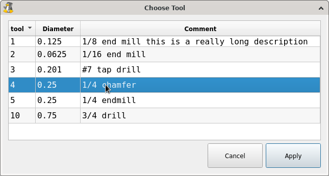

3.6. ToolChooserDialog - Tool Chooser Dialog Widget
QtVCP `ToolChooserDialog`: Tool Chooser Dialog Widget
Figur 19. QtVCP ToolChooserDialog: Tool Chooser Dialog Widget
This widget allows the operator to select one of the tools defined in the tool table. If a tool is selected and Apply is pressed or the tool is double-clicked, the dialog will return the tool number selected. This can be used in conjunction with the OperatorValueLine widget to create a tool change widget, for example.
When using STATUS 's request-dialog function, the default launch name is TOOLCHOOSER.

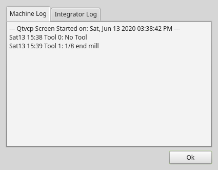

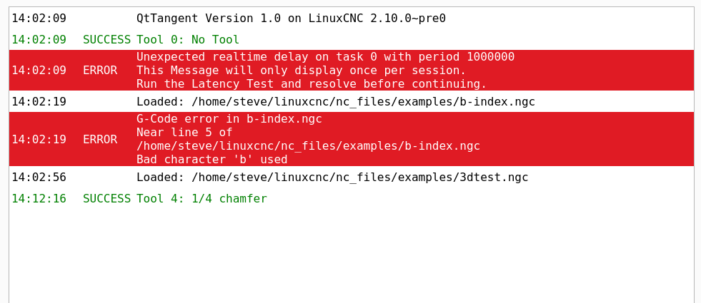

3.7. MachineLog - Machine Events Journal Display Widget
This widget displays various log event messages that have been output by the system during the current session. This includes informational messages as well as errors.
QtVCP `MachineLog`: Machine Log Widget
Figur 20. QtVCP MachineLog: Machine Events Log in machine_log (plain) mode
Figur 21. QtVCP MachineLog: Machine Events Log in machine_log_severity mode
Two distinct types of logs may be displayed:
  • machine log (plain text or severity highlighted)
  • integrator log (plain text only)
The type of log shown by the widget is controlled by the option properties of the widget. By selecting machine_log_option or integrator_log_option the appropriate log will be displayed. These options will display plain styled logs in a Qt QTextEdit widget.
Additionally, there is a machine_log_severity_option property that may be chosen that will display the machine log in a variety of colors depending on the severity of the message, by using a QTableWidget. The colors may be configured with the properties of the widget.
3.7.1. Emitting Log messages with Severity
Severity is conveyed via the option value sent along with the STATUS signal called update-machine-log. The option parameter is a comma-delimited list, containing typically
``` text = an error has occurred. STATUS.emit(update-machine-log, text, TIME,ERROR) ```
3.7.2. Clearing the Log
The log may be cleared by calling the clear() method of the widget.

3.13. VersaProbeDialog - Part Touch Probing Dialog Widget
QtVCP VersaProbeDialog: Part Touch Probing Dialog Widget
Figur 24. QtVCP VersaProbeDialog: Part Touch Probing Dialog Widget
This is a dialog to display a part probing screen based on Verser Probe v2.
3.14. MachineLogDialog - Machine and Debugging Logs Dialog Widget
QtVCP MachineLogDialog: Machine and Debugging Logs Dialog Widget
Figur 25. QtVCP MachineLogDialog: Machine and Debugging Logs Dialog Widget
This is a dialog to display the machine log and QtVCP’s debugging log.

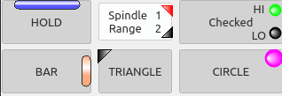

5.1. IndicatedPushButtons
This class modifies QPushButton behaviour.
5.1.1. Indicator Option
indicator_option puts a LED on the top of the button.
QtVCP IndicatedPushButton: Indicated Action Button, LED Indicator Option
Figur 27. QtVCP PushButton: IndicatedPushButton Button, LED Indicator Option
It can be a triangle, circle, top bar, or side bar.
The triangle and circle LEDs can display double vertical LEDs optionally each with it’s own HAL pin. + The size and position can be adjusted.
It will indicate:
  • the current state of the button, or
  • the state of a HAL pin, or
  • LinuxCNC status.
