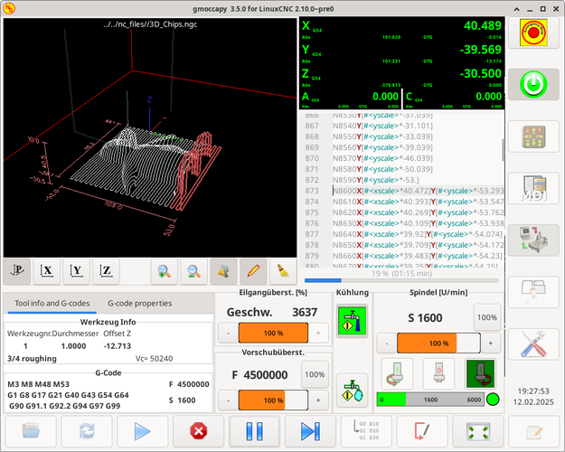

GMOCCAPY is a GUI for LinuxCNC, designed to be used with a touch screen, but can also be used on normal screens with a mouse or hardware buttons and MPG wheels, as it presents HAL Pins for the most common needs. Please find more information in the following.
It offers the possibility to display up to 9 axes, support a lathe mode for normal and back tool lathe and can be adapted to nearly every need, because GMOCCAPY supports embedded tabs and side panels. As a good example for that see gmoccapy_plasma.

You will get a similar screen to the following (the design may vary depending on your config):

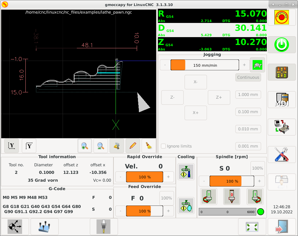

  • LATHE = 1 - Set the screen layout to control a lathe.
  • BACK_TOOL_LATHE = 1 - Is optional and will switch the X axis in a way you need for a back tool lathe. Also the keyboard shortcuts will react in a different way. It is allowed with GMOCCAPY to configure a lathe also with additional axes, so you may use also a XZCW config for a lathe.
    Tip
    See also the Lathe Specific Section.

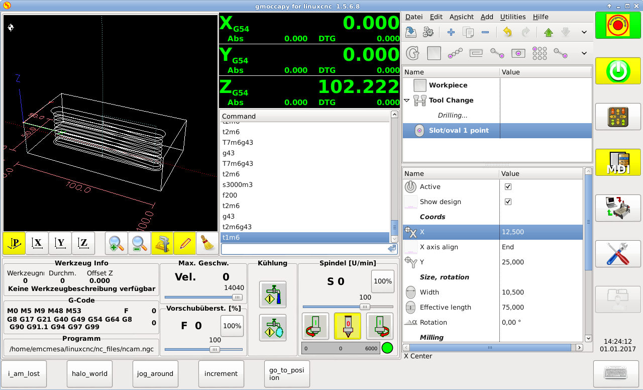

4.3. Macro Buttons
You can add macros to GMOCCAPY, similar to Touchy’s way. A macro is nothing else than a NGC file. You are able to execute complete CNC programs in MDI mode by just pushing one button. To do so, you first have to specify the search path for macros:
[RS274NGC]
SUBROUTINE_PATH = macros
This sets the path to search for macros and other subroutines. Several subroutine paths can be separated ":".
Then you just have to add a section like this:
Configuration of Five Macros to be Shown in the MDI Button List
[MACROS]
MACRO = i_am_lost
MACRO = hello_world
MACRO = jog_around
MACRO = increment xinc yinc
MACRO = go_to_position X-pos Y-pos Z-pos
Then you have to provide the corresponding NGC files which have to follow these rules:
  • The name of the file need to be exactly the same as the name mentioned in the macro line, just with the ".ngc" extension (case sensitive).
  • The file must contain a subroutine like O<i_am_lost> sub, the name of the sub must match exactly (case sensitive) the name of the macro.
  • The file must end with an endsub O<i_am_lost> endsub followed by an M2 command.
  • The files need to be placed in a folder specified in your INI file by SUBROUTINE_PATH in the RS274NGC section
The code between sub and endsub will be executed by pushing the corresponding macro button.
Note
A maximum of 16 macros will be shown in the GUI. Due to space reasons you may need to click on an arrow to switch the page and display hidden macro buttons. The macro buttons will be displayed in the order of the INI entries. It is no error placing more than 16 macros in your INI file, they will just not be shown.
Note
You will find the sample macros in a folder named macros placed in the GMOCCAPY sim folder. If you have given several subroutine paths, they will be searched in the order of the given paths. The first file found will be used.
GMOCCAPY will also accept macros asking for parameters like:
[MACROS]
The parameters must be separated by spaces. This example calls a file go_to_position.ngc with the following content:
; Test file "go to position"
; will jog the machine to a given position
O<go_to_position> sub
G17
G21
G54
G61
G40
G49
G80
G90
;#1 = <X-Pos>
;#2 = <Y-Pos>
;#3 = <Z-Pos>
(DEBUG, Will now move machine to X = #1 , Y = #2 , Z = #3)
G0 X #1 Y #2 Z #3
O<go_to_position> endsub
M2
After pushing the execute macro button, you will be asked to enter the values for X-pos Y-pos Z-pos and the macro will only run if all values have been given.
Note
If you would like to use a macro without any movement, see also the notes in known problems.
Macro example using the "go to position"-macro
gmoccapy getting macro info mid

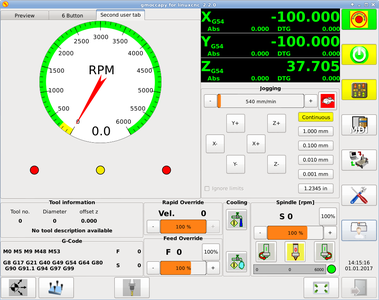

You can add embedded programs to GMOCCAPY like you can do in AXIS, Touchy and Gscreen. All is done by GMOCCAPY automatically if you include a few lines in your INI file in the DISPLAY section.
If you have never used a Glade panel, I recommend to read the excellent documentation on Glade VCP.
You can embed QtVCP panels too: QtVCP panels
Embedded Tab Example
EMBED_TAB_NAME = DRO
EMBED_TAB_LOCATION = ntb_user_tabs
EMBED_TAB_COMMAND = gladevcp -x {XID} dro.glade
EMBED_TAB_NAME = Second user tab
EMBED_TAB_COMMAND = gladevcp -x {XID} vcp_box.glade
All you have to take care of, is that you include for every tab or side panel the mentioned three lines:

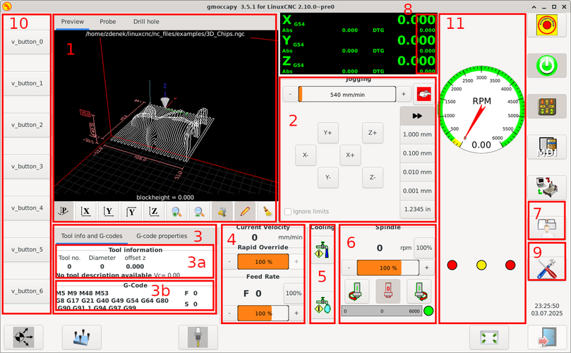

  • EMBED_TAB_NAME = Represents the name of the tab or side panel, it is up to you what name you use, but it must be present!
  • EMBED_TAB_LOCATION = The place where your program will be placed in the GUI, see figure Embedded tab locations. Valid values are:
    • ntb_user_tabs (as main tab, covering the complete screen (7))
    • ntb_preview (as tab on the preview side (1))
    • hbox_jog (will hide the jog buttons and introduce your glade file here (2))
    • box_left (on the left, complete height of the screen (10))
    • box_right (on the right, in between the normal screen and the button list (11))
    • box_tool_and_code_info (will hide the Tool information and G-code frames and introduce your glade file here (3))
    • box_tool_info (will hide the Tool information frame and introduce your glade file here (3a))
    • box_code_info (will hide the G-code information frame and introduce your glade file here (3b))
    • box_vel_info (will hide the velocity frames and introduce your glade file (4))
    • box_coolant_and_spindle (will hide the coolant and spindle frames and introduce your glade file here (5)+(6))
    • box_cooling (will hide the cooling frame and introduce your glade file (5))
    • box_spindle (will hide the spindle frame and introduce your glade file (6))
    • box_custom_1 (will introduce your glade file left of vel_frame)
    • box_custom_2 (will introduce your glade file left of cooling_frame)
    • box_custom_3 (will introduce your glade file left of spindle_frame)
    • box_custom_4 (will introduce your glade file right of spindle_frame)
    • box_dro_side (will introduce your glade file right of the DRO (8))
    • ntb_setup (as tab on the setup page (9))
Note
See also the included sample INI files to see the differences.

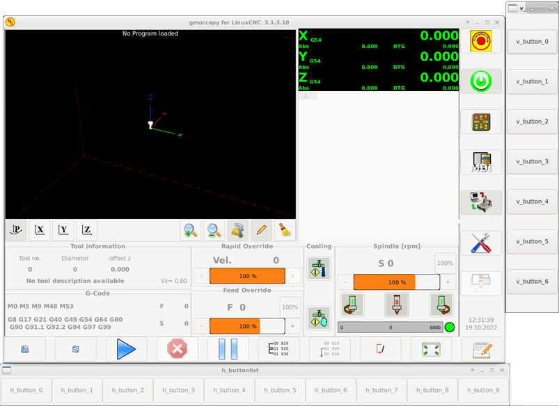

  • EMBED_TAB_COMMAND = The command to execute, i.e.
    includes a custom glade file called dro.glade in the mentioned location. The file must be placed in the config folder of your machine.
    gladevcp h_buttonlist.glade
    will just open a new user window called h_buttonlist.glade note the difference. This one is stand alone, and can be moved around independent from GMOCCAPY window.
    gladevcp -c gladevcp -u hitcounter.py -H manual-example.hal manual-example.ui
    will add a the panel manual-example.ui, include a custom Python handler, hitcounter.py and make all connections after realizing the panel according to manual-example.hal.
    hide
    will hide the chosen box.
gmoccapy embedded tabs small
Figure 1. Embedded tab locations

Magic comments can be used to control the G-code preview. On very large programs the preview can take a long time to load. You can control what is shown and what is hidden on the graphics screen by adding the appropriate comments from this list into your G-code:
(PREVIEW,hide)
<G-code to be hidden>
(PREVIEW,show)

5.1. Right and Bottom Button Lists
The screen has two main button lists, one on the right side an one on the bottom. The right handed buttons will not change during operation, but the bottom button list will change very often. The buttons are count from up to down and from left to right beginning with 0.
Note
The pin names have changed in GMOCCAPY 2 to order them in a better way.
The pins for the right (vertical) buttons are:
  • gmoccapy.v-button.button-0 (bit IN)
  • gmoccapy.v-button.button-1 (bit IN)
  • gmoccapy.v-button.button-2 (bit IN)
  • gmoccapy.v-button.button-3 (bit IN)
  • gmoccapy.v-button.button-4 (bit IN)
  • gmoccapy.v-button.button-5 (bit IN)
  • gmoccapy.v-button.button-6 (bit IN)
For the bottom (horizontal) buttons they are:
  • gmoccapy.h-button.button-0 (bit IN)
  • gmoccapy.h-button.button-1 (bit IN)
  • gmoccapy.h-button.button-2 (bit IN)
  • gmoccapy.h-button.button-3 (bit IN)
  • gmoccapy.h-button.button-4 (bit IN)
  • gmoccapy.h-button.button-5 (bit IN)
  • gmoccapy.h-button.button-6 (bit IN)
  • gmoccapy.h-button.button-7 (bit IN)
  • gmoccapy.h-button.button-8 (bit IN)
  • gmoccapy.h-button.button-9 (bit IN)
As the buttons in the bottom list will change according to the mode and other influences, the hardware buttons will activate the displayed functions. So you don’t have to take care about switching functions around in HAL, because that is done completely by GMOCCAPY!
For a three axes XYZ machine the HAL pins will react as shown in the following three tables:

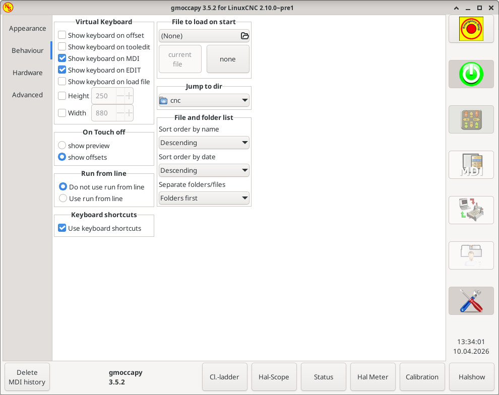

Pin Settings Mode Homing Mode Touch off Mode
delete MDI history
touch X
home all
touch Y
touch Z
home x
open classic ladder
home y
open HAL scope
home z
open HAL status
open HAL meter
open HAL calibration
unhome all
open HAL show
back
back

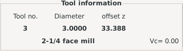

Tool Offset Pins
These pins allow you to show the active tool offset values for X and Z in the tool information frame. You should know that they are only active after G43 has been sent.
Tool information
Figure 3. Tool information area
  • gmoccapy.tooloffset-x (float IN)
  • gmoccapy.tooloffset-z (float IN)
Note
The tooloffset-x line is not needed on a mill, and will not be displayed on a mill with trivial kinematics.
To display the current offsets, the pins have to be connected like this in the postgui HAL file:
net tooloffset-x gmoccapy.tooloffset-x <= motion.tooloffset.x
net tooloffset-z gmoccapy.tooloffset-z <= motion.tooloffset.z
Important
Please note, that GMOCCAPY takes care of its own to update the offsets, sending an G43 after any tool change, but not in auto mode!
So writing a program makes you responsible to include an G43 after each tool change!

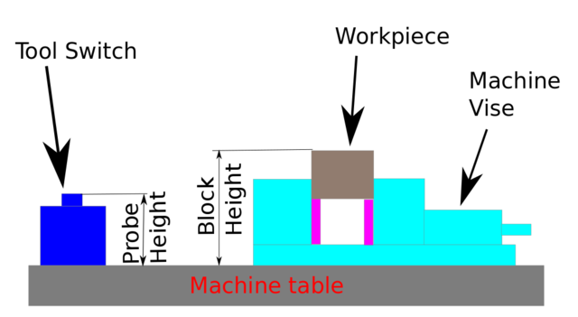

6. Auto Tool Measurement
GMOCCAPY offers an integrated auto tool measurement. To use this feature, you will need to do some additional settings and you may want to use the offered HAL pin to get values in your own NGC remap procedure.
Important
Before starting the first test, do not forget to enter the probe height and probe velocities on the settings page! See Settings Page Tool Measurement.
It might be also a good idea to take a look at the tool measurement video, see tool measurement related videos.
Tool Measurement in GMOCCAPY is done a little bit different to many other GUIs. You should follow these steps:
  1. Touch off your workpiece in X and Y.
  2. Measure the height of your block from the base where your tool switch is located, to the upper face of the block (including chuck etc.).
  3. Push the button block height and enter the measured value.
  4. Go to auto mode and start your program.
Here is a small sketch:
sketch auto tool measurement
Figure 4. Tool measurement data
With the first given tool change the tool will be measured and the offset will be set automatically to fit the block height. The advantage of the GMOCCAPY way is, that you do not need a reference tool.
Note
Your program must contain a tool change at the beginning! The tool will be measured, even it has been used before, so there is no danger, if the block height has changed. There are several videos showing the way to do that on YouTube.

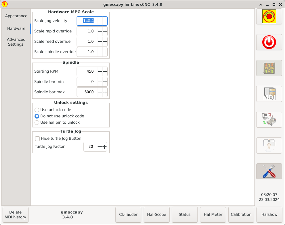

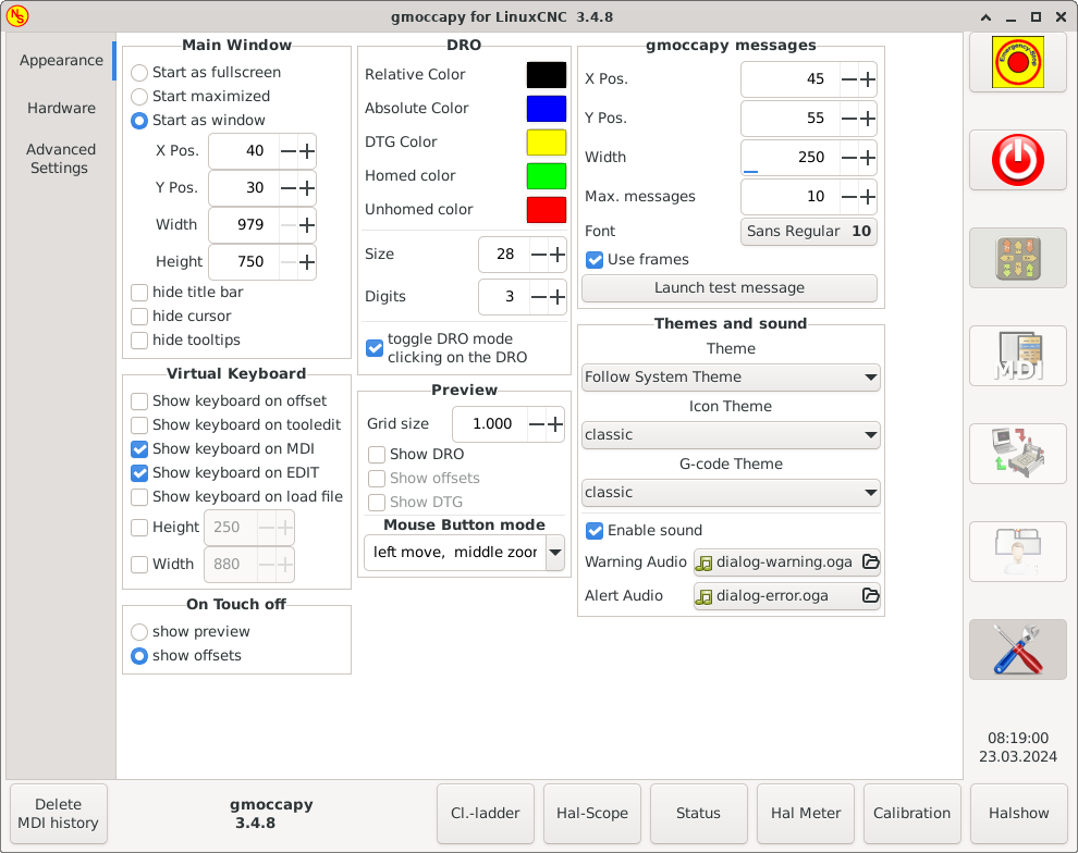

7. The Settings Page
To enter the page you will have to click on gmoccapy settings button and give an unlock code, which is 123 by default. If you want to change it at this time you will have to edit the hidden preference file, see the display section for details.
The page is separated in three main tabs:

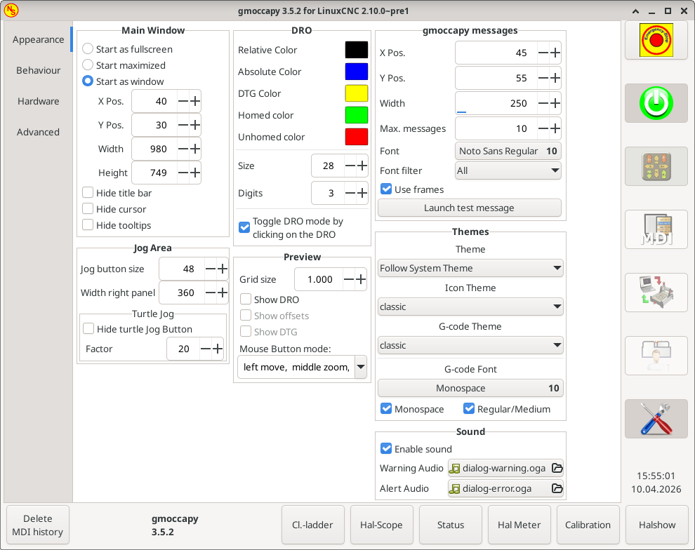

7.1. Appearance
Configuration page
Figure 5. GMOCCAPY settings page Appearance
On this tab you will find the following options:
Main Window
Here you can select how you wish the GUI to start. The main reason for this was the wish to get an easy way for the user to set the starting options without the need to touch code. You have three options:
  • Start as full screen
  • Start maximized
  • Start as window - If you select start as window the spinboxes to set the position and size will get active. One time set, the GUI will start every time on the place and with the size selected. Nevertheless the user can change the size and position using the mouse, but that will not have any influence on the settings.
  • hide title bar - Allows the title bar to be hidden. (default: title bar visible).
  • hide cursor - Does allow to hide the cursor, what is very useful if you use a touch screen.
  • hide tooltips - Hides the tool tips.
Jog Area
  • Jog button size - Change the size of the job buttons in the manual mode page
  • Width right panel - Change the width of the right part of window (= width of the DRO)
Turtle Jog
This settings will have influence on the jog velocities.
  • Hide turtle jog button - Will hide the button right of the jog velocity slider. If you hide this button, please take care that the "rabbit mode" is activated, otherwise you will not be able to jog faster than the turtle jog velocity, which is calculated using the turtle jog factor.
  • Turtle jog factor - Sets the scale to apply for turtle jog mode (button pressed, showing the turtle). If you set a factor of 20, the turtle max. jog velocity will be 1/20 of the max. velocity of the machine.
Note
This button can be controlled using the Turtle-Jog HAL Pin.
DRO
You have the option to select the background colors of the different DRO states. So users suffering from protanopia (red/green weakness) are able to select proper colors.
By default, the background colors are:
  • Relative Color = black
  • Absolute Color = blue
  • DTG Color = yellow
The foreground color of the DRO can be selected with:
  • Homed Color = green
  • Unhomed Color = red
Note
You can change through the DRO modes (absolute, relative, distance to go) by clicking the number on the DRO! If you click on the left side letter of the DRO a popup window will allow you to set the value of the axes, making it easier to set the value, as you will not need to go over the touch off bottom button.
  • size - Allows to set the size of the DRO font, default is 28, if you use a bigger screen you may want to increase the size up to 56. If you do use 4 axes, the DRO font size will be 3/4 of the value, because of space reason.
  • digits - Sets the number of digits of the DRO from 1 to 5.
    Note
    Imperial will show one digit more that metric. So if you are in imperial machine units and set the digit value to 1, you will get no digit at all in metric.
  • Toggle DRO mode by clicking on the DRO - If not active, a mouse click on the DRO will not take any action.
    By default this checkbox is active, so every click on any DRO will toggle the DRO readout from actual to relative to DTG (distance to go).

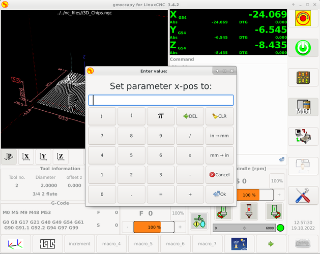

    Neverthereless a click on the axis letter will open the popup dialog to set the axis value.
Preview
  • Grid Size - Sets the grid size of the preview window. Unfortunately the size has to be set in inches, even if your machine units are metric. We do hope to fix that in a future release.
    Note
    The grid will not be shown in perspective view.
  • Show DRO - Will show the a DRO also in the preview pane, it will be always shown in fullsize preview.
  • Show DTG - Will show the DTG (direct distance to end point) in the preview pane if Show DRO is active. Otherwise only in full size preview.
  • Show Offsets - Will show the offsets in the preview pane when Show DRO is active. Otherwise only in full size preview.
  • Mouse Button Mode - This combobox allows you to select the button behavior of the mouse to rotate, move or zoom within the preview:
    • left rotate, middle move, right zoom
    • left zoom, middle move, right rotate
    • left move, middle rotate, right zoom
    • left zoom, middle rotate, right move
    • left move, middle zoom, right rotate
    • left rotate, middle zoom, right move
Default is left move, middle zoom, right rotate.
The mouse wheel will still zoom the preview in every mode.
Tip
If you select an element in the preview, the selected element will be taken as rotation center point and in auto mode the corresponding code line will be highlighted.
Gmoccapy Messages
This will display small pop up windows displaying a message or error text, similar to the ones known from AXIS. You can delete a specific message by clicking on its close button. If you want to delete the last one, just hit the WINDOWS key on your keyboard, or delete all messages at once with Control + Space.
You are able to set some options:
  • X Pos - The position of the top left corner of the message in X counted in pixel from the top left corner of the screen.
  • Y Pos - The position of the top left corner of the message in Y counted in pixel from the top left corner of the screen.
  • Width - The width of the message box.
  • Max. messages - The maximum number of messages you want to see at once. If you set this to 10, the 11th message will delete the first one, so you will only see the last 10.
  • Font - The font and size you want to use to display the messages.
  • Font filter - A filter for the font chooser above.
  • Use frames - If you activate the checkbox, each message will be displayed in a frame, so it is much easier to distinguish the messages. But you will need a little bit more space.
  • Launch test message-button - It will show a message, so you can see the changes of your settings without the need to generate an error.
Themes
  • Theme - This lets the user select what desktop theme to apply. By default "Follow System Theme" is set.
  • Icon Theme - Change the icon theme. Currently there are three themes available:
    • classic
    • material
    • material light
    For more information and how to create custom icon themes, see section Icon Theme.
  • G-code Theme - Select a colour theme for the G-code viewer/editor.
  • G-code Font - Select a font for the G-code viewer/editor. Default is "monospace 10".
Sound
Select what error and messages sounds should be played and if sound should be played at all.
7.2. Behaviour
Configuration page
Figure 6. GMOCCAPY settings page Behaviour

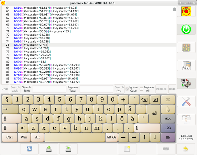

Virtual Keyboard
The checkboxes allow the user to select if he wants the on board keyboard to be shown immediately when entering the MDI Mode, the offset page, the tooledit widget or when open a program in the EDIT mode. The keyboard button on the bottom button list will not be affected by these settings, so you are able to show or hide the keyboard by pressing the button.
The default setting is:
  • Show keyboard on offset = False
  • Show keyboard on tooledit = False
  • Show keyboard on MDI = True
  • Show keyboard on EDIT = True
  • Show keyboard on load file = False
Note
If this section is not sensitive, you have not installed a virtual keyboard, supported ones are onboard and matchbox-keyboard.
Note
If the keyboard layout is not correct, i.e. clicking Y gives Z, than the layout has not been set properly, related to your locale settings. For onboard it can be solved with a small batch file with the following content:
#!/bin/bash
setxkbmap -model pc105 -layout de -variant basic
The letters "de" are for German, you will have to set them according to your locale settings. Just execute this file before starting LinuxCNC, it can be done also adding a starter to your local folder.
./config/autostart
So that the layout is set automatically on starting.
For matchbox-keyboard you will have to make your own layout, for a German layout ask in the forum.
GMOCCAPY with Onboard keyboard in edit mode
Onboard keyboard
On Touch Off
This gives the option whether to show the preview tab or the offset page tab when you enter the touch off mode by clicking the corresponding bottom button.
  • show preview
  • show offsets
Run from Line
You can allow or disallow the run from line. This will set the corresponding button insensitive (grayed out), so the user will not be able to use this option. The default is disable run from line.
Warning
It is not recommend to use run from line, as LinuxCNC will not take care of any previous lines in the code before the starting line. So errors or crashes are fairly likely.
Keyboard shortcuts
Some users want to jog their machine using the keyboard buttons and there are others that will never allow this. So everybody can select whether to use them or not.
Keyboard shortcuts are disabled by default. They can be activated by the checkbox
  • Use keyboard shortcuts
Warning
It is not recommended to use keyboard jogging, as it represents a serious risk for operator and machine.
Please take care if you use a lathe, then the shortcuts will be different, see the Lathe Specific Section.
General
  • F1 - Trigger Estop (will work even if keyboard shortcuts are disabled)
  • F2 - Toggle machine on/off
  • F3 - Manual mode
  • F5 - MDI mode
  • ESC - Abort
In Manual Mode
  • Arrow_Left or NumPad_Left - Jog X minus
  • Arrow_Right or NumPad_Right - Jog X plus
  • Arrow_up or NumPad_Up - Jog Y plus
  • Arrow_Down or NumPad_Down - Jog Y minus
  • Page_Up or NumPad_Page_Up - Jog Z plus
  • Page_Down or NumPad_Page_Down - Jog Z minus
In Auto Mode
  • R or r - Run program
  • P or p - Pause program
  • S or s - Resume program
  • Control + R or Control + r - Reload the loaded file
Message handling (see Message behavior and appearance)
  • WINDOWS - Delete last message
  • Control + Space - Delete all messages
File to load on start up
Select the file you want to be loaded on start up. If a file is loaded, it can be set by pressing the current button. To avoid that any program is loaded at start up, just press the None button.
The file selection screen will use the filters you have set in the INI file, if there aren’t any filters given, you will only see NGC files. The path will be set according to the INI settings in [DISPLAY] PROGRAM_PREFIX.
NGC files can be explicitly excluded from the file selection screen by passing no_ngc instead of an extension:
PROGRAM_EXTENSION = no_ngc Exclude ngc files from selection screen
Jump to dir
You can set here the directory to jump to if you press the corresponding button in the file selection dialog.
File and folder list
For the file chooser page it is possible to change the sorting options with these parameters.
