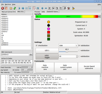

Run the sample GladeVCP panel integrated into AXIS like PyVCP as follows:
$ cd configs/sim/axis/gladevcp $ linuxcnc gladevcp_panel.ini
Run the same panel, but as a tab inside AXIS:
$ cd configs/sim/axis/gladevcp $ linuxcnc gladevcp_tab.ini
To run this panel inside Touchy:
$ cd configs/sim/touchy/gladevcp $ linuxcnc gladevcp_touchy.ini
Functionally these setups are identical - they only differ in screen real estate requirements and visibility. Since it is possible to run several GladeVCP components in parallel (with different HAL component names), mixed setups are possible as well - for instance a panel on the right hand side, and one or more tabs for less-frequently used parts of the interface.
2.1. Exploring the example panel
While running configs/sim/axis/gladevcp_panel.ini or configs/sim/axis/gladevcp_tab.ini, explore Show HAL Configuration - you will find the gladevcp HAL component and may observe their pin values while interacting with the widgets in the panel. The HAL setup can be found in configs/axis/gladevcp/manual-example.hal.
The example panel has two frames at the bottom. The panel is configured so that resetting ESTOP activates the Settings frame and turning the machine on enables the Commands frame at the bottom. The HAL widgets in the Settings frame are linked to LEDs and labels in the Status frame, and to the current and prepared tool number - play with them to see the effect. Executing the T<toolnumber> and M6 commands in the MDI window will change the current and prepared tool number fields.
The buttons in the Commands frame are MDI Action widgets - pressing them will execute an MDI command in the interpreter. The third button Execute Oword subroutine is an advanced example - it takes several HAL pin values from the Settings frame, and passes them as parameters to the Oword subroutine. The actual parameters received by the routine are displayed by (DEBUG, ) commands - see ../../nc_files/oword.ngc for the subroutine body.
To see how the panel is integrated into AXIS, see the [DISPLAY]GLADEVCP statement in configs/sim/axis/gladevcp/gladevcp_panel.ini, the [DISPLAY]EMBED* statement in configs/sim/axis/gladevcp/gladevcp_tab.ini and [HAL]POSTGUI_HALFILE statements in both configs/sim/axis/gladevcp/gladevcp_tab.ini and configs/sim/axis/gladevcp/gladevcp_panel.ini.

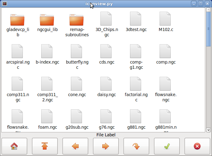

6.23. IconView (File Select)
This is a touch screen friendly widget to select a file and to change directories.
6.23.1. Propiedades
IconView widget has the following properties:
- icon_size
Sets the size of the displayed icon.
Allowed values are integers in the range from 12 to 96.
Default is 48. - start_dir
Sets the directory to start in when the widget is shown first time.
Must be a string, containing a valid directory path.
Default is "/". - jump_to_dir
Sets the "jump to" directory, which is selected by the corresponding button in the bottom button list (the 5th button counting from the left).
Default is "\~". - filetypes
Sets the file filter for the objects to be shown.
Must be a string containing a comma separated list of extensions to be shown.
Default is "ngc,py". - sortorder
Sets the sorting order of the displayed icon.
Must be an integer value from 0 to 3, where:-
0 = ASCENDING (sorted according to file names)
1 = DESCENDING (sorted according to file names)
2 = FOLDERFIRST (show the folders first, then the files), default
3 = FILEFIRST (show the files first, then the folders)
6.23.2. Direct program control
Using GObject to set the above listed properties:
[widget name].set_property(property,Value)
There are Python methods to control the widget:
[widget name].show_buttonbox(state)
If False the bottom button box will be hidden.
This is helpful in custom screens, with special buttons layouts to not alter the layout of the GUI. Good example for that is GMOCCAPY.
state= boolean (True or False).
Default is True. -
[widget name].show_filelabel(state)
If True the file label (between the IconView window and the bottom button box) will be shown.
Hiding this label may save place, but showing it is very useful for debugging reasons.
Default is True. -
[widget name].set_icon_size(iconsize)
Sets the icon size.
Must be an integer in the range from 12 to 96.
Default = 48. -
[widget name].set_directory(directory)
Allows to set an directory to be shown.
directory= string (a valid file path). -
[widget name].set_filetypes(filetypes)
Sets the file filter to be used.
Only files with the given extensions will be shown.
filetypes= string containing a comma separated list of extensions.
Default = "ngc,py". -
[widget name].get_selected()
Returns the path of the selected file, orNoneif a directory has been selected. -
[widget name].refresh_filelist()
Refreshes the filelist.
Needed if you add a file without changing the directory.
If the button box has been hidden, you can reach the functions of this button through its clicked signals like so:
[widget name].btn_home.emit("clicked")
[widget name].btn_jump_to.emit("clicked")
[widget name].btn_sel_prev.emit("clicked")
[widget name].btn_sel_next.emit("clicked")
[widget name].btn_get_selected.emit("clicked")
[widget name].btn_dir_up.emit("clicked")
[widget name].btn_exit.emit("clicked")
6.23.3. Señales
El widget emitirá la señales siguientes:
selected
This signal is emitted when the user selects an icon.
It will return a string containing a file path if a file has been selected, orNoneif a directory has been selected. -
sensitive
This signal is emitted when the buttons change their state from sensitive to not sensitive or vice versa.
This signal is useful to maintain surrounding GUI synchronized with the button of the widget. See GMOCCAPY as example.
It will return the buttonname and the new state:-
buttonnameis one ofbtn_home,btn_dir_up,btn_sel_prev,btn_sel_next,btn_jump_toorbtn_select. -
stateis a boolean and will be True or False.
exit
This signal is emitted when the exit button has been pressed to close the IconView.
Mostly needed if the application is started as stand alone.

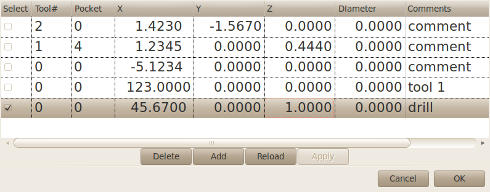

6.25. Tooleditor widget
This is a tooleditor widget for displaying and modifying a tool file.
If in lathe mode, it will display wear offsets and tool offsets separately.
Wear offsets are designated by tool number above 10000 (Fanuc style).
It checks the current file once a second to see if LinuxCNC updated it.
Note
LinuxCNC requires remapping of tool calls to actually use wear offsets. |
6.25.1. Propiedades
tooleditor has the following properties:
- font
Display font to use
- hide_columns
This will hide the given columns.
The columns are designated (in order) as such:s,t,p,x,y,z,a,b,c,u,v,w,d,i,j,q.
You can hide any number of columns including the select and comments. - lathe_display_type
Show lathe format
6.25.2. Direct program control
