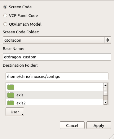

1.1. copy
Used for copying QtVCP’s builtin Screens/VCP Panels/QtVismach code to a folder so one can customize it.
In a terminal run:
qtvcp copy
QtVCP copy Dialog - Screen, Panel or Vismach Code Copy Panel
Figure 1. QtVCP copy Dialog - Screen, VCP Panel or QtVismach Code Copy Panel

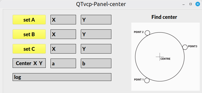

1.2. center
QtVCP Center Finder Panel VCP
Used for finding center of three points.
In a terminal run:
qtvcp center
1.2.1. Qt Embedding Commands
Add these lines to the [DISPLAY] section in your .ini file
The example tab_location is for the QtDragon screen.
EMBED_TAB_NAME=Center Finder
EMBED_TAB_COMMAND=qtvcp center
EMBED_TAB_LOCATION=tabWidget_utilities

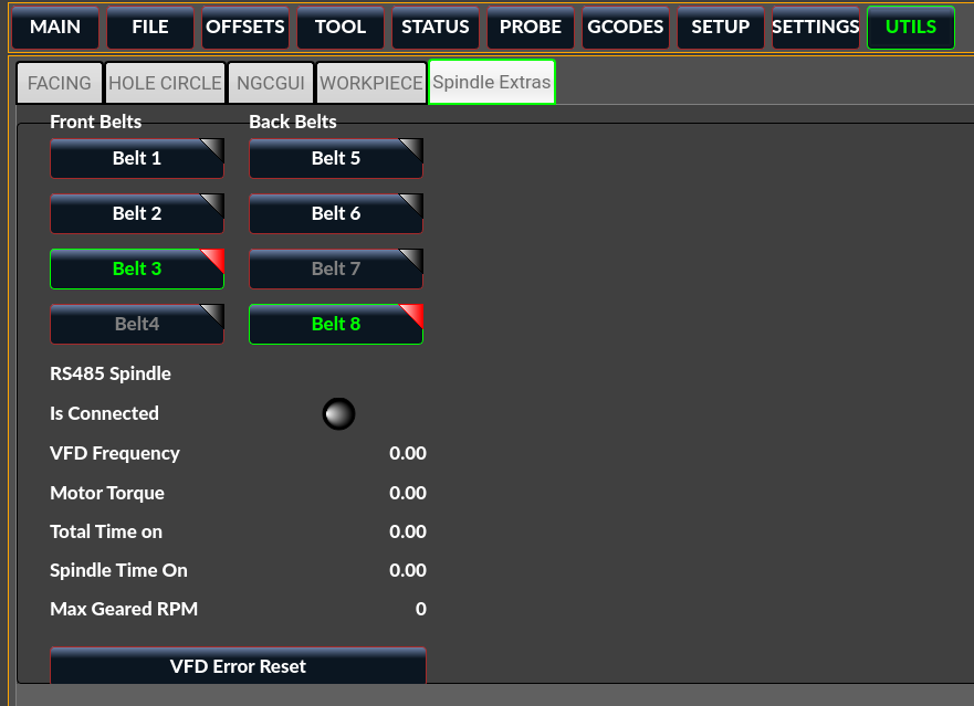

1.3. spindle_belts
This panel is designed to display additional RS485 VFD data and also to configure a 4 sheave, 2 belt spindle drive via a series of buttons.
QtVCP spindle_belts Panel - Spindle Belts VCP
In addition, it is also a useful template to use for your custom panel because it includes:
  • Display of additional HAL data
  • Buttons and button groups
  • Dynamic changes to button enabled/disabled state based on the state of other buttons
  • Saving data to the qtdragon.prefs file
  • Custom button to reset the VFD
Modify this panel to suit your own requirements. Most common features are used. The advantage of using panels is that it separates your custom display code from the qtdragon core code so upgrading the system will not break your customization.
1.3.1. Additional Requirements
  • A spindle drive (for instance VFDMOD)
  • A custom component that scales the VFD frequency to obtain the desired spindle speed.
  • A belt driven spindle that uses two belts and an intermediate idler pulley much like a drill press.
  • Connect the input pins qtdragon.belts.<pin-name> in your postgui HAL file.
1.3.2. Function
The belts are broken into two button groups, the front belts and the rear belts. These are numbered as per the plate on the machine. Buttons in a group are mutually exclusive, i.e., only one can be selected in the group.
Additionally, it’s not possible to have both belts on the same level with this kind of mechanism because you cannot fit two belts to the one idler pulley sheave. So if a belt is selected, its opposite button is disabled. E.g., if belt 3 is selected, belt 7 is disabled.
1.3.3. Embedding commands
EMBED_TAB_NAME=Spindle Extras
EMBED_TAB_COMMAND=qtvcp spindle_belts
Here is how to load spindle_belt from a HAL script:
loadusr qtvcp spindle_belts

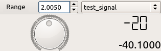

1.4. test_dial
  • This panel has a dial that adjusts S32 and Float HAL output pins.
  • The dial’s range can be adjusted from a drop down menu.
  • The output can be scaled with the spinbox.
  • A combobox can be used to automatically select and connect to a signal.
loadusr qtvcp test_dial
QtVCP test_dial Panel - Test Dial VCP
Figure 2. QtVCP test_dial Panel - Test Dial VCP

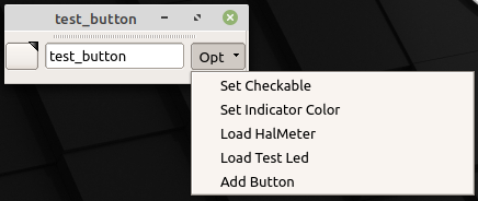

1.5. test_button
  • This panel has a button that will set a HAL pin.
  • The button can be selected as a momentary or a toggle button.
  • A HAL pin will be created that follows the button state.
  • The button’s indicator color can be adjusted from a drop down menu.
  • A HAL pin or signal can be selected to follow the button state.
  • You can add more buttons from the drop down menu.
  • You can load a Halmeter from the drop down menu.
  • You can load a test LED from the drop down menu.
  • The button can be detached from the main windows.
Here is how to load test_button from a HAL script:
loadusr qtvcp test_button
loadusr qtvcp -o 4 test_button
The -o switch sets how many buttons the panel starts with.
If loading directly from a terminal omit the loadusr.
QtVCP test_button - Test Button VCP
Figure 3. QtVCP test_button - Test Button VCP

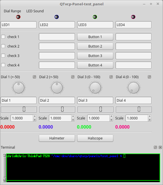

1.7. test_panel
Collection of useful widgets for testing HAL component, including speech of LED state.
loadusr qtvcp test_panel
QtVCP test_panel - HAL Component Testing Panel
Figure 5. QtVCP test_panel - HAL Component Testing Panel

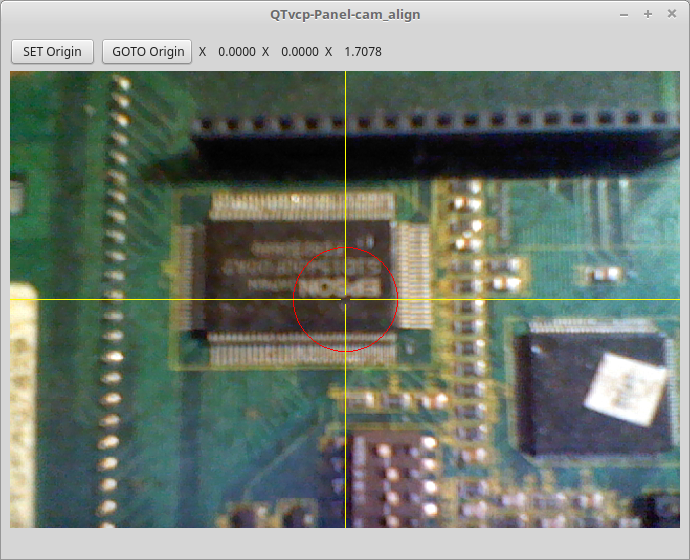

1.8. cam_align
A camera display widget for rotational alignment.
QtVCP cam_align Panel - Camera Based Alignment Panel
Figure 6. QtVCP cam_align Panel - Camera Based Alignment Panel
Bruk
Add these lines to the INI file:
[DISPLAY]
EMBED_TAB_NAME = cam_align
EMBED_TAB_COMMAND = halcmd loadusr -Wn qtvcp_embed qtvcp -d -c qtvcp_embed -x {XID} cam_align
# The following line is needed if embedding in GMOCCAPY
Note
All <options> must appear before the cam_align panel name.
Qtvcp Options
  • -c NAME HAL component name. Default is to use the UI file name.
  • -d Debugging on. or remove for no minimum output
  • -v Verbose debugging on. You can find all available resolutions.
  • -x {XID} used for embedding into AXIS or Gmoccapy
  • -o <option> Options passed to cam_align. can use multiple -o entries
Cam_align Options
These are the available -o option:
  • size=400,400 Size of the embedded window (width,height)
  • imagesize=300,300 Size of the image inside the window (width,height)
  • rotincr=5 Sets the increment of the crosshair rotation. (degrees)
  • xscale=100 Scales the image in X. A negative value will flip the image in X (percent)
  • yscale=100 Scales the image in Y. A negative value will flip the image in Y (percent)
  • camnumber=1 Sets what system camera to use
  • api=V4L2 Sets the opencv backend library for the camera
  • res=1280,720 Sets the requested resolution (width,height)
For instance you can add window width and height size, rotation increment, and camera number from the INI with -o options.
EMBED_TAB_COMMAND = halcmd loadusr -Wn qtvcp_embed qtvcp -d -c qtvcp_embed -x {XID} -o size=400,400 -o rotincr=.2 -o camnumber=0 cam_align
Musinnstillinger:
  • left mouse single click - increase cross hair rotation one increment
  • right mouse single click - decrease cross hair rotation one increment
  • middle mouse single click - cycle through rotation increments
  • left mouse hold and scroll - scroll camera zoom
  • right mouse hold and scroll - scroll cross hair rotation angle
  • mouse scroll only - scroll circle diameter
  • left mouse double click - reset zoom
  • right mouse double click - reset rotation
  • middle mouse double click - reset circle diameter
To use the top buttons you have to assign a command (or a sub-routine). This could look like this:
[MDI_COMMAND_LIST]
MDI_COMMAND_CAM_ALIGN1=G10 L20 P1 X0 Y0,Set XY\nOrigin
MDI_COMMAND_CAM_ALIGN2=G0 X0 Y0,Go To\nOrigin
Where the first command is referring to the button "SET origin" and the second to the button "GOTO Origin".
Note the comma and text after is optional - it will override the default button text.
These buttons are QtVCP action buttons and follow those rules.

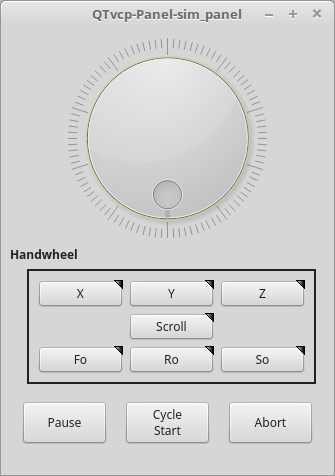

1.9. sim_panel
Small control panel to simulate MPG jogging controls etc for simulated configurations.
The MPG, selection buttons and control buttons export HAL pins to connect to linuxcnc.
The selection and control group boxes can be hidden if not needed by using the -o hide= option.
groupBoxControl and groupBoxSelection are the widget names that can be hidden.
If you want to hide both, use a comma between them with no spaces.
The -a option will make the panel always-on-top of all windows.
loadusr qtvcp sim_panel
Here we load the panel with no MPG selection buttons and the always-on-top option.
loadusr qtvcp -a -o hide=groupBoxSelection sim_panel
QtVCP sim_panel - Simulated Controls Panel For Screen Testing
Figure 7. QtVCP sim_panel - Simulated Controls Panel For Screen Testing.

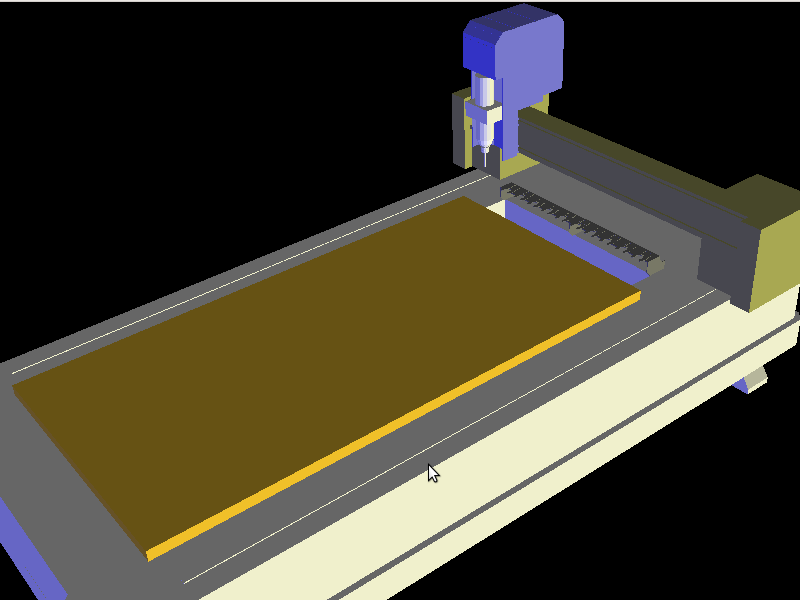

2.2. QtVCP vismach_router_atc
3D OpenGL view of a 3-Axis router style, gantry bed milling machine.
This particular panel shows how to define and connect the model parts in the handler file, rather then importing the pre-built model from QtVCP’s vismach library.
loadusr qtvcp vismach_router_atc
QtVCP vismach_router_atc - 3-Axis Gantry Bed Mill 3D View Panel
Figure 10. QtVCP vismach_router_atc - 3-Axis Gantry Bed Mill 3D View Panel

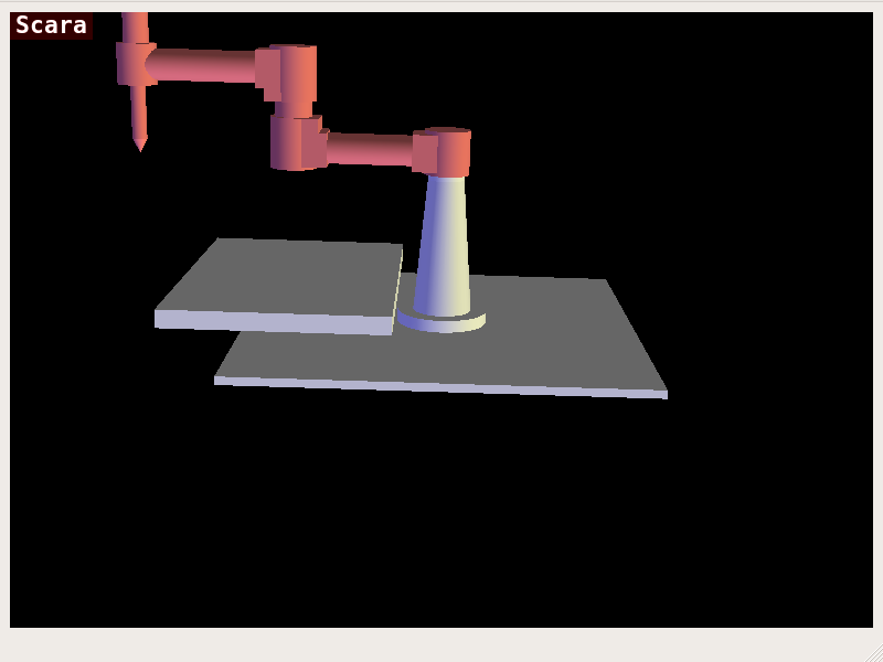

2.3. QtVCP vismach_scara
3D OpenGL view of a SCARA based milling machine.
loadusr qtvcp vismach_scara
QtVCP vismach_scara - SCARA Mill 3D View Panel
Figure 11. QtVCP vismach_scara - SCARA Mill 3D View Panel

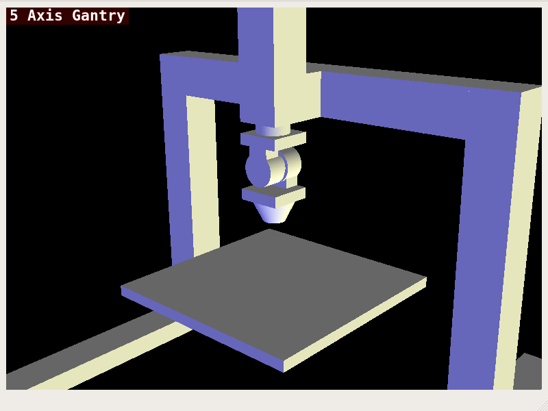

2.5. QtVCP vismach_mill_5axis_gantry
3D OpenGL view of a 5-Axis gantry type milling machine.
loadusr qtvcp vismach_mill_5axis_gantry
QtVCP vismach_mill_5axis_gantry - 5-Axis Gantry Mill 3D View Panel
Figure 13. QtVCP vismach_mill_5axis_gantry - 5-AxIs Gantry Mill 3D View Panel

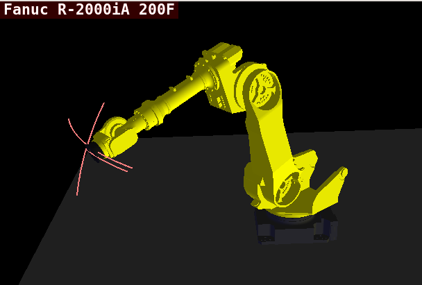

2.6. QtVCP vismach_fanuc_200f
3D openGL view of a 6 joint robotic arm.
loadusr qtvcp vismach_fanuc_200f
QtVCP vismach_fanuc_200f - 6 Joint Robotic Arm
Figure 14. QtVCP vismach_fanuc_200f - 6 Joint Robotic Arm
3. Custom Virtual Control Panels
You can of course make your own panel and load it.
If you made a UI file named my_panel.ui and a HAL file named my_panel.hal, you would then load this from a terminal with:
halrun -I -f my_panel.hal
Example HAL file loading a QtVCP panel
# load realtime components
loadrt threads
loadrt classicladder_rt
# load non-realtime programs
loadusr classicladder
loadusr -Wn my_panel qtvcp my_panel.ui  # (1)
# add components to thread
addf classicladder.0.refresh thread1
# connect pins
net bit-input1     test_panel.checkbox_1        classicladder.0.in-00
net bit-hide       test_panel.checkbox_4        classicladder.0.hide_gui
net bit-output1    test_panel.led_1             classicladder.0.out-00
net s32-in1        test_panel.doublescale_1-s   classicladder.0.s32in-00
# start thread
start
  1. In this case we load qtvcp using -Wn which waits for the panel to finish loading before continuing to run the next HAL command.
    This is to ensure that the panel created HAL pins are actually done in case they are used in the rest of the file.

Here is a sample to change the circle color in cam_align:
import sys
import os
import importlib
from PyQt5.QtCore import Qt
from qtvcp.core import Path
PATH = Path()
# get reference to original handler file so we can subclass it
sys.path.insert(0, PATH.PANELDIR)
panel = os.path.splitext(os.path.basename(os.path.basename(__file__)))[0]
base = panel.replace('_handler','')
module = "{}.{}".format(base,panel)
mod = importlib.import_module(module, PATH.PANELDIR)
sys.path.remove(PATH.PANELDIR)
HandlerClass = mod.HandlerClass
# return our subclassed handler object to Qtvcp
def get_handlers(halcomp, widgets, paths):
    return [UserHandlerClass(halcomp, widgets, paths)]
# subclassed from HandlerClass which was imported above
class UserHandlerClass(HandlerClass):
    print('Custom subclassed panel handler loaded\n')
    def initialized__(self):
        # call original handler initialized function
        super().initialized__()
        # add our customization
        self.w.camview.circle_color = Qt.green
