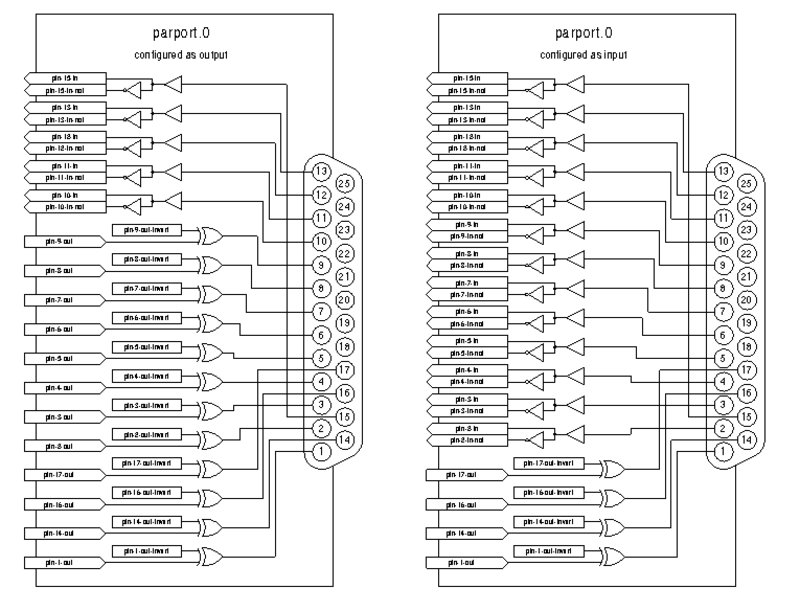

Parport block diagram
Figure 1. Parport block diagram

  • parport.<p>.pin-`__<n>__-out` (bit) Drives a physical output pin.
  • parport.<p>.pin-`__<n>__-in` (bit) Tracks a physical input pin.
  • parport.<p>.pin-`__<n>__-in-not` (bit) Tracks a physical input pin, but inverted.
For each pin, <p> is the port number, and <n> is the physical pin number in the 25 pin D-shell connector.
For each physical output pin, the driver creates a single HAL pin, for example: parport.0.pin-14-out.
For each physical input pin, the driver creates two HAL pins, for example: parport.0.pin-12-in and parport.0.pin-12-in-not.
The -in HAL pin is TRUE if the physical pin is high, and FALSE if the physical pin is low. The -in-not HAL pin is inverted and is FALSE if the physical pin is high.
