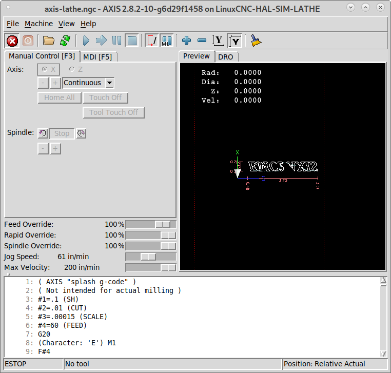

AXIS is a graphical front-end for LinuxCNC which features a live preview and backplot. It is written in Python and uses Tk and OpenGL to display its user interface.
AXIS main window
Figure 1. The AXIS Window
2. Getting Started
If your configuration is not currently set up to use AXIS, you can change it by editing the .ini file (INI file). In the section [DISPLAY] change the [DISPLAY] line to read DISPLAY = axis.
The sample configuration sim/axis.ini is already configured to use AXIS as its front-end.
When AXIS starts, a window like the one in the figure The AXIS Window above opens.

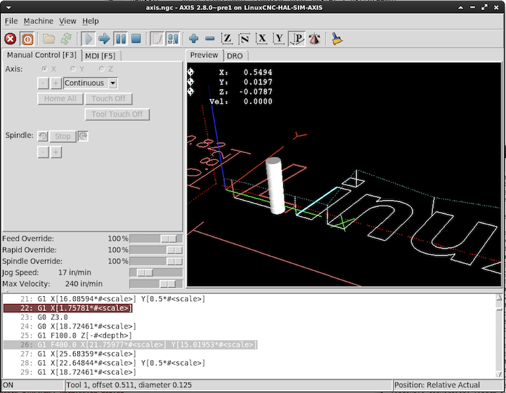

    • A preview of the loaded file (in this case, axis.ngc), as well as the current location of the CNC machine’s controlled point. Later, this area will display the path the CNC machine has moved through, called the backplot.
    • A large readout showing the current position and all offsets.

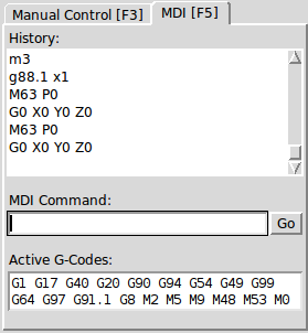

  • MDI Tab - where G-code programs can be entered manually, one line at a time. This also shows the Active G-codes which shows which modal G-codes are in effect.

  • Clear MDI history - Clears the MDI history window.
  • Copy from MDI history - Copies the MDI history to the clipboard
  • Paste to MDI history - Paste from the clipboard to the MDI history window

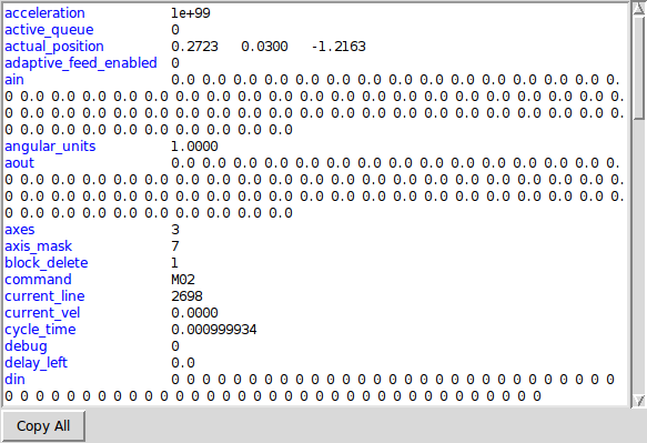

  • Show LinuxCNC Status - Opens a window showing LinuxCNC’s status.

3.3. Graphical Display Area
Coordinate Display
In the upper-left corner of the program display is the coordinate position display for each axis. To the right of the number an origin symbol origin symbol is shown if the axis has been homed is shown if the axis has been homed.
A limit symbol limit symbol is shown on the right side of the coordinate position number if the axis is on one of its limit switches.
To properly interpret the coordinate position numbers, refer to the Position: indicator in the status bar. If the position is Machine Actual, then the displayed number is in the machine coordinate system. If it is Relative Actual, then the displayed number is in the offset coordinate system. When the coordinates displayed are relative and an offset has been set, the display will include a cyan machine origin cyan machine origin marker.
If the position is Commanded, then the exact coordinate given in a G-code command is displayed. If it is Actual, then it is the position the machine has actually moved to. These values can be different from commanded position due to following error, dead band, encoder resolution, or step size. For instance, if you command a movement to X 0.0033 on your mill, but one step of your stepper motor or one encoder count is 0.00125, then the Commanded position might be 0.0033, but the Actual position will be 0.0025 (2 steps) or 0.00375 (3 steps).
Preview Plot
When a file is loaded, a preview of it is shown in the display area. Fast moves (such as those produced by the G0 command) are shown as cyan lines. Moves at a feed rate (such as those produced by the G1 command) are shown as solid white lines. Dwells (such as those produced by the G4 command) are shown as small pink X marks.
G0 (Rapid) moves prior to a feed move will not show on the preview plot. Rapid moves after a T<n> (Tool Change) will not show on the preview until after the first feed move. To turn either of these features off program a G1 without any moves prior to the G0 moves.
Program Extents
The extents of the program in each axis are shown. At the ends, the least and greatest coordinate values are indicated. In the middle, the difference between the coordinates is shown.
When some coordinates exceed the soft limits in the INI file, the relevant dimension is shown in a different color and enclosed by a box. In figure below the maximum soft limit is exceeded on the X axis as indicated by the box surrounding the coordinate value. The minimum X travel of the program is -1.95, the maximum X travel is 1.88, and the program requires 3.83 inches of X travel. To move the program so it’s within the machine’s travel in this case, jog to the left and Touch Off X again.
Soft Limits
Figure 2. Soft Limits
Tool Cone
When no tool is loaded, the location of the tip of the tool is indicated by the tool cone. The tool cone does not provide guidance on the form, length, or radius of the tool.
When a tool is loaded (for instance, with the MDI command T1 M6 ), the cone changes to a cylinder which shows the diameter of the tool given in the tool table file.
Backplot
When the machine moves, it leaves a trail called the backplot. The color of the line indicates the type of motion: Yellow for jogs, faint green for rapid movements, red for straight moves at a feed rate, and magenta for circular moves at a feed rate.
Grid
AXIS can optionally display a grid when in orthogonal views. Enable or disable the grid using the Grid menu under View. When enabled, the grid is shown in the top and rotated top views; when coordinate system is not rotated, the grid is shown in the front and side views as well. The presets in the Grid menu are controlled by the INI file item [DISPLAY]GRIDS. If unspecified, the default is 10mm 20mm 50mm 100mm 1in 2in 5in 10in.
Specifying a very small grid may decrease performance.
Interacting
By left-clicking on a portion of the preview plot, the line will be highlighted in both the graphical and text displays. By left-clicking on an empty area, the highlighting will be removed.
By dragging with the left mouse button pressed, the preview plot will be shifted (panned).
By dragging with shift and the left mouse button pressed, or by dragging with the mouse wheel pressed, the preview plot will be rotated. When a line is highlighted, the center of rotation is the center of the line. Otherwise, the center of rotation is the center of the entire program.
By rotating the mouse wheel, or by dragging with the right mouse button pressed, or by dragging with control and the left mouse button pressed, the preview plot will be zoomed in or out.
By clicking one of the Preset View icons, or by pressing V, several preset views may be selected.
3.4. Text Display Area
By left-clicking a line of the program, the line will be highlighted in both the graphical and text displays.
When the program is running, the line currently being executed is highlighted in red. If no line has been selected by the user, the text display will automatically scroll to show the current line.
Current and Selected Lines
Figure 3. Current and Selected Lines

3.6. MDI
MDI allows G-code commands to be entered manually. When the machine is not turned on, or when a program is running, the MDI controls are unavailable.
MDI tab
Figure 6. The MDI tab
  • History - This shows MDI commands that have been typed earlier in this session.
  • MDI Command - This allows you to enter a G-code command to be executed. Execute the command by pressing Enter or by clicking Go.
  • Active G-codes - This shows the modal codes that are active in the interpreter. For instance, G54 indicates that the G54 offset is applied to all coordinates that are entered. When in Auto the Active G-codes represent the codes after any read ahead by the interpreter.

5. Show LinuxCNC Status (linuxcnctop)
AXIS includes a program called linuxcnctop which shows some of the details of LinuxCNC’s state. You can run this program by invoking Machine > Show LinuxCNC Status
LinuxCNC Status Window
Figure 7. LinuxCNC Status Window
The name of each item is shown in the left column. The current value is shown in the right column. If the value has recently changed, it is shown on a red background.

10. Using AXIS in Lathe Mode
By including the line LATHE = 1 in the [DISPLAY] section of the INI file, AXIS selects lathe mode. The Y axis is not shown in coordinate readouts, the view is changed to show the Z axis extending to the right and the X axis extending towards the bottom of the screen, and several controls (such as those for preset views) are removed. The coordinate readouts for X are replaced with diameter and radius.
AXIS Lathe Mode
Figure 9. AXIS Lathe Mode
Pressing V zooms out to show the entire file, if one is loaded.
When in lathe mode, the shape of the loaded tool (if any) is shown.
