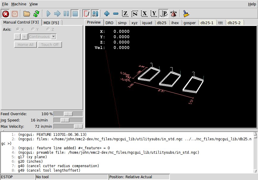

Figure 1. NGCGUI imbedded into Axis

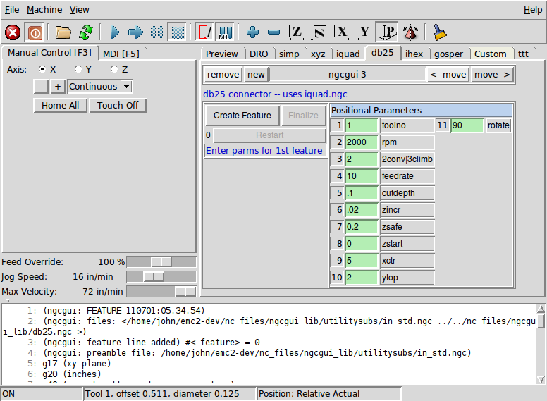

Using NGCGUI or PYNGCGUI:
  • Tab pages are provided for each subroutine specified in the INI file
  • New subroutines tab pages can be added on the fly using the custom tab
  • Each subroutine tab page provides entry boxes for all subroutine parameters
  • The entry boxes can have a default value and an label that are identified by special comments in the subroutine file
  • Subroutine invocations can be concatenated together to form a multiple step program

2. Demonstration Configurations
A number of demonstration configurations are located in the sim directory of the Sample Configurations offered by the LinuxCNC configuration picker. The configuration picker is on the system’s main menu:
CNC > LinuxCNC
Examples are included for the axis, touchy, gscreen, and gmoccapy. These examples demonstrate both 3-axis (XYZ) cartesian configurations (like mills) and lathe (XZ) setups. Some examples show the use of a pop up keyboard for touch screen systems and other examples demonstrate the use of files created for the gcmc (G code Meta Compiler) application. The touchy examples also demonstrate incorporation of a gladevcp back plot viewer (gremlin_view).
The simplest application is found as:
Sample Configurations/sim/axis/ngcgui /ngcgui_simple
A comprehensive example showing gcmc compatibility is at:
Sample Configurations/sim/axis/ngcgui/ngcgui_gcmc
A comprehensive example embedded as a gladevcp app and using gcmc is at:
Sample Configurations/sim/gscreen/ngcgui/pyngcgui_gcmc

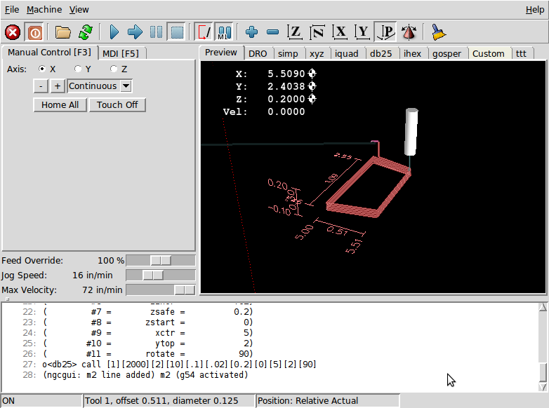

To try a demonstration, select a sim configuration and start the linuxCNC program.
If using the axis gui, press the E-Stop images/tool_estop.gif then Machine Power images/tool_power.gif then Home All. Pick a ngcgui tab, fill in any empty blanks with sensible values and press Create Feature then Finalize. Finally press the Run images/tool_run.gif button to watch it run. Experiment by creating multiple features and features from different tab pages.
To create several subroutines concatinated into a single file, go to each tab fill in the blanks, press Create Feature then using the arrow keys move any tabs needed to put them in order. Now press Finalize and answer the prompt to create

7. DB25 Example
The following shows the DB25 subroutine. In the first photo you see where you fill in the blanks for each variable.
