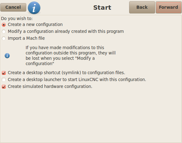

2. Start Page
images/stepconf-config.png
Figure 1. Entry Page
  • Create New - Creates a fresh configuration.
  • Modify - Modify an existing configuration. After selecting this a file picker pops up so you can select the .stepconf file for modification. If you made any modifications to the main .hal or the .ini file these will be lost. Modifications to custom.hal and custom_postgui.hal will not be changed by the Stepconf Wizard. Stepconf will highlight the lastconf that was built.
  • Import - Import a Mach configuration file and attempt to convert it to a linuxcnc config file. After the import, you will go though the pages of stepconf to confirm/modify the entries. The original mach xml file will not be changed.
These next options wiil be recorded in a preference file for the next run of Stepconf.
  • Create Desktop Shortcut - This will place a link on your desktop to the files.
  • Create Desktop Launcher - This will place a launcher on your desktop to start your application.
  • Create Simulated Hardware - This allows you to build a config for testing, even if you don’t have the actual hardware.

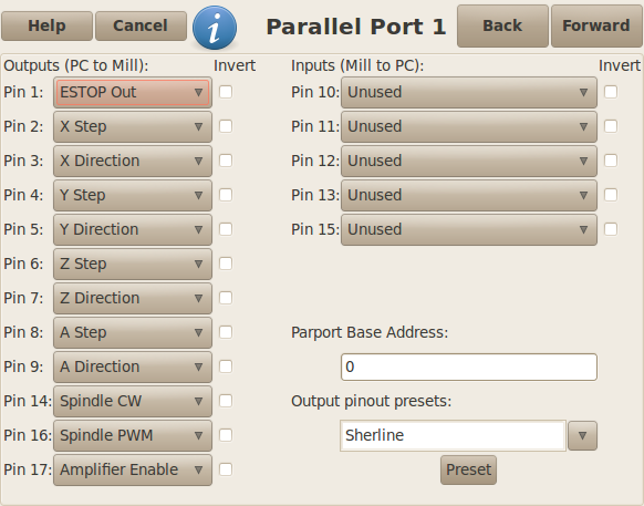

5. Parallel Port Setup
images/stepconf-pinout.png
Figure 4. Parallel Port Setup Page
You may specify the address as a hexidecimal (often 0x378) or as linux’s default port number (probably 0)
For each pin, choose the signal which matches your parallel port pinout. Turn on the invert check box if the signal is inverted (0V for true/active, 5V for false/inactive).
  • Output pinout presets - Automatically set pins 2 through 9 according to the Sherline standard (Direction on pins 2, 4, 6, 8) or the Xylotex standard (Direction on pins 3, 5, 7, 9).
  • Inputs and Outputs - If the input or output is not used set the option to Unused.
  • External E Stop - This can be selected from an input pin drop down box. A typical E Stop chain uses all normally closed contacts.
  • Homing & Limit Switches - These can be selected from an input pin drop down box for most configurations.
  • Charge Pump - If your driver board requires a charge pump signal select Charge Pump from the drop down list for the output pin you wish to connect to your charge pump input. The charge pump output is connected to the base thread by Stepconf. The charge pump output will be about 1/2 of the maximum step rate shown on the Basic Machine Configuration page.

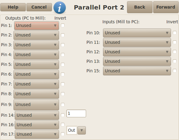

6. Parallel Port 2 Setup
images/stepconf-parport2.png
Figure 5. Parallel Port 2 Setup Page
The second Parallel port (if selected) can be configured and It’s pins assigned on this page.
No step and direction signals can be selected.
You may select in or out to maximizes the number of input/output pins that are available.
You may specify the address as a hexidecimal (often 0x378) or as linux’s default port number (probably 1).

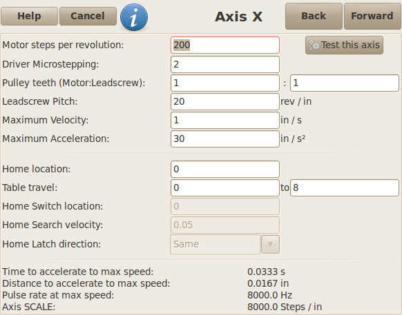

7. Axis Configuration
images/stepconf-axis.png
Figure 6. Axis Configuration Page
  • Motor Steps Per Revolution - The number of full steps per motor revolution. If you know how many degrees per step the motor is (e.g., 1.8 degree), then divide 360 by the degrees per step to find the number of steps per motor revolution.
  • Driver Microstepping - The amount of microstepping performed by the driver. Enter 2 for half-stepping.
  • Pulley Ratio - If your machine has pulleys between the motor and leadscrew, enter the ratio here. If not, enter 1:1.
  • Leadscrew Pitch - Enter the pitch of the leadscrew here. If you chose Inch units, enter the number of threads per inch If you chose mm units, enter the number of millimeters per revolution (e.g., enter 2 for 2mm/rev). If the machine travels in the wrong direction, enter a negative number here instead of a positive number, or invert the direction pin for the axis.
  • Maximum Velocity -Enter the maximum velocity for the axis in units per second.
  • Maximum Acceleration - The correct values for these items can only be determined through experimentation. See Finding Maximum Velocity to set the speed and Finding Maximum Acceleration to set the acceleration.
  • Home Location - The position the machine moves to after completing the homing procedure for this axis. For machines without home switches, this is the location the operator manually moves the machine to before pressing the Home button. If you combine the home and limit switches you must move off of the switch to the home position or you will get a joint limit error.
  • Table Travel - The range of travel for that axis based on the machine origin. The home location must be inside the Table Travel and not equal to one of the Table Travel values.
  • Home Switch Location - The location at which the home switch trips or releases relative to the machine origin. This item and the two below only appear when Home Switches were chosen in the Parallel Port Pinout. If you combine home and limit switches the home switch location can not be the same as the home position or you will get a joint limit error.
  • Home Search Velocity - The velocity to use when searching for the home switch. If the switch is near the end of travel, this velocity must be chosen so that the axis can decelerate to a stop before hitting the end of travel. If the switch is only closed for a short range of travel (instead of being closed from its trip point to one end of travel), this velocity must be chosen so that the axis can decelerate to a stop before the switch opens again, and homing must always be started from the same side of the switch. If the machine moves the wrong direction at the beginning of the homing procedure, negate the value of Home Search Velocity.
  • Home Latch Direction - Choose Same to have the axis back off the switch, then approach it again at a very low speed. The second time the switch closes, the home position is set. Choose Opposite to have the axis back off the switch and when the switch opens, the home position is set.
  • Time to accelerate to max speed - Time to reach maximum speed calculated from Max Acceleration and Max Velocity.
  • Distance to accelerate to max speed - Distance to reach maximum speed from a standstill.
  • Pulse rate at max speed - Information computed based on the values entered above. The greatest Pulse rate at max speed determines the BASE_PERIOD. Values above 20000Hz may lead to slow response time or even lockups (the fastest usable pulse rate varies from computer to computer)
  • Axis SCALE - The number that will be used in the ini file [SCALE] setting. This is how many steps per user unit.
  • Test this axis - This will open a window to allow testing for each axis. This can be used after filling out all the information for this axis.

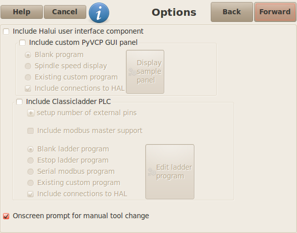

9. Options
images/stepconf-advanced.png
Figure 9. Advanced Configuration
  • Include Halui - This will add the Halui user interface component. See the HALUI Chapter for more information on.
  • Include pyVCP - This option adds the pyVCP panel base file or a sample file to work on. See the PyVCP Chapter for more information.
  • Include ClassicLadder PLC - This option will add the ClassicLadder PLC (Programmable Logic Controller). See the Classicladder Chapter for more information.
  • Onscreen Prompt For Tool Change - If this box is checked, LinuxCNC will pause and prompt you to change the tool when M6 is encountered. This feature is usually only useful if you have presettable tools.

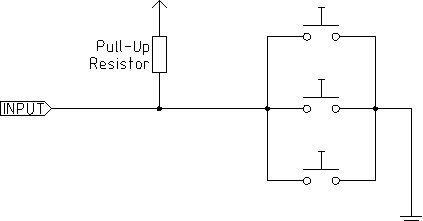

11.3. Home and Limit Switch wiring options
The ideal wiring for external switches would be one input per switch. However, the PC parallel port only offers a total of 5 inputs, while there are as many as 9 switches on a 3-axis machine. Instead, multiple switches are wired together in various ways so that a smaller number of inputs are required.
The figures below show the general idea of wiring multiple switches to a single input pin. In each case, when one switch is actuated, the value seen on INPUT goes from logic HIGH to LOW. However, LinuxCNC expects a TRUE value when a switch is closed, so the corresponding Invert box must be checked on the pinout configuration page. The pull up resistor show in the diagrams pulls the input high until the connection to ground is made and then the input goes low. Otherwise the input might float between on and off when the circuit is open. Typically for a parallel port you might use 47k.
Normally Closed Switches

Normally Open Switches
Wiring N/O switches in parallel (simplified diagram)
images/switch-no-parallel.png
