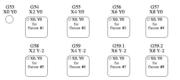

1.3 Fixture Offsets (G54-G59.3 )
Figure: Work Offsets
Work or fixture offset are used to make a part home that is different from the absolute, machine coordinate system. This allows the part programmer to set up home positions for multiple parts. A typical operation that uses fixture offsets would be to mill multiple copies of parts on "islands" in a piece, similar to figure [.]
The values for offsets are stored in the VAR file that is requested by the INI file during the startup of an EMC. In our example below we'll use G55. The values for each axis for G55 are stored as variable numbers.

You should read this as moving the zero positions of G55 to X = 2 units, Y= 1 unit, and Z = -2 units away from the absolute zero position.
Once there are values assigned, a call to G55 in a program block would shift the zero reference by the values stored. The following line would then move each axis to the new zero position. Unlike G53, G54 through G59.3 are modal commands. They will act on all blocks of code after one of them has been set. The program that might be run using figure [.] would require only a single coordinate reference for each of the locations and all of the work to be done there. The following code is offered as an example of making a square using the G55 offsets that we set above.

G54     use preset work coordinate system 1
G55     use preset work coordinate system 2
G56     use preset work coordinate system 3
G57     use preset work coordinate system 4
G58     use preset work coordinate system 5
G59     use preset work coordinate system 6
G59.1   use preset work coordinate system 7
G59.2   use preset work coordinate system 8
G59.3   use preset work coordinate system 9
